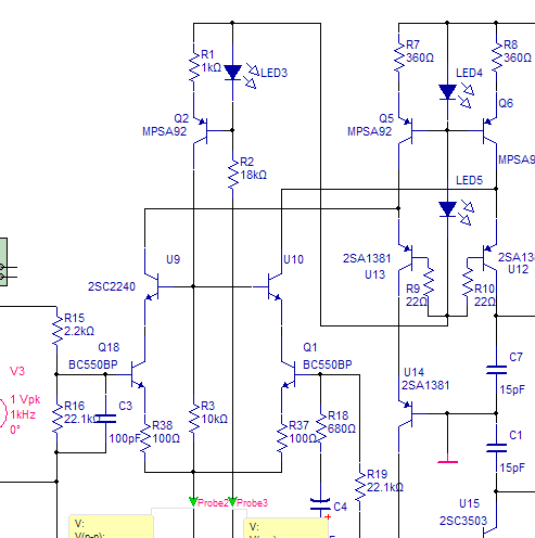

Let's compare:
I see the 696B has a Cob of 6pF, yet it's input capacitance is 200pF. Is this high? Looking at the 2SC1845 I see that it has a listed Cob of 1.6pF, but they make no mention of the input capacitance. Calling up the spec sheet on the BC550 I see Cob = 3.5pF and Cib = 9pF.
The problem:

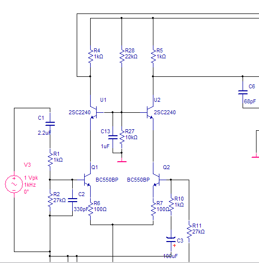

I have 70V rails. I have on hand several 2SC1845E but they would not survive my voltage! I'd prefer to cascode, but that would mean changing OS's design (oh the humanity!).
Conclusion:
I see the ZTX696B as a viable solution. I and many others will not detect the inferior quality of this device when used in this application. But that's always been my problem - I listen to the music, not the transistors. 🙂
Sticking with the purely technical reasons to choose a particular device is probably better and less contentious.
Let's compare:
The problem:
Conclusion:
go ahead ,do the cascode, (only on the condition you use a zener😀 )
About voltage..??? KSA1845's do`180v , since fa2 's LTP
only goes from -.8v to V+ rail (60-100v), I see no problem here.

Heres yer' cascode..sims great, shaves a little off the gain
as well.
Does not seem like a "frugal" anymore
OS
as well.
OS
ostripper said:Heres yer' cascode..
No, here's my cascode. 🙂 No stinkin' zeners.
Was it ever "frugal"?

Cascoding is a route one can take, or for 70v supplies you could find 2sd756a hitachis, very difficult nowadays. I for one agree with Pass sometimes less is more when it comes to complexity. Chasing ultimate THD numbers is sometimes counterproductive but good for marketing figures.
Os now youve gone and complicated a very nice design
If you chasing figures you could go futher and use cfps for the ltp and taking a step further bootstrap the front end, dont know whether youll like the sonic results though. To reduce gain you could split the vas ltp like the cyrus amp and boost the currents with subsequint EFs. It works well for THD figures and getting kick *** bass.

Hey OS,
How about doing a constant power cascode?
That is, string a 2mA CCS from the positive rail to a resistor of 10K terminating on the two LTP degen resistors, dropping around 20 volts, and support the cascode bases from here. Bump up the existing LTP CCS by 2mA to maintain the same operating stage current. This will ensure constant voltage across the LTP devices, reducing Early effect, but serve to reduce the Vbe they see.
Of course, Alex is right that cfp LTP would be the next logical step.... with changes in Ic, the Vbe changes cause a gross non-linearity in the LTP. With high fb factor, this is small, but it can be almost eliminated with a cfp.

Sounds familiar. Same scheme as in the RMI-FC100 or my debauched version - Abomination:
I have seen the same done in several other topics here.
CCS + resistor, tied to the LTP emitter side.
Nothing new. But it is a very good trick.

Love the discussion thats been going on over the Frugalamp II design. This is pretty much the topology I'd simmed a while back and then never got around to doing anything with.
I might have to lay out a PCB 🙂 I know MJL has done one, but it wouldn't fit with how I plan to mount the transistors to my heatsinks. The cascode in the LTP is something I've had from day one, too.
I'm tempted to try simulating a CFP LTP input but i doubt it's worth the hassle.
