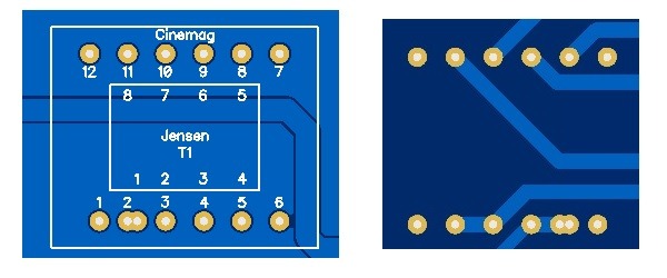

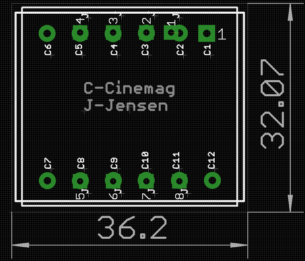

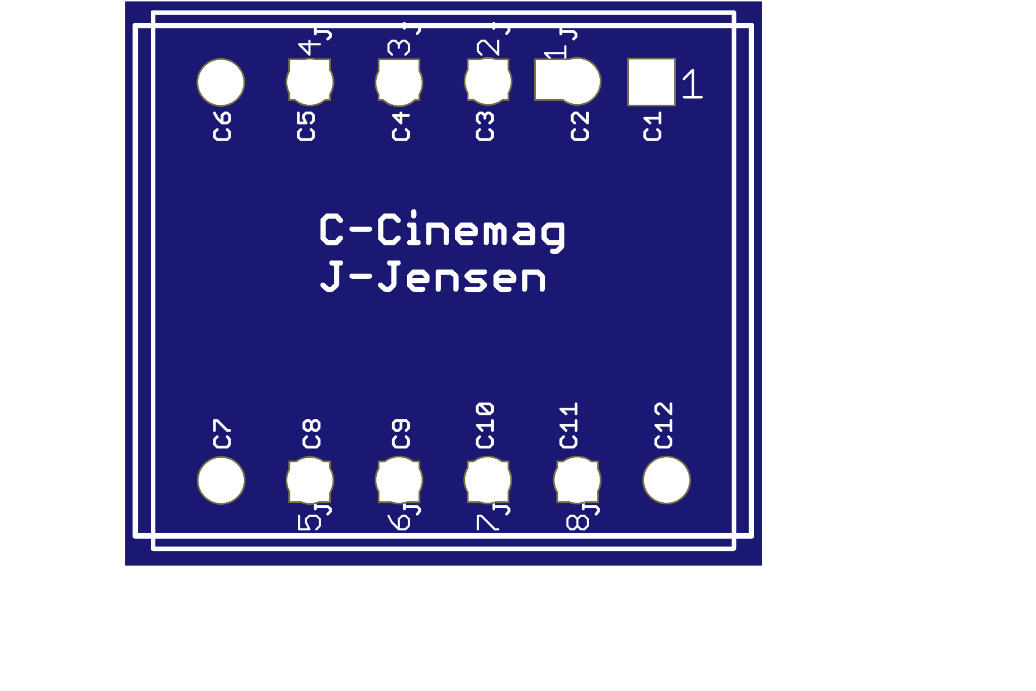

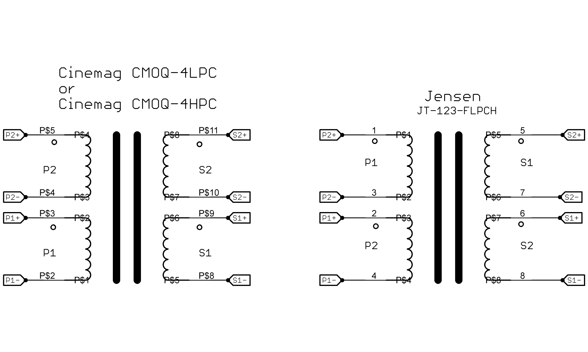

if you look at schematic, 3 repeaters are connected primary to primary, secondary to secondary, obeying phases
so, how you gonna connect it/them in circuit, that's matter of main board, not Daughterboard
now, if you are talking abut preferences - Jensen vs, Cinemag or Edcor, in normal xformer configuration, that's other thing
I didn't found Jensen superior at all to Cinemag, and I'm liking Edcor more than Jensen, even if Jensen is certainly having more detailed sound
correction, this is good for F6
but, it will not transform it in Square Law OS :devily:
  • Jensen CInemag repeaters.zip

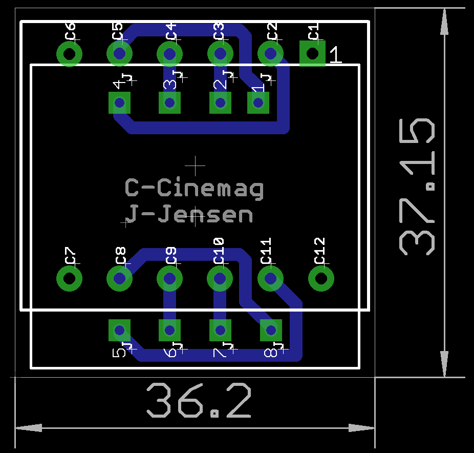

I had that triple version already made whoknowswhen, as building bock for my concoctions
all what was needed is to draw Dimension (pcb boundaries) and produce set of files you see attached
and then - when Tungsten pushed me in right direction, deleting Edcor was trivial
xformer types you can see at render bottom pic
Cinemag - yes, directly from them
both low nickel and hi nickel are good; let mood decide

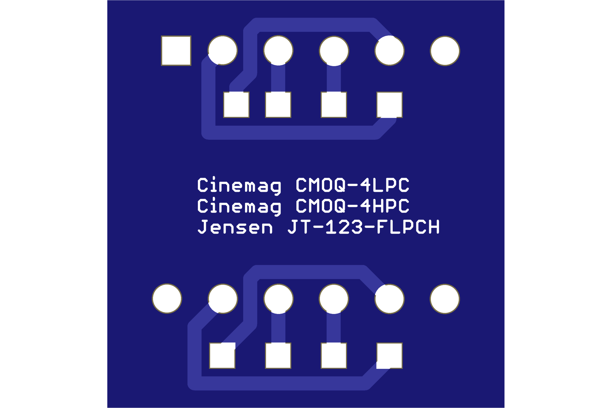

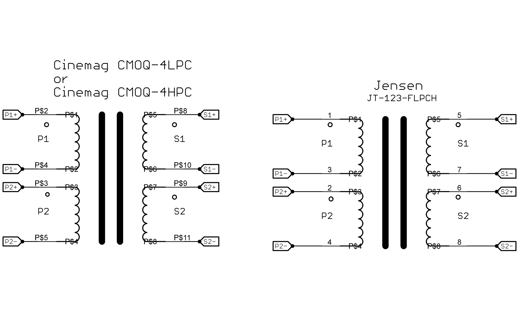

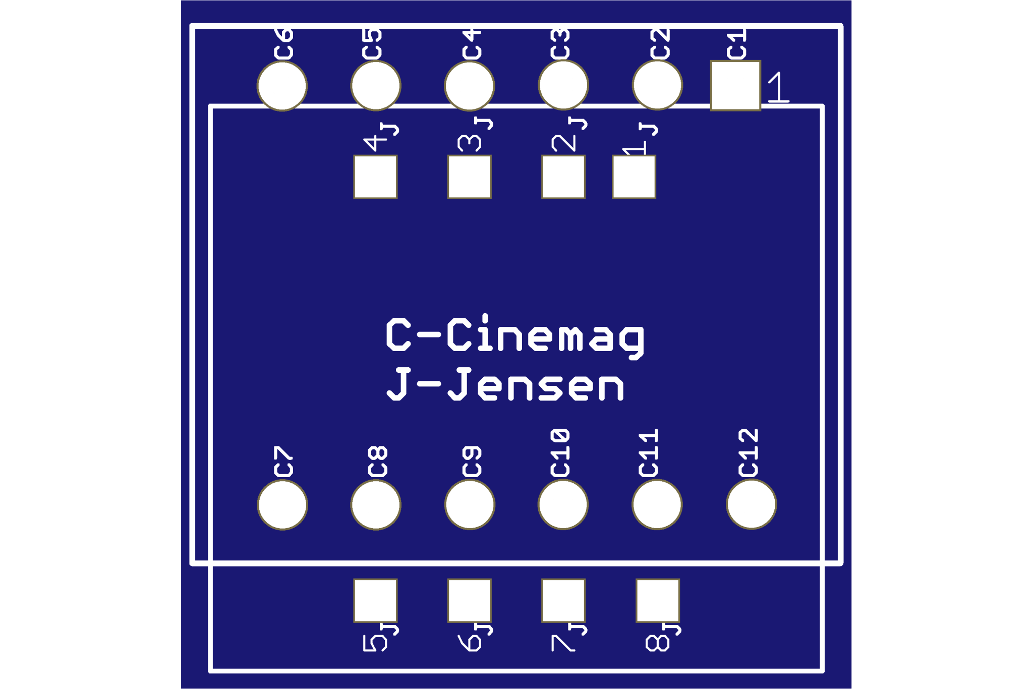

Looking at both datasheets, I think the connections are:
Jensen pin 1 to Cinemag pin 2
Jensen pin 3 to Cinemag pin 4
Jensen pin 2 to Cinemag pin 3
Jensen pin 4 to Cinemag pin 5
Jensen pin 5 to Cinemag pin 8
Jensen pin 7 to Cinemag pin 10
Jensen pin 6 to Cinemag pin 9
Jensen pin 8 to Cinemag pin 11
Hope you agree ZM.

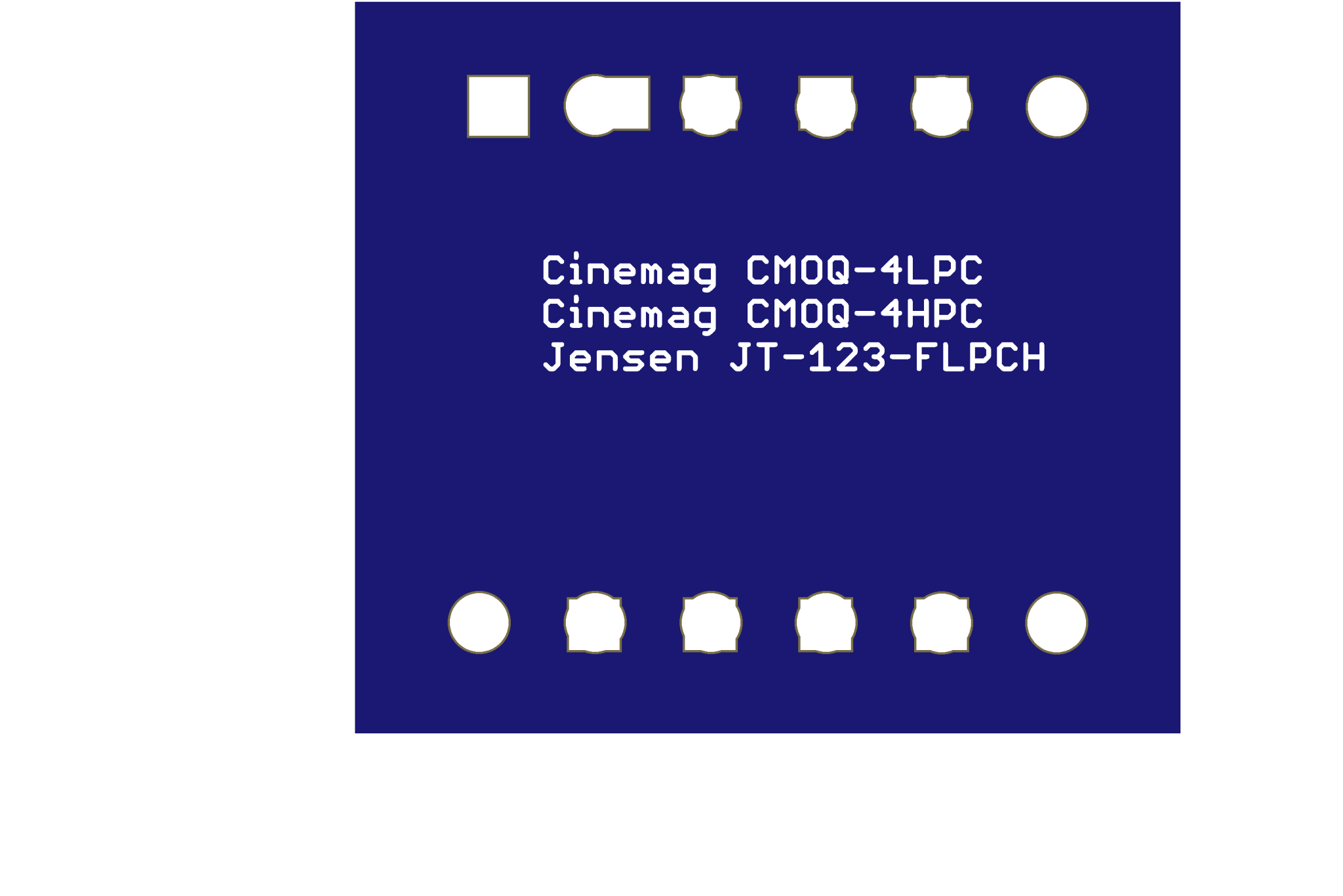

here it is, as it seems that my brain is better while having night coffee, anyways
  • 2 repeaters for F6 ZM finally proper.zip
