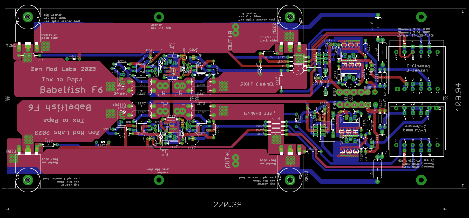

True, unzipping the attachment reveals a folder that contains a second ZIP archive that can be presumably sent to a fab house to make PCBs.

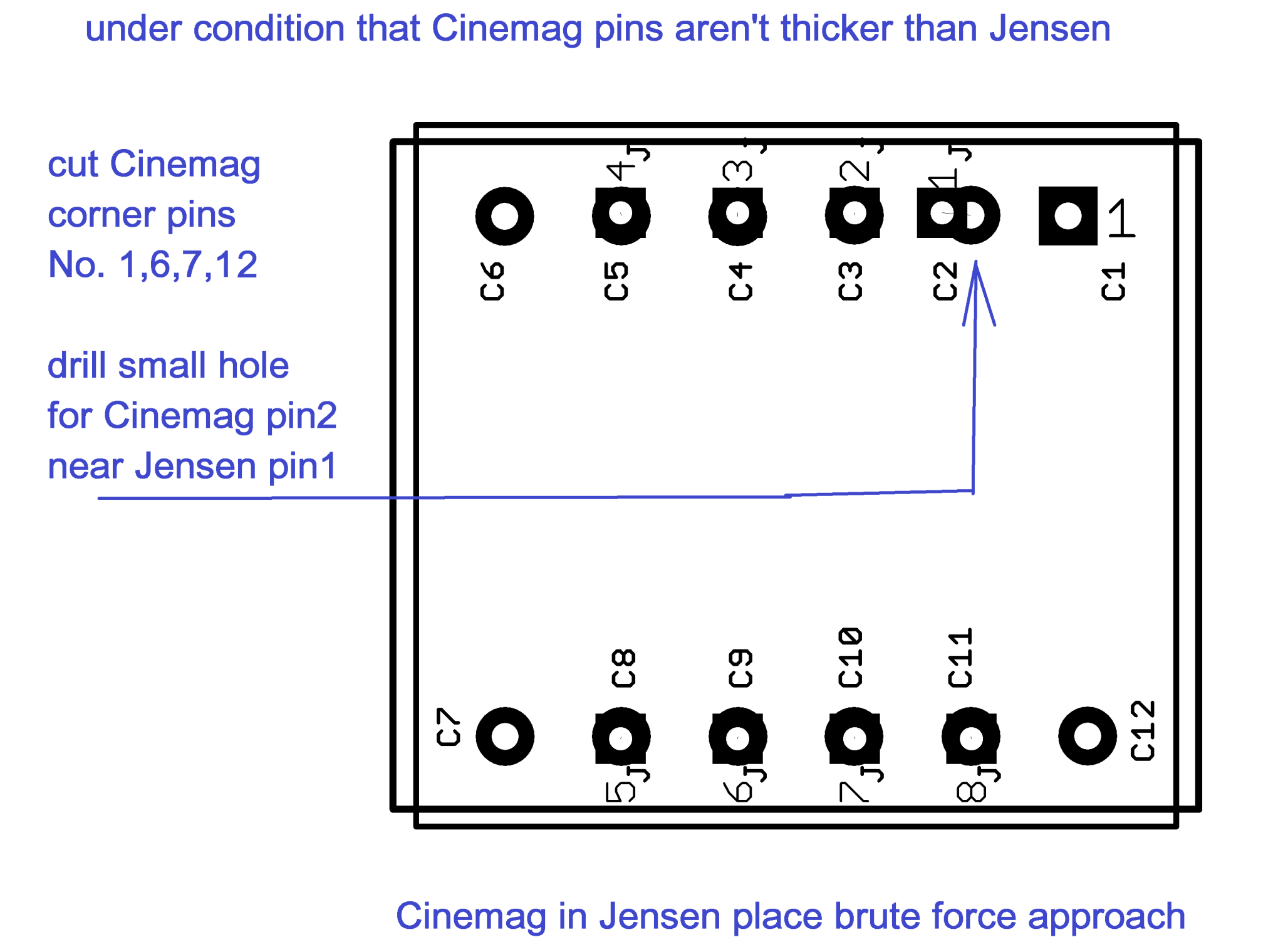

One can fit the Cinemag direct to the F6 pcb with a small mod as detailed below without the need of a daughter board:
1. The Cinemag has 12 pins against the Jensen which has 8 pins.
2. Pins 1,6,7 and 12 on the Cinemag are not used and not connected to the windings.
3. One needs to drill a 1mm hole that is 0.005" or 1.27mm outside of the Jensen pin 1 on the pcb for the Cinemag pin 2 - that is the one with the square land.
4. Carefully sit the Cinemag over the holes so that Pin 5 of the Cinemag lines up with pin 4 of the Jensen hole, similarly pin 8 of the Cinemag will line up with pin 5 of the Jensen. Then you can mark the position of the new hole on the pcb with a fine marking pen for the Cinemag pin 2.
5. Drill a new hole where you have marked (1mm dia or 0.04")
6. Carefully snip off pins 1,6,7 and 12 flush with the Cinemag former. Don't cut any of the other pins!!
7. Now the Cinemag should drop neatly into the holes.
8. Solder all pins, you might just have to bridge the Cinemag pin 2 to the Jensen pin 1 land.
9. Job done, both transformers are the same size within a mm so the Cinemag will fit OK.
yup, that exactly shown in Brute Force pic, #161
of course that I made typo yesterday, was pin 11, needs to be pin 12; error corrected

pretty much trivial regarding FE - already seen 3+3pcs of 2SK2145 same sex JFet buffer feeding two primary sections in series, then one secondary modulating one output mosfet
difference in OS being - again seen already - 0R11 combo in each rail as sense resistance, with optos translating that to governing bias voltages up and down
(common) helper CCS to bring optos in conducting region
I mean - nothing new under the sun,, but I'll leave details for time of actually having pcbs made and populated and confirmed with all measurements
bummer is - I already have entire line of populated Drek, "just" waiting for "when?!?" bench time
