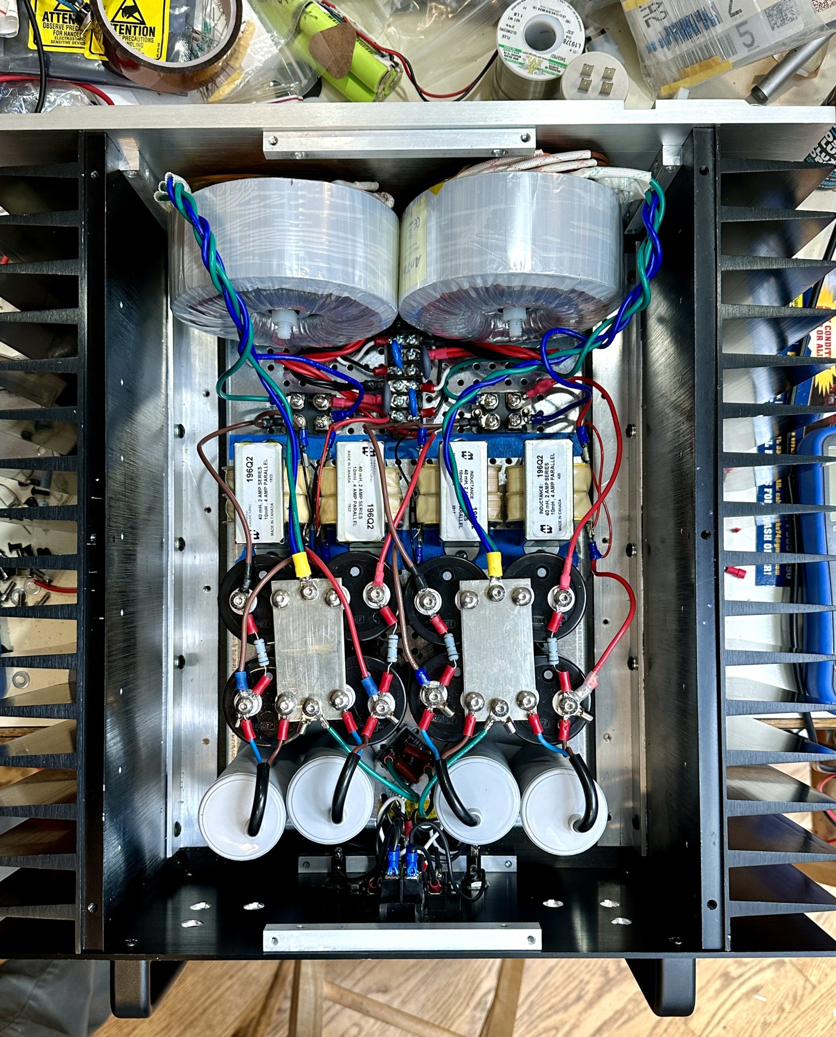

I have been postponing the transistor matching for my new Stasis OS boards. I have four tubes of parts to match for two different builds. The fun part for me was building the power supply for the smaller of the two chassis. I happen to like doing a little metal work as well. The grounding plates were cut and filed from larger sheets of nickel silver alloy.
Looking good there TA, what are you going to use to get the +/- DC rails from this chassis to the Stasis amp chassis?
Nice work TA!
I'm interested in the way you hold your transformers in place.
Is that a rubber stopper compressed between a pair of washers to expand in the center of the donut? This creates enough holding power for a heavy trafo?
This will be a single chassis build. I drilled and tapped mounting holes for the 8 deep OS boards. Each board has three ground wire mounting holes, all of which will be used and collected back at the channel grounding plate.
I use strongtie angle brackets for mounting the big transformers. A hardware store item used normally for tying pieces of lumber together. I have found a snug fitting rubber stopper (or two) has plenty of holding power when compressed by the mounting bolts. Note that the mounting bolts are nylon to ensure there is no way to create a shorted turn.

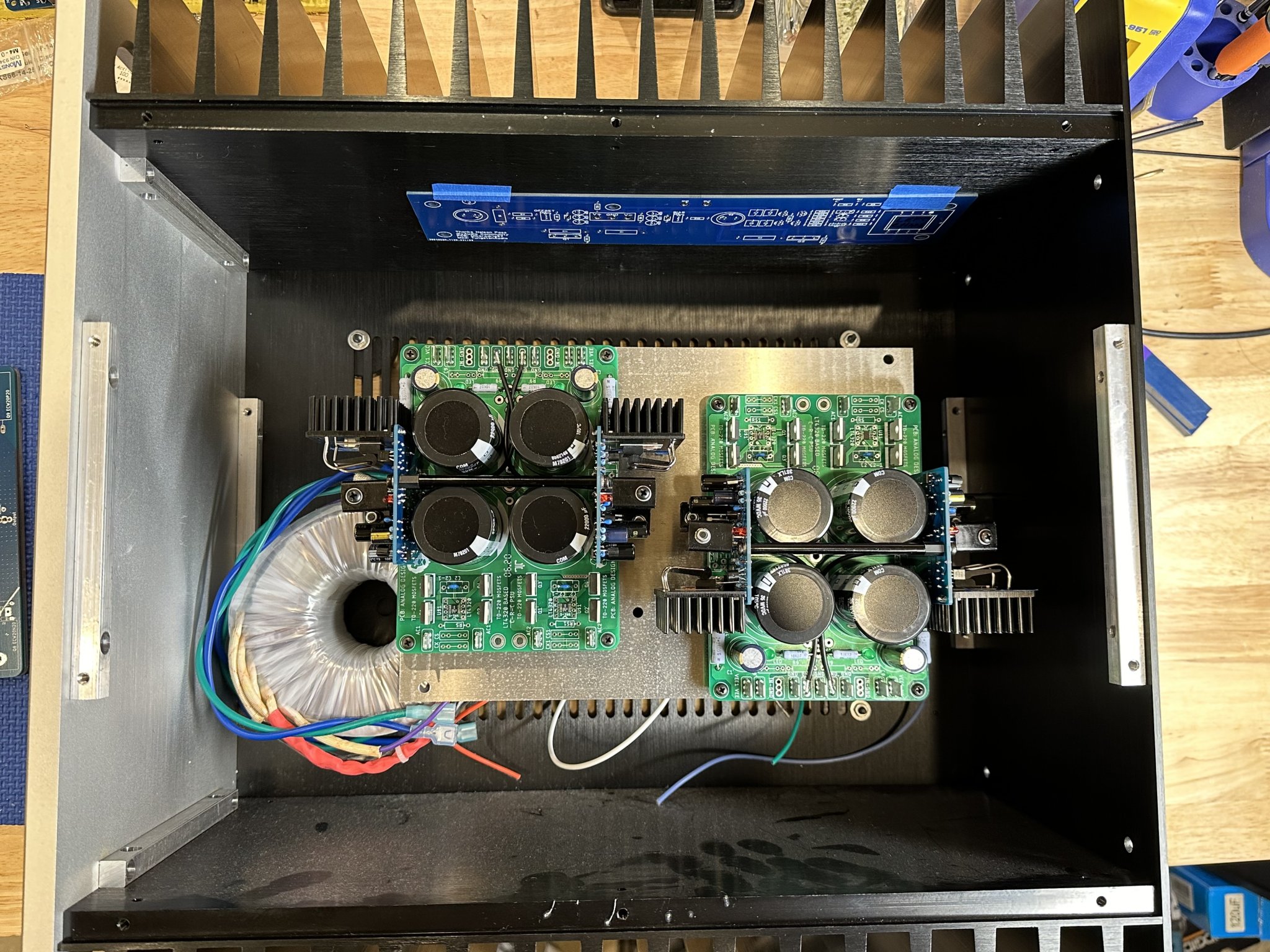

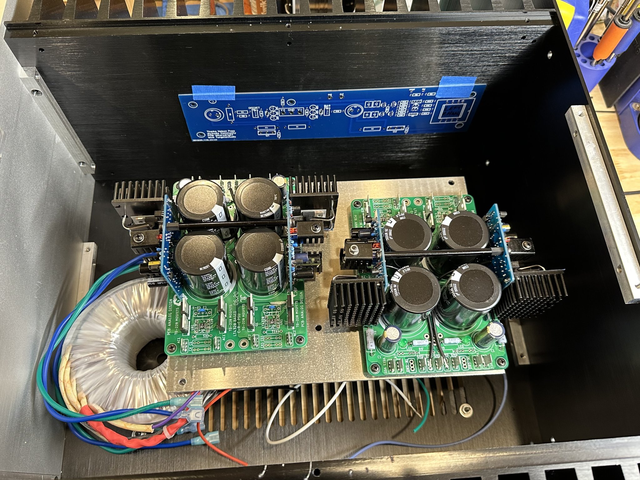

Planning stage of chassis layout tonight.
This configuration would use a pair of Antek AS-3225 trafos mounted at the front of chassis flat on the base.
The PSU boards are mounted on a raised platform, the soft start is underneath in line with the AC inlet module.
The chassis size is 5U x 400mm, the F6 boards are not centered but mounted two fins towards rear. Mosfet mounting hole is 60mm up from base.
Would this be an acceptable distance between the Jensen transformers and power trafos?
Probably. If not I have little sheets of mu metal I can send you.
I would say that would work Vunce, but the mu metal sheets wrapped around the Jensen's wont hurt at all.

I’ll move forward with the proposed layout, fire up the garage heater🥶
The F6 Diamond and another low power class A amp will both use these power supplies. Took a looong time to gather the parts for the R21 modules, so first time they will be put in service for me.
