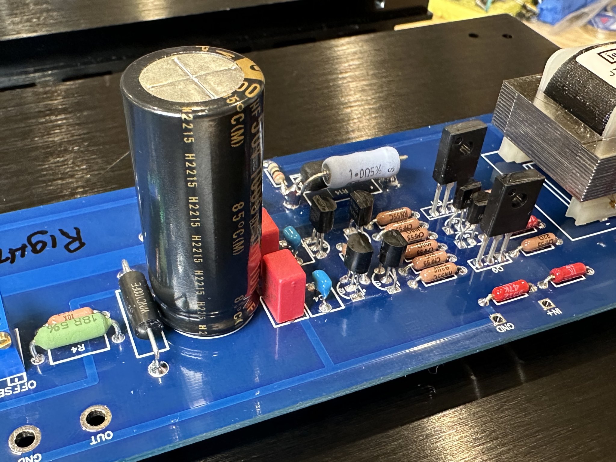

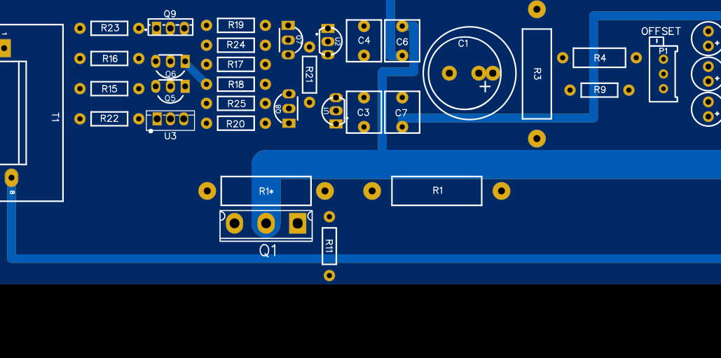

Now a couple of comments (and in no way is it a criticism) after loading up the passives.
1. Resistor R22 is silkscreened upside down on 1 of the pcb's, the other channel board is OK.
2. Resistor R1* on the same pcb is silkscreened as R14 for the 1R//0R1, again the other board is OK.
3. Silkscreening on the other channel pcb for U3 is obscured, the 1st pcb is OK.
4. Maybe increase the silkscreen lettering size for the TO92 transistors and the V ref TO92 - it is a bit small.
5. Remove Zeners Z1 and Z2.
6. If you or Mike were to revise the pcb, then add parallel pcb lands for the resistor R1*, rather than piggyback resistors.
7. Again if revised, add the second pin next to pin 1 for the transformer mounting so one could use either the Jensen or Cinemag transformers.
Just thought I would bring those to your attention, obviously all are only cosmetic and don't affect the operation of the board in any way - just to keep in mind for any future revision.

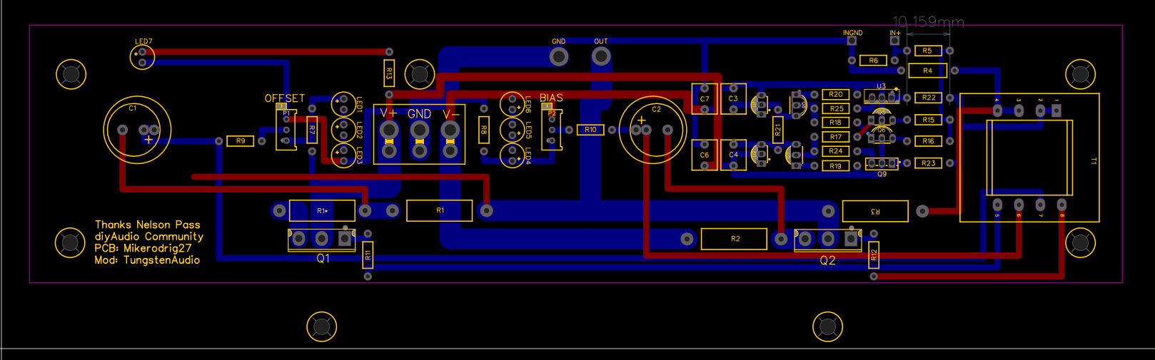

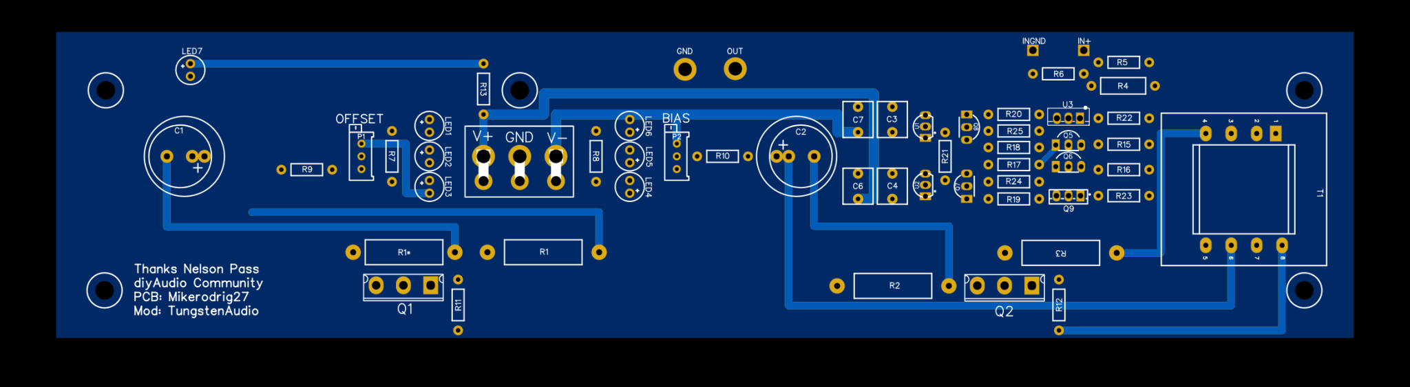

So I have been planning on redoing the PCBs a bit. I addressed the points 1-5. Tungsten is on the same page regarding the Zeners.
Done 1. Resistor R22 is silkscreened upside down on 1 of the pcb's, the other channel board is OK.
Done 2. Resistor R1* on the same pcb is silkscreened as R14 for the 1R//0R1, again the other board is OK.
Done 3. Silkscreening on the other channel pcb for U3 is obscured, the 1st pcb is OK.
Done 4. Maybe increase the silkscreen lettering size for the TO92 transistors and the V ref TO92 - it is a bit small.
Done 5. Remove Zeners Z1 and Z2.
Regarding 6, that is up to Tungsten.
Regarding 7, I plan to redo the Diamond boards to take the Cinemag and Jenson transformers the next time I have a free moment. I need to talk to the store to make sure I am not stepping on their toes regarding a regular F6 with the Cinemags. I don't know what their plans are.
Let me know if anything else pops out at you and I can adjust things.

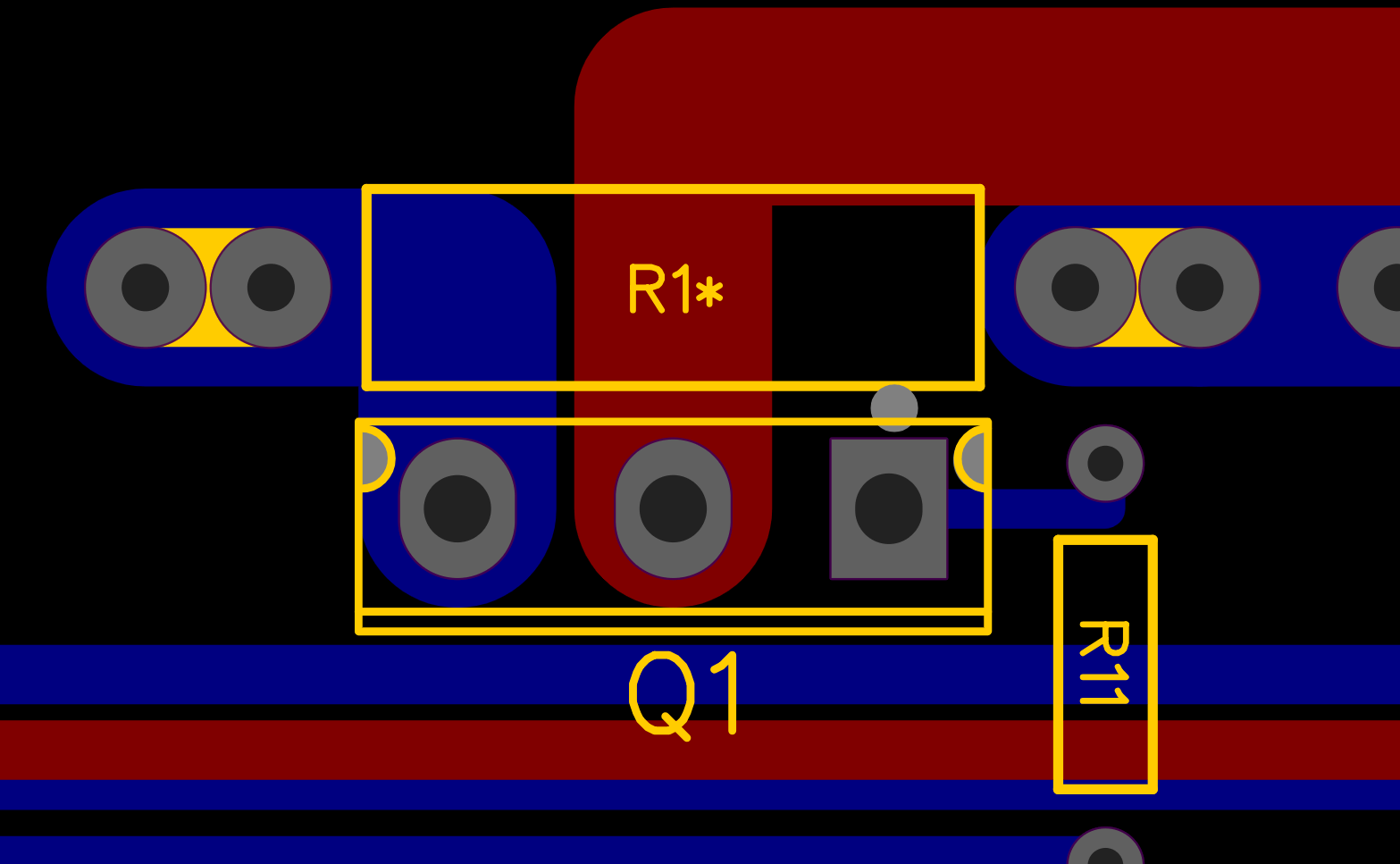

My observations on R1*
The mounting holes appear to be smaller than those for R1 and R2.
Having parallel lands looks feasible, perhaps easier if they are under the main outline of R1*. This would allow separate mounting of the extra resistor, with bent leads.

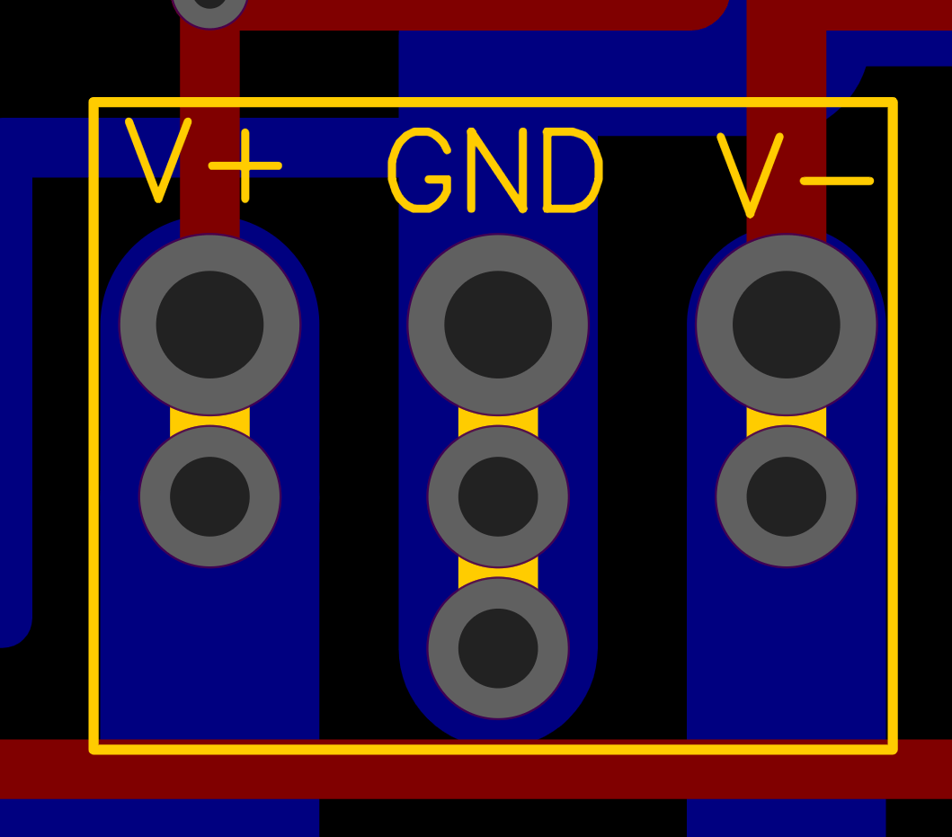

Note the extra small holes under V+ GND V-. These are for wiring motor run capacitors, or similar. The main holes allow 14ga wire; smaller holes are for 20ga wire.

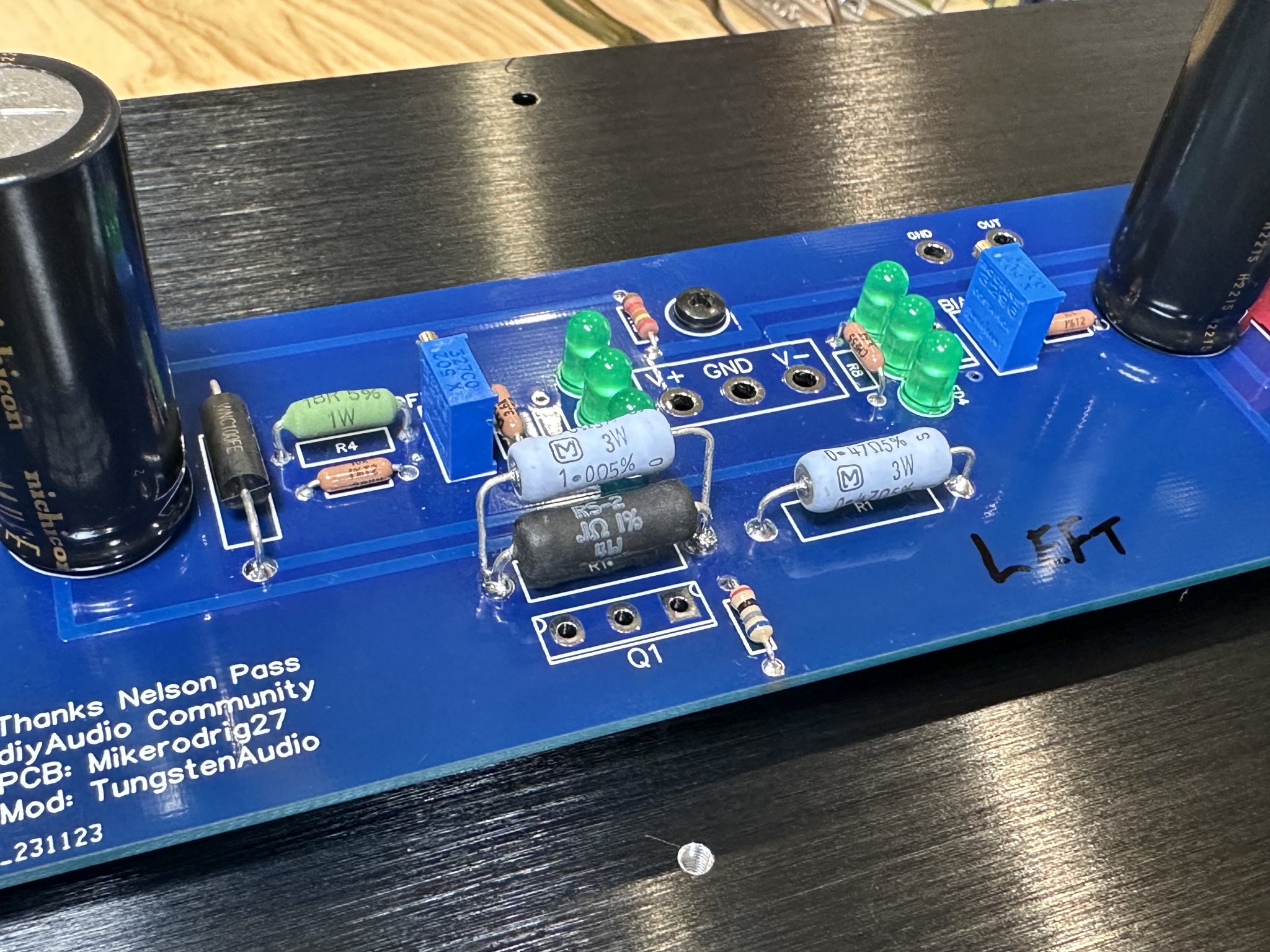

R1* holes on one of the pcb's appears to be smaller - they all look OK on the other one.
Perhaps also with a revision - mark one pcb LEFT and the other RIGHT on the front silkscreen..
Also, for the motor run caps (if using) there should be an added 2nd hole for 2 GND lands.

Yep, the pad size on R1* reverted to the original footprint size when I retitled it. Fixed:

I could do this:
Is that kind of Janky?

That is a good point. Each cap will need it's own gnd connection:added 2nd hole for 2 GND lands.

"Janky" - that must be a local Vermont phrase Mike, the R1* solution is OK with me.

The proposed not-too-janky parallel lands for R1* are what I had in mind. I could see that offsetting the extra mounting holes would cause a lot more re-wiring and didn't want to push for that.

I populated all the resistors on both boards and did notice a few stencile "imperfections", but nothing thats not self explanatory.

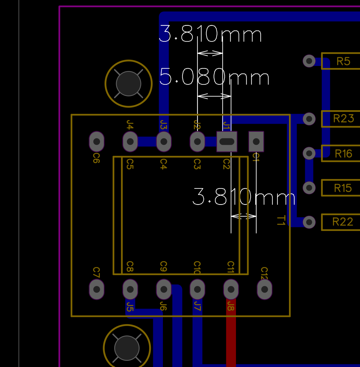

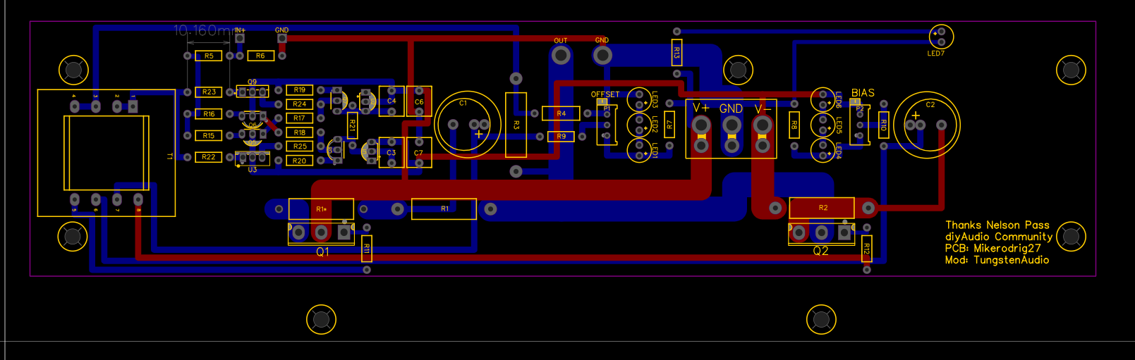

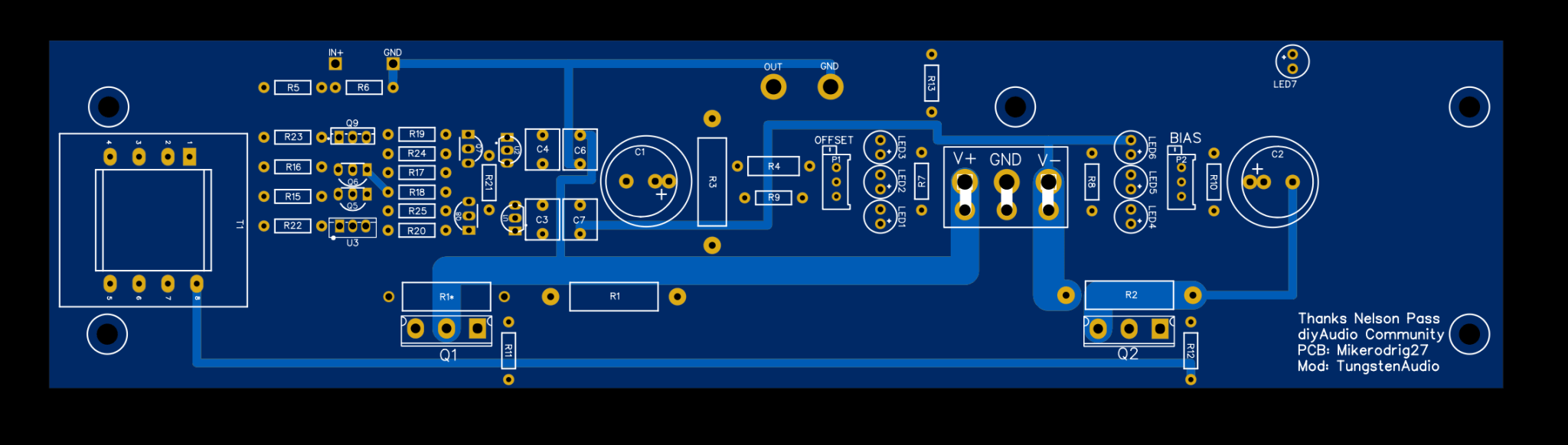

Okay, here is a practice run of the Cinemag transformer layout. Feel free to look at it and let me know if you see anything off. I am just going off of Zen Mod's PCB plus the dimensions in the Datasheet. Instead of doing a two hole solution for J1/C2, I just made a slot that should accommodate both.

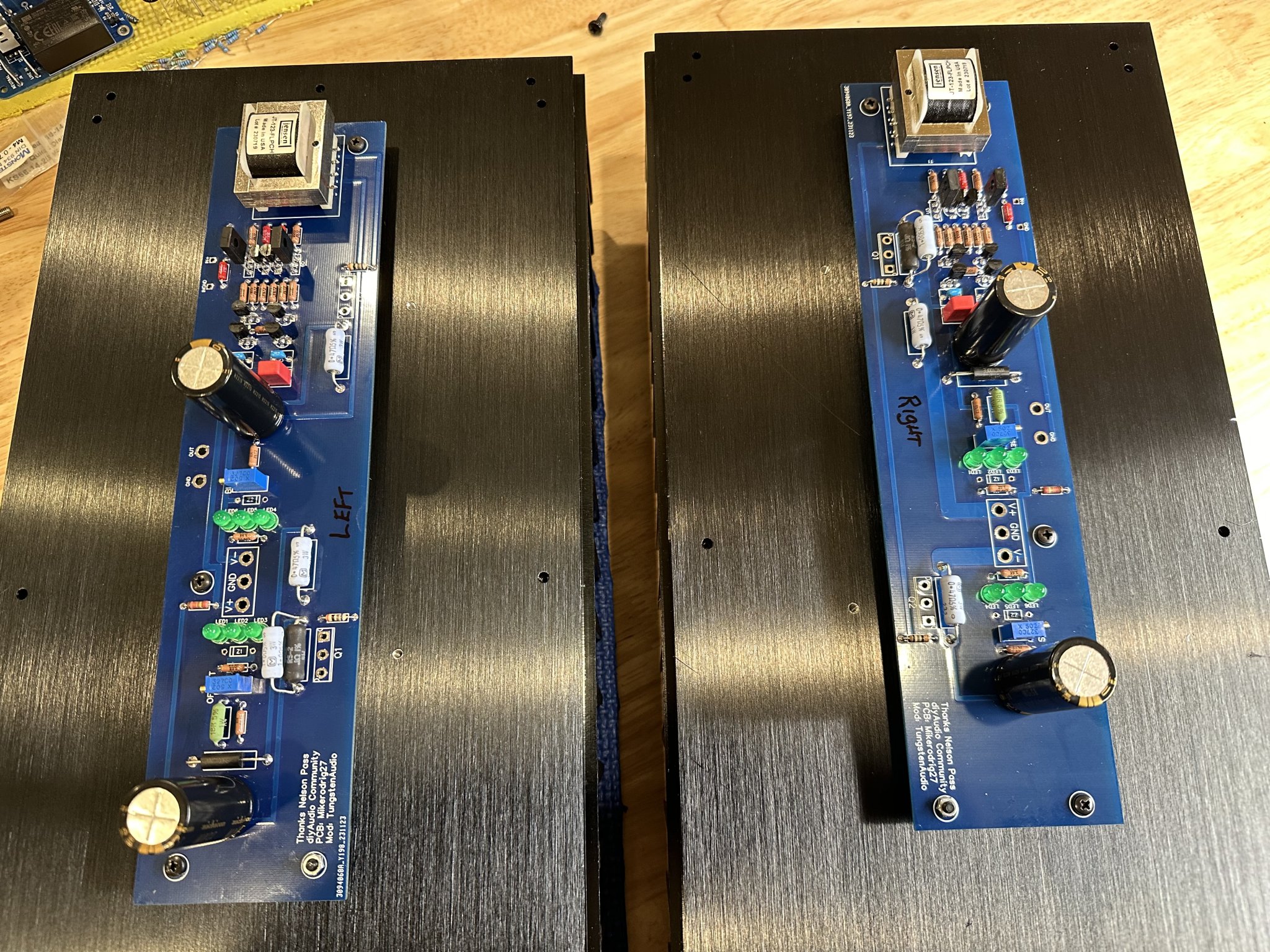

Heatsinks are prepped and F6 Diamond boards are built, minus the OS Fets.
The right channel board has a tight area around C1,6,7 and R3. The Nichi Muse cap is 18mm diameter and is very close to R1, if this resistor gets hot it might be a concern.
@Mikerodrig27, if you plan to remove the zeners, maybe shift the LEDs, trimpot, R4, R9 and R3 down the board a few mm’s that Z1 used to occupy, if that’s possible. That would give some breathing room between R3 and C1. The left channel is good.
What’s progress without porn…😆

Mike, that looks good on the dual transformer footprint, I will check the details tomorrow for you.
