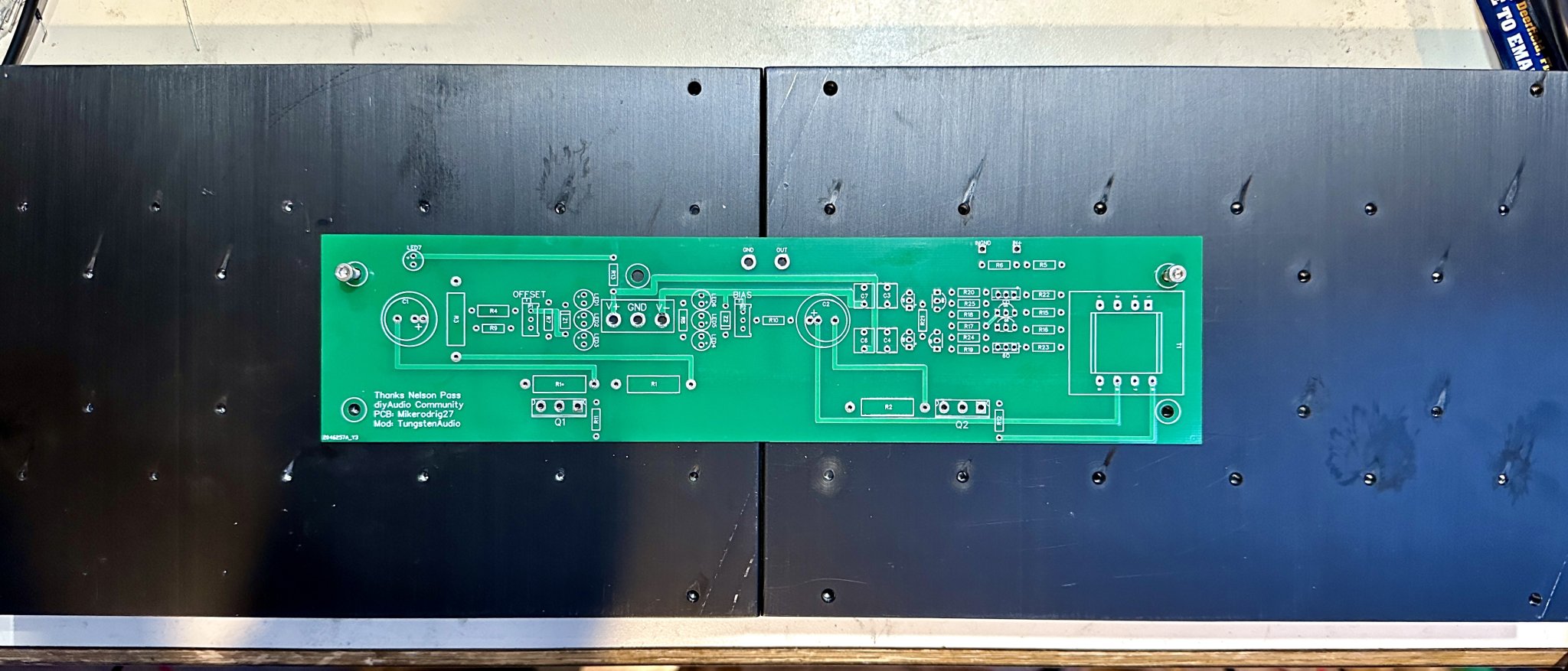

Just loading the 2 boards for the Diamond Buffer version into my JLCPCB cart, and I notice it shows them being different lengths.
Left = 259.21mm x 61.21mm
Right = 255.78mm x 61.21mm
Not that it worries me, but is that correct TA? I assume the mounting hole centres are the same on both boards.

The Toshiba TTC004B and TTA004B bipolars used in the Diamond buffer are rated for 160V. The smaller transistors are rated for 120V. So the Diamond buffer is easily capable of running on 32V rails.
The large electrolytic caps that need to be added on the output of the SLB may be located where you have space for them. I kept the wires to the SLB short.
The new PCBs, both sets, are compatible with the UMS mounting system. I have a set of heatsinks for the 4U x 500mm chassis. The board and Mosfet mounting holes align with the center locations.
There is a caveat: two piece heatsinks will probably need to have their inner fins dressed with a file to let the pieces fit such that the hole spacing is accurate. I needed to do that with these. Manufacturing tolerances are such that this is not uncommon.

I haven't done a 'fair' comparison between the JFet vs Diamond Buffer version. The Diamond buffer went into the best chassis that I had with the best output devices that I had. The JFet version resides in a chassis that is more typical of a build from a DIY enthusiast that is newer to the game and using a Modushop chassis with IRFP048 output devices. I cheated a little with synchronous rectifiers and added the motor run caps later to hear how that would improve things.
The Diamond buffer boards will be the main experimental platform going forward. Now is probably a good time to get back to the IXTQ75N10P Mosfets that I was experimenting with earlier. These look promising as substitutes for the FQH44N10. They need a slightly higher threshold voltage to operate at the preferred bias current. The new PCBs make it easy to use a blue LED in each string to get a higher voltage for setting the bias.
