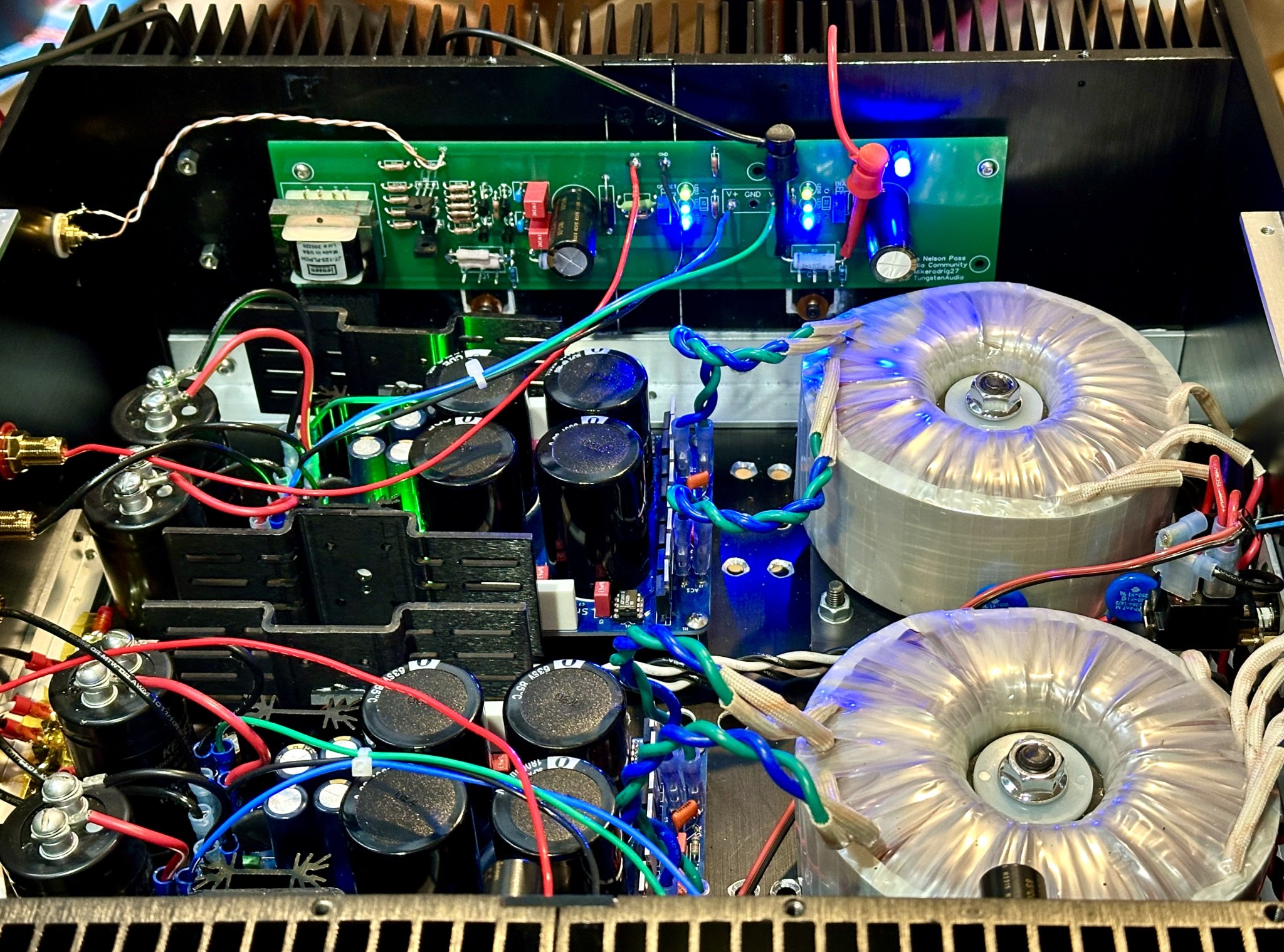

I have been listening to a second build of the F6 Diamond PCBs with IXTQ75N10P Mosfets for the last couple days. Yes, I have been taking my sweet time. Or as Pa likes to say:
:snail:
Good news! These parts sound equally great in the F6 as the FQH44N10. With a variety of music styles, the sound remains dynamic, clear and articulate. In my dual-mono chassis, the soundstage was immense and individual instruments often had a spooky 3D presence.
The IXTQ75N10P is a high transconductance and high power Mosfet that is easy to drive, with reasonable input capacitance and low total gate charge. It responds well to higher power rail voltage and bias current, but its datasheet specs indicate that the standard F6 voltages and bias currents should also work well. The threshold voltage is higher than the typical IRFP standard (or the FQH for that matter). This is easy to manage with the new F6 PCBs by substituting one blue LED for a green in each string. This provides an extra volt for setting Vgs to achieve the desired bias current. My boards settled in easily at 1.75A bias and offset < 10 mV.
I recommend using these parts if you are curious what high transconductance output devices can do for the F6.

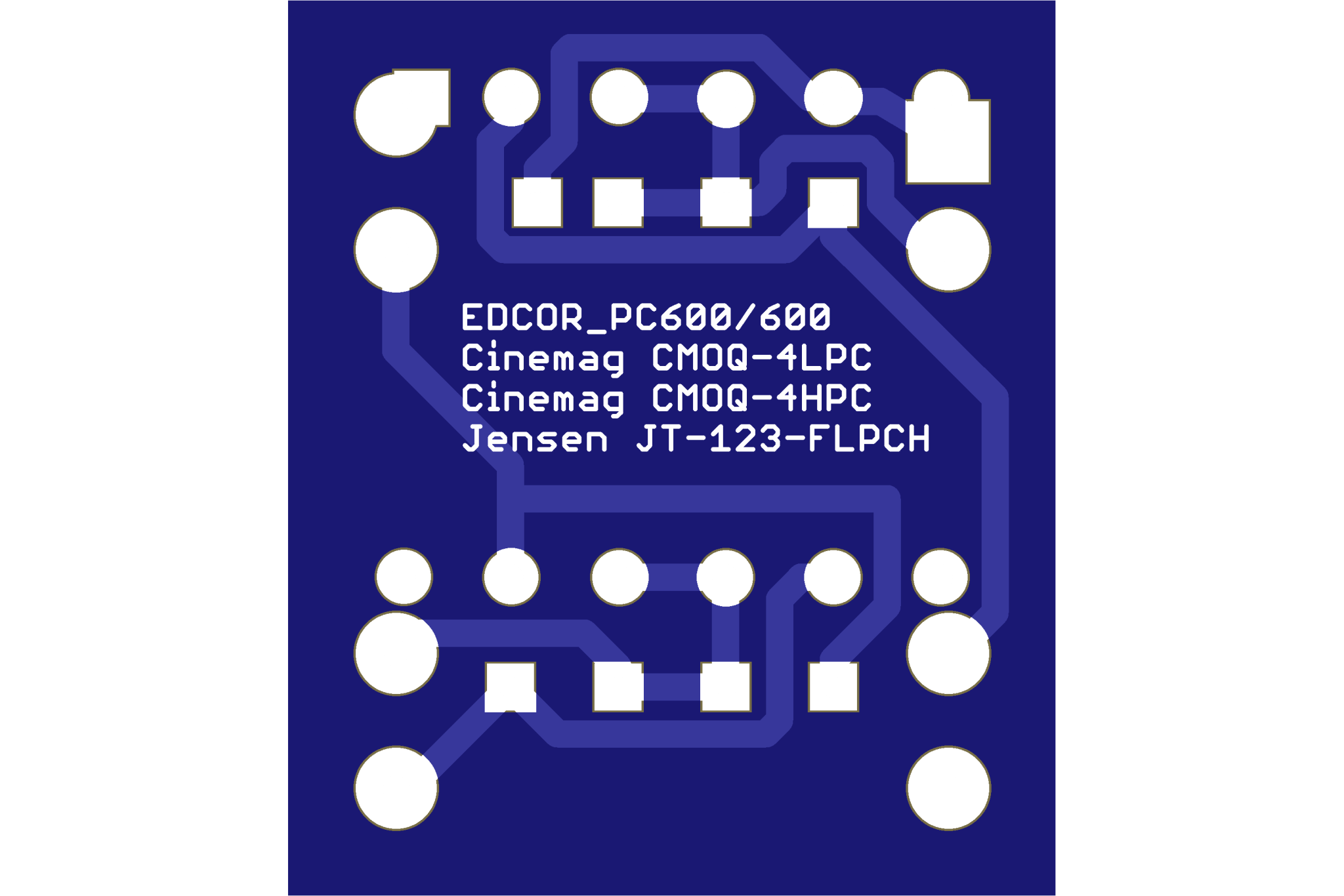

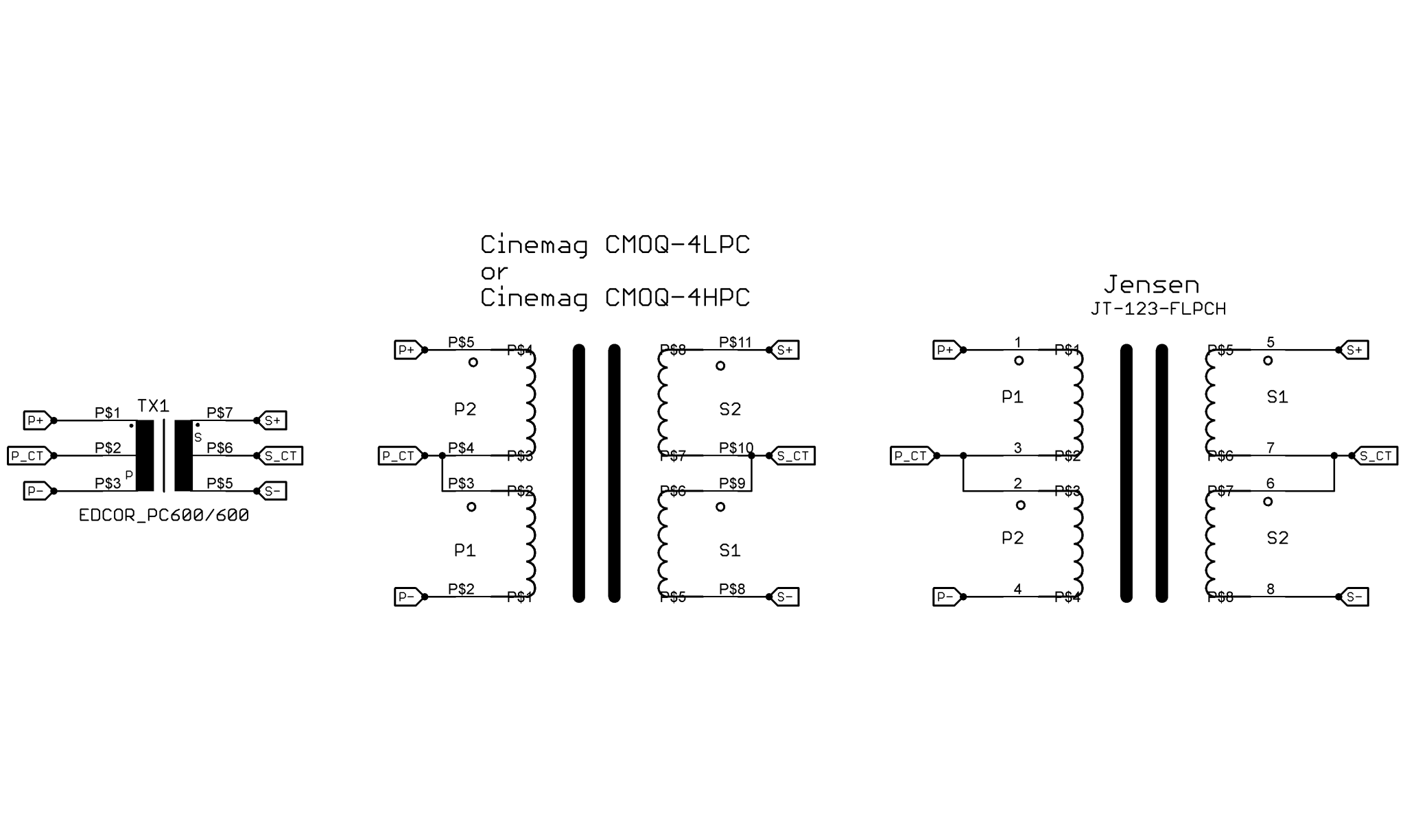

I have not done a direct comparison between the Jensen and the CineMag transformers. They are both quad-filar with four equal windings wound onto the same core, and both are intended for the highest audio performance applications. I suspect differences will be a matter of personal preference.
Mighty ZenMod has the ability to use three (Jensen, Edcore and Cinemag ) transformers on some of his boards.

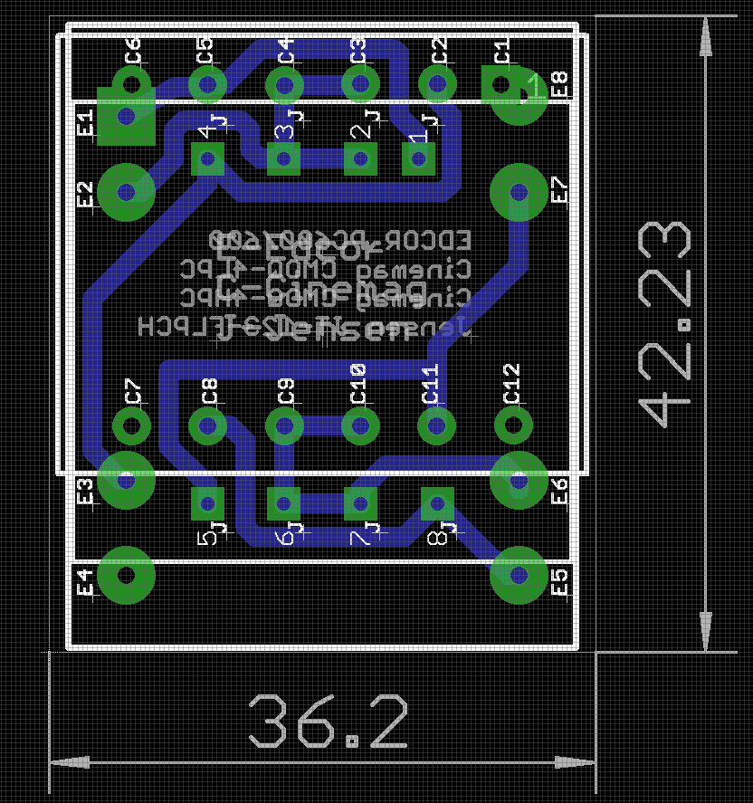

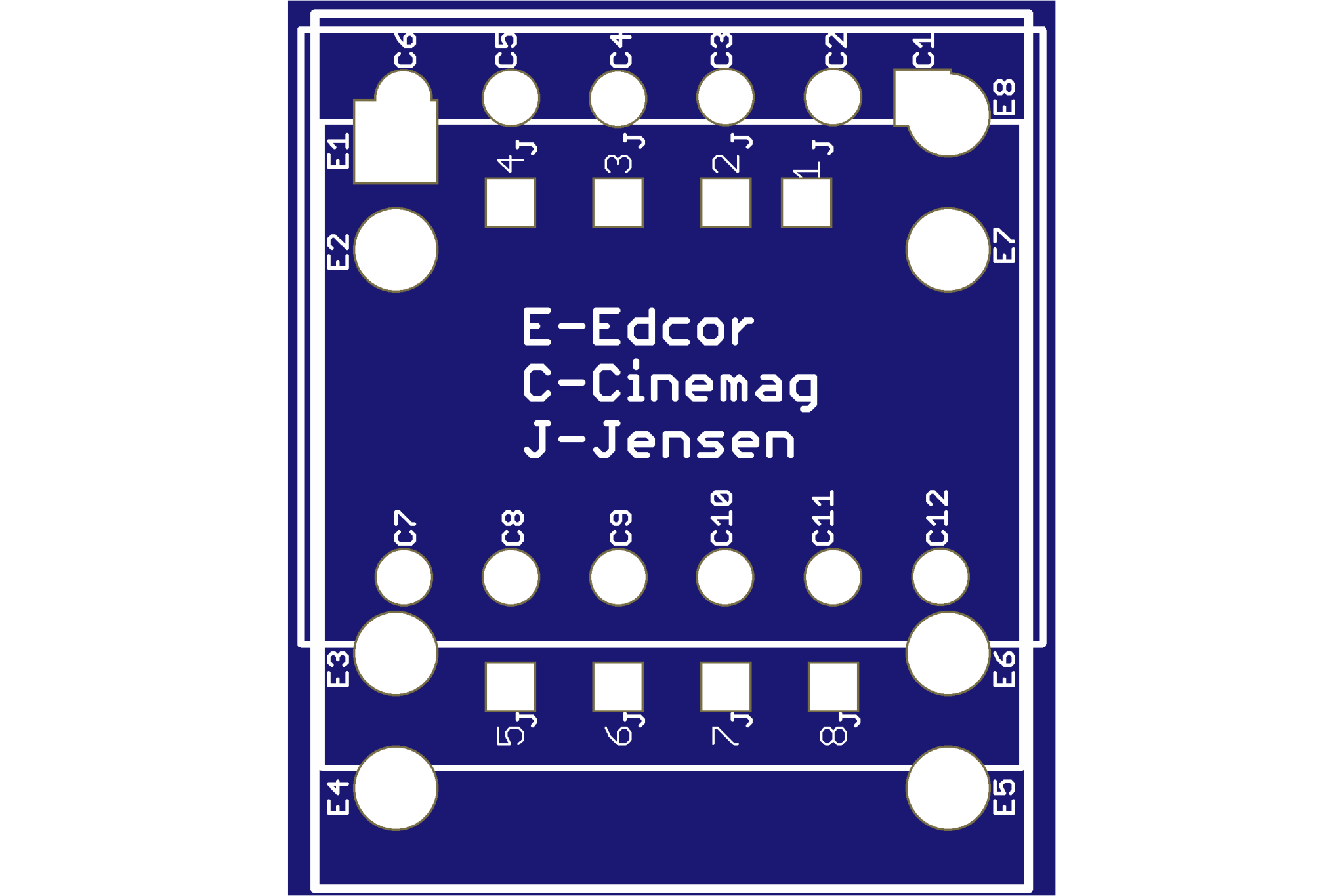

Would it be possible for someone (not me) to design and possibly make a daughter board to plug into the store F6 board to allow the use of the other similar transformers?
