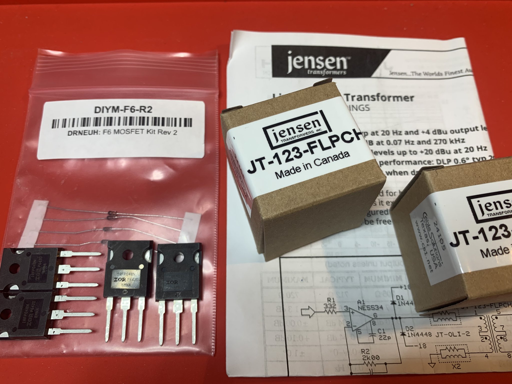

Building the jfet version. I am getting high voltage to the led bank closest to the V+ terminal. just flicking the power switch I see 13 plus volts and climbing. It appears my Irfp150 is fine and r7 is 3.3k ohms. Any ideas?
Update, I had that bank of LEDs in backwards. It will bias properly but I still have 23 volts going to the single led power indicator now

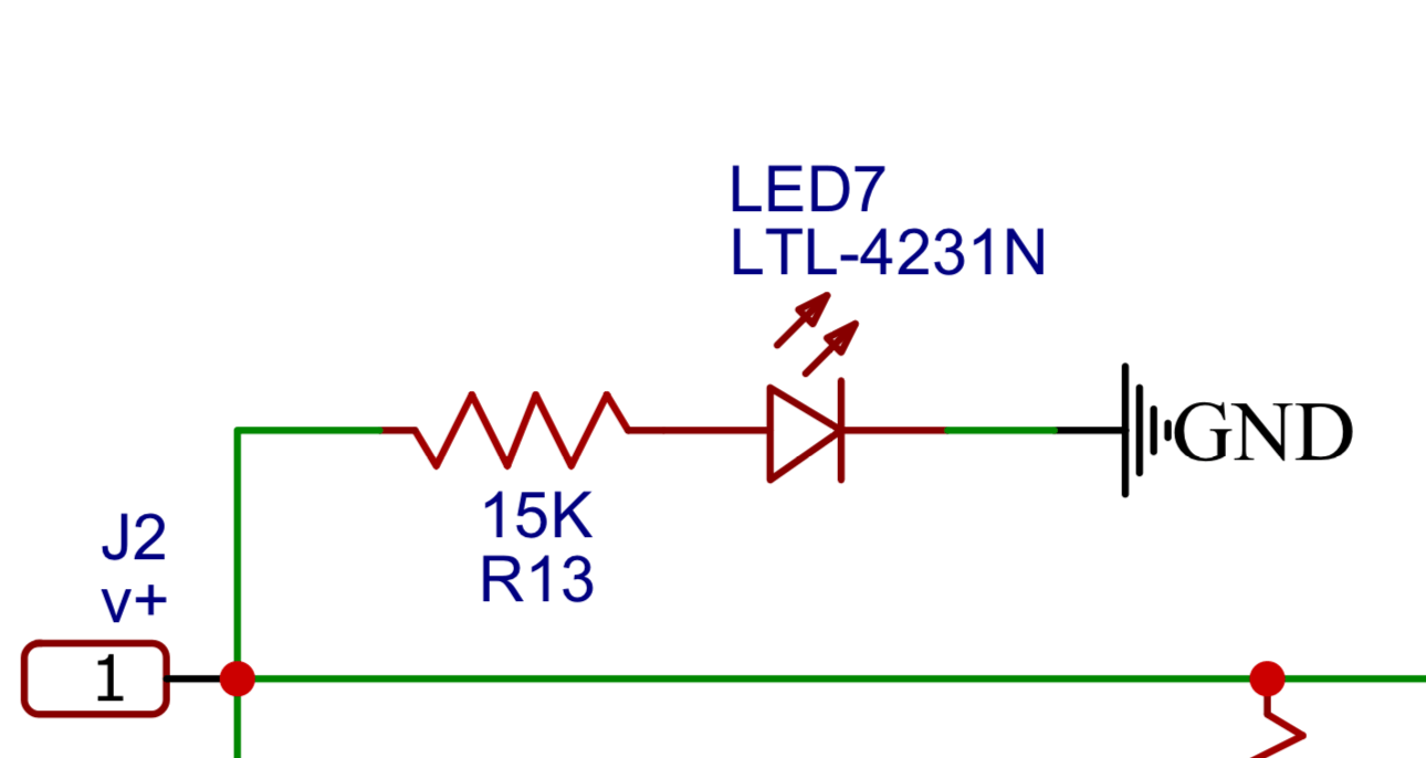

I don’t think I understand or see if you have a question.
V+ should be about 23V, and it should be connected to R13 which limits the current to LED7. If LED7 is oriented properly it will light up. If not, flip it or replace it if it is already correctly oriented (anode connected to R13 and cathode connected to ground). If it is too bright, try R13=20K or higher.
Anode of LED7 is typically the long lead and cathode is the short lead. If in doubt, test it using a DMM or transistor tester.
LED7 serves no purpose in the circuitry other than being an indicator light.
Best,
Anand.
Thank you, I rushed my post, I went through the schematics like you posted. My problem was that I installed the one bank of LED's reverse polarity. Then due to my lack of basic understanding of electronics I was confused that I was getting 23v on either side of R13. once I installed LED7 it shows 1.7 volts after R13. Off to cook and set final bias and dc offset

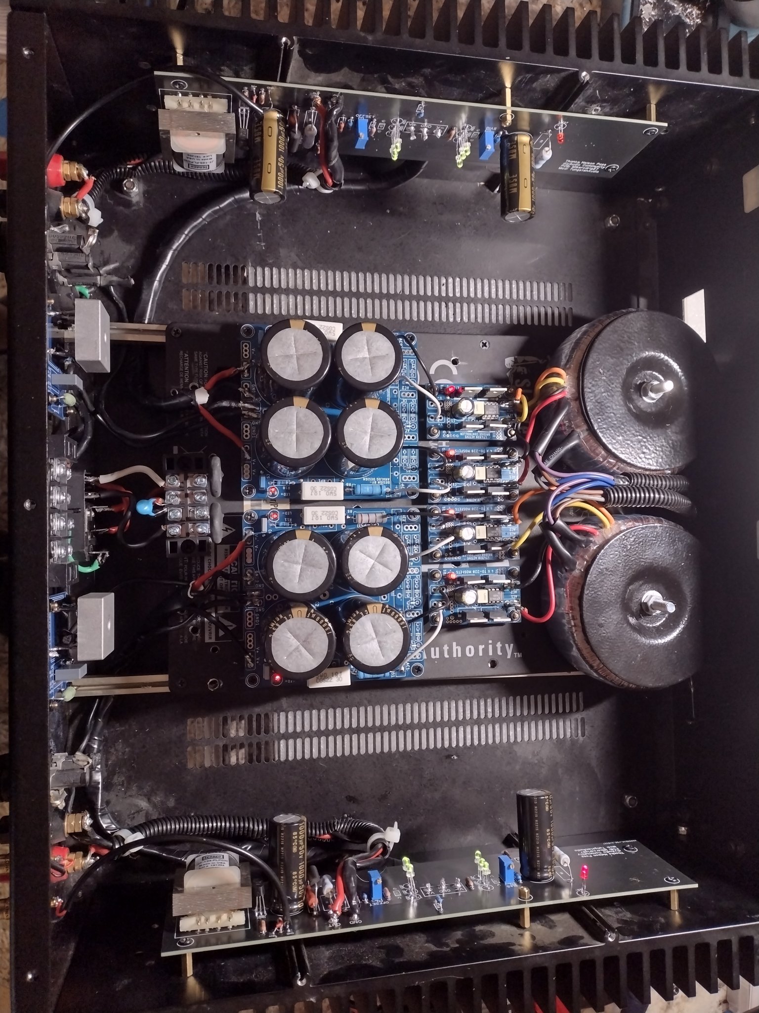

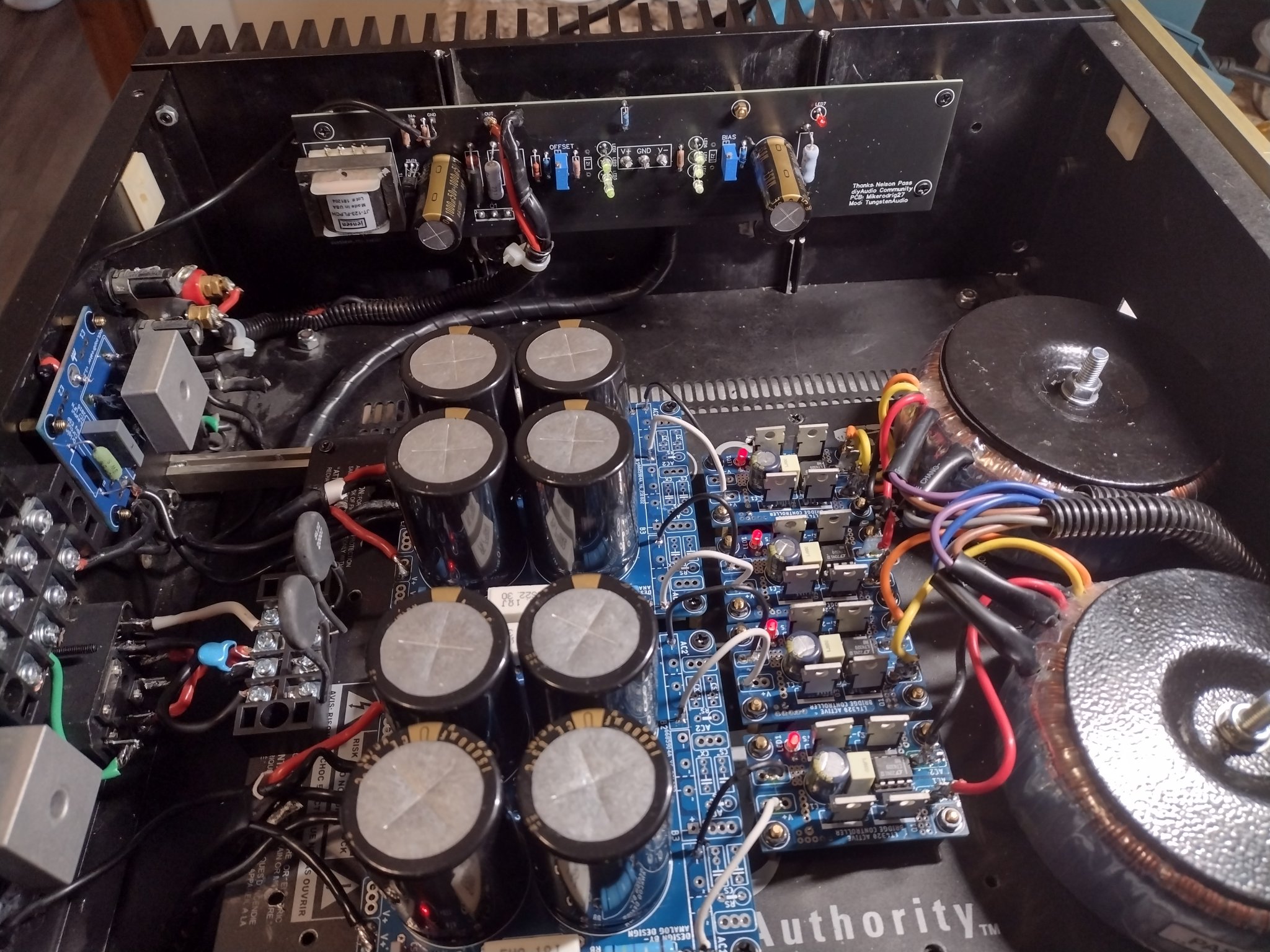

I originally installed a F6 clone board I bought off Canuckaudio mart in this repurposed chassis. From day one the single antek transformer I used had an audible hum in the speakers and at the actually transformer itself. I tried changing out the bridge rectifiers and the cap banks trying to fix the problem. I then traded out the single antek for dual smaller triads. I tried a different grounding scheme, and still it hummed. I thought I would try the these reworked F6 boards to see if that helped anything and it still hummed. So redid the power cord and switch, basically removing the front factory switch and just using a switch on the rear. So far the hum is completely gone. I have limited understanding and try to look at pictures people post in these threads to help with my builds.

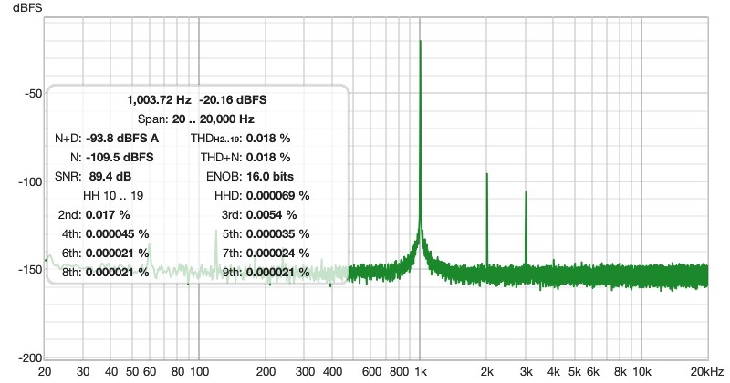

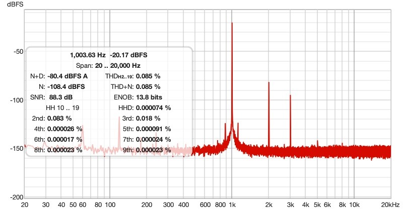

Just finished the build and testing with REW, and I see that I'm getting much higher second and third order harmonics than I had with my F6 from DIY-Audio. The F6 from DIY-Audio uses the Jensen transformer and IRFP240 MOSFETs; the F6 Diamond uses the Cinemag transformer and IXTQ75N10P MOSFETS; both are on the same +-22V power supply and biased to 600mV across R2 and with the same test setup: running 1 watt into 8 ohms with a 1 khz signal. Green is the F6 from DIY-Audio, and red is the F6 Diamond. Not sure where to start troubleshooting, so any pointers are appreciated.
Yeah... I'd look at the grounding, and wiring in general... It wouldn't hurt to check the output (loaded output, with and without input signal present) for oscillations... broad spectrum.
Of course, the photos would help immensely, so that we do not have to hunt in the dark...
It sounds fine to me, so maybe "troubleshooting" is the wrong word. It's a more a question of learning. I'd like to understand why my F6 Diamond has higher second and third harmonics than my F6 from DIY Audio. Also, the non-harmonic spikes, which is especially puzzling to me, since I used the same power supply and everything else connecting to/from the board in both cases - just swapped the two boards in and out.
Reactions: Jacruzer787
My advice is to read the F6 talk by Nelson here. You will see how he discussed output degeneration resistors and input degeneration resistors. You will also see that Tungsten specifically implemented output degeneration changes to get a second harmonic level that he likes with his system after I am assuming several experiments. And not to mention these are different N-ch Mosfets ((the 75N10P has higher transconductance)) than the diyaudio version which used the IRFP240 . And both are different from the original SJEP power JFETs discussed in Nelson's F6 talk.
Although the use of Cinemag or Jensen phase splitting transformers along with the Austin buffer input stage have low distortion overall, the dominant distortion element here might be the output stage including the Fets themselves and the potpourri of degeneration resistor choices. So experiment away and let us know what you find.
