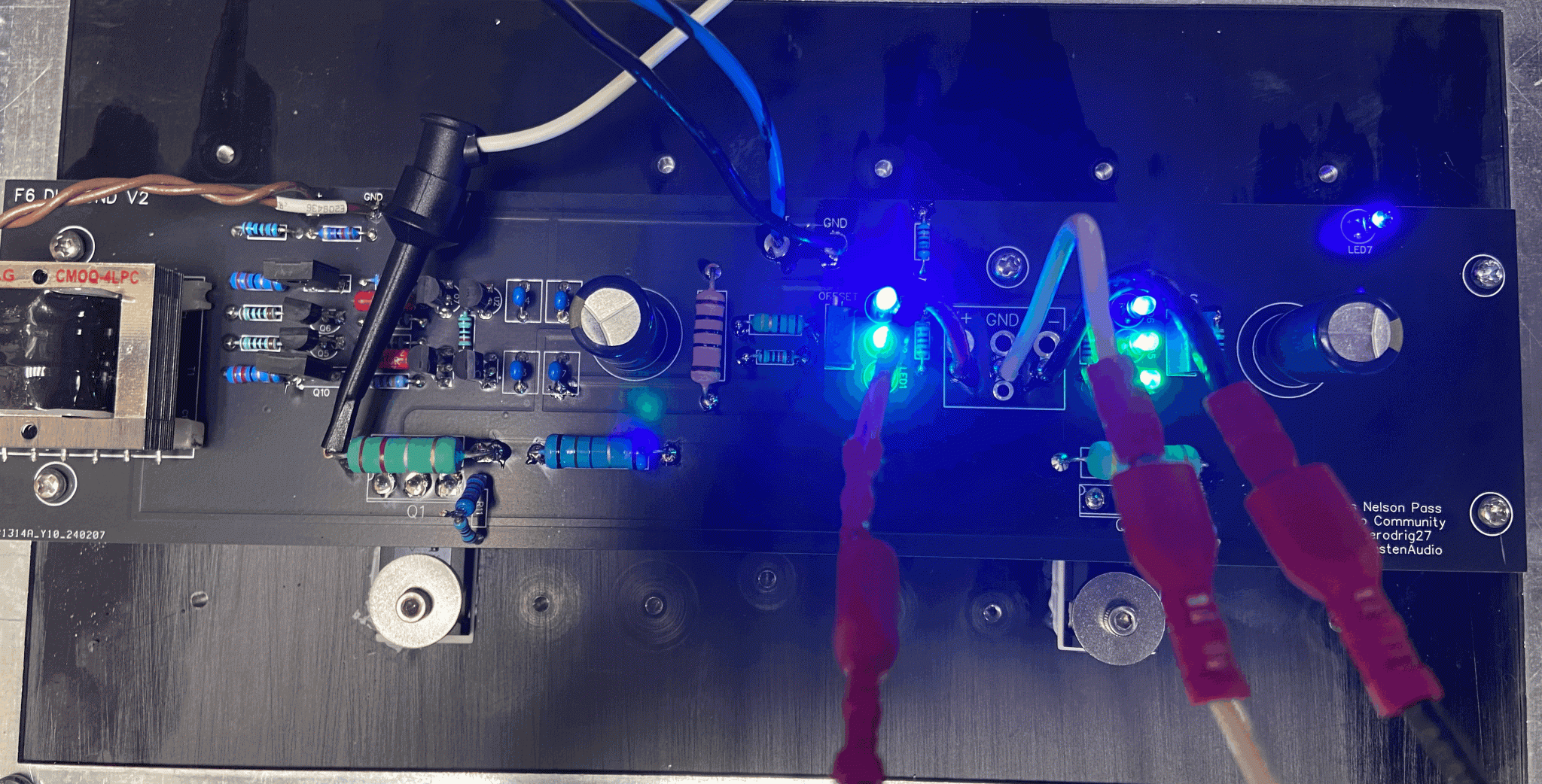

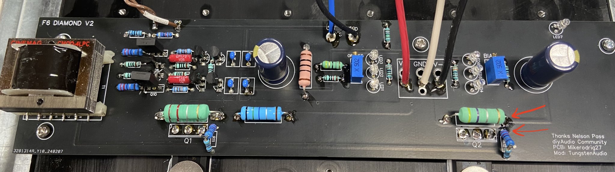

I'm having an unexpected issue biasing the F6 Diamond amp on my work bench. The left channel has biased just fine, to 0.506 VDC. The right channel, on the other hand, biases up to about 0.400 VDC and then drops to zero and starts biasing up again to 0.400 VDC, over and over. I don't know how to interpret this and have no idea how to proceed. Your counsel is appreciated.

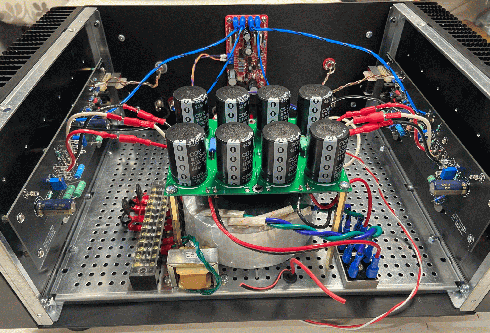

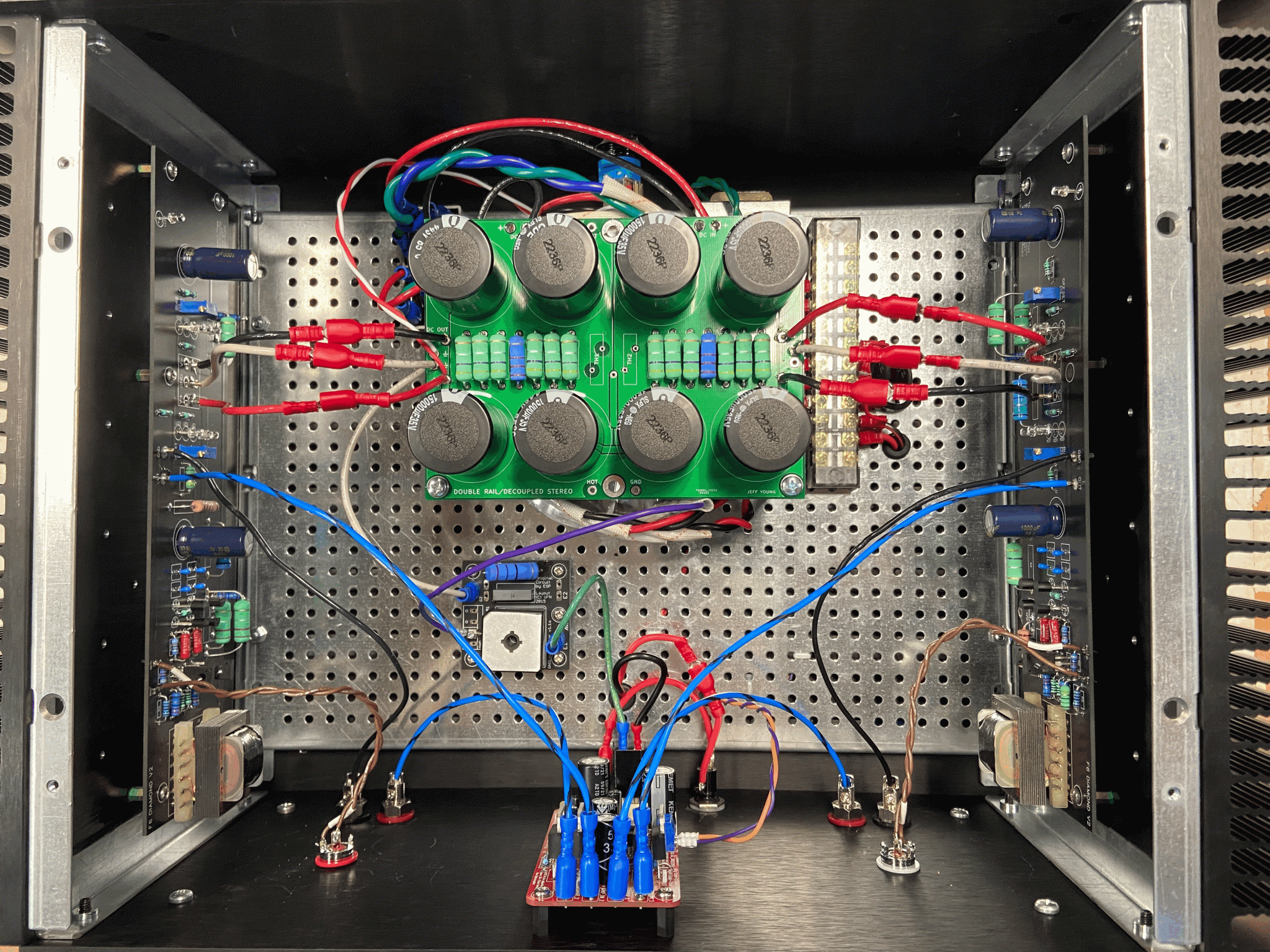

I am having a difficult time seeing how this construction is working at all.
First remove that module from the middle of the backplate. Eliminate it completely.
It is possible to use a single bridge rectifier, but I am not sure you have wired this correctly. Try using two bridge rectifiers - one for the positive input to the CRC board, and the other for the negative input.
...And one for the ground lift board... which you're probably looking at. 🙂 Follow the wiring from the DC input of the filter boards to the left for the bridges.It is possible to use a single bridge rectifier, but I am not sure you have wired this correctly. Try using two bridge rectifiers - one for the positive input to the CRC board, and the other for the negative input.
Reads like a cap charging/discharging. What are the rails doing?
Scott - What you may consider is powering the board with the symptoms from the other side of the PSU and vice versa one channel at a time. Since you're using spades, maybe just build up quick extra section of wires to lengthen the V+, V-, and GND from the PSU to the board(s) on the opposite side.
For a few minutes work, that could narrow down where to look by a decent margin. If the issue "follows the amp board", you look one way... if it follows the 'side' of the PSU (seems less likely to me... but who knows?), you look another.
While your at it, connect IEC Earth GND directly to chassis, remove purple trafo shield wire from GLB board and connect to the same bolt as Earth ground.
Folks:
The module on the back panel is a speaker protection board (Prasi released it recently; it's based on the Store's version but updated to use solid state relays). The bridge rectifier towards the lower middle of the first photo is a ground loop breaker. There are two bridge rectifiers trucked close to the toroid, under the power supply. The small transformer simply powers the speaker protection board.
The toroid is an Antek AS-4218. The power supply board is producing +/- 23.37 VDC. When I initially biased the amp, both channels read about 0.503 VDC across R2. I dialed the offset down below 1.2 mV on each channel. I installed the amp in my main system and both channels worked, but the right channel was noticeably quieter than the left channel. I then returned the amp to my work bench and checked the bias, which was when I saw the cycling bias reading across R2 on the right channel.

@SRMcGee
This isn’t a problem with the input stage/Austin buffer. It may be an intermittent connection/poor soldering somewhere.
I would concentrate on the DC setpoints of the output stage for the offending channel, which also means the DC bias circuitry which involves pins 5,6,7,8 of the transformer as well (see schematic below, the pin numbers might be different for Cinemag vs Jensen). You should be able to verify continuity of this entire circuit.
I am assuming that you substituted one blue LED for the green LTL-4231N diode since you are using the IXTQ75N10P N channel Mosfets which is fine.
Can you measure the voltage across the outer pins of each of the Mosfets? Is C1, C2 oriented properly? Are all the diodes lit, all the time? What are the voltages at the wiper end of the pots, i.e. where R9 and R10 connect?

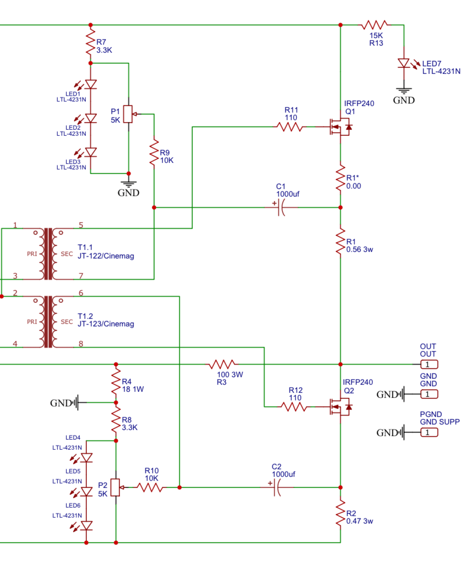

Anand & Co.:
I've resoldered every accessible connection on both sides of the right channel pcb and the problem persists. I'm using IRFP240 MOSFETs, not IXTQ75N10P, because I have a huge stock of matched units, but I still installed one blue LED (along with 2 green) in both banks. All six of those LEDs light (as does the seventh on the pcb). C1 and C2 are properly oriented. The input is shorted.
I'm getting 4.3 VDC measuring across Q1 and 4.28 VDC across the outer pins of Q2.
I'm getting 5.64 VDC measuring from the proper end of R9 to Input Ground, and 18.32 VDC measuring from the proper end of R10 to Input Ground.
From the anode on LED1 to the cathode on LED3 there is 7.85 VDC; the same across LED4 to LED6.

@SRMcGee
My surmise at this point is that you have enough forward bias voltage to “turn on” your Mosfets since your Vgs for Q1 and Q2 are about 4.3VDC. Double check with the other channel just to be sure. See if there is a major difference between the two channels.
If you leave your multimeter across the outer pins of the offending channel’s Q1 and Q2 (you need 2 multimeters for this), does the voltage remain steady or does it change?
That leaves the question on which one of your Q1,Q2 mosfets is misbehaving.

Anand & Co.:
There is no major difference between the voltage across the MOSFETs on the two channels -- the right channel reads roughly 4.3 VDC across the outer pins on both devices and the left channel reads closer to 4.4 VDC. I would note that the bias on the right channel undoubtedly needs adjusting at this point.
The voltage across both MOSFETs on the right channel steadily increase to about 4.3 VDC in about 20 seconds after power is turned on. Same with the left channel.

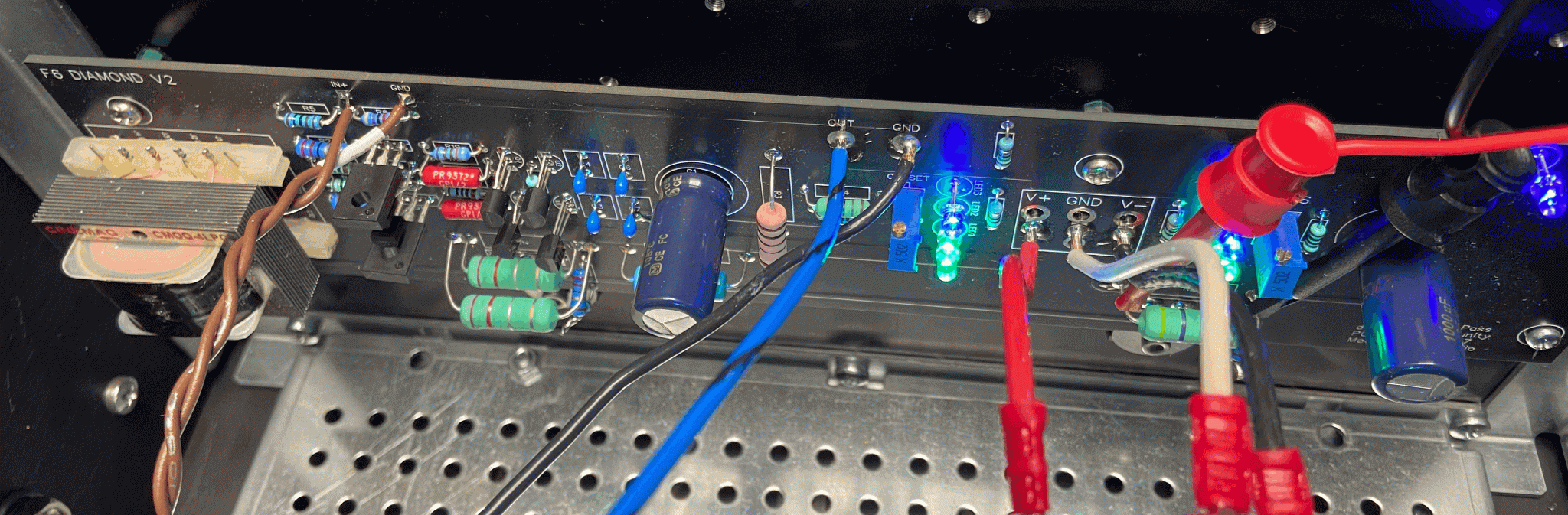

This may be relevant: I tried measuring VDC across R2 and R12 instead of across the outer pins on Q2 at the spots indicated on the photo below because I had easier access to the resistors. While the voltage across Q2 remained steady, the voltage at the resistor leads bounced all over the place.
I have more matched pairs (and quads) of the IRFP240 MOSFETs. I'd be happy replacing both if you thought one or both were the issue.
Your thoughts?

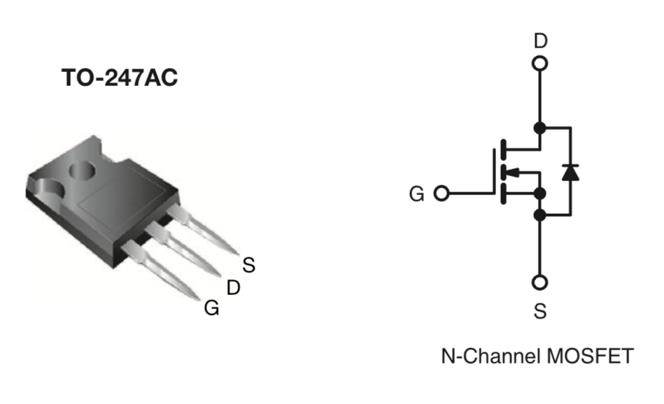

Go ahead and try replacing both, and also measure the Vgs voltages of Q1 and Q2 by only placing the multimeter leads on the outer pins of the mosfets. Please leave enough "lead" on the Mosfets themselves so you can use clip leads from your multimeter so you don't accidentally slip and create a short. See if replacing the Mosfets solves your problem. Double check and make sure there is good electrical isolation along with thermal conduction particularly with the back of the MOSFET which is connected to the Drain pin.
Using the proper end of the resistors for measuring Vgs is probably fine, however, this is faster as you don't have to keep double checking the traces on the pcb which are extremely difficult on black pcb's or when you don't have the trace layout printed in front of you. Hope that makes sense.

MOSFETs swapped out for a fresh matched pair and the amp is singing beautifully! Thank you for the help -- I'm no diagnostician and, Blanche DuBois-like, have to rely on the kindness of others. Your support and guidance were crucial. If we both find ourselves at BA2024, please let me buy you a beer.
