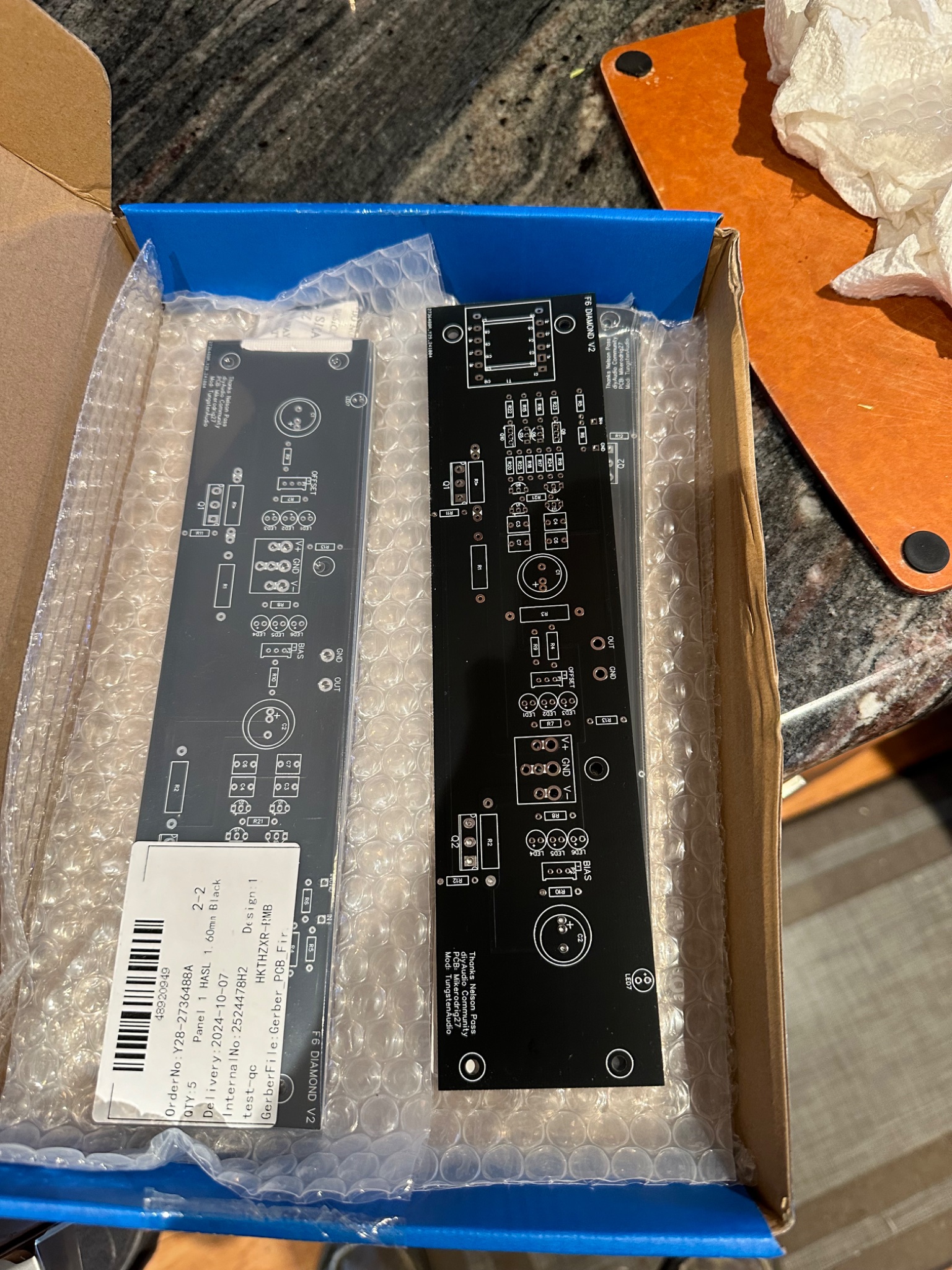

Writing subjectively about the sound of a tweaked amplifier becomes even more challenging when experimenting with alternate output devices. That has been where my efforts have been for quite a few months. Some will recall that my original F6 used the FQH44N10 Mosfets in its output stage. As those became difficult to source, I tried a few others. The JFet version of the F6 revisited was built with IRFP048. The Diamond buffer version started with the FQH44N10, then another set of boards was built with the XTQ75N10P.
Given the F6 Diamond configuration, both the FQH44N10 and IXTQ75N10P sound open and transparent, with the liveliness that I have come to appreciate with the higher transconducdance Mosfets. Differences lie mainly in the subtleties of harmonic structure of instruments and some smaller details of imaging. I run these with a 'hot' power supply of +/– 26.5V. Adventurous DIY enthusiasts can try the same configuration without fear of melting anything, as long as bias current is kept withing 1.8A or less. In practice, I have found little to no sonic improvement with bias above 1.65A, so that is where my amps are operating these days. I have a tube of IXTQ36N30P that will also be pressed into service. Some of these already made into my F5m, with results so favorable that I haven't been willing to take that amp out of my system for several months. In the case of the F5m, I found it necessary to voice the amp differently using gate stopper resistors, as the IXTQ parts sounded slightly shrill until I did so.

What about adding these F6R boards to the store? 🙂
No real panic or hurry, but i am curiously contemplating to build these JFET F6R versions after my Tokin SIT-amp builds.
I would be fine with that. I would also be willing to make a few changes to accommodate the stores needs.
