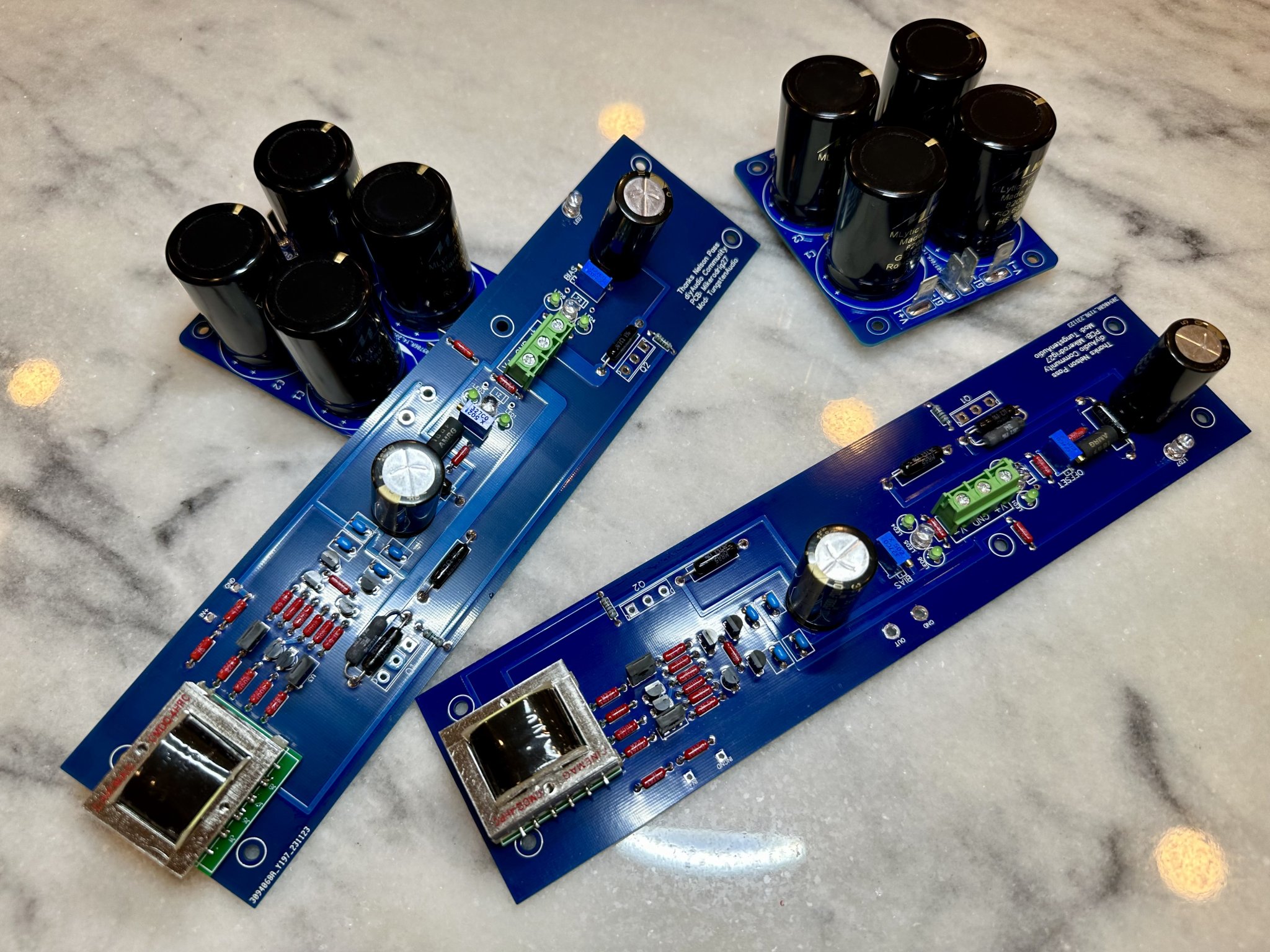

New additions to the NPXP coming soon…
Best,
Anand.
Reactions: 10 users
Very nice looking boards. Those red resistors look spiffy! What brand/model are those?
Those are PRP brand. Only went with them instead of my usual CMF 55 because all the values were available and come 1% stock.
Other resistors in the build include Takman metal film (gate resistors) and Mills (feedback, source) and AMRG (feedback).
The caps are Elna Cerafine.
All transistors are matched on a PeaK DCA75 with the exception to the large TO-247 N-channel on the outputs.

Well, at the end of the day, it’s the design topology that really counts. Let’s see:
  • Austin Buffer
  • Cinemag CMOQ transformer (high nickel version)
  • Choice of FET (i.e. IXTQ75N10P)
  • Amount of Bias (more the better)
  • Provision for output degeneration done with Q1, the top FET
The choice of passive parts for me is just eye candy. The constellation of colors looks pretty and it makes amp building less like dialysis.
I do have a QuantAsylum unit that I will press into use to measure the various harmonics. Should be fun.
Thanks again Tungsten for sharing your work.
