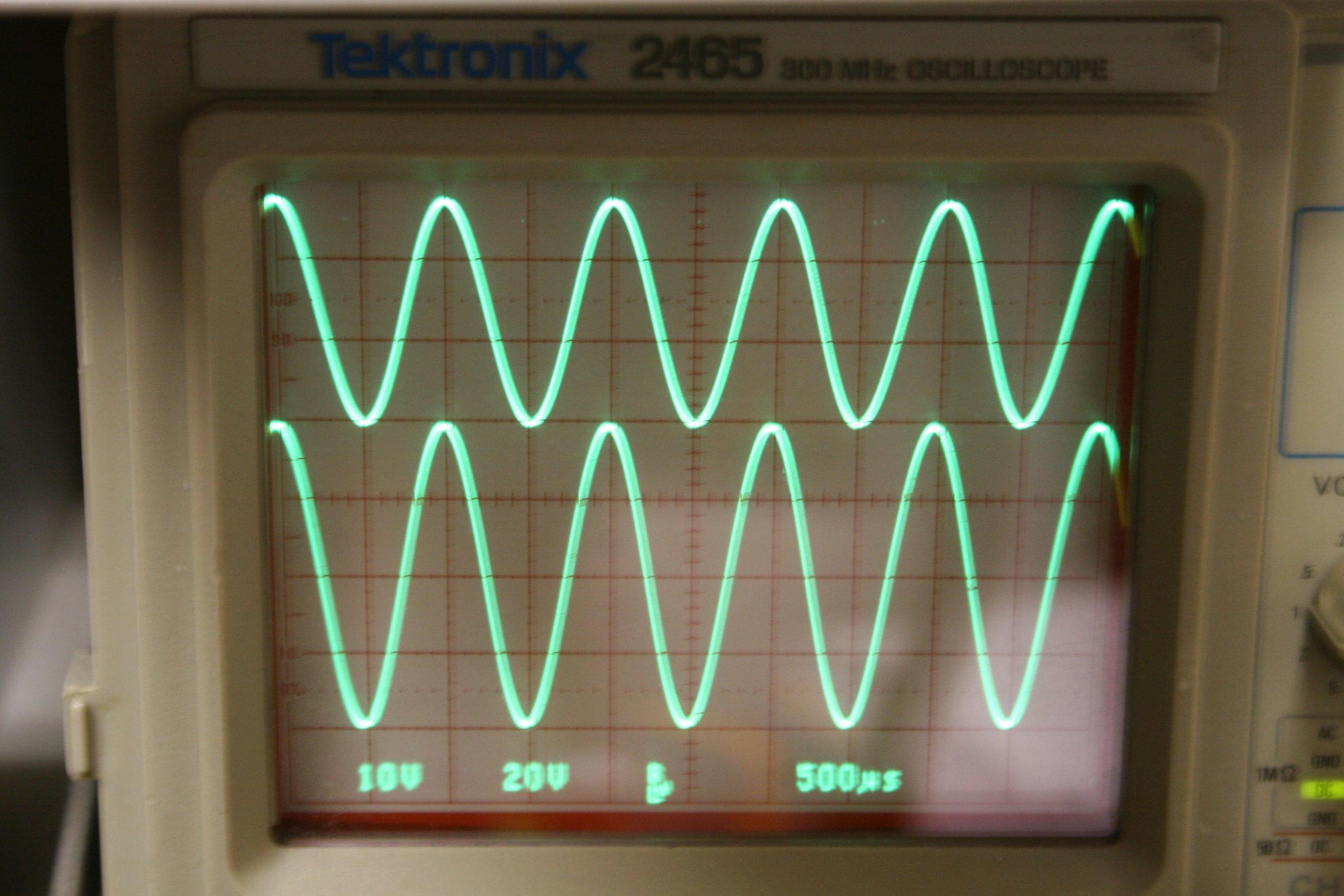

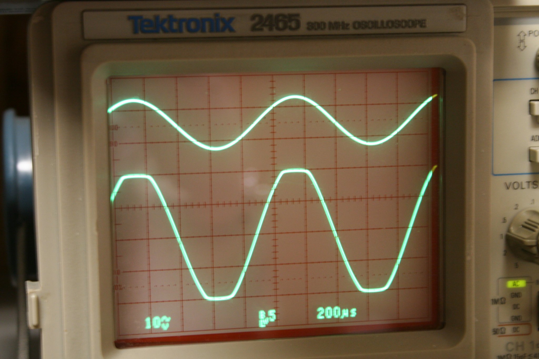

Some pics from the O'scope while hooked up to dummy loads. The first pic is 3.5V PP input (upper trace) and 40V PP just before clipping.

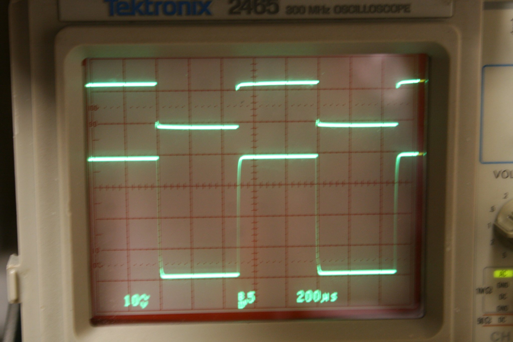

2nd pic is 1Khz Square wave.

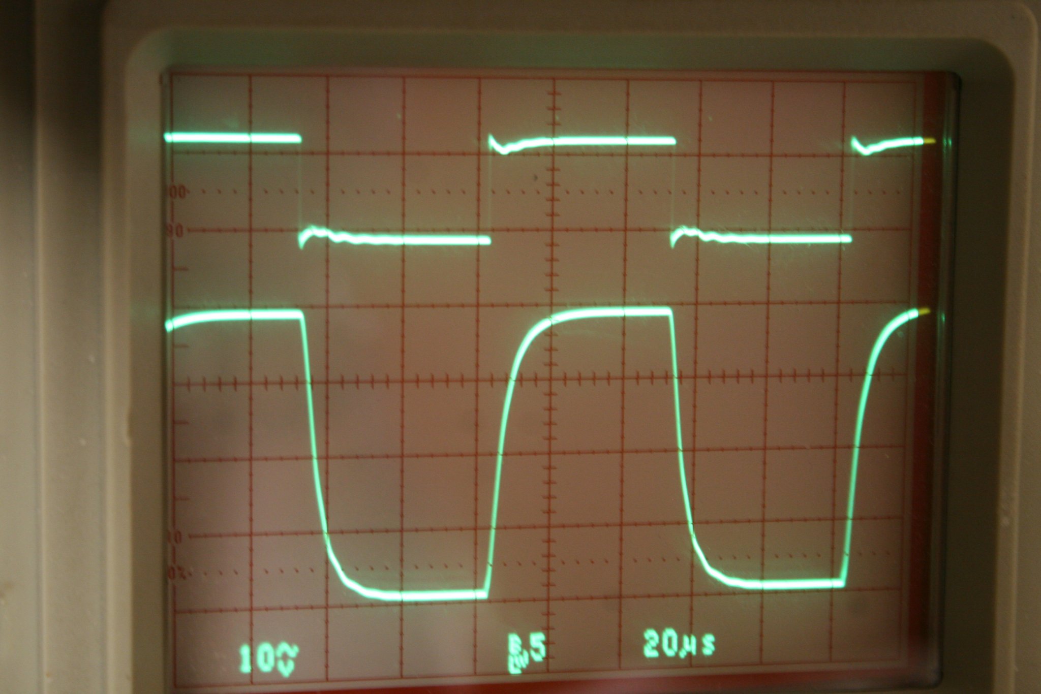

3rd pic is 10 Khz square wave.
Next 3 pics are as follows:

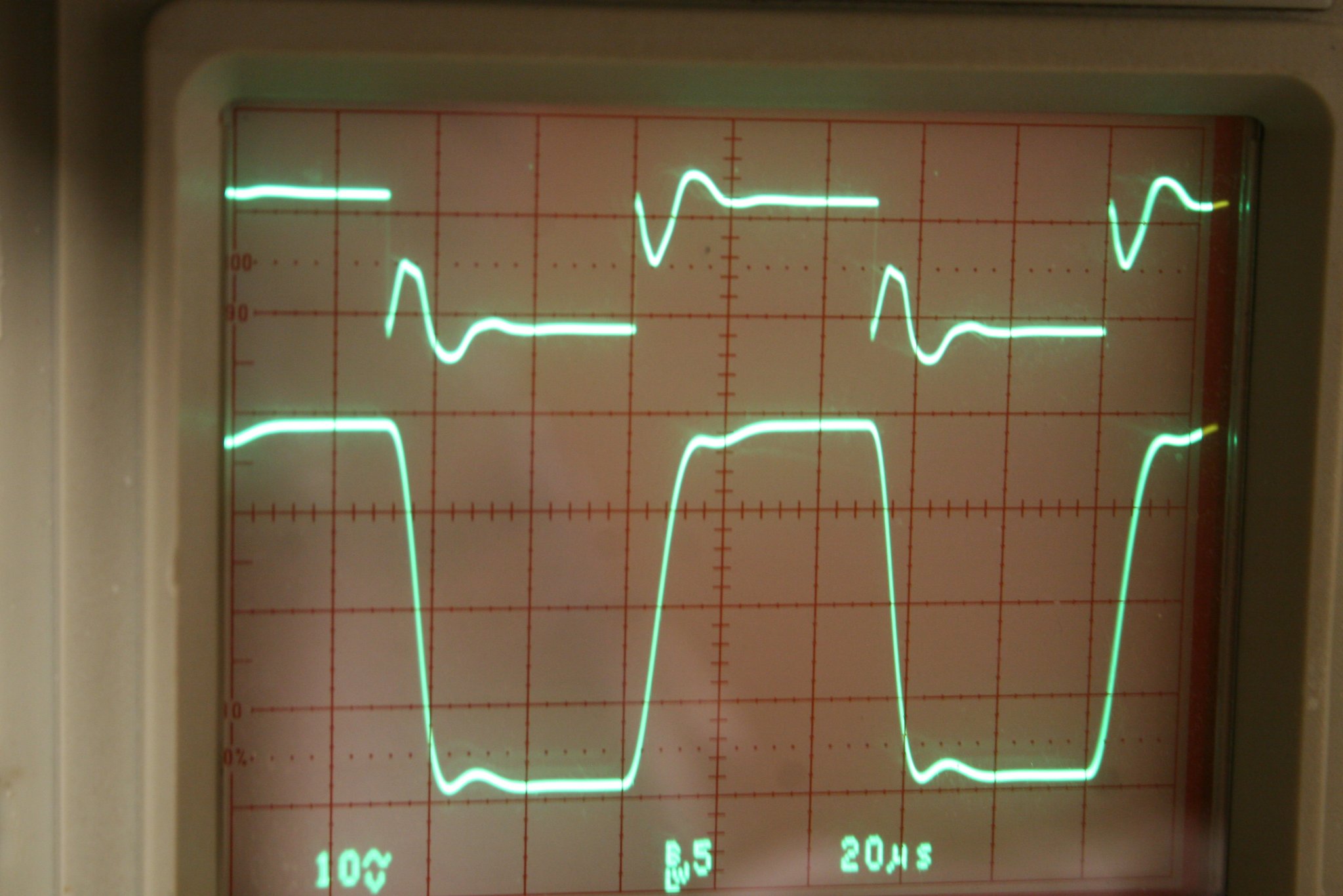

1st: 10Khz Square wave with 2.2uF cap. across 8.25 ohm dummy load. Note the input impedance distortion on the upper trace compared to the previous post.
2nd: 1Khz driven at 4.0V PP to show serious clipping. Note the rounded corners of the clip.

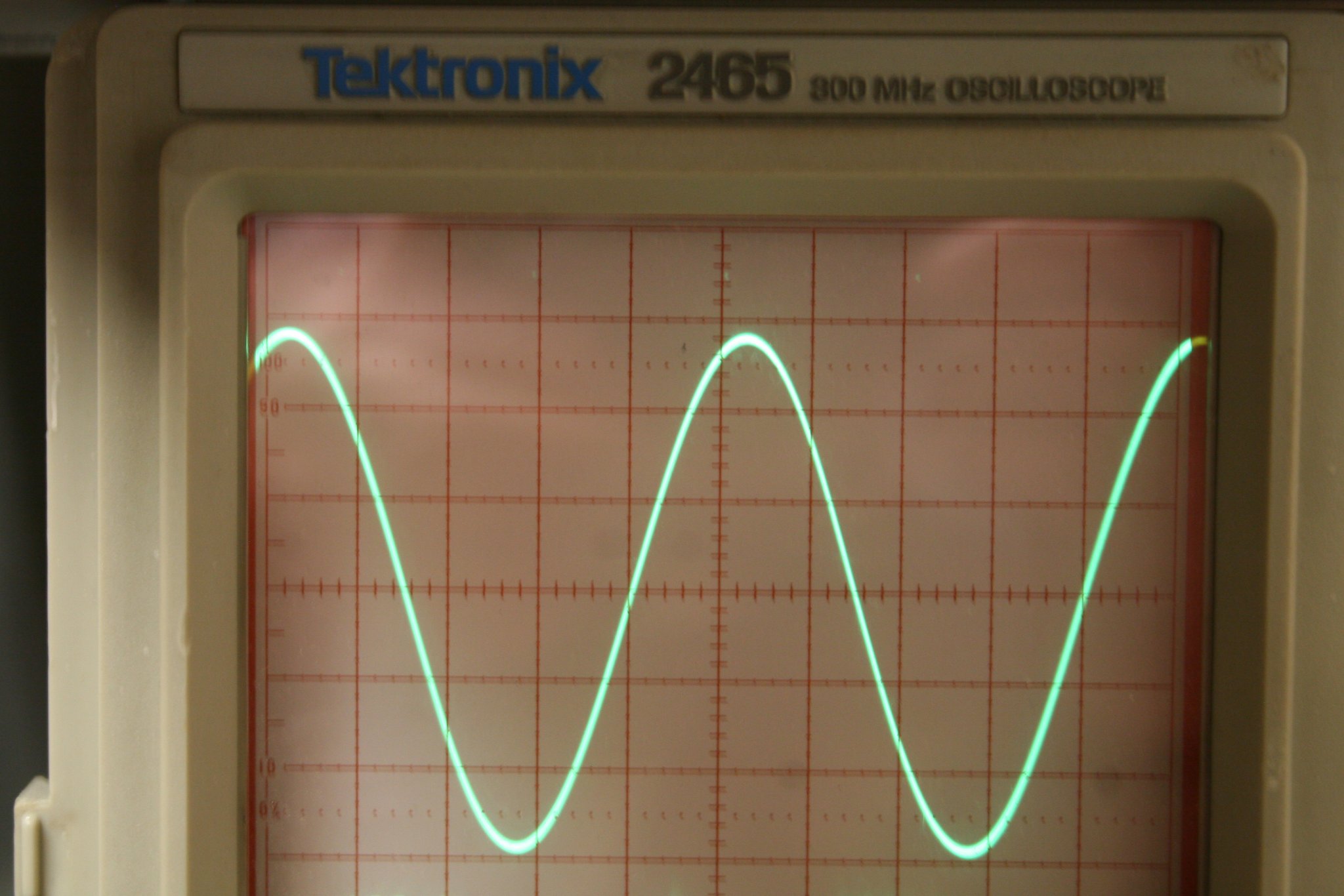

3rd: 1Khz sine wave input 50mv. Nice smooth sine wave, pure class A.
I've listened to it and it sounds perfect. This build used the IRFP240 outputs, 100ohm gate stoppers, 3 green LEDs, 3.3K bias resistors, and input stage per the diamond schematic.

Pretty good behaviour with 2.2uF capacitor || 8.25ohm resistor, especially for 10kHz input. Impressive actually.

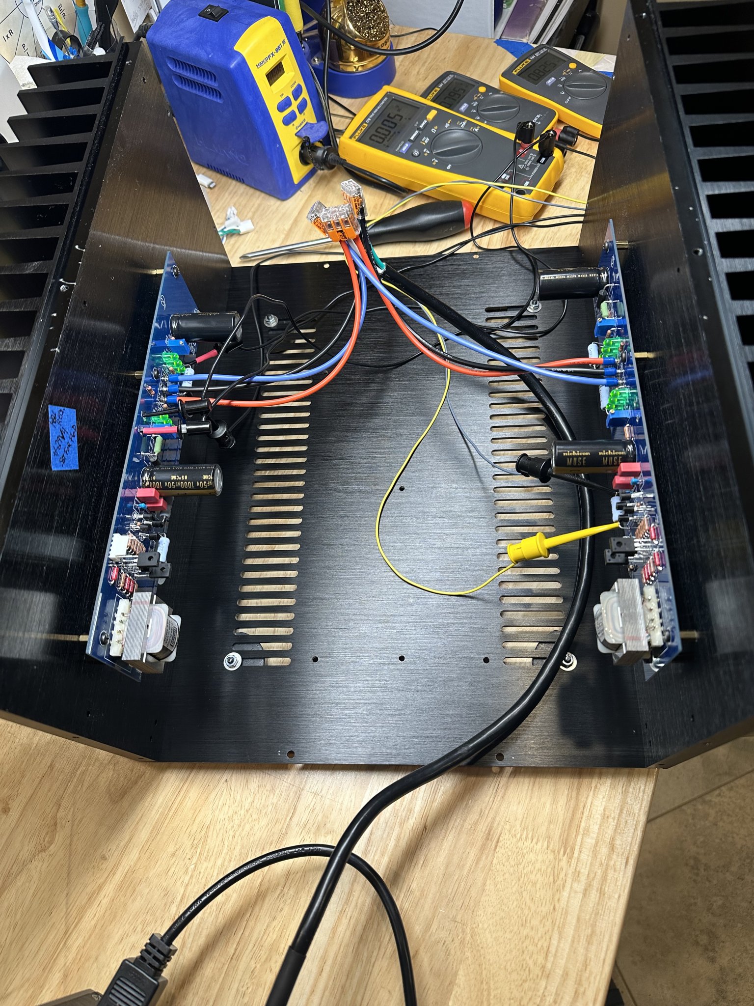

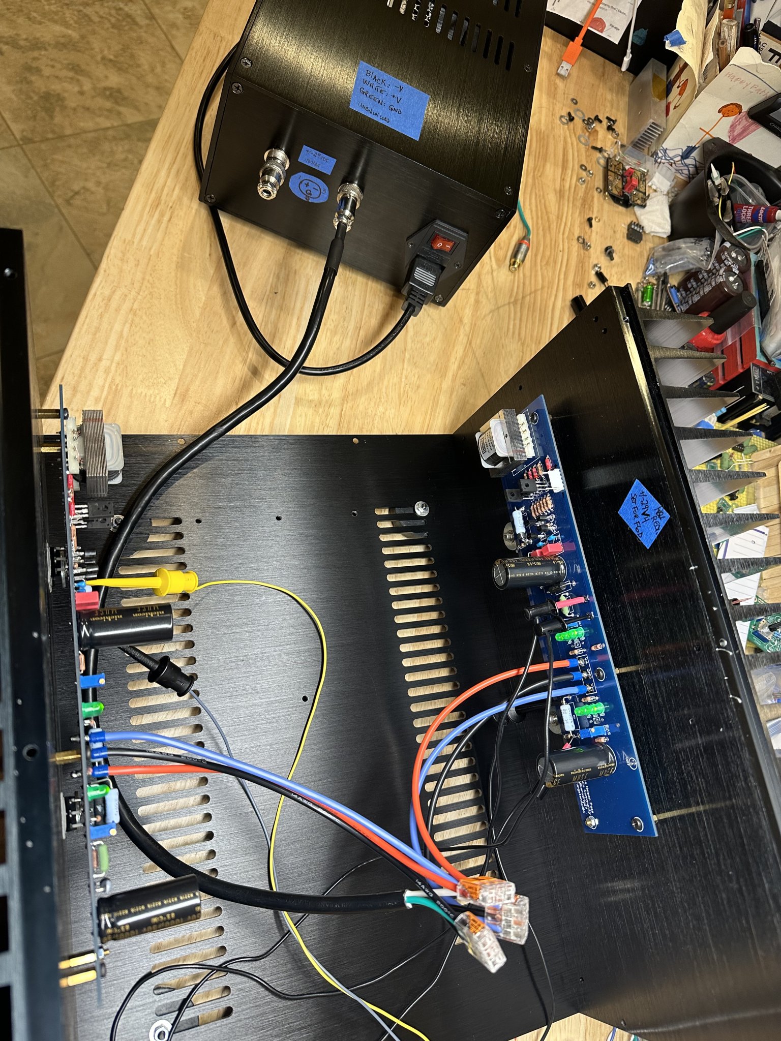

How is this meant to be mounted inside the chassis?
A picture of the board in use would be helpful.

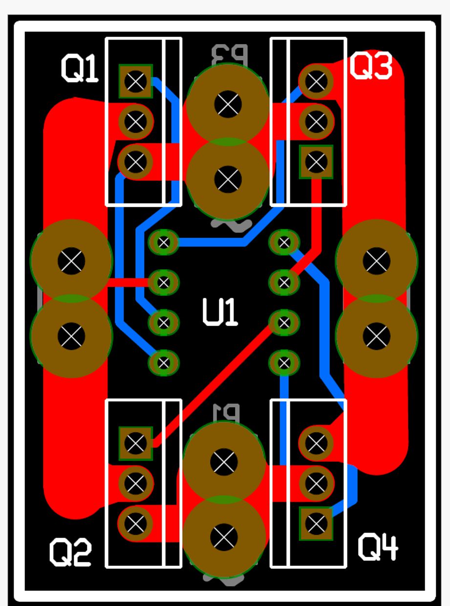

Also missing the required capacitor as far as I can see, which appears in all other designs around here.
Yes, the 0.1 uF cap is essential to power the LT4320. It uses an internal oscillator and charge pump to drive the external Mosfets.
Yes, it was 1.0 uF. My mistake. Ceramic is preferred by the datasheet, and I have also used MMK film with good results.
The choice of Mosfet matters as well. I look for parts with a lower total gate charge, as the LT4320 is actually using a charge pump to drive the Gates. Mosfets rated for 60V Vds are usually easier to drive than those rated at 100V.

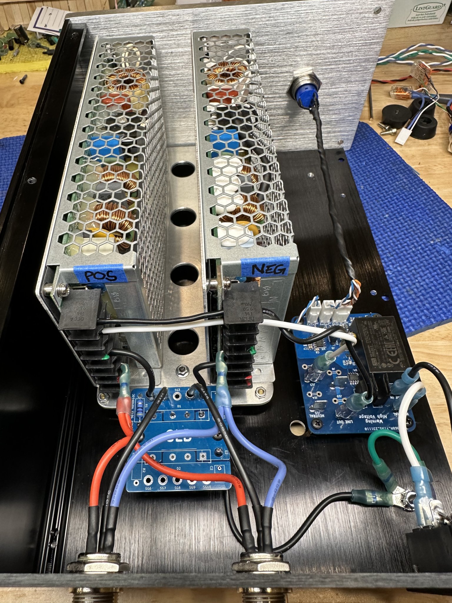

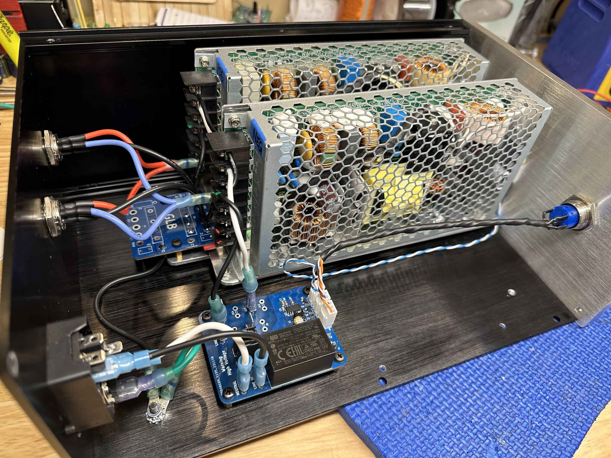

Having the built and ready to go F6D boards on heatsinks sitting on the dining room table waiting for a suitable transformer has been driving me nuts. I just buttoned up an external bipolar psu based on a pair of Meanwell HRP-200-24 smps's and decided to power up the F6D boards. The psu manages to output +/-29vdc with both channels biased at 1.8A. I'll monitor the bias current and offset this evening and then move on to I/O signal wiring. Hopefully first sound this week, Yahoo!
Nice work as usual Vunce. From what I have been reading on various threads in the Pass Labs forum here - the Meanwells might be the way to go. Take up less room, easier, cheaper and just about same overall performance as linear non reg supply.
By the way, what chassis is that you show in the pics?
Ah, this should be interesting. There has obviously been some discussion about the use of chassis mount SMPS in the F5m, and other Nelson Pass designed amps in previous threads. I think much lies in the details of the implementation.
These particular units, the HRP series in 200W, have good chance at being successful, and appear to be very similar to the RSP series. So far this looks like a good start, with a well-defined star grounding point. I worked with the RSP series (200W, 27V) in one of my ACA builds, comparing it directly with an otherwise similar ACA with a linear supply that delivered the same internal rail voltage, following supply rail filtration. The two were very close in sound, but the linear supply version had the advantage in bass impact and extension.
This is not meant to dissuade one from working to find a better implementation of a chassis mount SMPS. I simply didn't have the correct recipe for this build. Other projects were calling my name (DIY Sony VFET amp, etc.) and I moved on before further work with that ACA.
