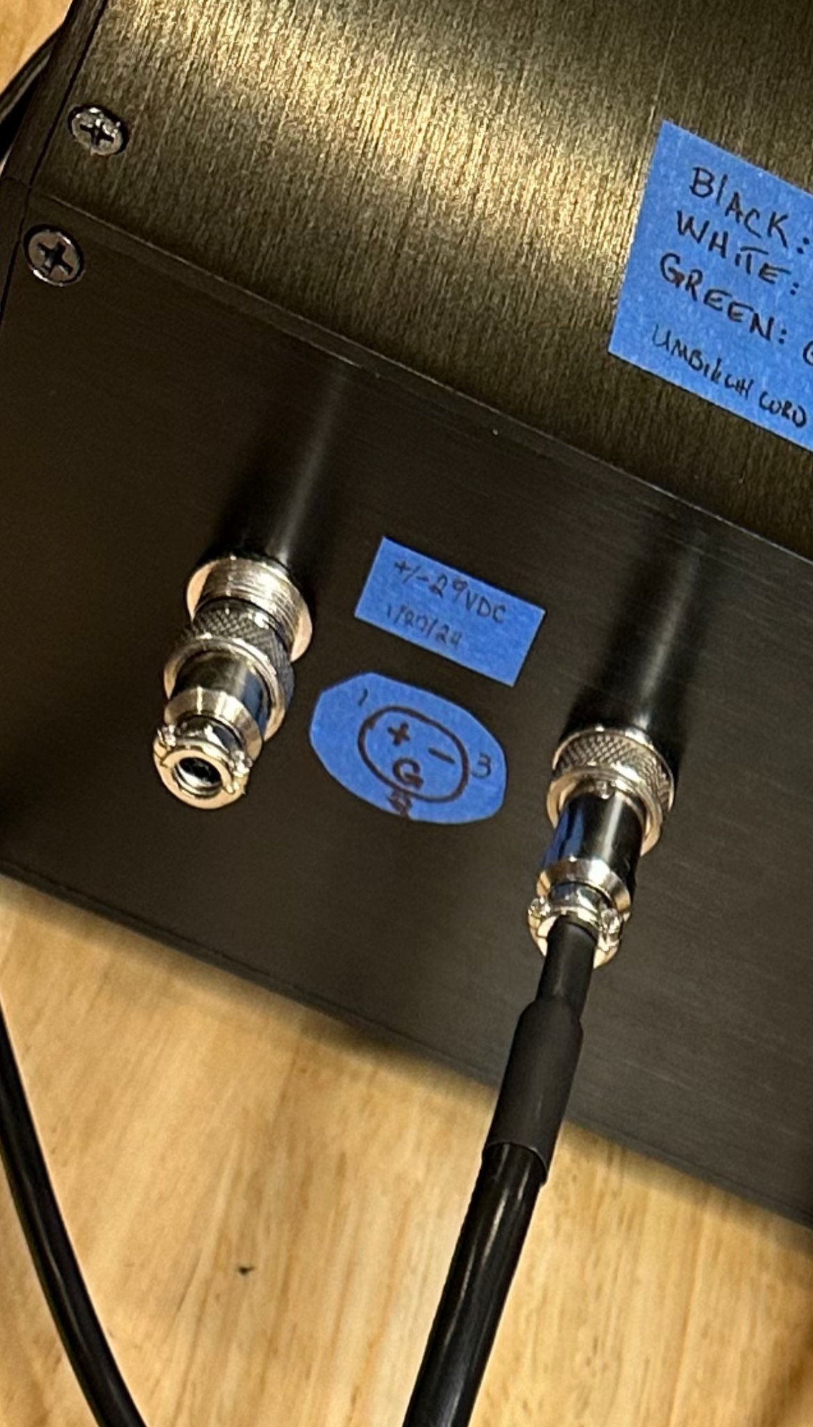

I installed three pin 'aviation connectors' that were in the parts bin for the external psu. 16ga is the maximum size conductor and that barely fits the solder tab. I would like a more robust connector for this application, what do you fellas recommend?

I have used XLR connectors in the past for PSU connections, some types have higher current ratings.
Have never used the PowerConn from Neutrik, but the Neutrik XLR TOP series is rated at 16amps - most of their other XLR's are rated at 6amps.
Looks like the PowerConn is mains rated at 20amps per contact - might be the way to go.
They are rated at 250VAC mains use at 20 amps, so quite rugged. Their technical documentation I read does not mention a DC rating.
I would say they would be fine at the nominal DC voltage levels for class A amps and you would only be putting a few amps through them anyway, and if you did not disconnect them while powered up then DC arcing will not be a problem.
I think they would be fine, as I said I have used Neutrik XLR connectors before for this purpose without a problem and the PowerCon range are even more rugged.
Neutrik specifically says that PowerCon are not for DC use. I am not saying that they are not suitable. That's up to each of you. However, they most certainly are not made for that application.PowerConn, a higher current version of SpeakOn are made for this.
NAC3FXXA-W-S is the one that has been suggested. While its primary rating may be for AC, it has been successfully used āoff labelā for modest DC applications such as what we are discussing.

IAIMH,Neutrik specifically says that PowerCon are not for DC use. I am not saying that they are not suitable. That's up to each of you. However, they most certainly are not made for that application.
Was there a technical reason from Neutrik why not to use for DC?
Or human error mixing up AC and plugging into DC ā¦.BOOM!!
^ I posted a summary of my conversation with the Neutrik engineer I called in another thread ...
Conversation With Fred From Neutrik
"He said in plain terms to not use either the PowerCon nor the SpeakOn for DC applications at all. I asked him if he could please explain at a novice level for my specific application. I asked was it dangerous / what could go wrong etc.?
He took the time to explain to me why those products were not suitable for me. That is not to say that they aren't suitable for anyone else... he was very polite, but strong in his wording that he doesn't think it's a good idea to use those products for DC. He'd be happy to explain why to anyone for their particular application over a quick / direct inquiry."
