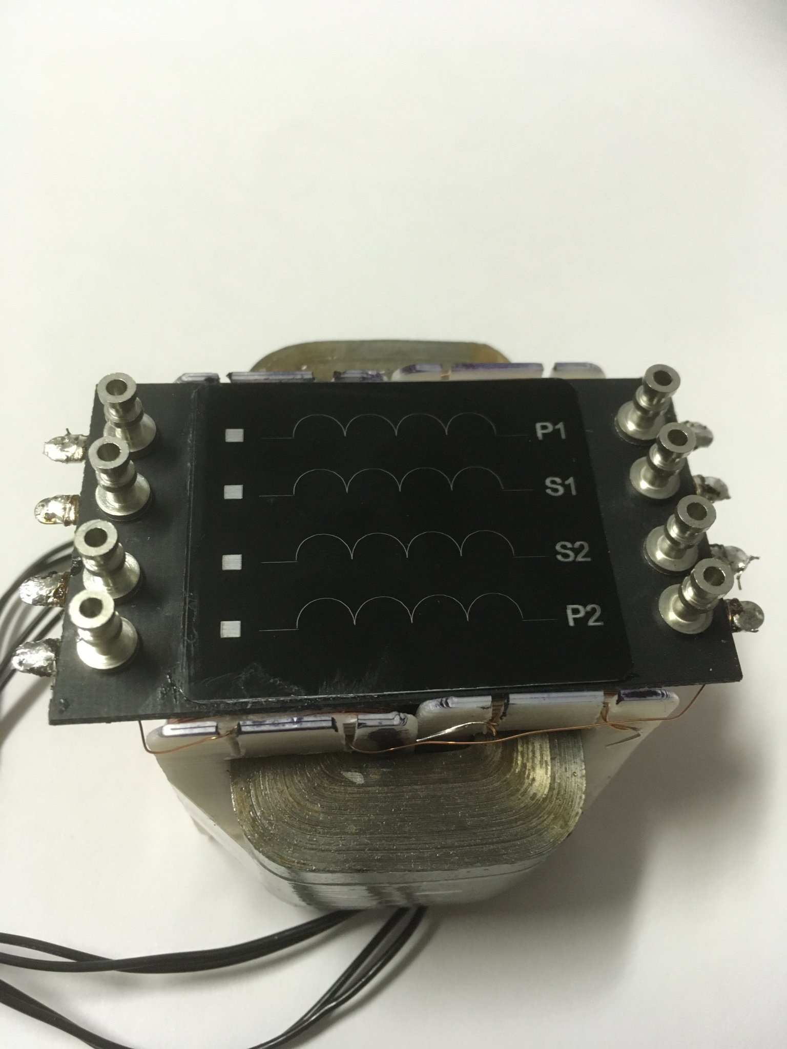

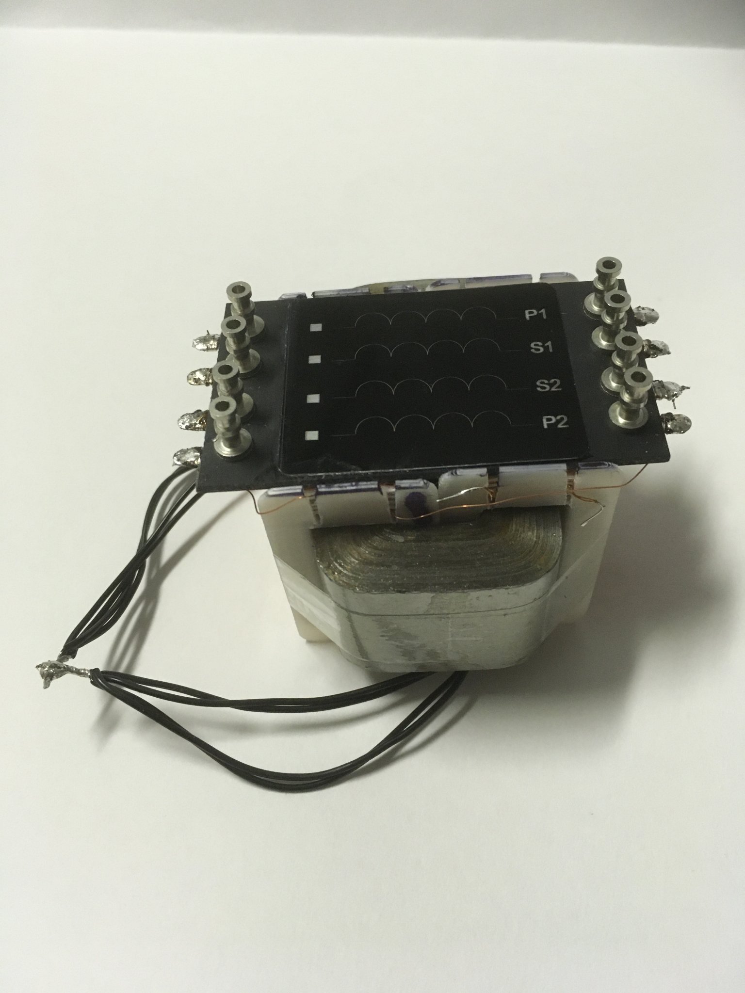

Anyone up for evaluating a pair of these amorphous and nanocrystalline transformers in your F6 build(you’ll need to use flying leads)?
Just drop me a PM if interested.
