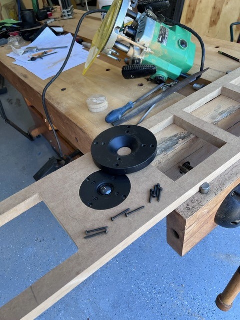

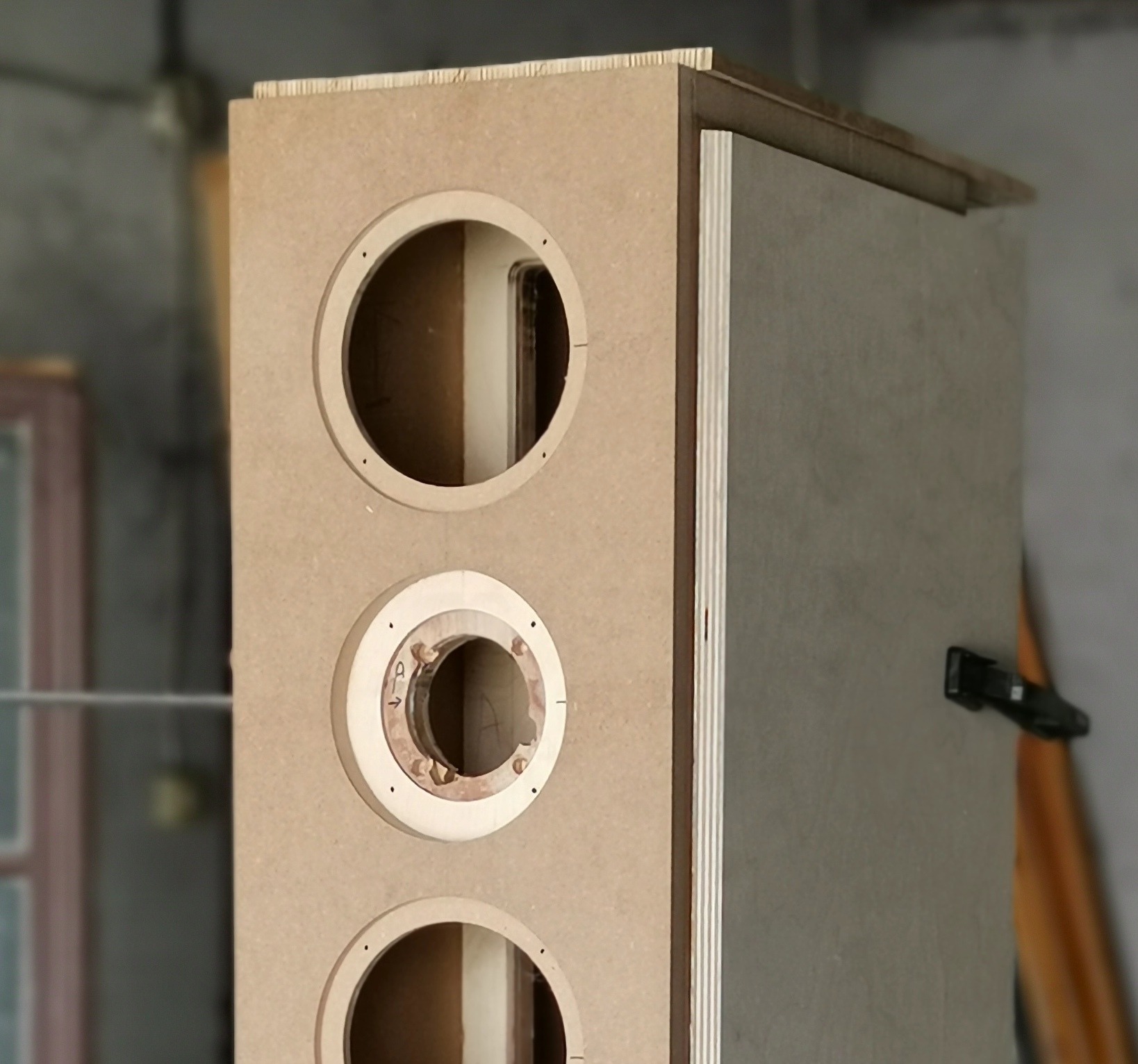

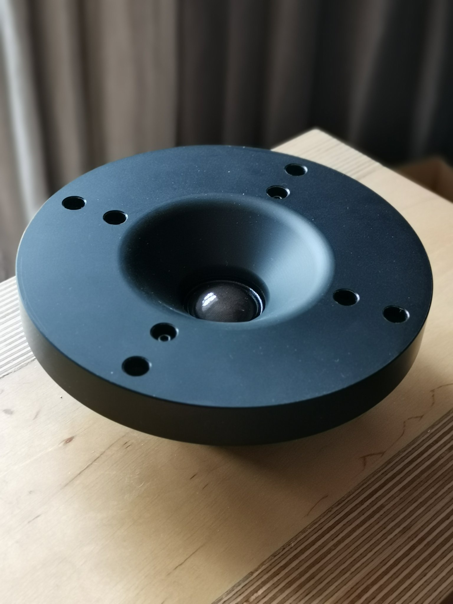

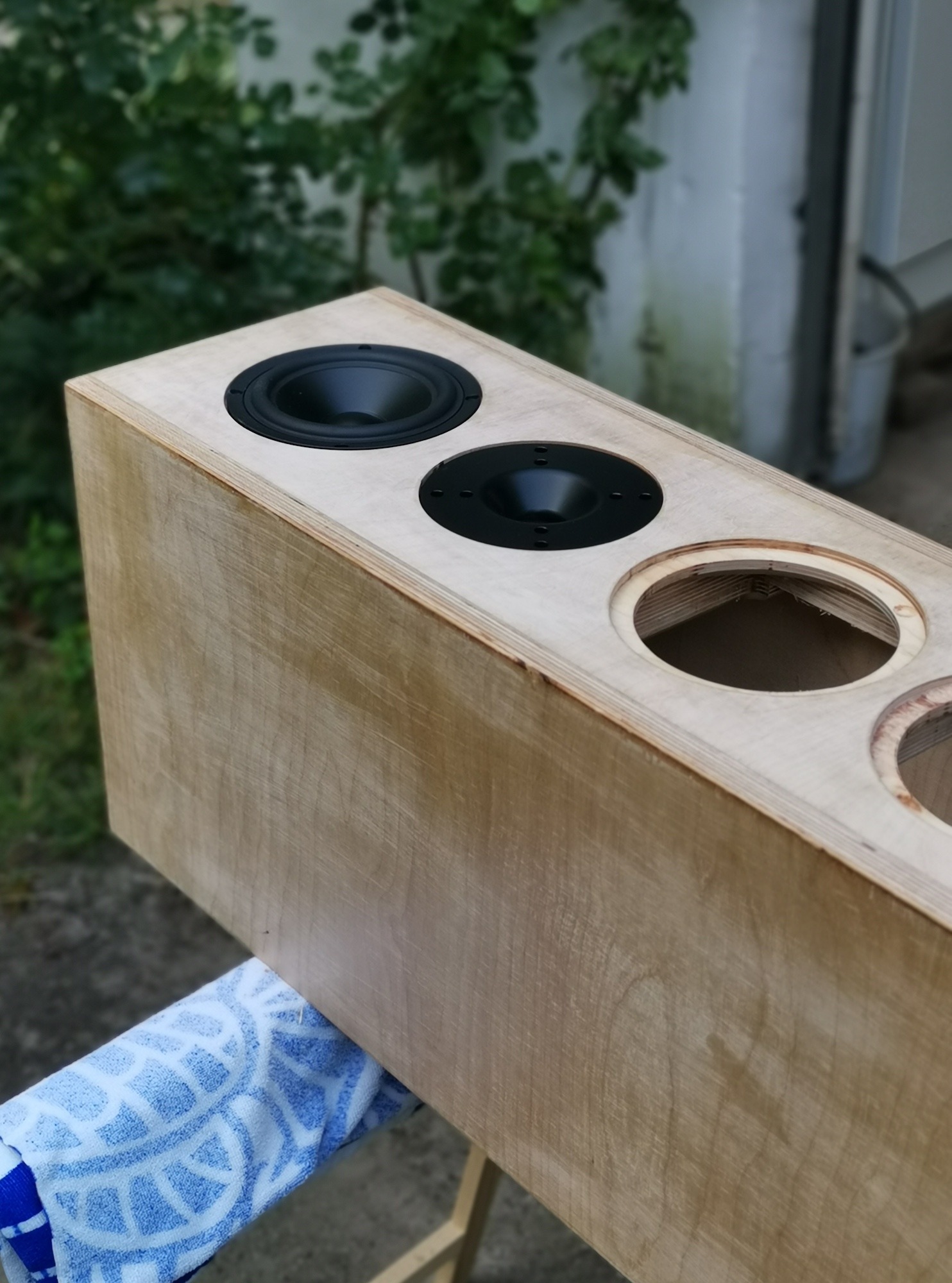

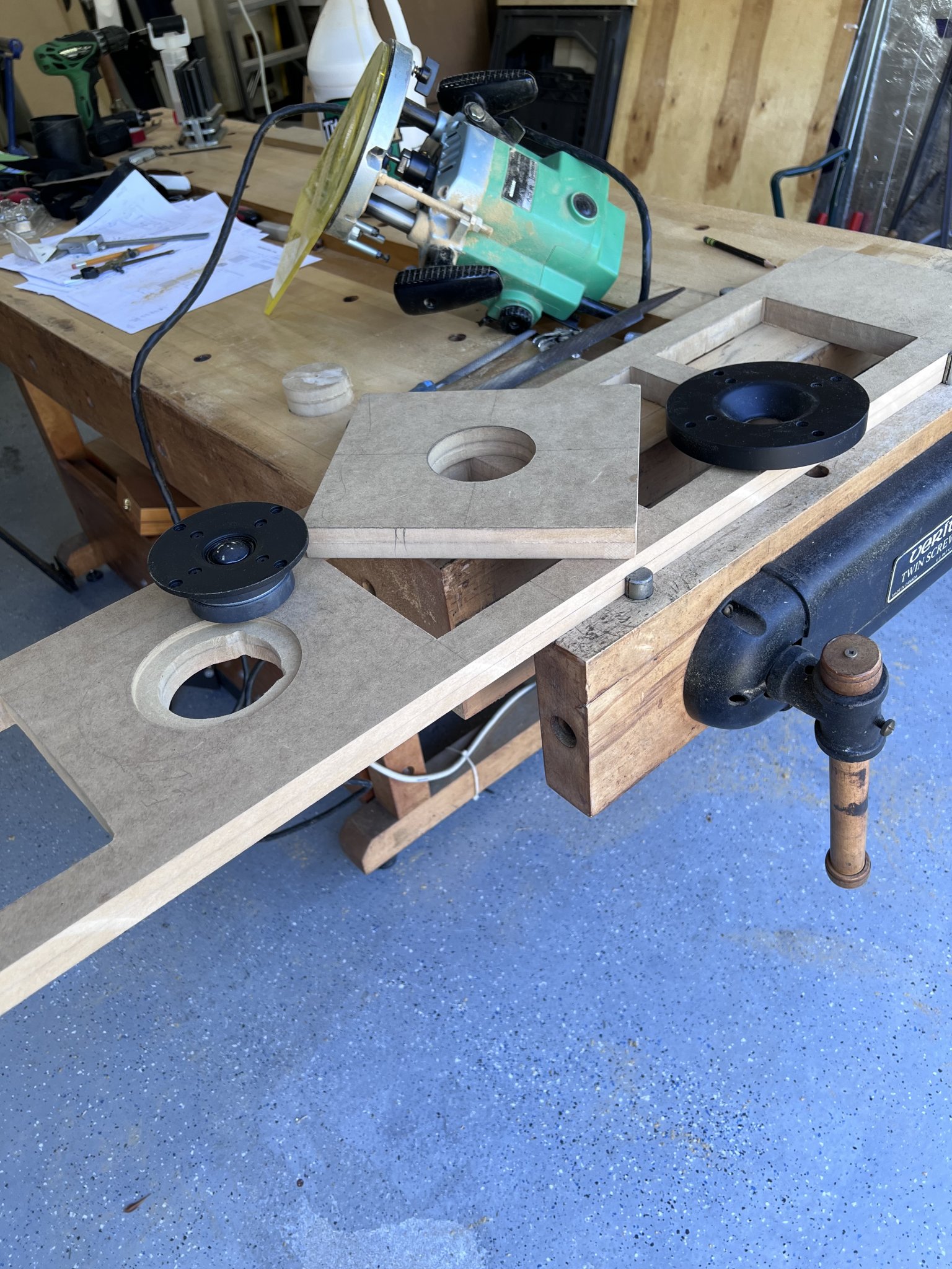

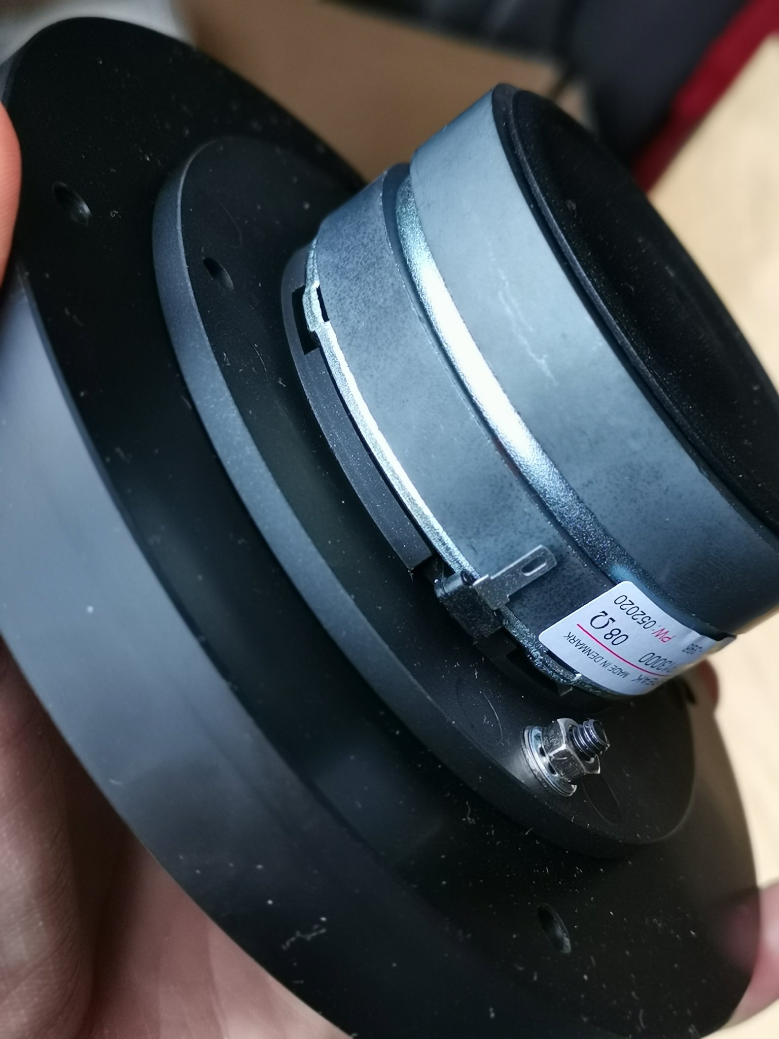

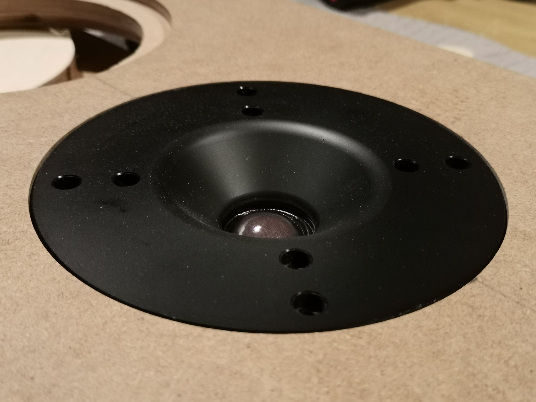

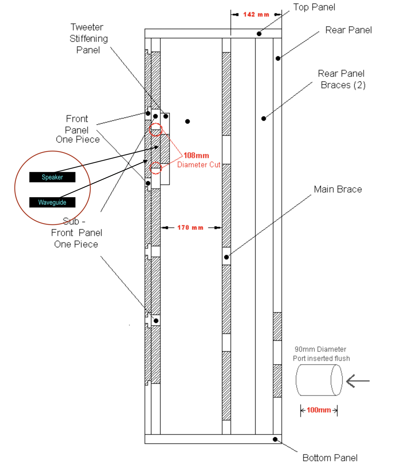

You should twist the speaker from the waveguide.
This waveguide holds the speaker and is then screwed to the inner panel. And the front has the same thickness as the waveguide and the hole in which it fits.

I am not sure of the suggested way to attach the tweeter and waveguide
Like JarBar is indicated, from what I can see, mount the waveguide to the tweeter so that it becomes a single unit. Now mount that as a unit into the box. It gives the whole thing the strongest mechanical fit.

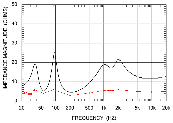

The red line is joining the spot checks where a parallel 8R is used. Now it is clear that this is rather different from a single driver and we see that midrange peak hugely flattened out. This is the Revel M126Be speaker and Isaac who added and listened to the result and was gobsmacked, we are still left with the question, what was it that he heard? So we have two additional components involved, the crossover and the tweeter.

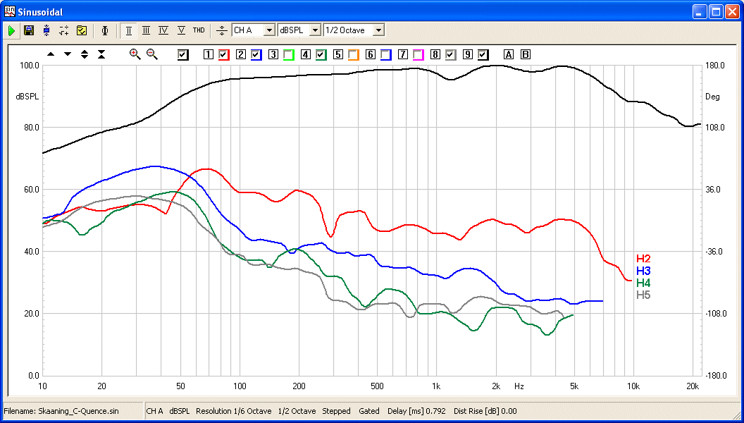

Coming back to your first H2, H3 measurement, I am not sure what the equipment you used, but I did look back into the 'vault' and found the below measurement of what was a then newish design from Audio Technology, the 18H52 C-Quenze Midwoofer, still in production. The measurement was taken 03/03/2007, so 16 years ago, with Clio 7 (I have Clio 11 FW now):
As you can see H5 up to 4500Hz. This was a pricey driver. Still is.

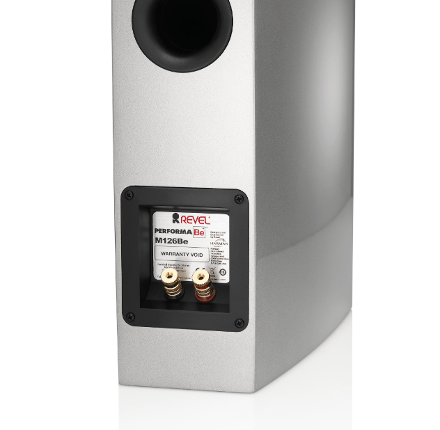

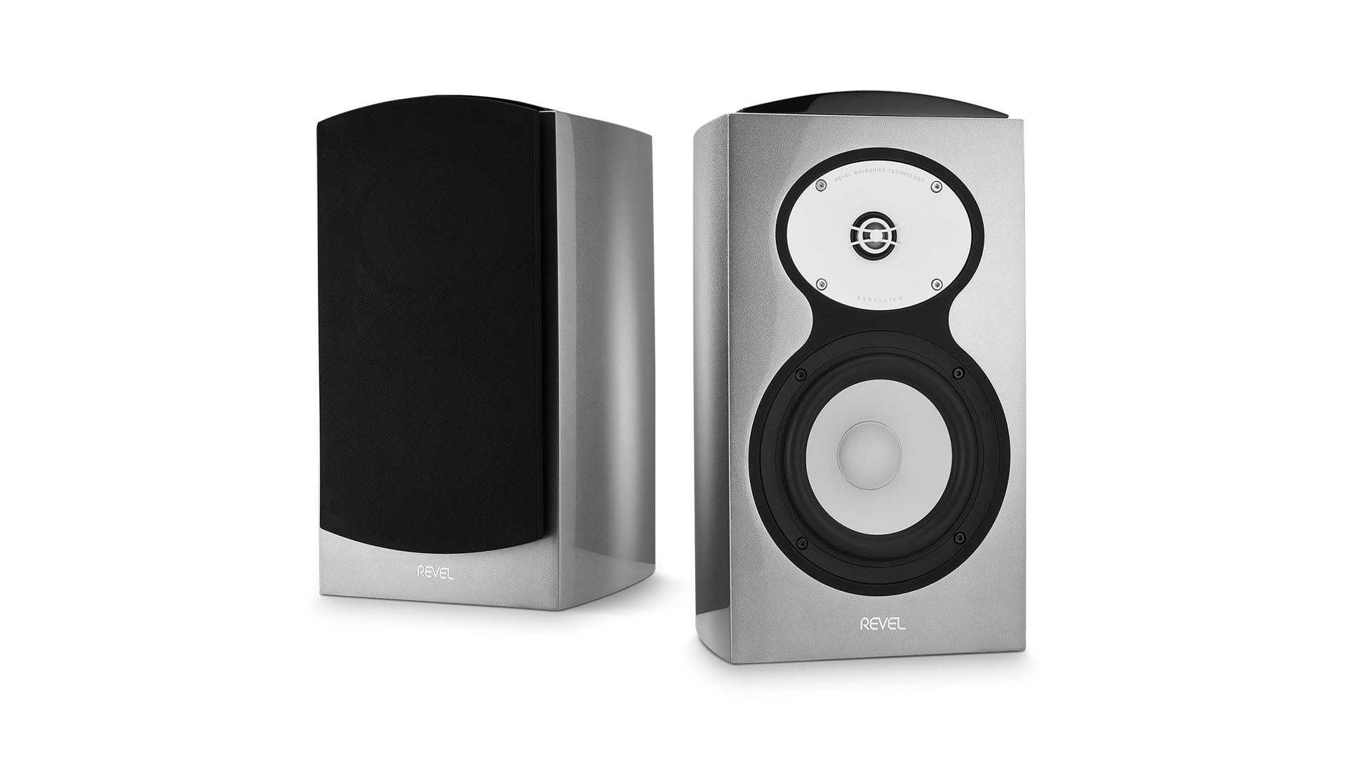

This is the Revel M126Be and it sells for AUD $7500, so it is a premium compact speaker with 6" driver and Beryllium tweeter.
Rear:
Nicely made speaker, as you would expect for the price.

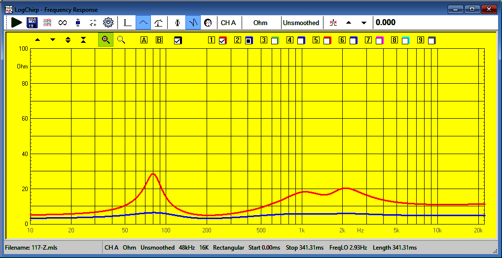

Now this is where some parallel 8R 100W resistors were added and the two Z responses below:
We can see that through the critical mid-frequencies how flat it looks. At those frequencies there is a lot more current going through the parallel resistor, I did a quick calculation, About 71% goes through the resistor at 2KHz and 29% on to the crossover and on to the drivers. The amplifier sees more of the resistor than the speakers, particularly around the crossover point. Is this having a stabilising affect around the crossover. Yes, saying stable may not be the best word, but is is what comes to mind.

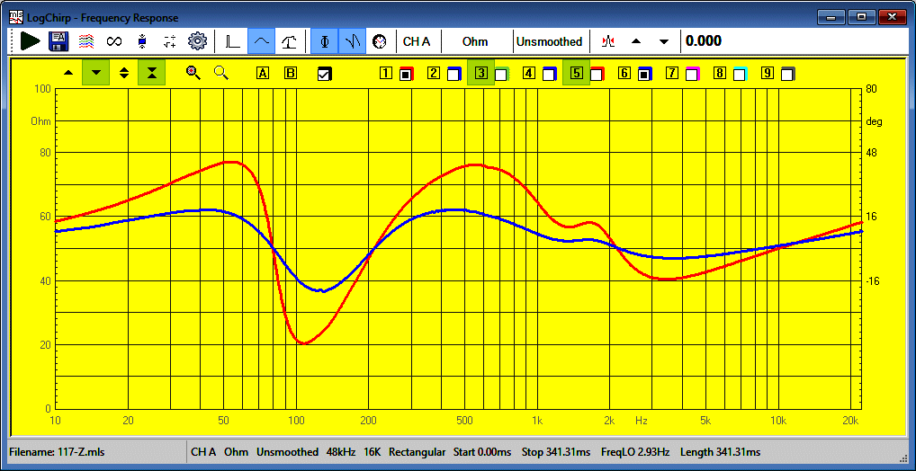

Let us look to the current phase angle:
We can see that above 1KHz the phase angle is under 10° deviation from zero degrees.
Of course this all looks very academic... until you listen to it. The difference in sound is not hard to spot and this neat trick, usually with 2-Way speakers like this, it has now been done so many times.

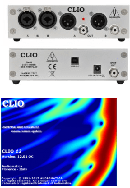

Hi Alfred
Isaac owns the speakers and brought them around last night and we did the measurements on my Audiomatica Clio V11.45 setup. There is a V12 but I have the Firewire edition and only the newer version has USB. I can get mine upgraded to USB but it needs to be sent to Florence and the whole thing will cost at least $500 and it is fine as it is and there are more V11.45 users out there than V12 w/USB. A lot of professional speaker designers use this and many came over from the extremely complicated MLSSA software. I also have a number of measurement microphones here, main goto is Earthworks M30. But this was an electrical measurement
Link: Audiomatica Website
I don't have any problems with Firewire. I have a Mac laptop with Windows 10 loaded on it and the port (whatever name they give it) works just fine. In my main desktop computer I have a PC Firefire card and also works great. Don't need USB.
Not a difficult measurement, lots of equipment out there could do it.

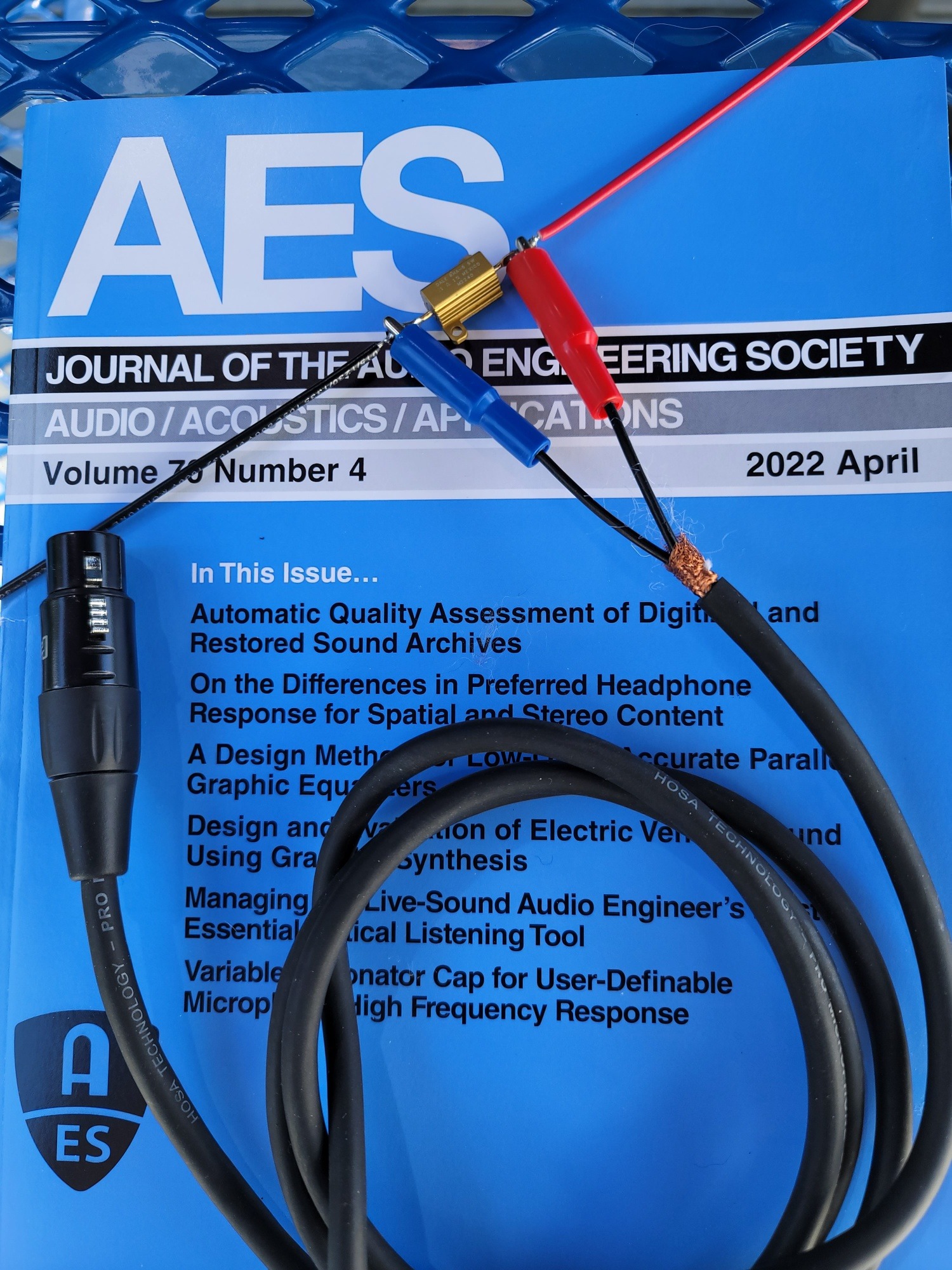

For grins see the attached photo of how the sensing resistor is used and connected by XLR to the analyzer. The Red clip is the hot pin and the Blue clip is the cold pin. A low noise precision measurement tool.
