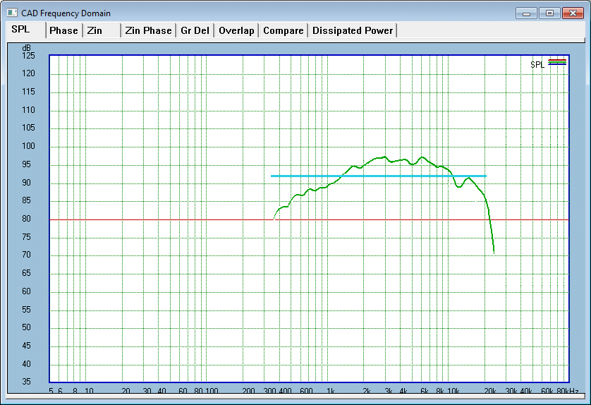

Easier when it is shown on its own below. The target sensitivity was circa 92dB/2.83V and 15° off axis listening:
Back in 2012, it got me close to what I was aiming at. Not saying that there is better out there now, but it works. I also aimed at the smallest value series capacitor I can get away with. For reasons to complex to explain here, I wanted as much 'impedance' between the tweeter as possible, especially near the crossover. For example, one active speaker with the amplifier connected directly to the tweeter, it had a glassy quality. Adding a series resistor and increasing the gain in the amp to compensate, that suppressed that glassiness. I believe I know the reasons and working on a measurement that I hope will explain why.

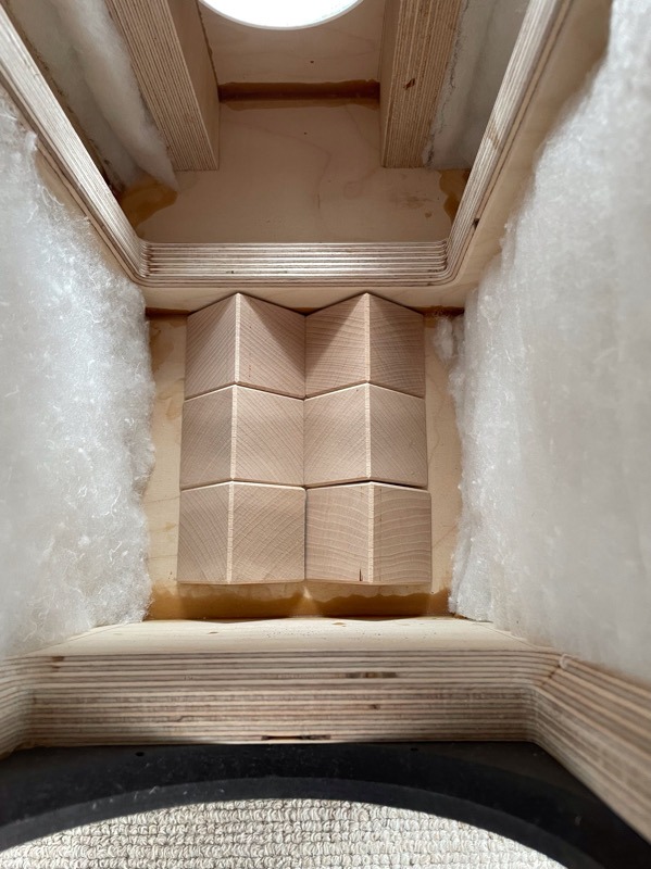

Hello all,
I am in the final stages of my build. Due to the fact that the crossover will be implemented externally, the floor inside the box remains free. I wonder if to reduce standing waves between the floor and the top in the box, it might be advantageous to glue small wooden triangular building blocks on the floor:
What do you guys think? Would this interfere with Joe's tuning of the box?

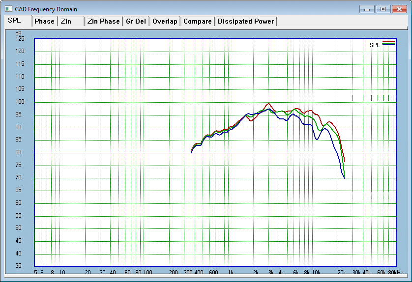

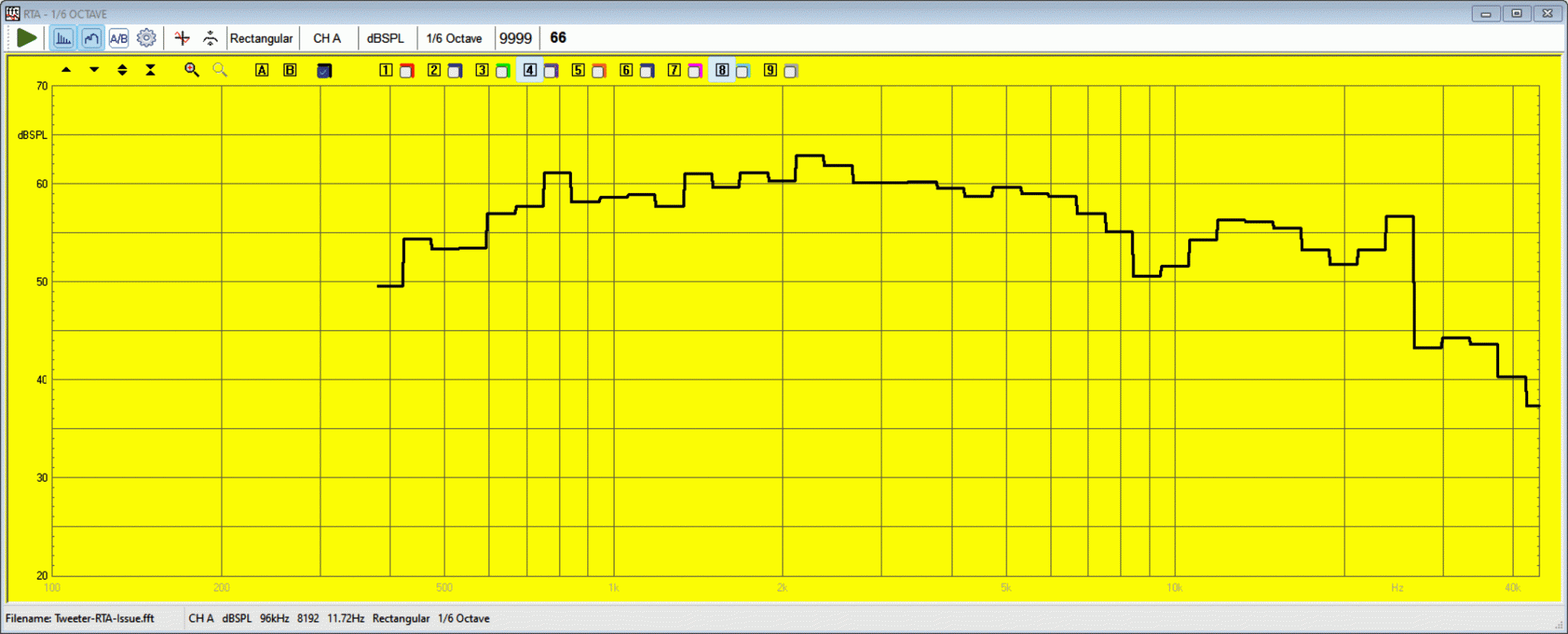

ISSUE:
Take a look below, a quick test of the Ceramic/Aluminium Tweeter, can you spot something?
No phase plate!

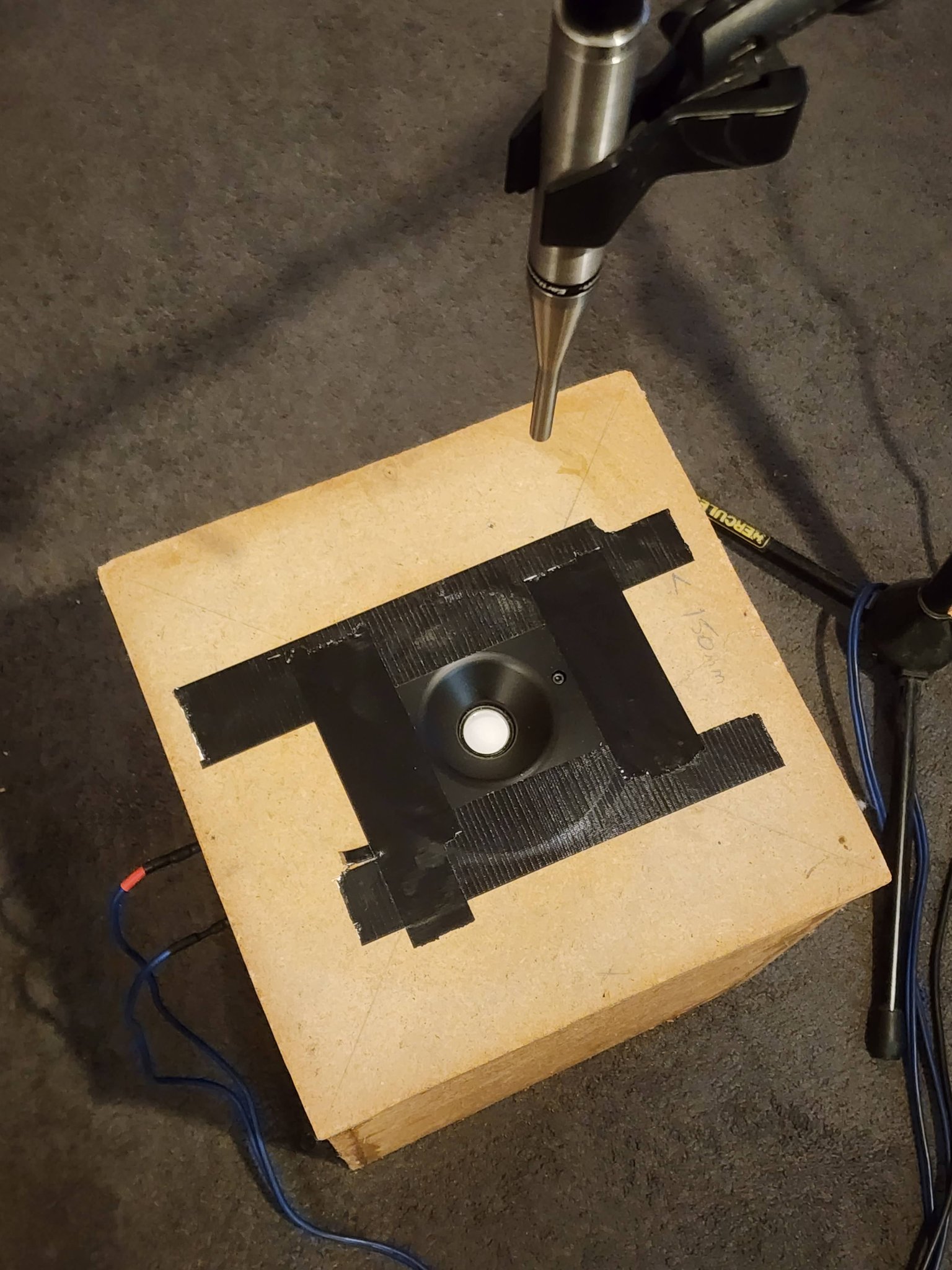

I am having an issue with the Ceramic/Aluminum Tweeter. I am getting a suck-out around 9KHz.
The picture above shows the Tweeter without the phase plate. I always wondered if there was going to be an interference between the phase plate and the Waveguide, and if so what frequency. I knew it would be fairly high up and sure enough there was a major suckout at 9KHz.

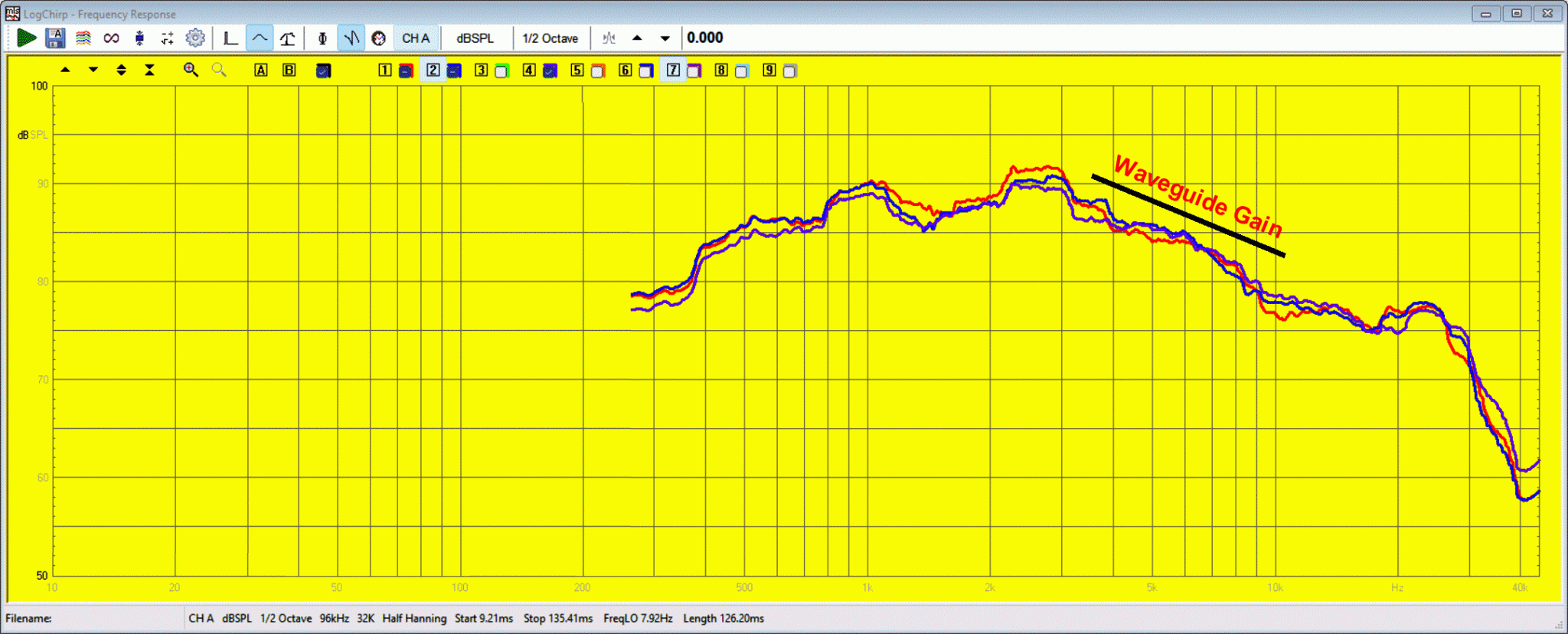

I then removed it with a pair of sharp cutters and got the following "on" and "off" axis family of responses below and no suckout. It looks very consistent.
The waveguide "gain" looks good too, between 10KHz and down to 3KHz..
This was a quick measurement, but the results confirmed that waveguide gain we are looking for. Interesting, the above 20KHz peak that you get with hard domes is largely not there, just a bump. It was more prominent with the phase plate as this RTA measurement confirms:
You can see that the suckout wrecks the waveguide gain and does not eliminate the circa 25KHz peak.
Any other issues?
Well, the dome is not as well protected, but the insert of the waveguide does give it some. They are not hard to swap out the VC & Dome assembly, are they available as spares from SB Acoustics. I haven't checked. But beware of young children, hard dome don't have the spring back of soft domes.
The nex main issue is the Tweeter's lower sensitivity and being 4 Ohm. The lower sensitivity of the NBAC driver will hopefully help out here. But I suspect that the impedance above 5KHz might drop as low as 4 Ohm, but we shall see.

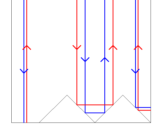

I honestly don't think it will do that much. What happens if you reduce the volume of the box? The box tuning frequency will go up, slightly and will increase output above the frequency and lower it below it, slightly. Will it break up any vertical internal resonances? This usually shows up in the impedance plot and they are not there. The drivers vertical line, spread out, plus the internal damping, it can be seen as already sorted. So I would not use it.

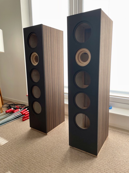

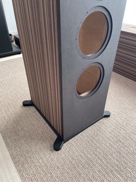

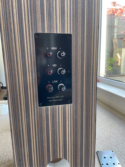

By the way, maybe it is time to show some pics of my build. It was a great experience thus far, being my first contact with woodwork ever. A dear colleague of mine and me we both helped each other and we both build a pair for each of us.

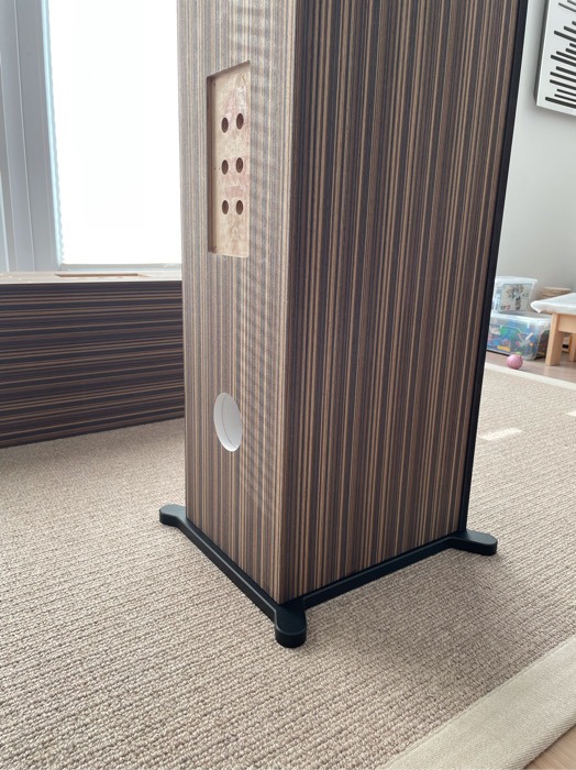

The foot plate for installing the Gaia feet later was done by a guy here in Germany who is specialised in milling custom speaker stands (for quite a reasonable price) and the result is just marvelous. Can‘t wait to let the Elsinores sing!

Those are very handsome cabinets -- nice work! You're going to love the final product.
Regards.
Regards.
Beautiful!!By the way, maybe it is time to show some pics of my build. It was a great experience thus far, being my first contact with woodwork ever. A dear colleague of mine and me we both helped each other and we both build a pair for each of us.
HenSch,
I would echo the sentiments expressed by SRMcGee and WeBuild4Life - the cabinets look really nice - kudos to you and your colleague! 🙂
There will be minimal effect for waves that can see these triangles as the distance and direction tend to remain the same as for the regular box.triangular
Yep.

Any idea of the date completion? Yes, the Gaia feet will make a difference, and no, I am not in cahoots with them.

You are absolutely right, I lost the physics for a moment.
I have given the building blocks back to my son, seems like they are of more use in his hands. 🙂
@Joe Rasmussen: Should have finished them around mid of July.
Triangles should alternate direction in order to work as diffuser.
