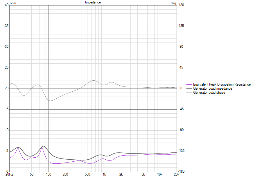

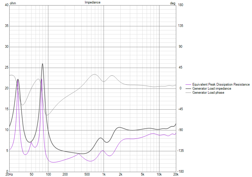

Reasoning, reading about EPDR, Equivalent Peak Dissipation Resistance, which kind of shows actual load impedance for class B amplifier, how much power turns into heat. Here is an example. Nominal ~4ohm speaker, but the reactive load lowers the impedance worst case to about 2ohms, which would require quite lot of current capability from the amplifier.

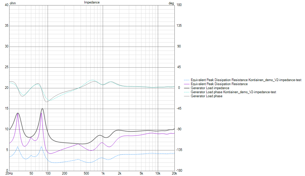

Now 8ohms parallel resistor added to the speaker the impedance plot is smoother, and max phase angle is less but the EDPR is even lower now requiring even more current from the amplifier than before.
Now if we assume perception of better sound with parallel resistor and reason about it: Since current demand from the amplifier got up, not down, the better sound quality must not be from the "ability to deliver current" as aggregate total but from the phase angle for example, which somehow affects how the amplifier works. It might be also that distortion went up, and it sounds better 🙂

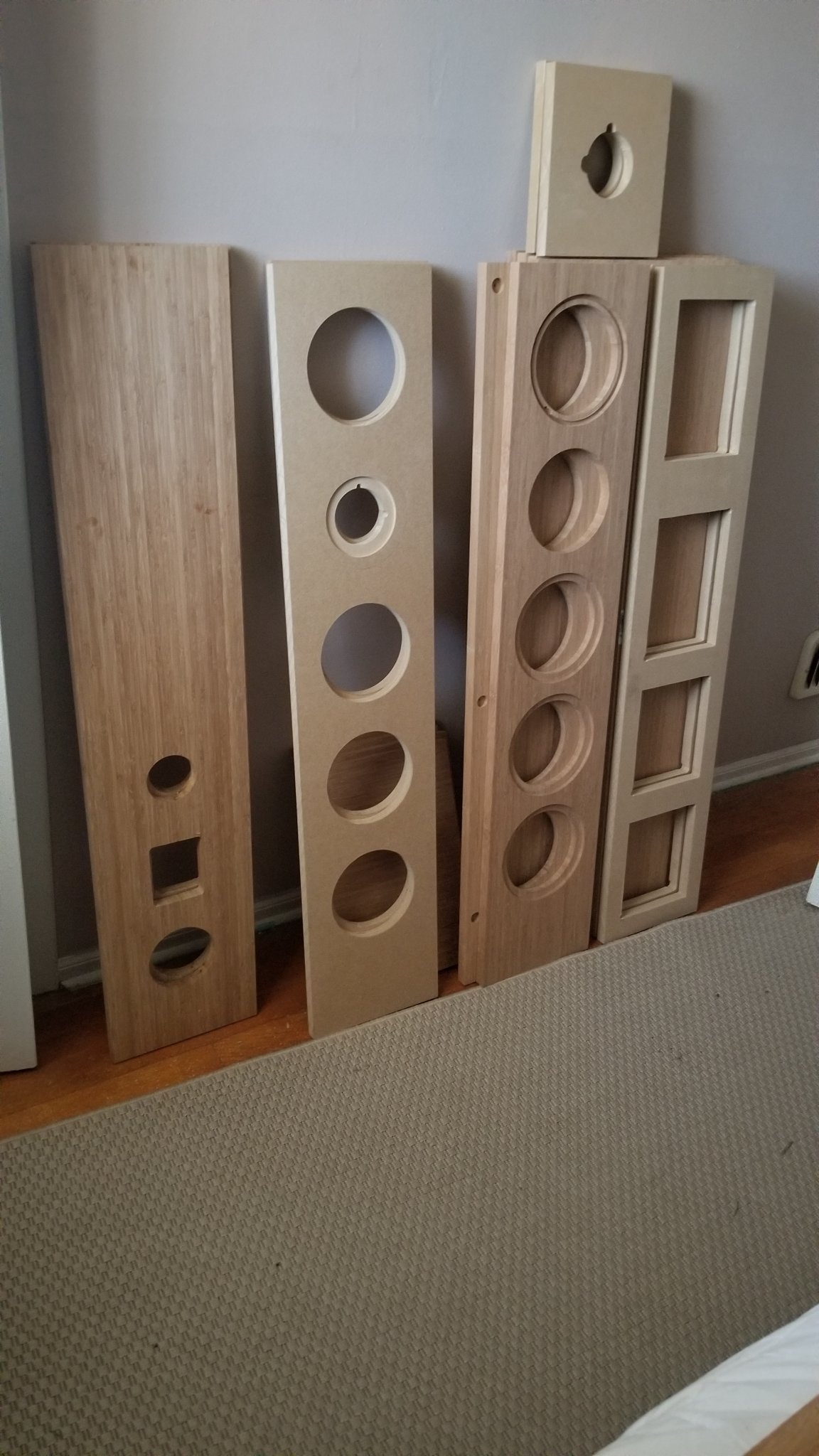

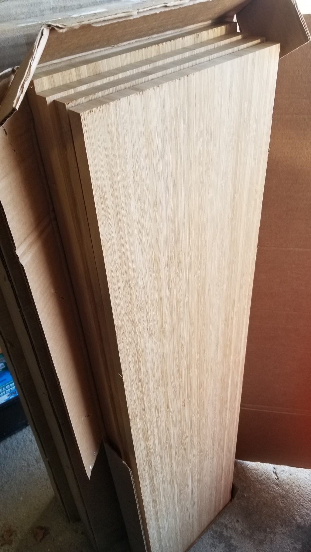

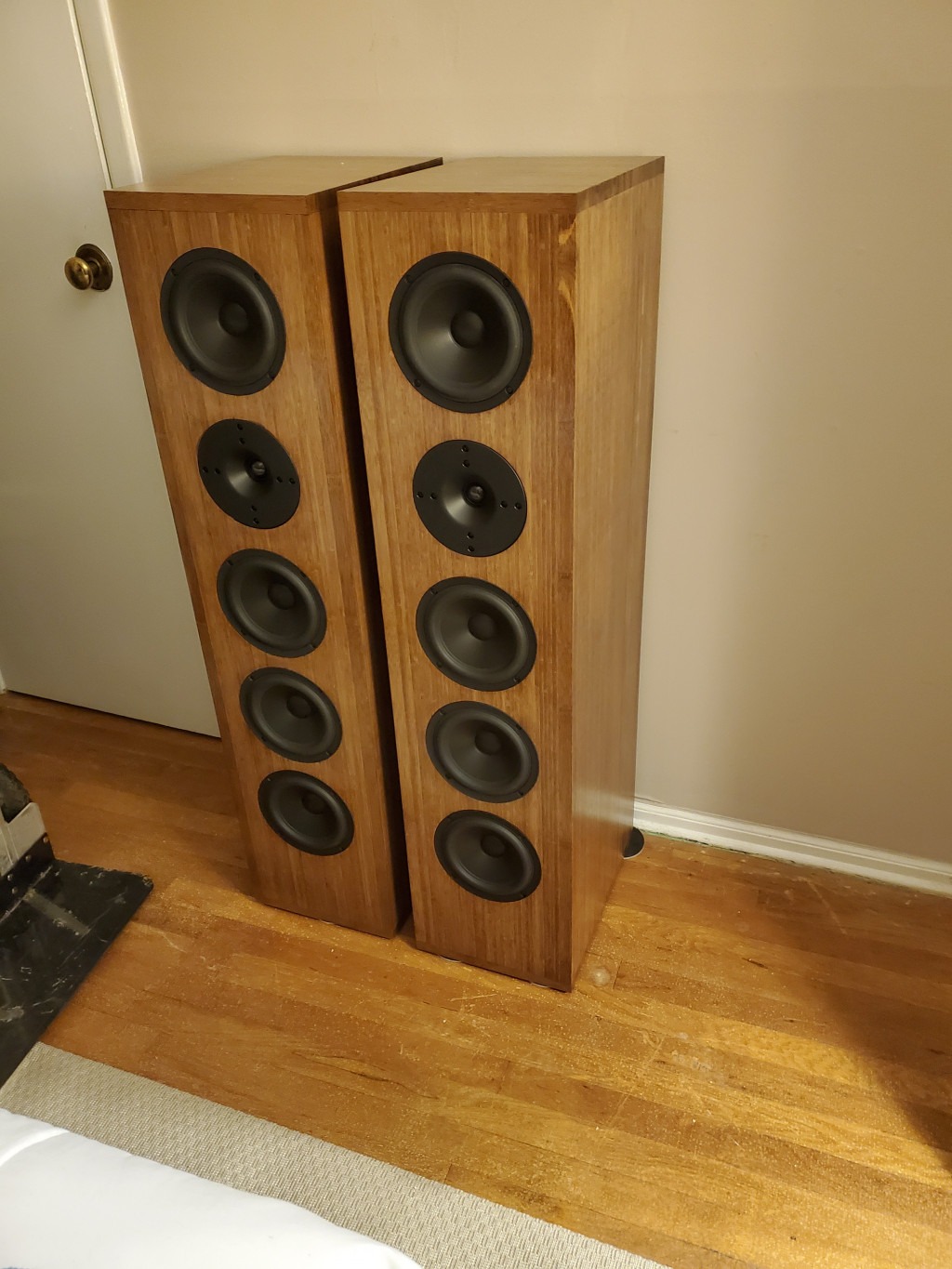

AudioFanMan,
Good to know that you have been enjoying the music. 🙂
Any pictures of the speakers/your setup that you would like to share?

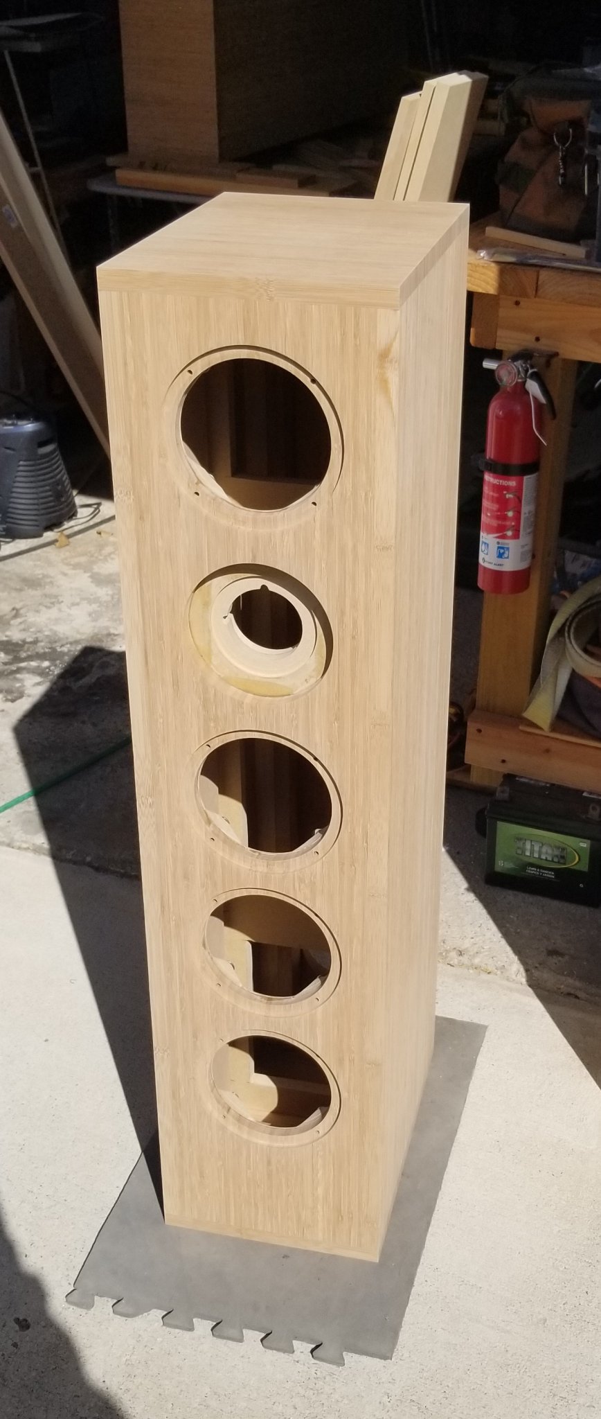

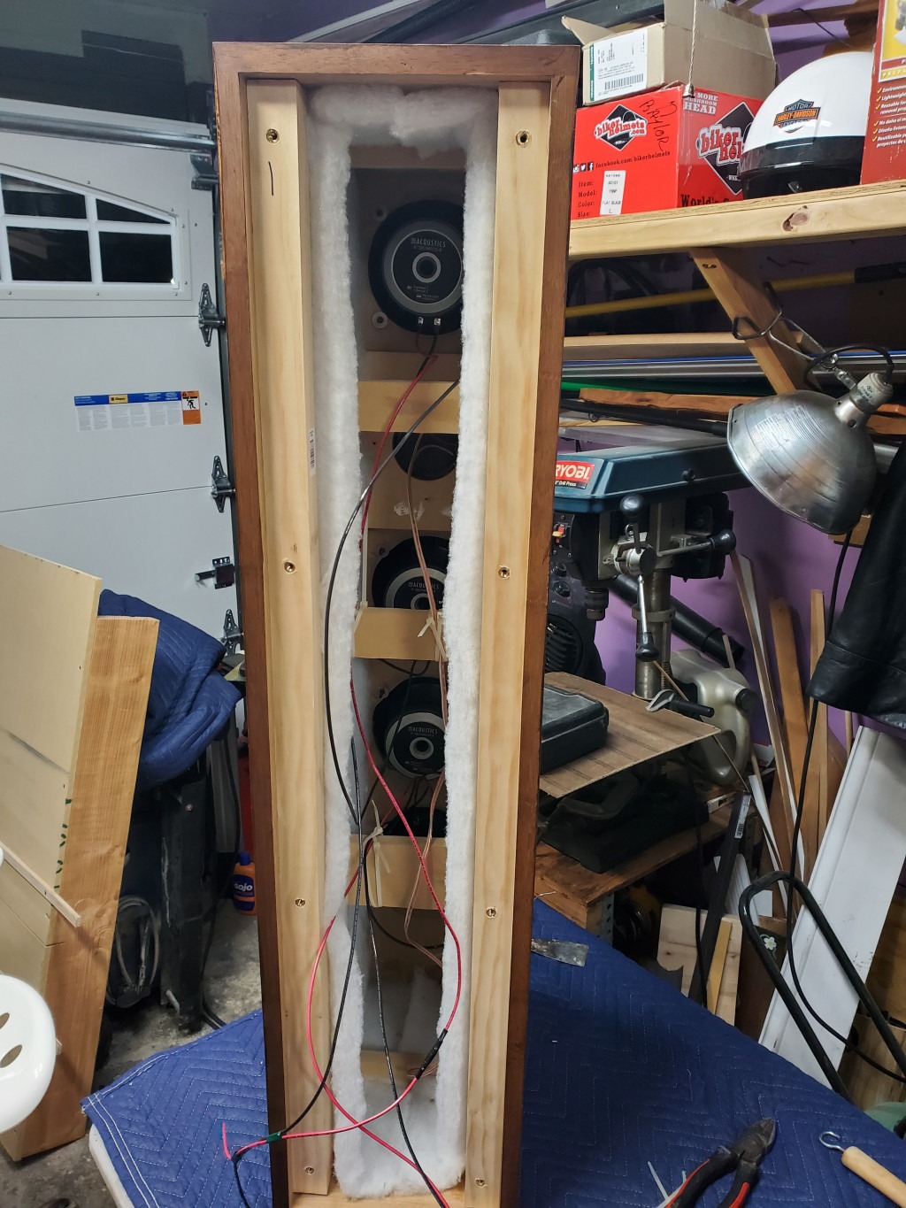

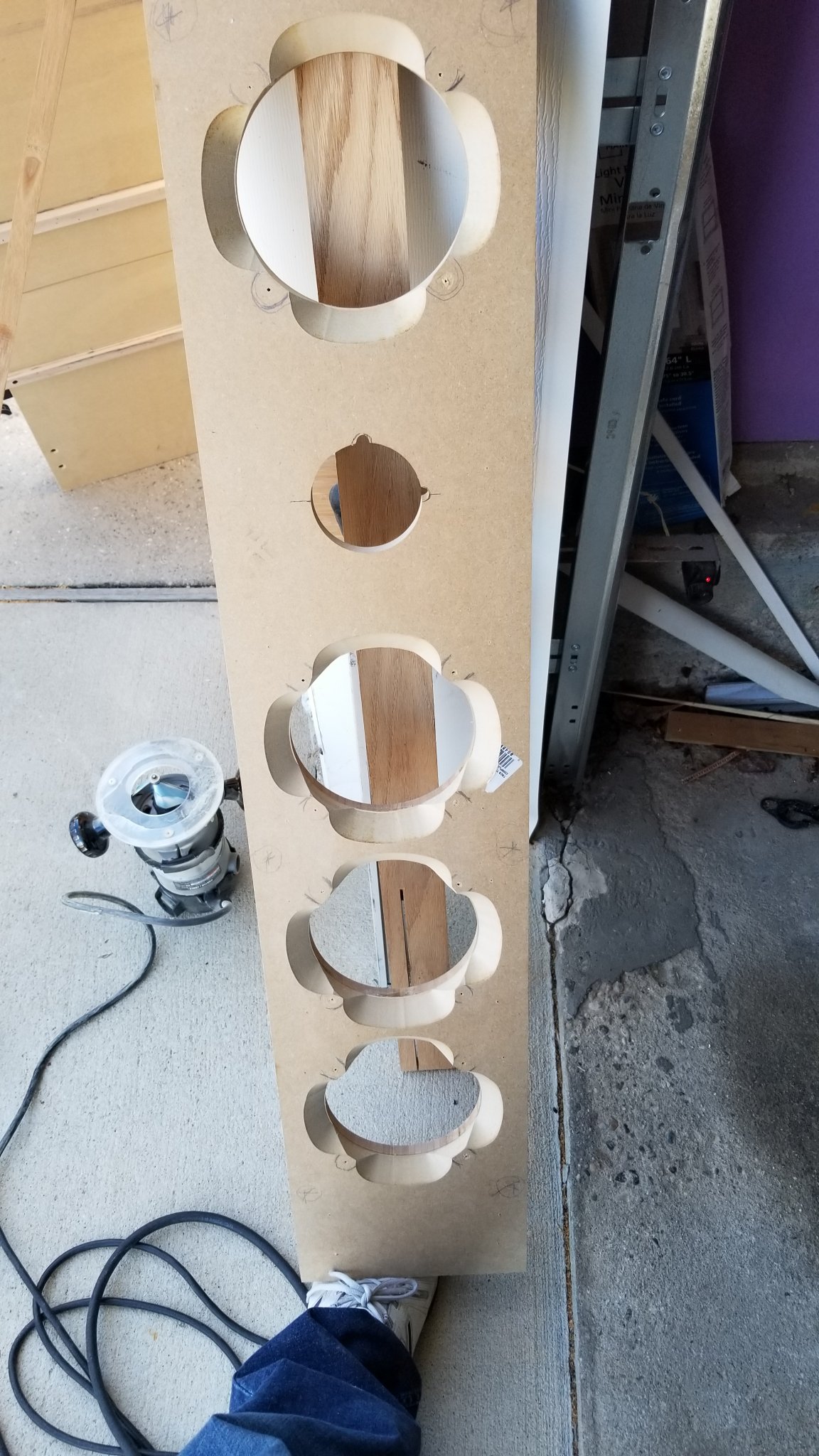

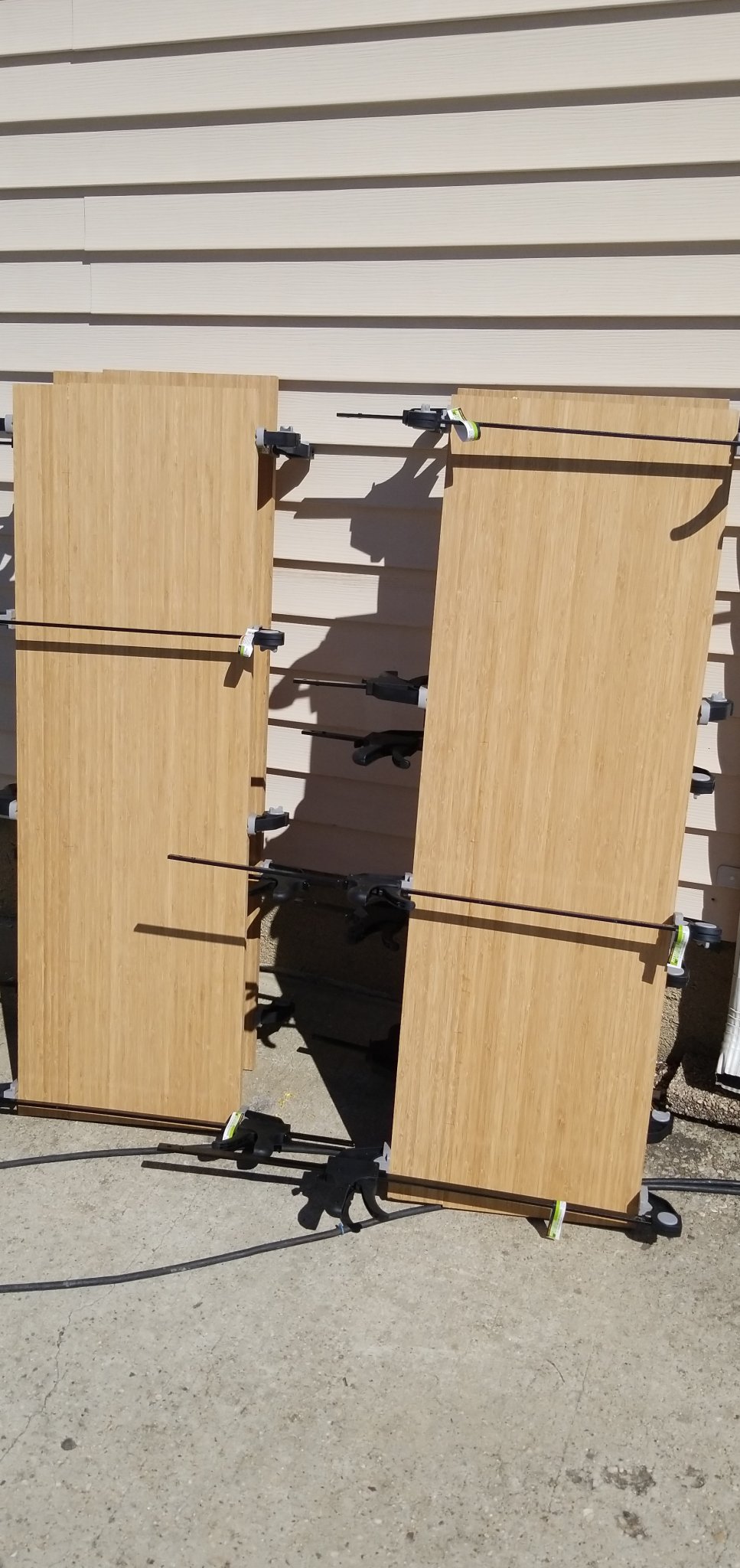

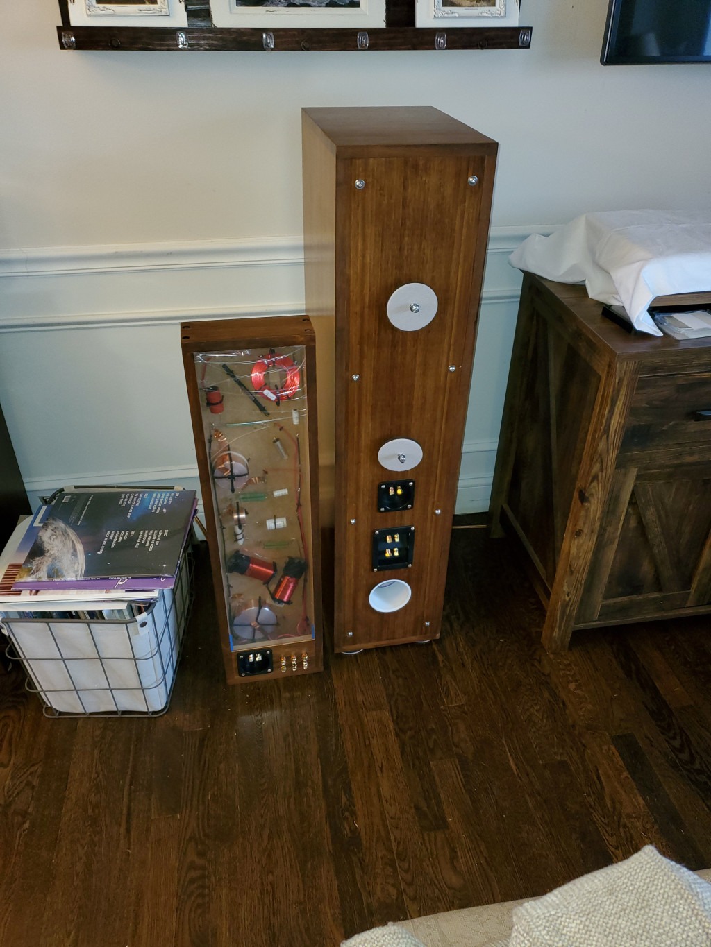

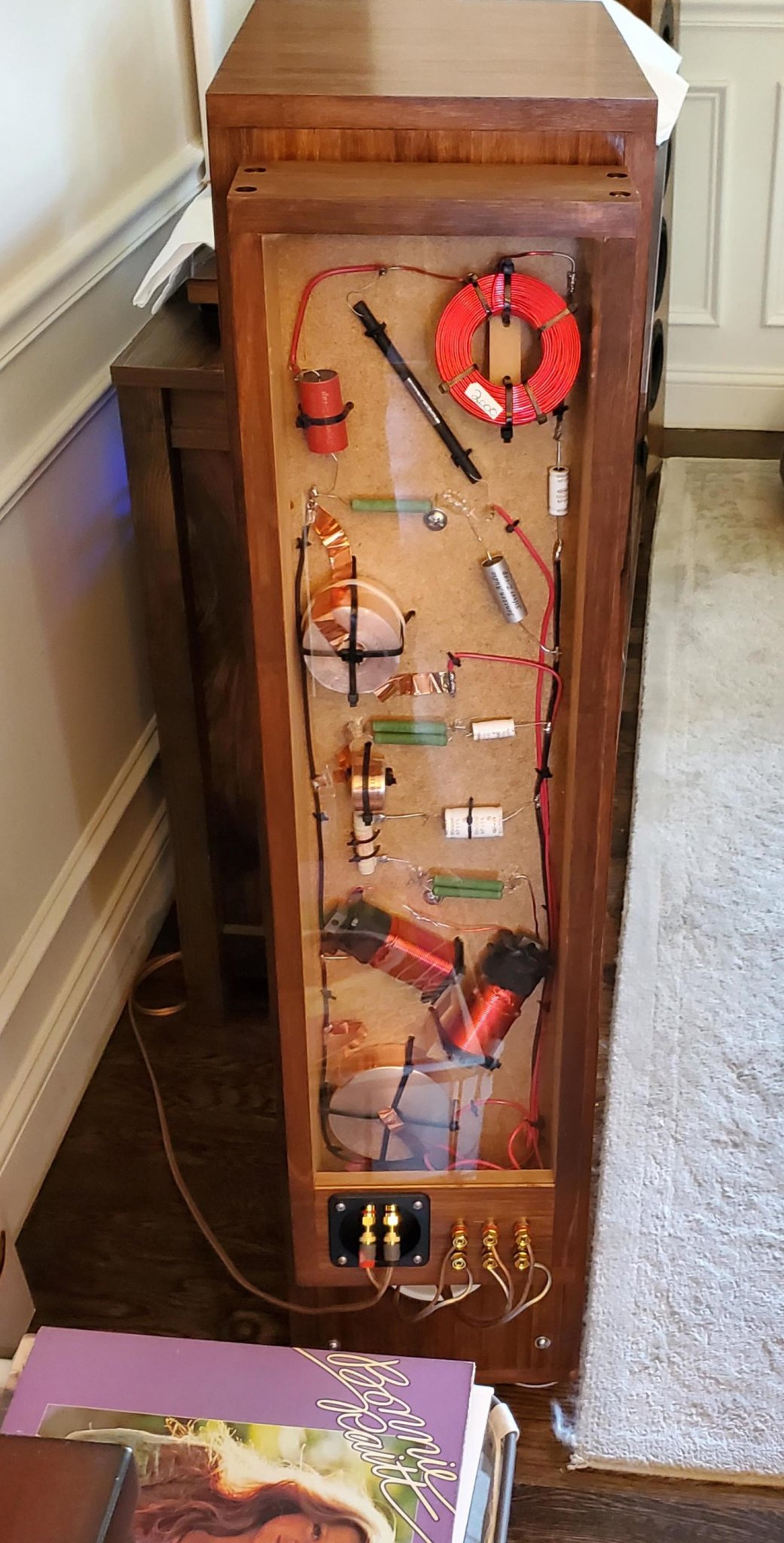

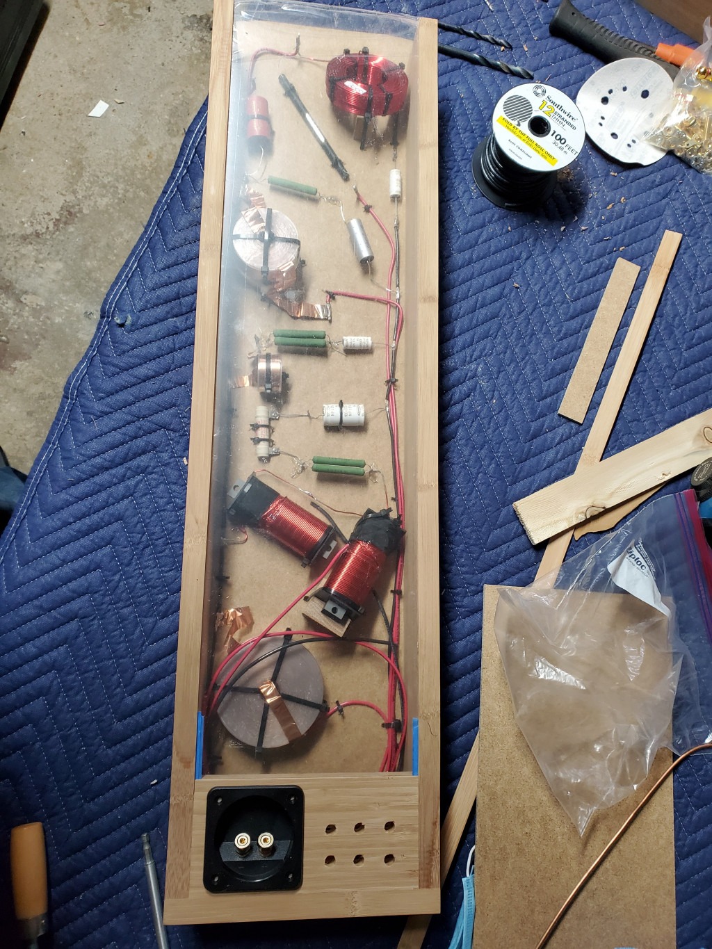

Few build pics attached...

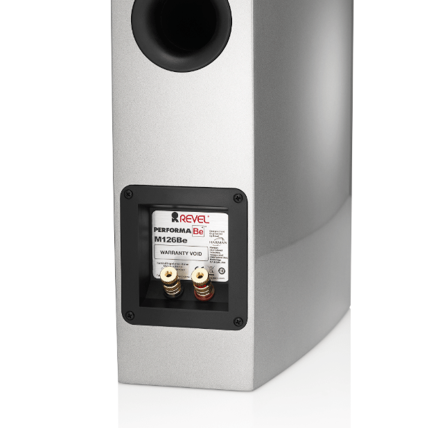

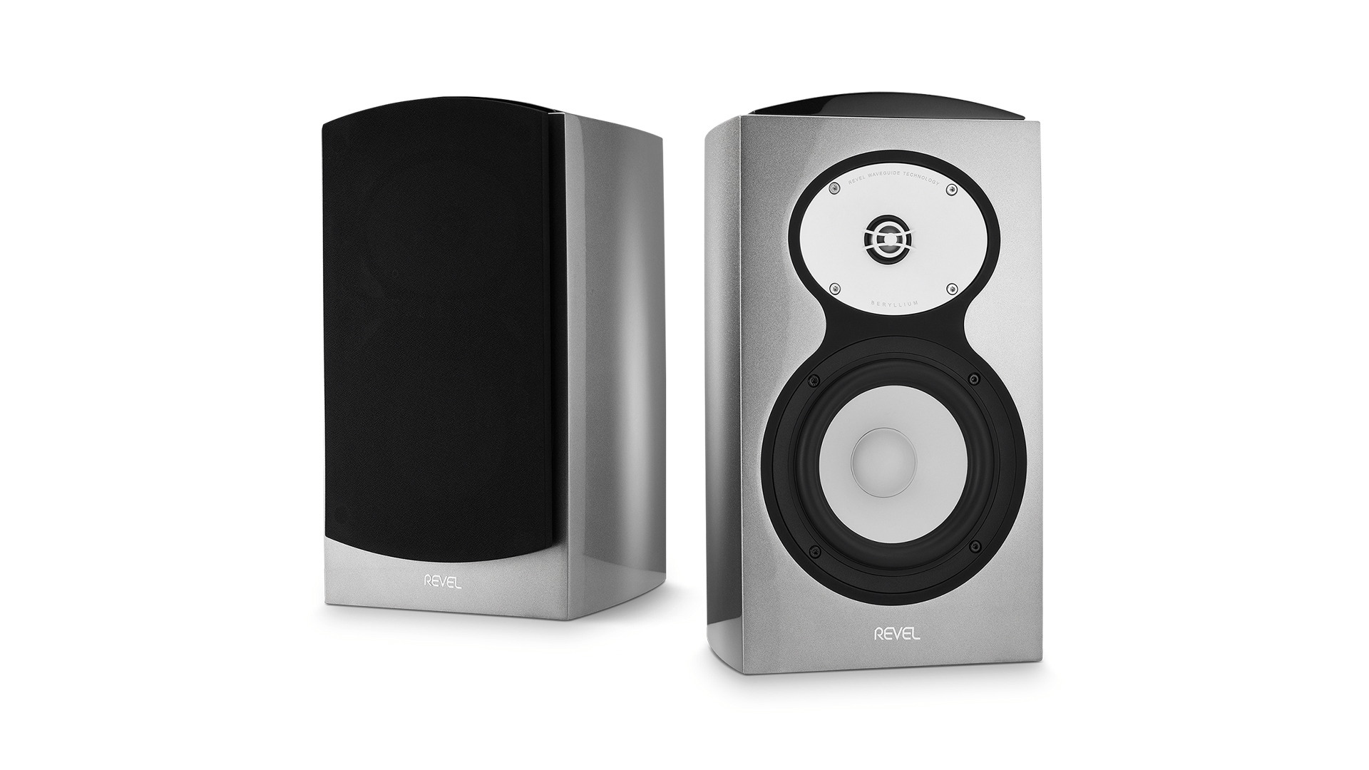

This is the Revel M126Be and it sells for AUD $7500, so it is a premium compact speaker with 6" driver and Beryllium tweeter.
Rear:
Nicely made speaker, as you would expect for the price.

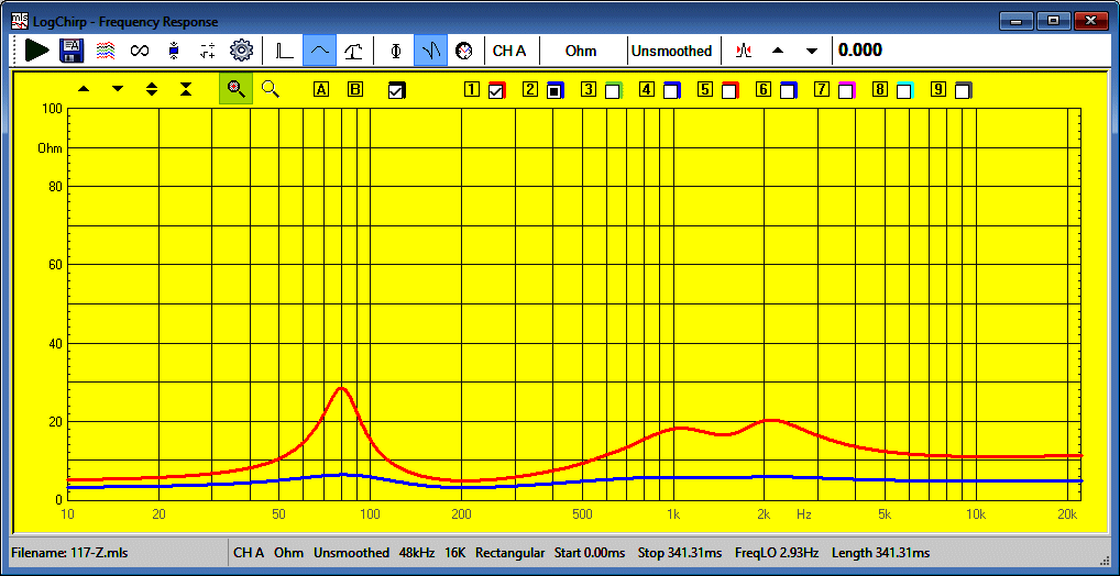

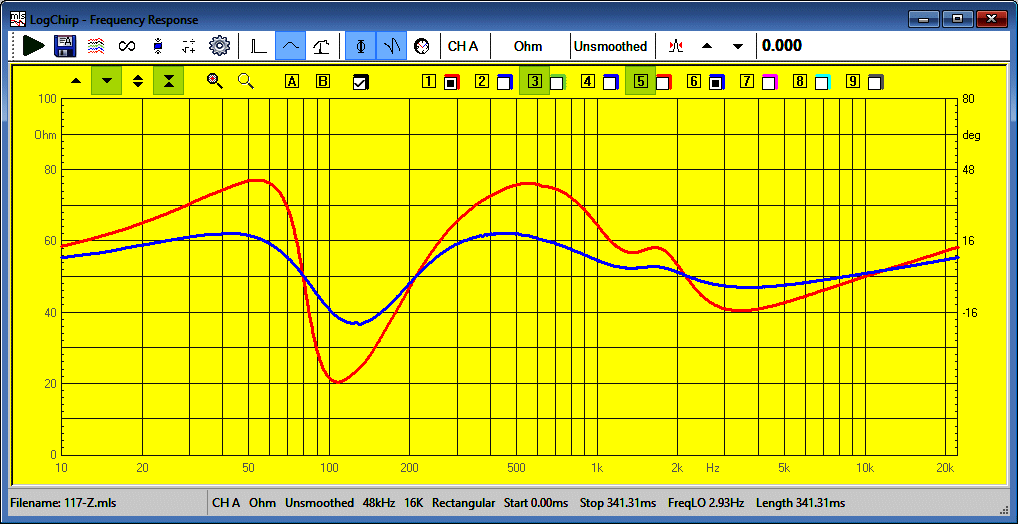

Now this is where some parallel 8R 100W resistors were added and the two Z responses below:
We can see that through the critical mid-frequencies how flat it looks. At those frequencies there is a lot more current going through the parallel resistor, I did a quick calculation, About 71% goes through the resistor at 2KHz and 29% on to the crossover and on to the drivers. The amplifier sees more of the resistor than the speakers, particularly around the crossover point. Is this having a stabilising affect around the crossover. Yes, saying stable may not be the best word, but is is what comes to mind.
Let us look to the current phase angle:
We can see that above 1KHz the phase angle is under 10° deviation from zero degrees.
Of course this all looks very academic... until you listen to it. The difference in sound is not hard to spot and this neat trick, usually with 2-Way speakers like this, it has now been done so many times.
