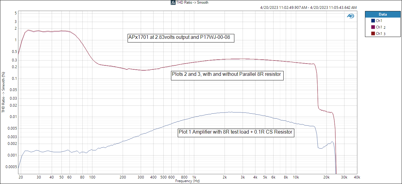

Hello All,
All this test lead stuff has been sitting open on the bench for a couple of days.
I did find that with and without the 8R test resistor in parallel with the driver there was no measurable difference in current distortion through the driver's sensing resistor.
APx555, APX1701 at 2.83 volts output. Edit 5 second frequency sweep
See the attached plot:
1) current distortion through 8R test load resistor + 0.1R Current Sensing resistor.
2) Current distortion through P17WJ-00-08 + 0.1R Current Sensing resistor only.
3) Current distortion through P17WJ-00-08 + 0.1R Current Sensing resistor With 8R test load resistor in parallel.
Test Plots 2) and 3) show that the parallel 8R test load resistor had no measurable effect on on the P17WJ-00-08 Driver Current Distortion.
Thanks DT
Edit: Distortion tests with a microphone will be more interesting to me.

For this test current flows through the 8R test resistor and or through the driver Voice Coil. The current is derived by measuring voltage across the Current Sensing Resistor(s).Where there any FR differences - electrically (voltage, current)?
There is no microphone to measure acoustic output, Sound Pressure Level, SPL or frequency response.
Thanks DT

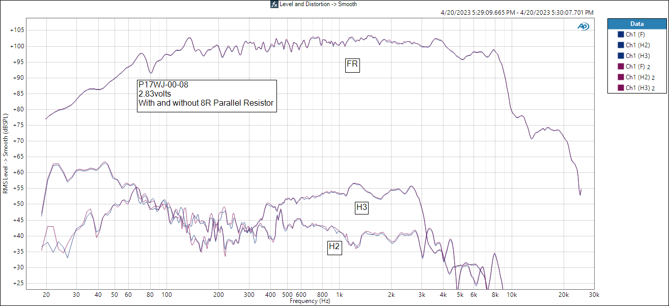

In #5511 I really ment electrically as in measuring the fundamentals on the input connectors.
No, not much in the acoustics FR /dist. But now we se above that there are really no difference using an 8 ohm resistor in parallel. To crown it, one have to do a strict blind test I suppose. Most probably it will not be detectable and if it was, there is something to be learned (I wouldn't hold my breath).
DualTriode said "the driver's sensing resistor" so it's in series with the driver, and the pair is in parallel with the extra 8 ohm resistor so it measures the driver current, not the amplifier current. So following, if the driver current is the same then the driver Voltage is the same and the measured response will also be the same.
Am I correct in noticing in 5512 there is -other than some minimal measuring differences- no measured difference in both SPL, H2 and H3 with and without the 8 Ohms parallel resistor?

The extra stuff you see in the plot posted in 5512 I believe is noise. The test plot used a test microphone that has its own noise plus there is additional noise from the analyzer and test amplifier cooling fans.Am I correct in noticing in 5512 there is -other than some minimal measuring differences- no measured difference in both SPL, H2 and H3 with and without the 8 Ohms parallel resistor?
Thanks DT

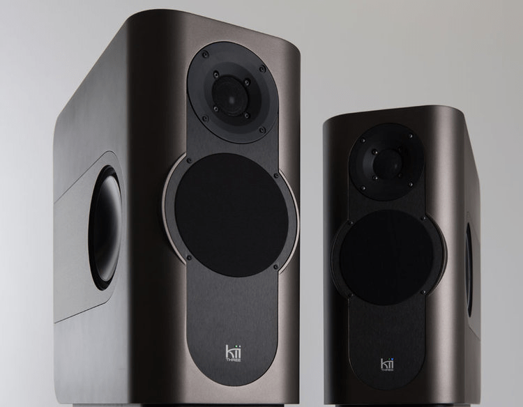

See that forward midrange driver in the Kii Three speakers, that is current-driven by what I believe is a modified NCore Class D amplifier. I have heard an Ncore amplifier that Menno Vanderveen demonstrated at ETF17 with an 18 Ohm output Z. I am sure he could have made it even higher than that as it was switchable to three different values, 0, 3 and 18 Ohm. The 18 Ohm sounded better and pretty much all agreed to that.

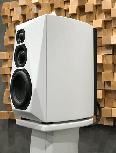

This is by SGR in Melbourne. See that dome midrange? These are also active speakers and that dome midrange is current-driven.

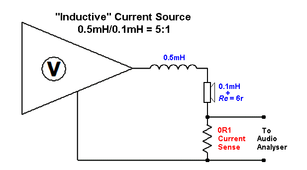

My 5:1 ratio, agreed upon by both Esa and myself in conversation ten years ago, apply that to the driver, add the highest value inductor possible - good drivers have lower inductance that is also more stable with motion/excursions.
The current sense resistor is only for testing purposes, so please ignore as it won't be used in a crossover. But the above example should be around -6dB circa 3KHz. It will give you the benefit of current drive around the crossover and the immediate octaves below. It should give you 15-20dB reduction (actually preventing) distortion that goes beyond the rate of roll-off. Now create the high-pass to match, may I suggest you look closely at the Elsinore high-pass design as a guide.

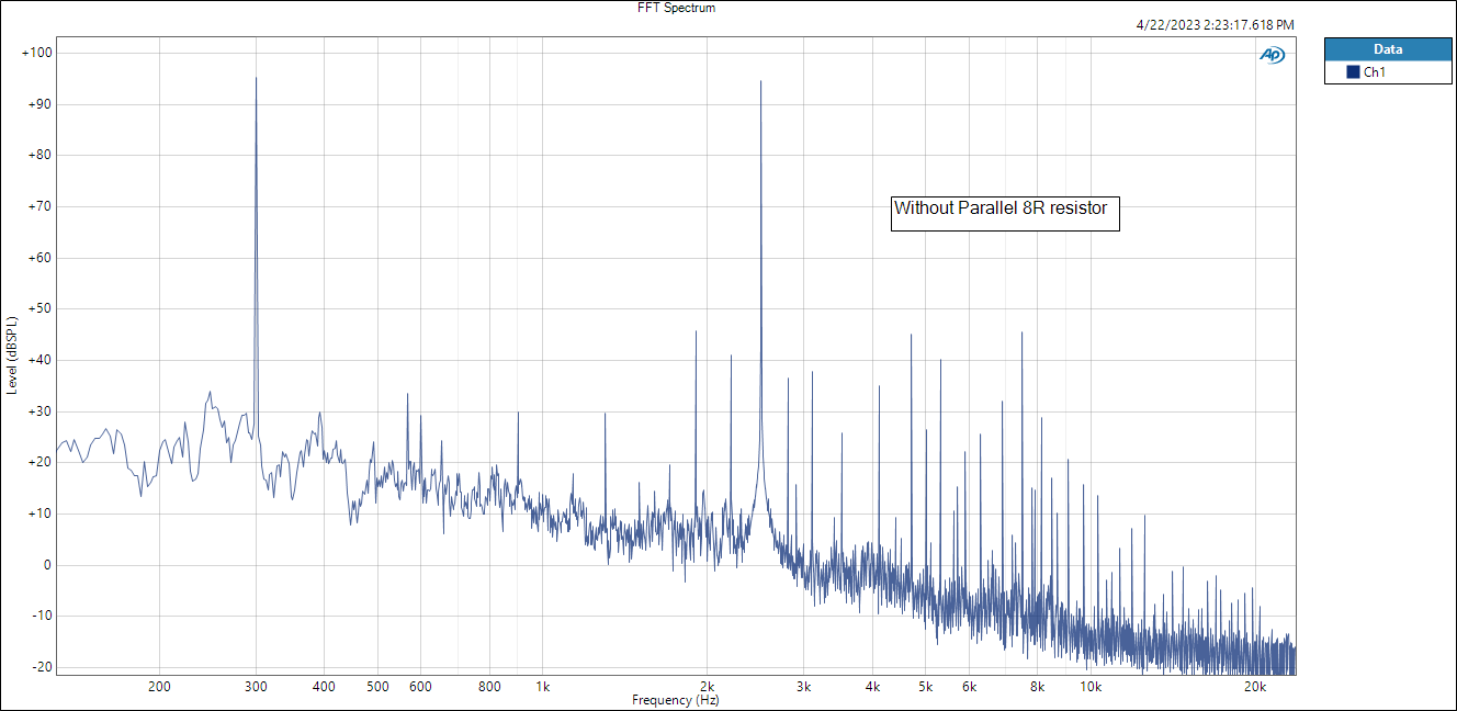

There may be some agreement, I am not sure to what extent.DT, you realise that I am not surprised, I can do the same measurement and up to H5 at that and more. As we discussed earlier are you proceeding or just resting here? I made sure you got Esa's article and what are you going to do next? Harmonic distortion test like that is not going to show up much, you will need multi-tone IMD and showing products that go way beyond H3. Agreed?
If you start adding Harmonics they rapidly fall outside the usual bandwidth we usually use for audio measurements. Do not be discourage about the common practice of using H2 and H3. I put FR and H2 plus H3 on the same plot, there was a request for Frequency response. FR does not show up in the current sensing resistor only tests.
If you look at the previous post (5508) Total Harmonic Current Distortion was measured across the driver's current sensing resistor.
If you want Two-Tone tests here they are.
The plot with the added parallel 8R resistor seem to have a little less noise, otherwise they are pretty much the same.
Thanks DT
