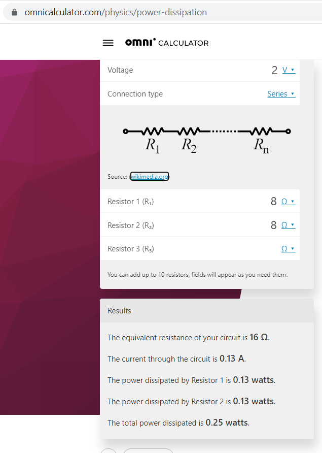

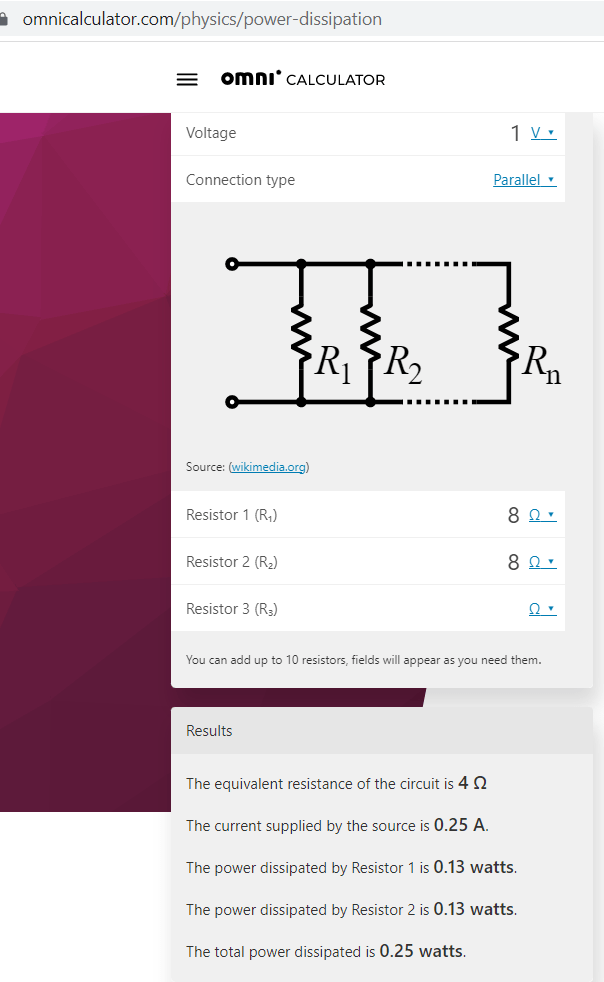

How about amplifier power? with series resistor current through voice coil goes down so we need to increase voltage to get same current through voice coil to maintain acoustic output. With parallel resistor the current through voice coil stays the same, but the parallel resistor draws additional current from the amplifier so amp power is up. Both cases, about same amplifier power is required to maintain acoustic output, both waste power as heat in the resistor. Simplified resistor / parallel calc attached to illustrate.
To get some particular SPL out of some particular loudspeaker there needs to be current x through voice coil which means voltage over the voice coil needs to be the same. Resistor in parallel with loudspeaker keeps the voltage on the loudspeaker terminals the same, but series resistor drops it. In other words, with series resistor current drops for given amplifier voltage because circuit impedance went up, so we have to use more amplifier voltage to get the current through voice coil back up.
A parallel resistor seems waste of amplifier power for no obvious benefits, while the series resistor wasting same amount of amplifier power could reduce acoustic distortion from the loudspeaker and noise from amplifier, perhaps alter frequency response of the loudspeaker, depending on the loudspeaker drivers and the crossover network within. This is because distortion and noise sources are voltage as well, and at same voltage per same acoustic SPL regardless of circuit impedance and amplifier output voltage in use. Now with series resistor circuit impedance goes up, current from these goes down so acoustic output from them goes down. With parallel resistor circuit impedance through voice coil stays the same and none of this happens.

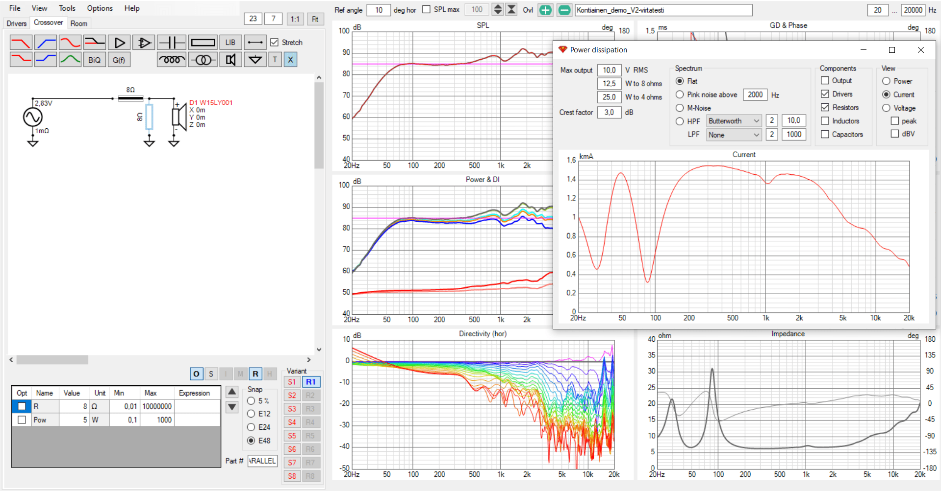

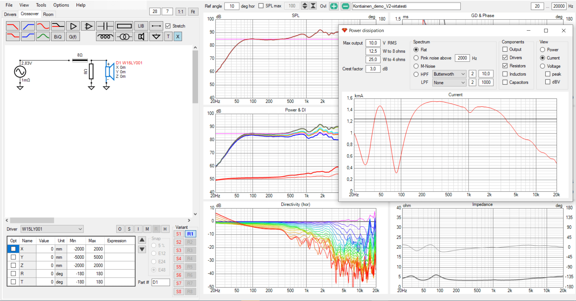

Sorry I'm flooding it but its nothing new so feel free to skip.
Thought to post this last one, VituixCAD has View > power dissipation window, which can be utilized to see current through the driver or any other component. This can be toyed around to find out what changes with high amplifier output impedance, or any impedance network between the amp and driver.
It doesn't provide view on acoustic distortion of course, but one can put the voltage source in series with the driver to emulate what currents backEMF voltage would do in the system. Or imagine the voltage source is the mains hum and what happens to acoustic output with added series or parallel resistor. Or inspect current of the driver / any component to evaluate when the current is up or down.

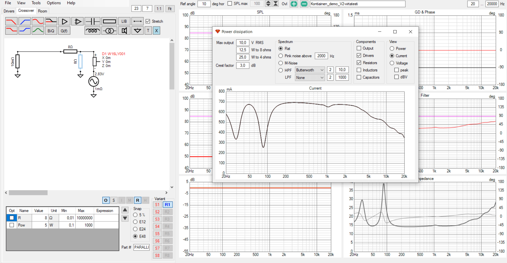

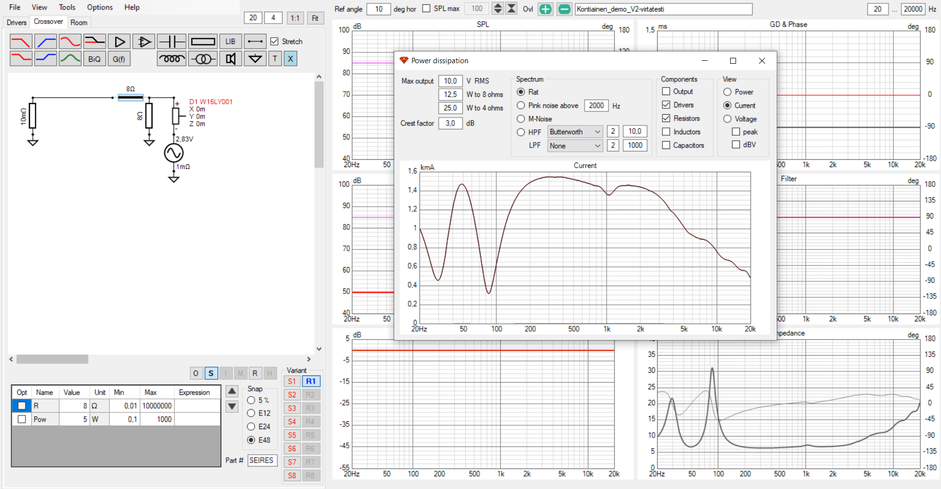

the backEMF example. Current flows through amplifier output impedance, and about none goes through the parallel resistor. The amplifier is here as Thevenin equivalent on the left represented by the output impedance only. The voltage source is next to the driver emulating backEMF voltage source in the driver.
The added series resistor reduces current from the backEMF voltage, but the parallel resistor doesn't because output of the amplifier (on the left) shortcircuits it. Current through both the amplifier output and the driver is the same on both cases, they are atop each other on the dissipation window.
Here is currents, amplifier like usual, driver unmuted to see frequency response et all. Parallel resistor changes the amplifier load impedance, draws additional current. Current through driver stays the same with or without the resistor, so acoustic output is the same.
These few images visualize all the my posts on this subject in this thread 😀 If someone is wondering whta the heck, its easy to replicate, open kontiainen-demo project shipped with vituixcad and experiment away.
