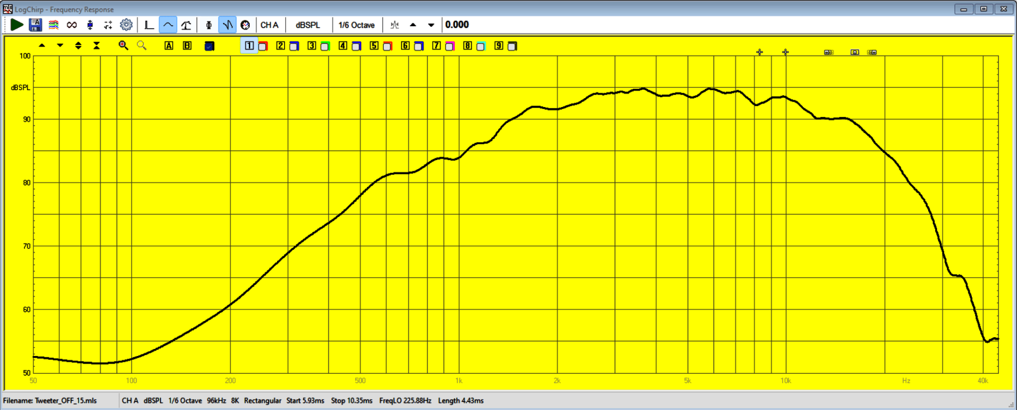

The existing Waveguide is not to be sneezed at. On Sunday I got this pleasing result shown below:
A thing of beauty, if I may say so myself.

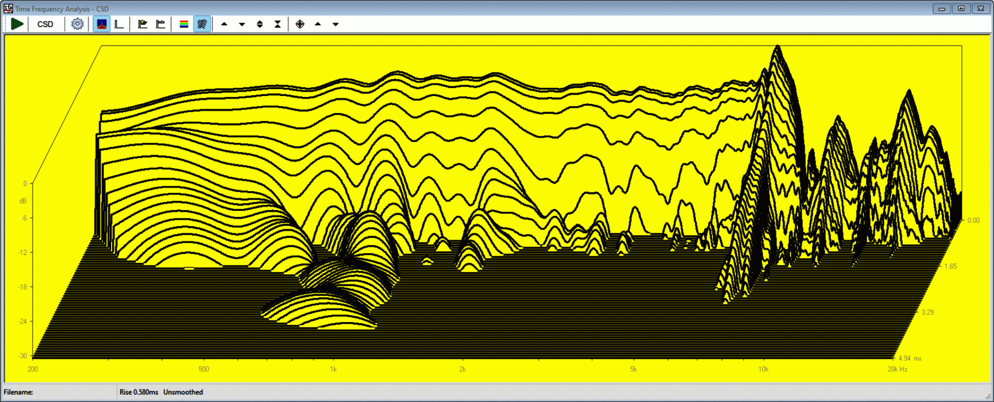

Our Waveguide was designed to be optimum at 15° off axis. That is how the above was measured at 2 metres outdoors on Sunday.
I am still quite proud of the work I did ten years ago with this Waveguide. It does exactly what I set it out to do. 😎 👍

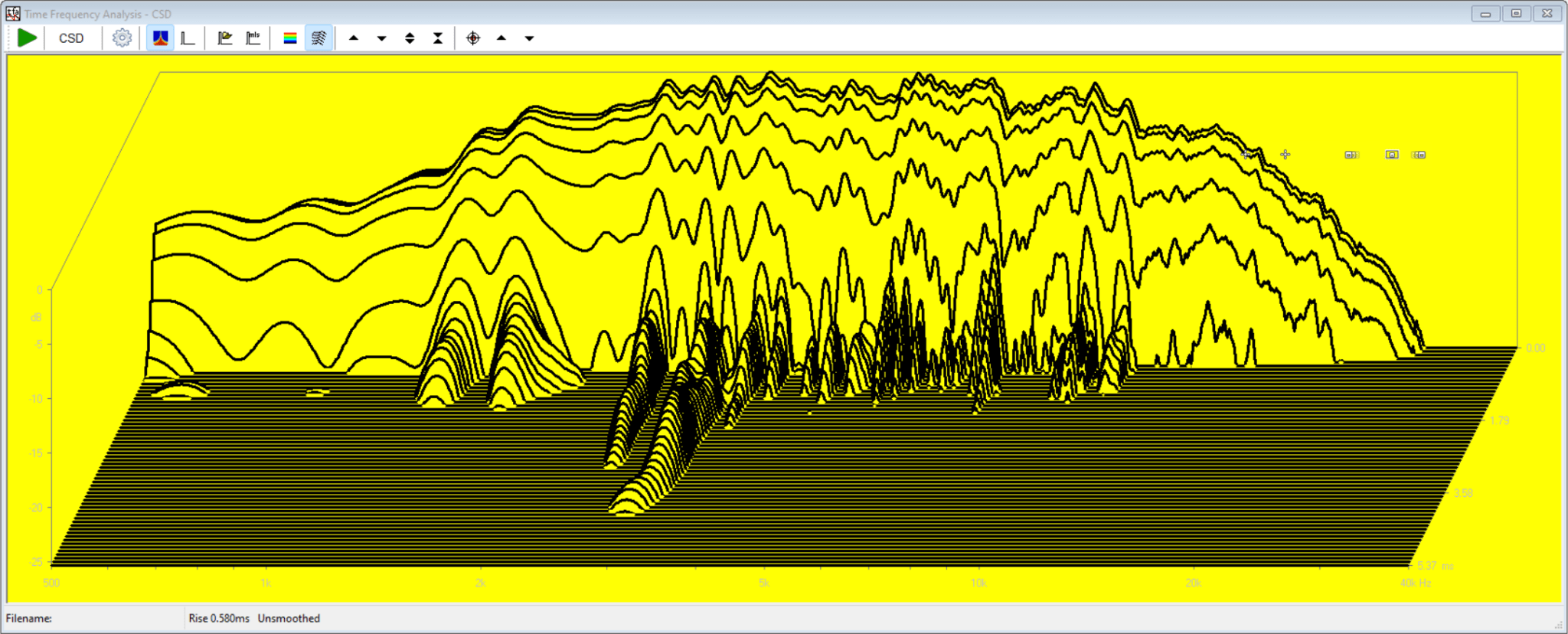

CSD (Waterfall) plot:
Later this week, as I have all the measurements to proceed, the data will be processed and exported into SoundEasy where we can work on the Crossover.

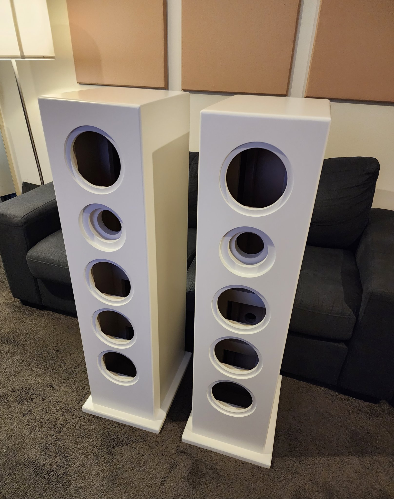

BOXES READY TO GO:
We are not totally discounting using the SB26CDC yet, but since all the measurements have been done with the D2608 and that I have expensive Waveguides in stock, and that sensitivity is good (the SB26CDC somewhat challenged here) and 8 Ohm and not 4 Ohm... so you can understand my decision, right? There is no guarantee that the SB26CDC will work out, but it does not mean that we won't try again in the future.
Have you seen anybody who has put on the net drawings to fit SB26CDC. I would like to see more if available. I have seen website www.somasonus.net/sb-acoustics-sb26 - but I need a way to look at step files. Is there any software for free, it definitely looks worthwhile to look. I am interested/curious.
BOXES READY TO GO:

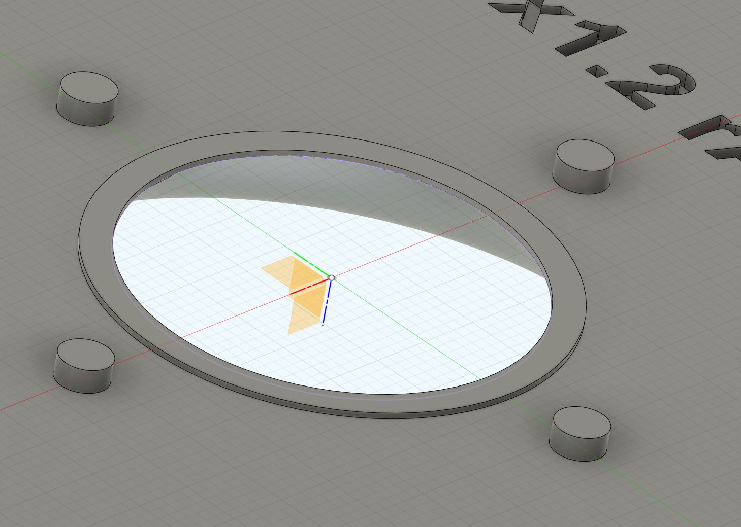

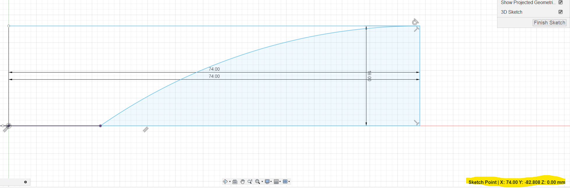

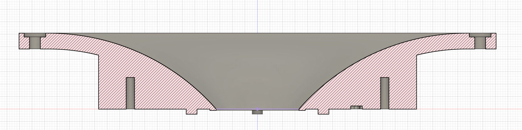

The throat on the SB26 waveguides are 33.02mm with a 0.5mm thick spacer on the back.
To make something with the same type of performance to fit the Elinsore cutout needs something like this.
The yellow highlighted sketch point co-ordinates in the image will allow a circular radius of 100.808mm to be drawn between the throat and mouth edge.
Thanks. So the face plate of the tweeter removed? That would explain the 33.02mm, that diameter sits right outside the Tweeter's surround.
Yes. Something could perhaps be done to match the existing faceplate, but it is usually better to start the waveguide profile as close to the surround as possible.So the face plate of the tweeter removed?
Must be really close. It is critical.
With the SBC26CDC it might be possible to do with the original face plate.
But not unless you snip the little phase plate cover off. It prevents any waveguide getting right in there. It is possible that the current Elsinore Waveguide, which has the 32mm diameter at the throat and that is bang-on where it needs to be. If we can modify the back of the waveguide enough and get it right inside so that there is no gap, that could work very well. But the phase thingy has to go and I don't mind that too much, but it does leave it more unprotected against accidental physical damage. But the depth of the waveguide does give it some protection. Keep children away, hmmmmm...

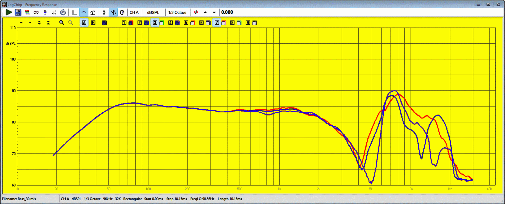

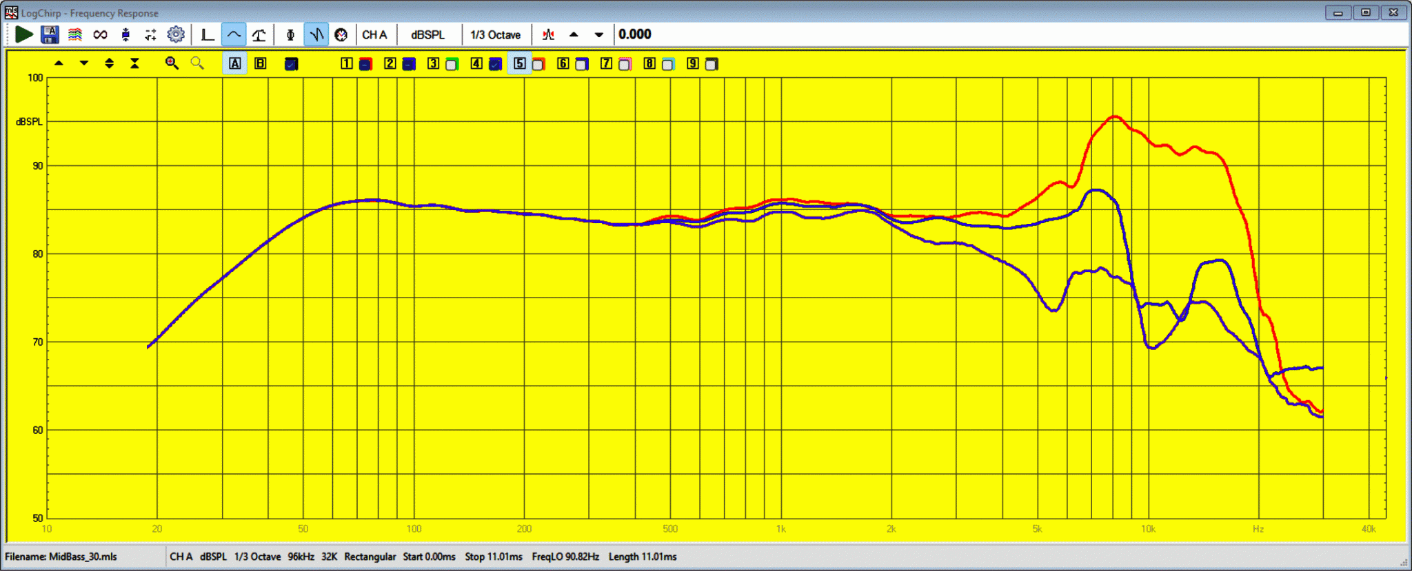

"NBAC" Update:

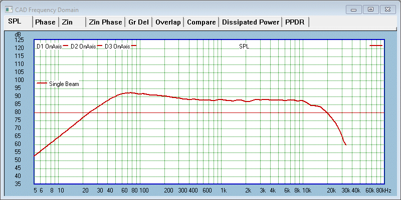

I showed the Tweeter, and I thought I should show you some results of the far-field/near-field splicing and FR of the driver in situ, in the box.
This is the top two drivers, these will of course be part of an MTM array with the Tweeter.
The slight bulge around 70-80Hz is a product of the nearfield measurement, it is somewhat flatter than that, by around 2 or 3dB.
Below is the bottom two driver, note the suckout is caused by the fact that, unlike the two top drivers are co-distant, the bottom two drivers are not. The second from the bottom driver is closer and the bottom driver is slightly further away. Keep in mind that the microphone is at the height of the Tweeter and at 2 metres:
The two driver will be rolled off from 400-500Hz up first order. By the time we get to the midrange above 1-2KHz, we get a 3rd order effect and this is a good thing for the midrange. All Elsinores benefit from this trick.
Finally, since the top two drivers will supply the midrange, then below is the 15° off axis at 2 metres, this is the CSD (waterfall) plot:
Around 7-8KHz there will likely be some kind of LCR correction. That means our component count will be higher than "MFC" (14) and "ULD" (15) and possibly as high as 18.
From what I can see so far, the final system voltage sensitivity of the completed design will be around 89dB/1m.

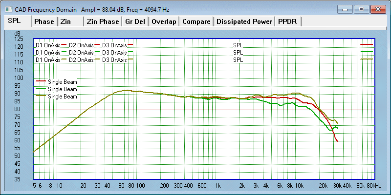

"NBAC" Update:
I have now been busy for a couple of days dealing with the data current available. At this stage we don't have anything reliable to go in with regards to the SB26CDC tweeter and there is no way of saying with any certainty that it will work satisfactorily. Again, be have a lover sensitivity and lower 4 Ohm impedance compared to our well-know Peerless HDS/SS-D2608 8 Ohm tweeter.
So for now I went with the HDS/D2608 tweeter and familiarity already told be that it should not be an issue at all.
Results below.
Please note that the results below were modeled in SoundEasy V28 and not actual final measured results, but I have high confidence in the results as this is familiar territory.
As per previous Elsinores, the optimum frequency response will be 15° off axis:
Comment: Very flat response indeed. A single LCR is tuned around 7KHz on the upper two drivers that forms an MTM array with the tweeter. It was tried also on the bottom two drivers (they fill in the diffraction loss of the bass) and deemed not required, they are well rolled off by 7KHz. I am in the school of not over-correcting everything I see, and sometimes don't see (something about not throwing out the baby with the bathwater). The voltage sensitivity will be around 88dB/1m. The rise at LF are the result of the near-field measurement of the port, it can largely be ignored (besides, it faces to the rear and the rise is not in the near-field of the drivers itself). The port is also relatively free off issues (minor at 400Hz) , as both the measurement above shows as well as the impedance plot. Again, the minor 400Hz is face rear and not front towards the listener. All in all, I am very pleased.

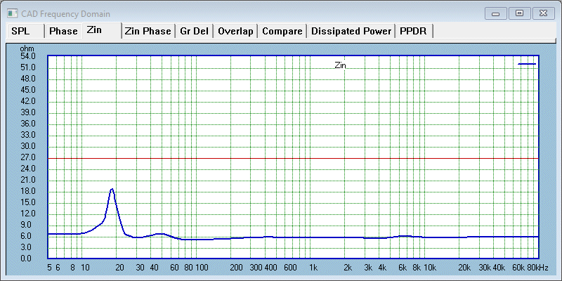

Let us look at the impedance plot:
Comment: Why don't we see this in any commercial speakers? The lowest Z is 100Hz and just above 5 Ohm. Often, when finalised and a real measurement made, it will be even more flat at LF than the modeling, but we shall wait and see. Above 5KHz it looks like it will be even flatter than "MFC" or "ULD" versions. The reason is that the HDS/D2608 tweeter is padded down and looks even more resistive. You can see an undulation centered around 7KHz, this is where the LCR referred to earlier, shows up. Avoiding the second LCR pays off here, the undulation would otherwise be greater. Now the only question remains, is it possible that this improves the sound, to get a result flat like this? I believe it does and is part of what Elsinores listens to and likes.

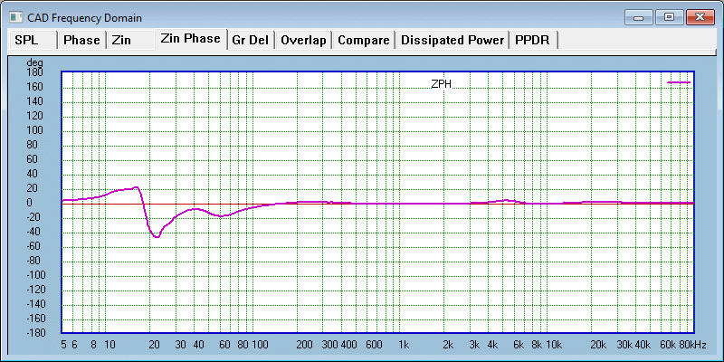

Next, the electrical phase:
Comment: Pretty much flat above circa 100Hz. Does it make a difference? I believe it does and I am working on showing why and come up with results that should go along way to satisfy the critics.
Finally, the family of frequency responses:
Comment:
Grey is ON axis.
Red is the same as before, 15° OFF axis.
Green is 30° OFF axis.
This is fairly similar to "MFC" and "ULD" versions. If a bit dull in a damped room, toe in more, if a bit bright, toe it out to suit.
I like what I see.
Everything I see says to go down this route with the HDS/D2608 and the waveguide we already have. It might be a ten year old designed waveguide, but it still does exactly what I want from it.
Is there still a hankering for the SB17CDC tweeter? Even if there is, I can't make any promises.
Any comments?
Cheers, Joe
