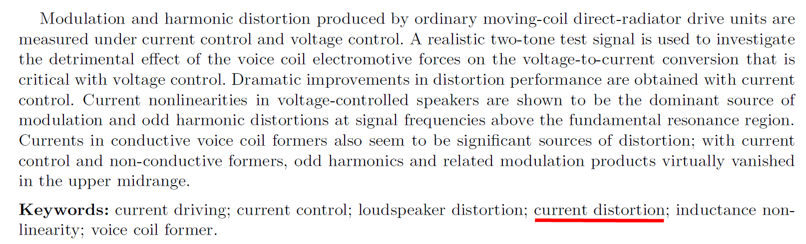

After the markets closed I spent some time reading this paper.
Comparative Measurements on Loudspeaker Distortion: Current vs. Voltage Control
Esa MERILAINEN
Yes I have read it before, this time I focused on V / I conversion. The term V / I conversion shows up 12 times in this paper. The theme is that EMF causes serious current distortion as the driver converts input voltage to current.
All the distortion measurements were taken at Small signal levels. You know at about 1 Watt or less. 2.83V RMS as well as 2.00 Volts was also mentioned in the paper.
My measurements of the P17WJ 00 08 are consistent with the results in the paper.
It is my impression that driver Voltage to Current conversion needs to be included in the driver distortion “KISS” model.

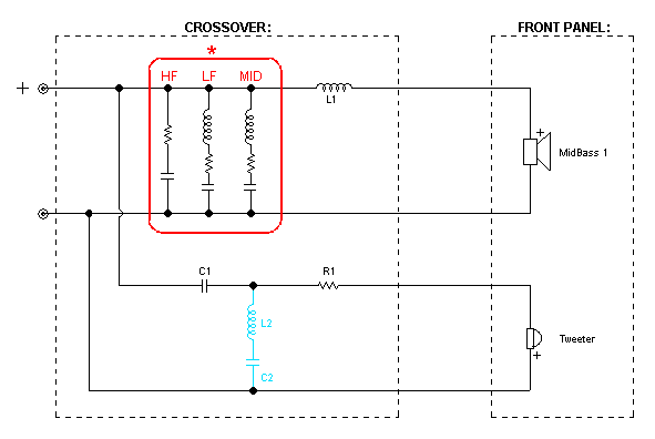

Below is how it is applied in a 2-Way with the added bonus of current EQ which locks in both the bass alignment and the crossover and presents a flat current phase angle to the amplifier:
Of course, driver selection is important.
Adjust L1 to be -6dB @ 3KHz, and adjust C1 also to be -6dB @ 3KHz (waveguide is useful here). The L2/C2 is a null filter tuned to the Fb of the tweeter, the Q is adjusted to give you that flattest FR at and below the 3KHz crossover.
The above is not that hard to do if you set your mind to it. Adjust values so that the best FR is about 15 degrees off axis, never straight on axis. Just my experience.

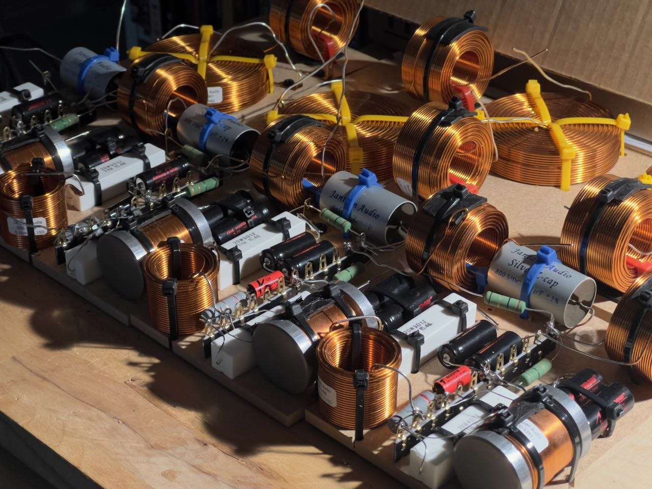

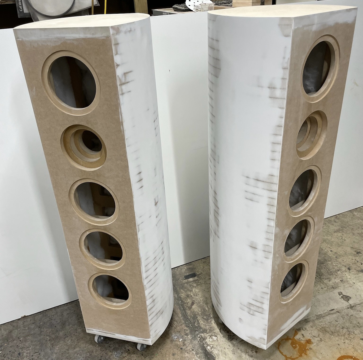

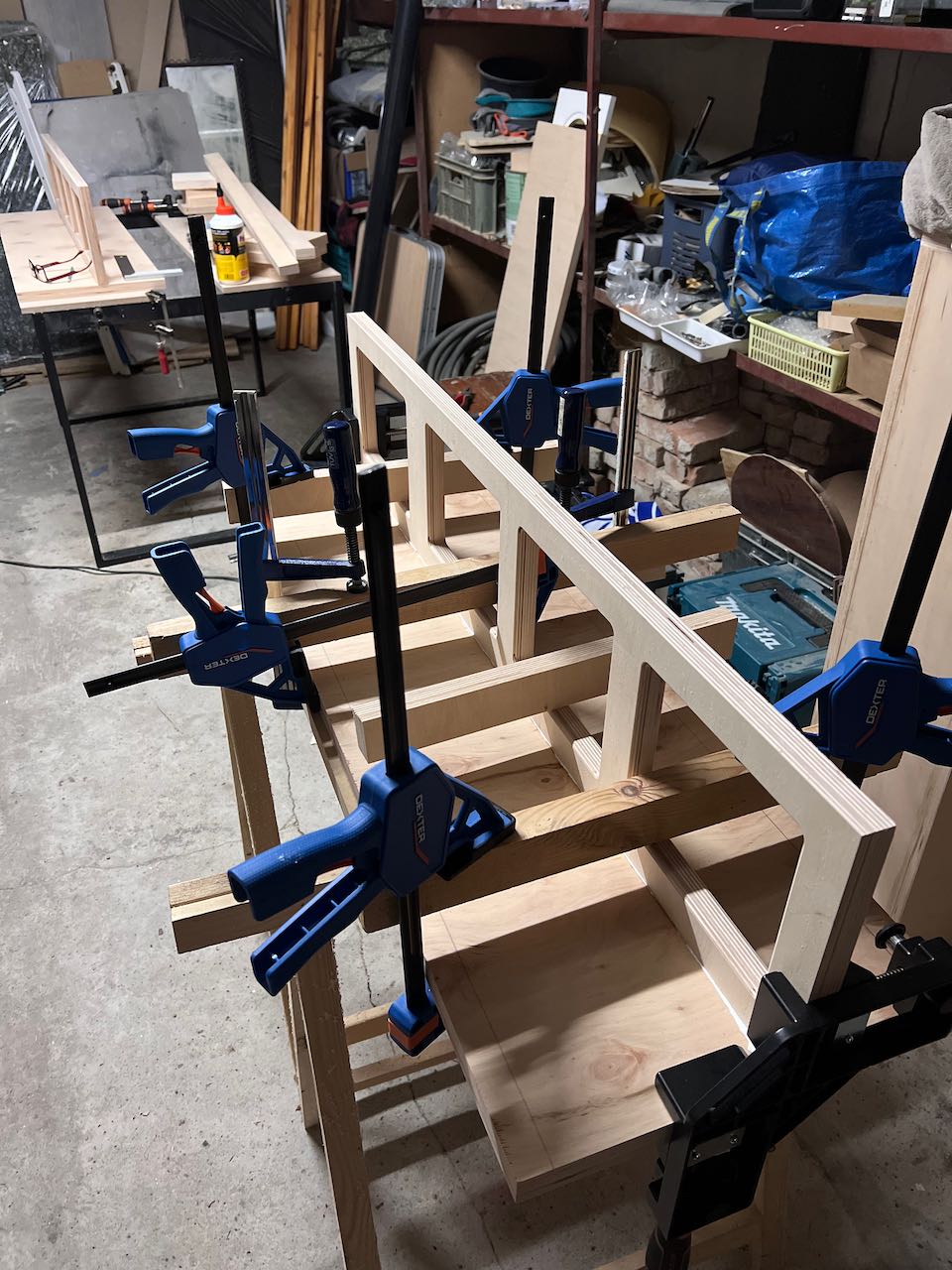

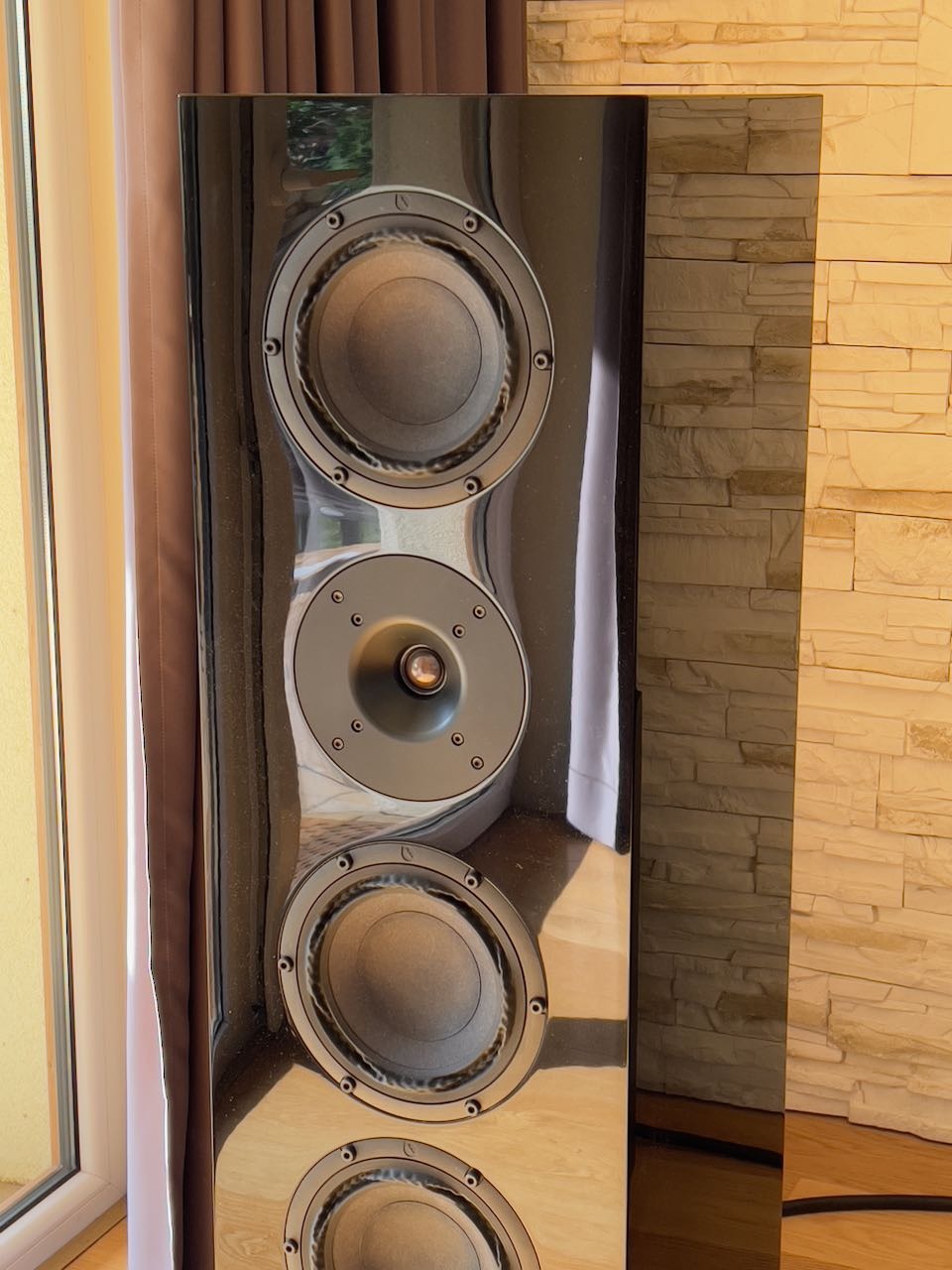

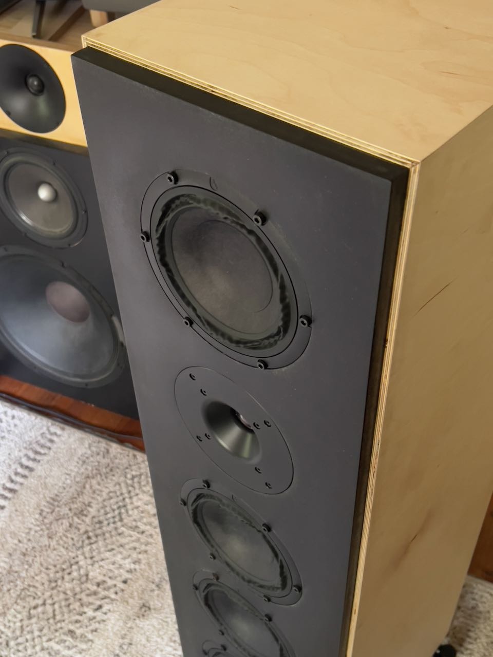

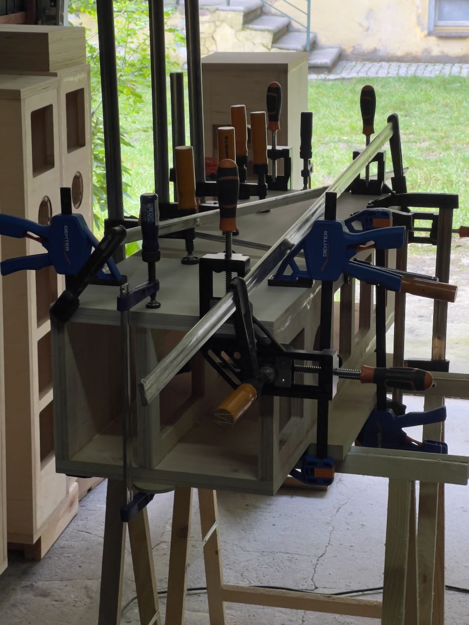

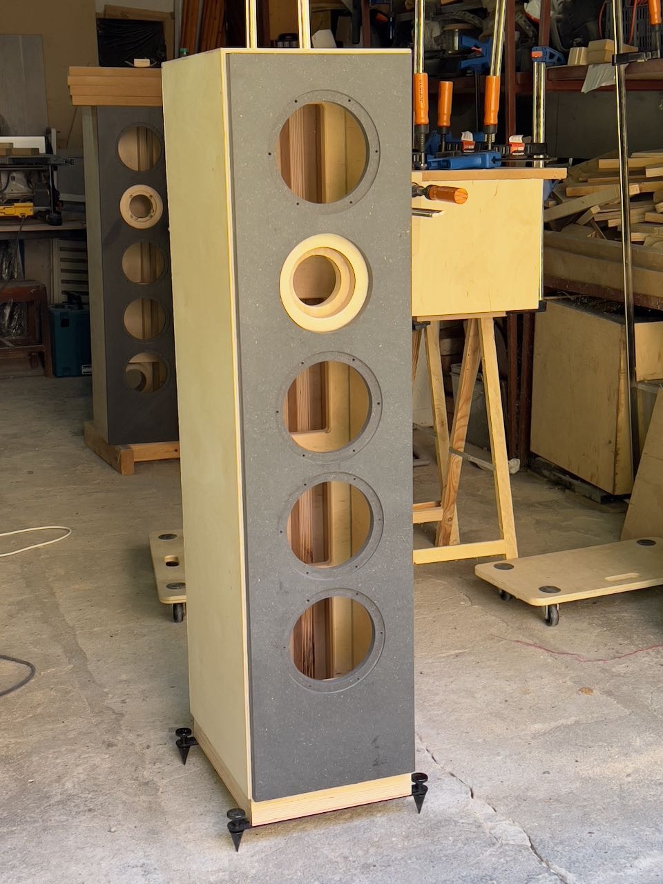

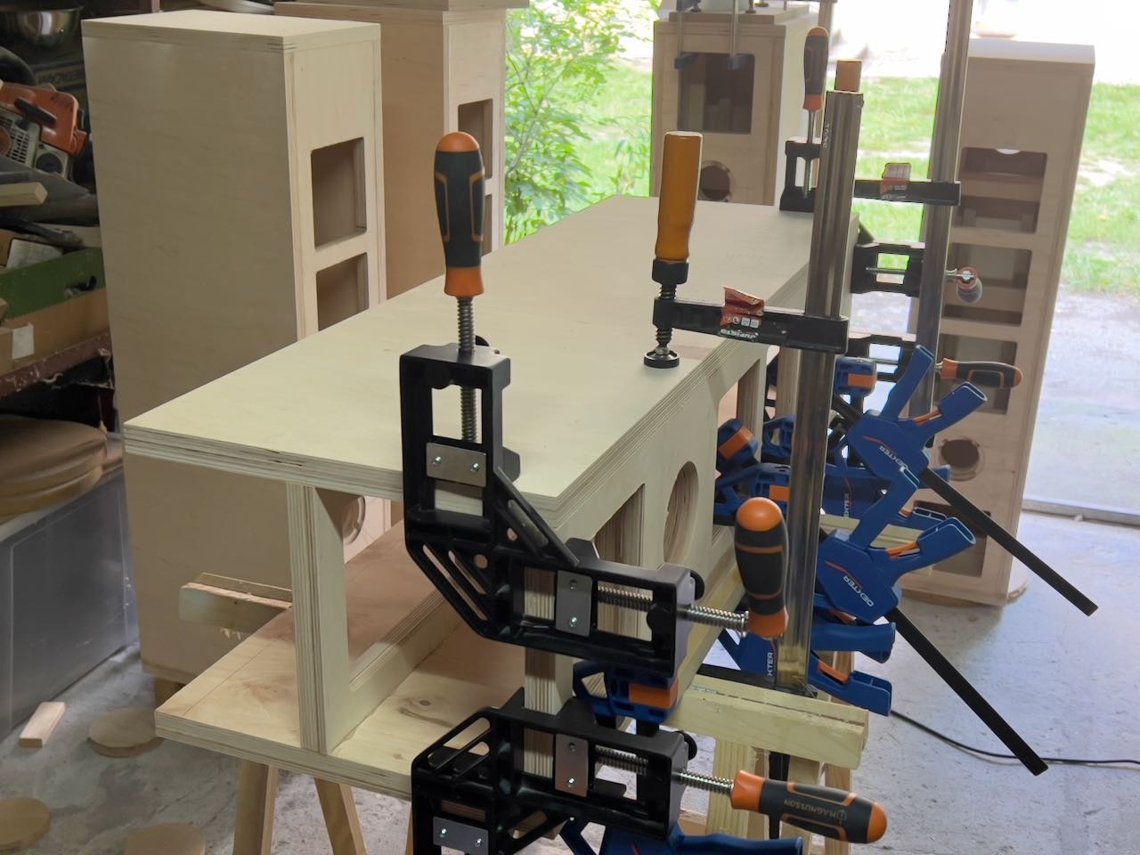

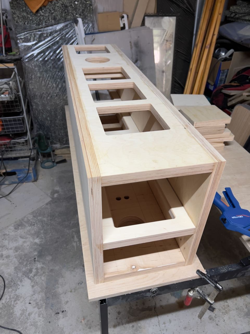

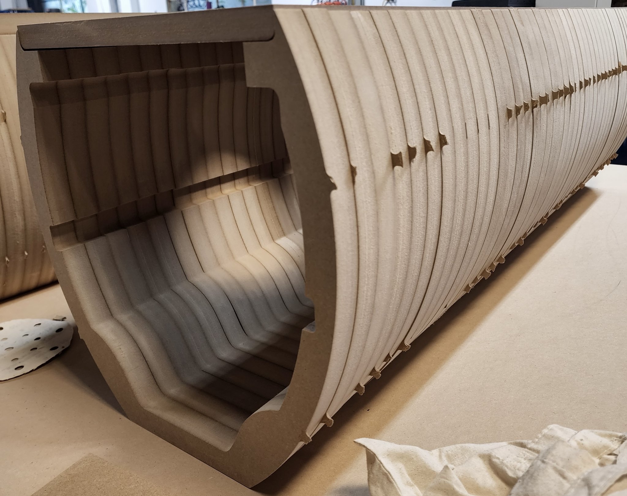

I was aiming for September and it worked! Two pairs of Elsinore ULD play beautifully. It is true that I still have the final finish of the front and walls in my pair, but the second pair, which was varnished by the professional, is fully ready. Just wipe off the dust and fingerprints after mounting the speakers 🙂
And the impression from the first moments of listening? Better, tighter bass. So bouncy. And a cleaner, dynamic midrange. And a unique way to build a very precise stereo image. I like it very much. Yes, Purifi is doing some serious work. There is a joy to listen to. I'm very happy.
Thank you Joe.
PS. There is still work to be done on the third and fourth pair. MFC version. The ELSINORE inscription will be stuck under the front. First I have to correct the letter N 🙂
Thank you Joe.

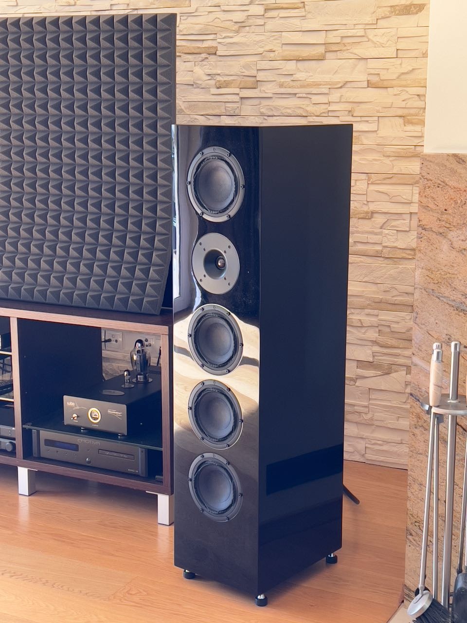

Congratulations! 🙂 Your speakers look great. Impressive. I’m sure they sound a million dollars too.
After hearing some of my favourite tracks on the Mark 6, what I knew already was really hammered home. I was missing a lot of mid range and bass with my Focal 918’s in my very poor acoustic room. I just had to get my hands on a pair of the Elisnore’s. The only issue is my hands-on DIY skills and tools are limited, so I’ve had to work with others to get my pair built.
Fast forward 6 months and my Elisnore’s are about two weeks away from competition. Curved boxes.
Alfebear,
Any build pics? 🙂
Good luck and hope you can get the speakers up and running very soon.
Any build pics? 🙂

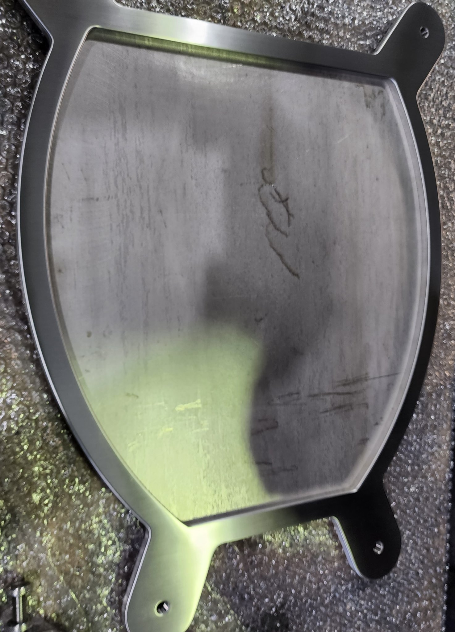

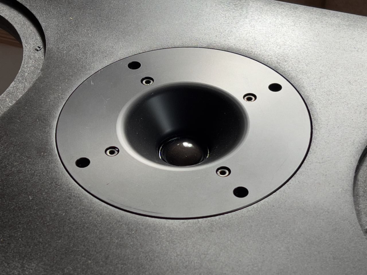

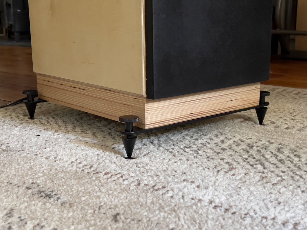

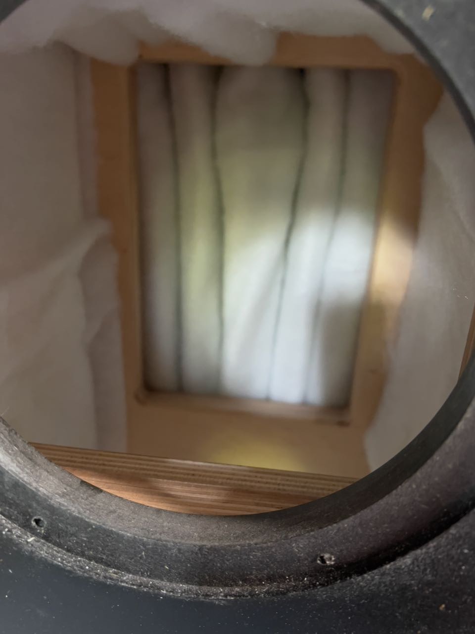

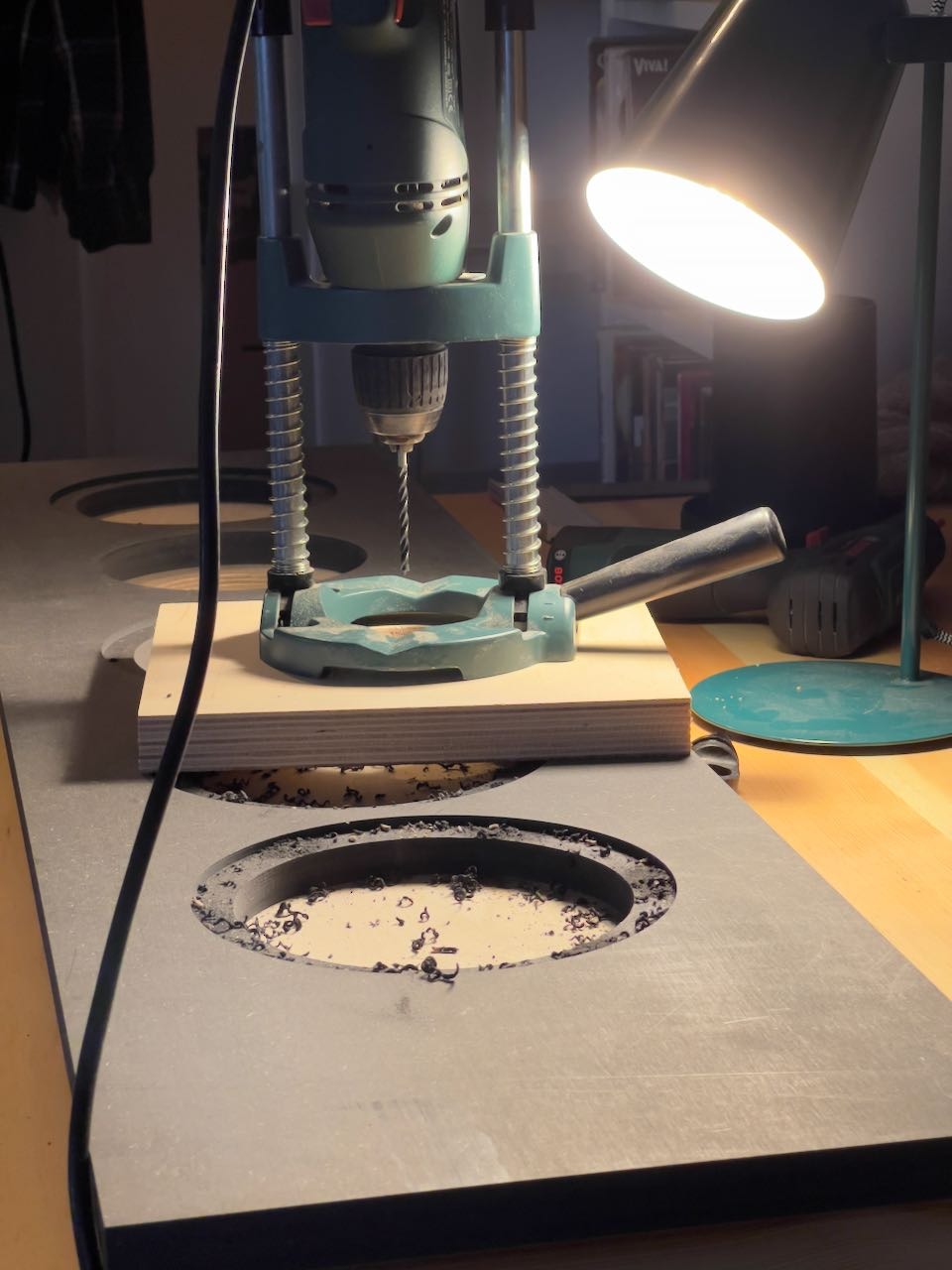

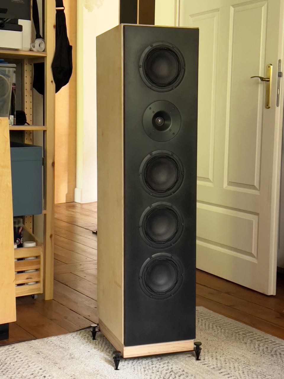

Hi, a few pictures.
Such a fun project.
Unlike some of you that are serial DIY builders that like to move between a variety of speakers, I hope that the Elsinore ULD‘s will be my sole main speaker for years to come.
This approach has led me to going a bit overboard e.g. sunken stainless steel base plates 😉
The internal volume of my curved boxes are identical to the Mark 6 boxes.
I’ll post a few more pics, once everything is in place and I’ve had time to listen to music and appreciate the whole package.
I was a bit reluctant to post earlier, as this tread appeared to me to move away from the Elsinore‘s and general DIY education, project excitement and the community of DIY audio.
For someone getting into DIY audio, whether building themselves or working with others who references a specific speaker DIY threads, it would be great if every now and then, the thread is steered back to the core DIY project. My opinion only. Reading about the Purifi option with the Elsinore in this tread in Nov 21 is what enticed me to seek out someone with the Mark 6 version.
Happy to share feedback on the sound soon.
