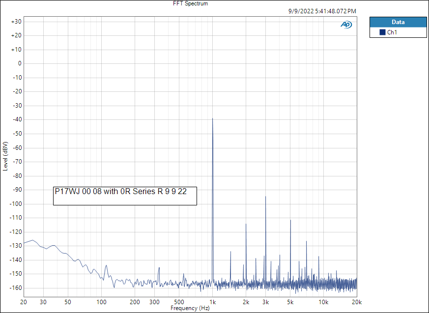

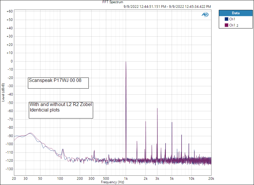

This morning I did some measurements on a Scanspeak P17WJ 00 08 driver with and without a L2 R2 coil model calculated 2 Resistor 2 Capacitor Zobel.
I used this driver and Zobel thinking that I have not observed any one with strong positive feelings about the model or driver on this thread. I am keeping the resistor and capacitor values under my hat so no one will call this a design or a competition.

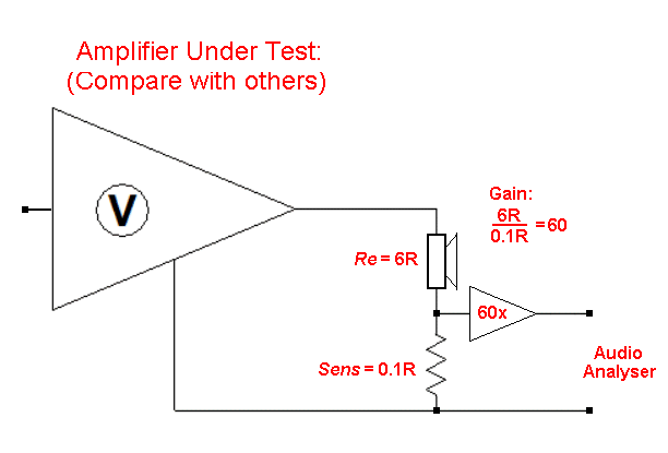

The source amplifier is a Audio Precision APx 1701 with a sense resistor included.

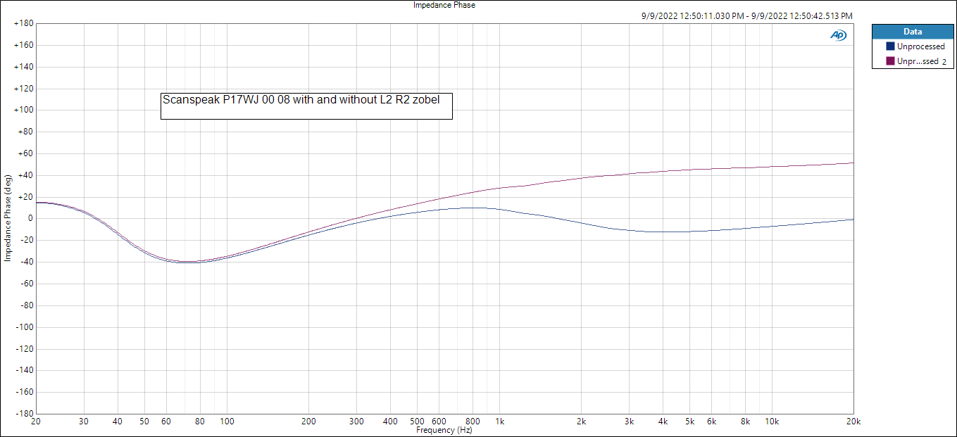

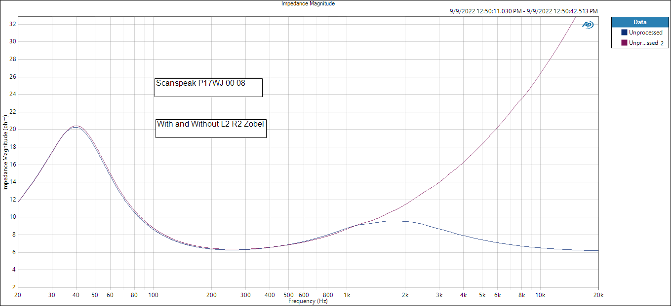

There was no measured current distortion difference with or without the Zobel.

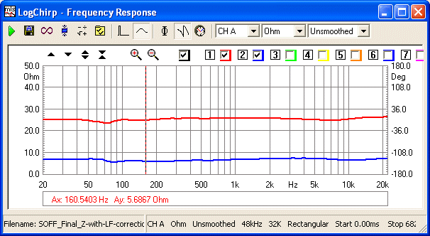

Note the reduction in impedance and impedance phase angle with the Zobel included.
View attachment 1089304 View attachment 1089305 View attachment 1089306 View attachment 1089307
Thanks DT
The amplifier output voltage was 2 V RMS
Hello,why would you expect a difference ?
Personally I would not expect to see a difference, if fact I would be surprised if there was a difference .
I have see others post here that the amplifier may/will distort with the increasing inductive impedance load. Recall all that "unstable impedance" kind of talk.
Thanks DT
hello DT,
Me neither. the Zobel is a linear circuit shunted with the driver which draws the same nonlinear current irrespective of the Zobel. The Zobel draw some fundamental current but as your impedance graphs show then the current at 1kHz is very low.
If the amp is really bad then the load impedance phase change may affect its distortion.
By adding a series resistor between the amp and driver the effect of current drive can be mimicked partly. So e.g. add 8 ohms and increase the voltage to drive the same fundamental current. Then I would expect a reduction in the current distortion to to the increased load impedance seen by the voice coil.
Lars

The traces are the same.It hard to really see whats going on in the distortion graph. Colors are deceivingly similar (to me). The magenta trace hides the blue, but to what extent is not easy to know.
While the analyzer was running I toggled between the traces they are the same, same with no difference. I guess that the point was that one plot completely covers the other.
Colors are different for me. I am red green color blind. For stockcharts.com I can see purple for down and gold for up. Red and green are very similar shades of gray.
Thanks DT
When I do this again I will plot two separate plots, one with Zobel and one without.

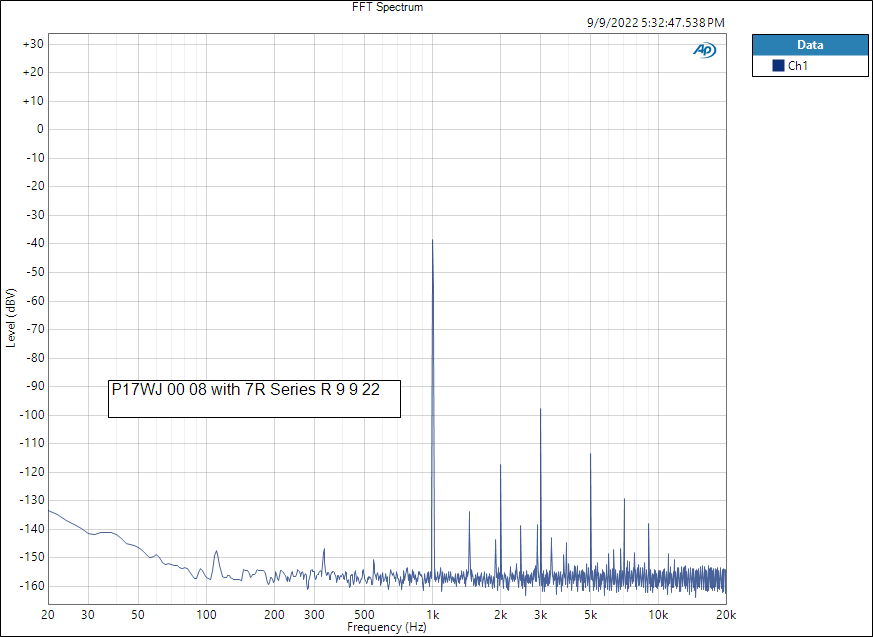

I had a bag of 7R Mills resistors handy, same ones used in the previous Zobel.
The Harmonic Distortion peaks are maybe reduced by 2dB's with the 7R resistor in series with the driver. The voltage across the sensing resistor was adjusted to be equal with and without the 7R resistor in place. (equal current)
Not much of a difference to my view.
Thanks DT

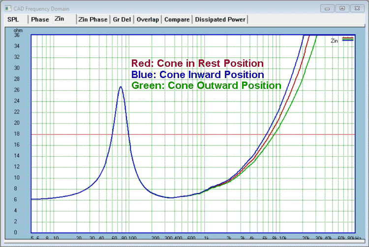

Main message is of course that the more there is excursion on a driver the more there is this distortion current, so the distortion current can be reduced also by reducing excursion, or use better quality driver with less non-linearities. Acoustic low pass does also something similar, lowpasses distortion products as well. But still there is opportunity to further reduce distortion current with the impedance. Many ways, just something good to know and consider while designing loudspeakers.

We must use an actual driver for these measurements, not resistors nor
I am hoping that the Vifa P17WJ-00-08 will become the standard driver to use.
I have a pair and they have a very well-controlled flaw. And the ones I have measured have been very consistent. I believe that Scan-Speak has brought out more of them, not sure what the number is limited to.
Keep in mind, if you had the perfect driver, the measured distortion on the voltage side would show up as identical distortion on the current side.
But to set the record clear, with a perfect load and say 1% voltage distortion, that will also show up on the current side as 1% distortion.
But what if you now connect an imperfect driver? The same 1% distortion will show up on the current side plus there will be even more caused by "EMF derived distortion" - as Esa Merilainen calls it. This is not a guess.

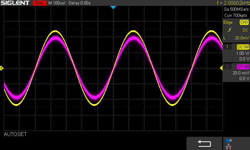

What are we looking at below?
This is 2 kHz sine wave. The voltage is yellow and maroon is the current.
How do we get this on our two-channel scope?
So we clearly have two sinewaves at the same time, one is the voltage, but also there is a delayed 30° current phase angle sinewave caused by the inductance. The amplifier has reacted to our real driver, not a dummy load.
Which of these two sinewaves are you listening to? You cannot be listening to two sinewaves, only one. The time difference precludes it.
Common sense tells us that at 2KHz we are listening to the delayed 2KHz and that means what?
You are listening to the current of the amplifier!

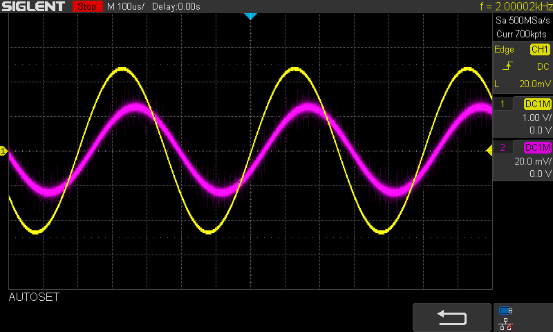

Now, what about our thought experiment above?
Note that the amplifier now produces ten times the current. It a lot of current. It will get very hot, but hey this is a thought experiment.
Will there be a reduction in the current distortion of the amplifier? Now connect up our audio analyser... interesting...
Further proof below: Look what has happened to the current phase angle? Now isn't that interesting, they almost line up perfectly in time. Note that the maroon is the total current of the amplifier. Try to induce driver EMF problems now.
Not only does this trick about parallel resistor to tame the current of the amplifier, indeed we know that a number of famous speaker designers and brands do this. When I visited Ulrik Schmidt I brought this up and he admitted to me he also knows names that did use it. Hush-hush.
Often when you see the impedance plot of these speakers, you can spot it. Did anybody say Wilson... ahem?

OK. But not if it looks like this:
Please let me explain something that is tricky to get across. The above is an actual measurement using Clio 7 some years back. It behaved like a sealed box but it was an aperiodic vent. Single impedance peak. Treat it like it was a sealed box.
Blue is the impedance, Red is the current phase angle.
Now here is a thought, make the amplifier produce the same current at all frequencies, even LF.
Guess what? This is really neat.
You can use current drive and get no change in FR near resonance.
Even the crossover gets be locked in, no matter what the source impedance.
