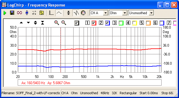

I remember the first time I tried it on a speaker and I got this electrical outcome:
The reaction was instantly obvious: What is happening here?

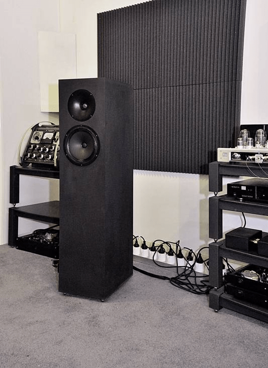

The photo below is from our Music Room. Yes, we have a Music Room in our house and there is no Hi-Fi equipment in it. But it has a real Yamaha piano. 😎

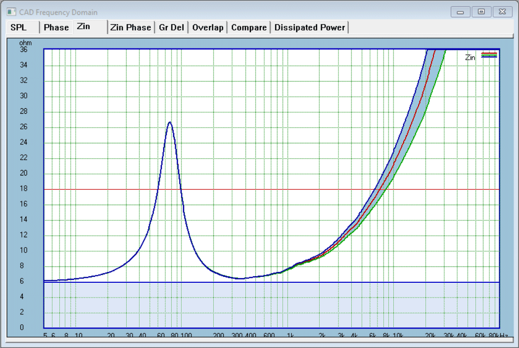

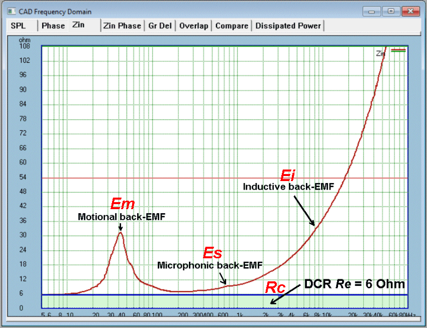

May I borrow from Esa is electrical equivalent circuit of a driver. I have sneakily edited a few things in Red in order where they show up in the impedance plot of the driver.
We have all seen bog standard impedance plots and they don't show anything special, right?
Actually, that would be very wrong. Let us dissect what an impedance plot reveals.
Here RC is the DC Resistance of the voice coil. Let us say 6 Ohm.
Ei is the inductive Back-EMF.
Em is the motional back-EMF.
Es is the microphonic back-EMF.
Rc or Re is the impedance formed DCR, the stable part of the impedance.
The first three are E in the sense they are electro-motive forces.
That also makes them voltages. Electro-motive forces are voltages. Why are so many resisting that? (There is a pun in there, did you spot it?)

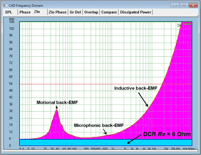

Let us post our example impedance plot and identify a few things:

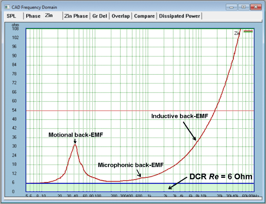

Let us make it a bit more obvious and match up with Esa's equivalent circcuit:
Ahah! Is it starting to make sense? All four of them are right in there in our impedance plot.
Now we see where all the elements are, Ei, Em, Es and Rc.
EVERYTHING ABOVE THE BLUE LINE IS BACK-EMF.
We will make the back-EMF Purple. In fact there is more Purple than Blue. It swamps it:
Only the light Blue is resistive and everything above that is caused by back-EMF.
There is a reason that this is not called front-EMF.
And there is a reason that it is EMF, Electro-Motive Forces = Voltage Sources!
But it shows up vertically and as Ohm.

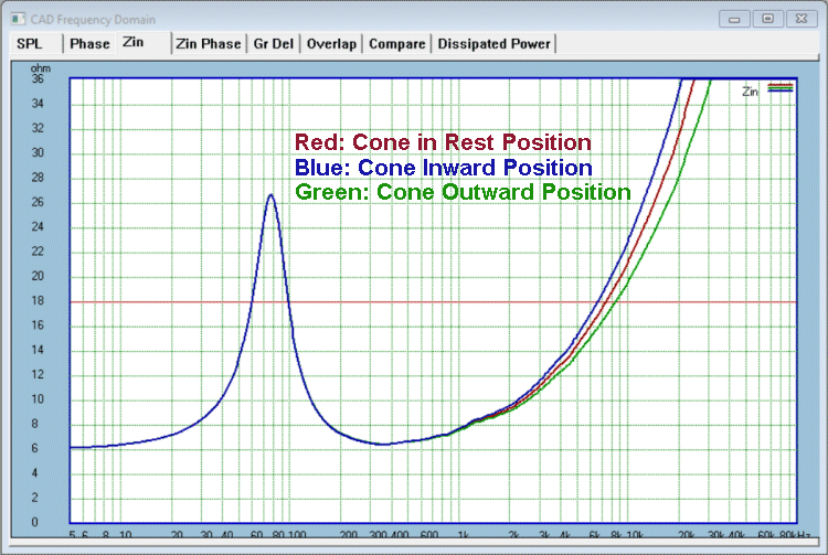

But here is something the impedance plot can only hint at.
IT IS MUCH WORSE:
Back-EMF induced distortions must take something into consideration, that the impedance of an average but good driver looks something like this:
You do not have a stable impedance. Only the Red one above is known by you. In actual fact, when music with multiple instruments are playing... you do not know the impedance is at any moment in time!
Is any of this being understood by you guys?
Excursions!
Everything vertically causes current by the amplifier. If you pick any frequency where you find the impedance to be 12 Ohm, produce a voltage of 12V at that frequency and the driver will draw 1 Ampere. The current is inversely proportional to the impedance. The impedance goes up and the current will go down, and vice versa.
Excursions!
There is your wild card.
Cause significant excursions at low frequencies and what will happen to our stable current of 1 Ampere at the frequency where we thought the impedance was 12 Ohm?
I mean, this is not exactly rocket science.
The truth is that our impedance plot is not nice and clean and has a fuzzy character. That leads to fuzzy current and that leads to more distortion. This is the distortion that current drive is supposed to prevent.

Question for Joe: how come in your view an inward move of the cone yields a different Z than an outward move? Aren't we talking simple a-symmetry in the suspension of the voicecoil?
@Boden,Question for Joe: how come in your view an inward move of the cone yields a different Z than an outward move? Aren't we talking simple a-symmetry in the suspension of the voicecoil?
While Joe sleeps.
You may want to download the Purifi AES paper and search the term " position ".
The impedance of the voice coil is dependent on its' position in the magnetic gap.
a-symmetry in the suspension plays a smaller role.
Thanks DT
https://purifi-audio.com/wp-content/uploads/2019/12/PURIFI-AES-9607.pdf
The way I understand this from Joe is:
Play a low note, close to the impedance peak of the driver. The cone moves in the frequency of this lower note to create the sound, low note is a slow pace. Play a higher note simultaneously, while the lower note is playing. Now the higher note moves way faster in and out, barely moving the cone, while the lower note does move the cone.
As the lower note holds the cone in inward position, the higher note moves in and out creating it's sound... but it's position yields a different impedance than when the lower note moves the cone outward again, and the high note again swings trough it's own faster motion while the cone is largely outward.
The graph that predicts this for a driver is that Inductance graph:
So when the low note is keeping the cone at -2.5 mm position and it is simultaneously playing the higher note, Le is about 0.135 mH. Now the cone is swinging outward, and reaches +2.5 mm, while still swinging back and forth in a faster movement to create that higher note, In that position it is seeing an Le of 0.105 mH. (original graph and story here)
An IMD two tone test should show this difference, playing a low note that really moves the cone, while simultaneously playing the higher note, you should see a difference in the distortion figures between current drive and voltage drive. Unless you use one of them fancy drivers from Purify. Note that the cone really needs to move due to playing that lower note or you will not see the difference. Examples of current drive vs voltage drive here and here. Not every driver will show similar results, certainly not the Purify driver. And not all amplifiers are created equal either.
Next, Joe wanted to find a way to make a Voltage drive amplifier have a similar result. That's where the series coil and series/parallel woofers come into play. The series/parallel woofers limit excursion (less change in Le because of less movement) The coil? Well, we've read that here multiple times. Basically it has the same function as the high output impedance of the current drive amp. The impedance compensation? That does make sure that any amp's output impedance has no real life effect on the resulting frequency curve you get. Well, almost no effect, a very small difference remains at the port. Not sure yet about any other benefit of that compensation, that part is unclear to me. We do let the amplifier make about an equal level of voltage and current at each frequency this way, as it largely sees a resistive load.
Joe, thanks for your response. But I wanted to know what change in sound you heard when comparing the Elsinore's compensations connected and disconnected. Instead, we read about a friend who felt like he was listening to ribbons speakers when you played him some previous boxes with compensation. As I mentioned before, I did a listening test with speakers with a very ugly impedance curve, and with compensations the sound was no better. He was only slightly different and rather worse. So I didn't find a correlation between beautiful pictures with straight lines and better sound. That's why I see this whole effort of yours as a useless solution to theoretical matters.
