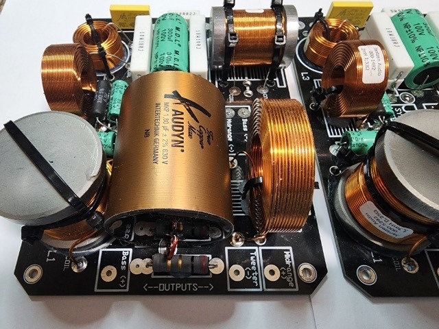

For the crossover I'm sticking with the wonderful overall design that Joe came up with, I'm just changing some values.
For the initial recalculations of the crossover using the new drivers I decided to experiment with dropping the mid/tweeter crossover point from nearly
6 kHz down to 2.5-3 kHz so that the tweeter was doing more of the heavy lifting above 3 kHz rather than just above 6 kHz.
For some weeks I have been fine tuning the crossover taking many frequency measurements along with listening tests. I have quite literally been switching in and out crossover components to allow quick listening comparisons.
I feel I am now close to a crossover configuration that I am happy with.
I have found that with the new SB17NBAC35-8 mid-woofer drivers there is more detail in the low to mid region along with an extended bass responce.
The SB26CDC-C000-4 dome tweeter has greatly improved detail above 2.5 kHz. I'm noticing background instrument detail that previously I have not been aware of. I believe the changing of drivers in my Elsinores has produced a positive improvement.

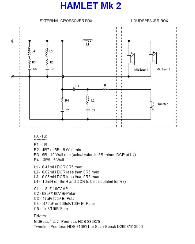

Hey Joe,
Very interesting regarding the discussion on changing out drivers... I have a question regarding the Hamlets. I know you're not planning on a purify version.. but any thoughts on whether one of the existing crossovers would be somewhat compatible with the drivers within reasonable range? As you might remember, I'm currently using the Mk2 version using peerless drivers... which is great but considering the added clarity to voices I heard when moving from Mk5 elsinores to the ULDs, and considering I'm using it as a center channel (where its often used for voices in movies, etc), I'm quite keen to consider any way I can to move to peerless drivers for the Hamlet..
Crossover version I'm using is attached.. I'd be happy swapping to the newer SB version xover too if it would be more likely to create a good result.
I am not exactly sure what you are suggesting. Using ULD drivers without a specifically developed crossover?
If so, sorry, but it is not something I could recommend. If you go back you may remember how long it took to get the MFC Hamlets out. There were reasons for this because it was quite a balance trick and it involved much work including a lot of testing and there was a realisation that the Hamlets had to do dual duty, both as a mid-channel as well as stereo pair.
Upgrading to the MFC drivers is a safe option, it's all fully developed. You need to recess the drivers by 7mm as per drawing and get the new crossover going. The box tuning should be fine where it is.

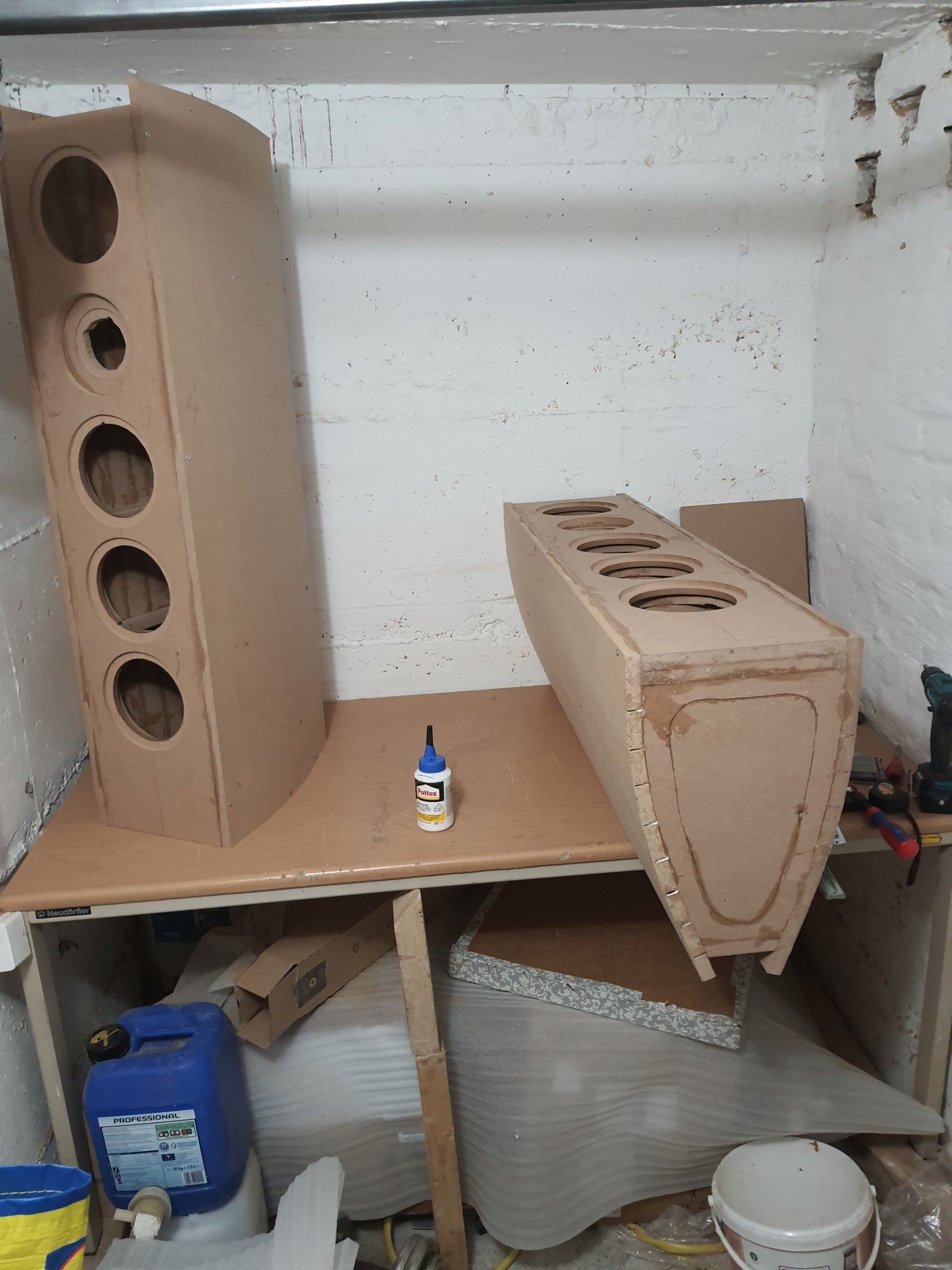

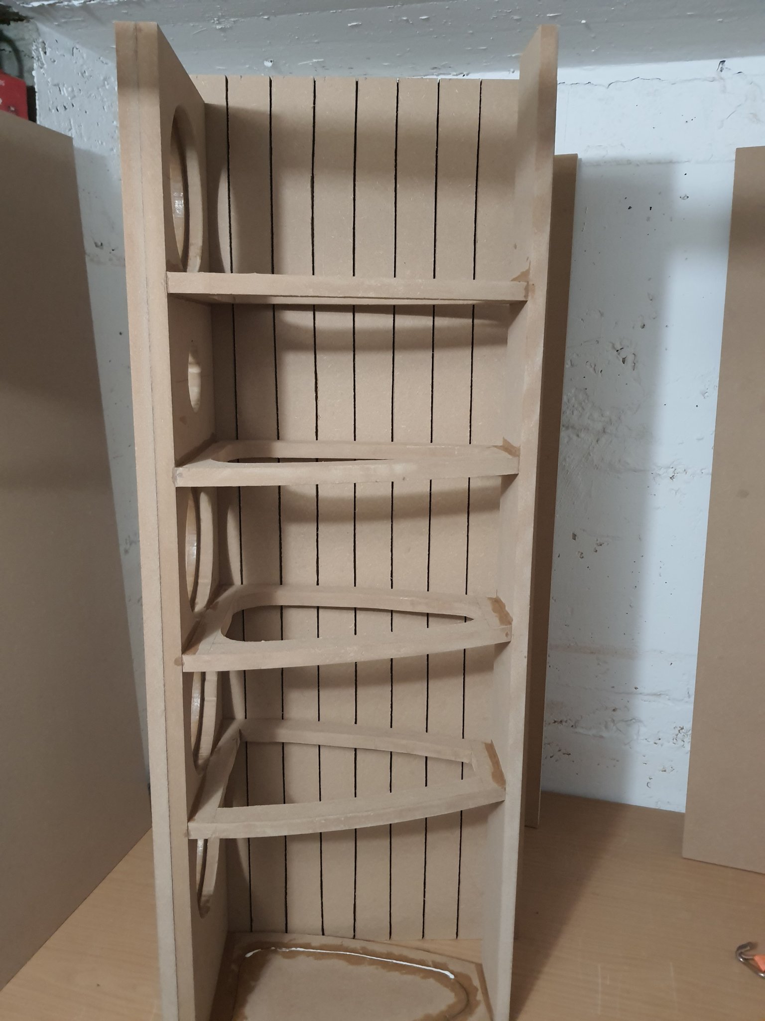

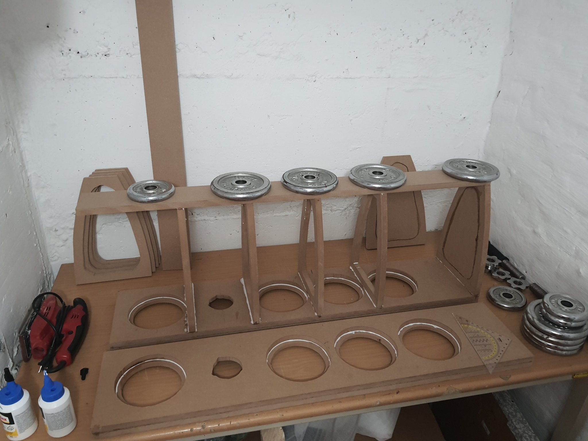

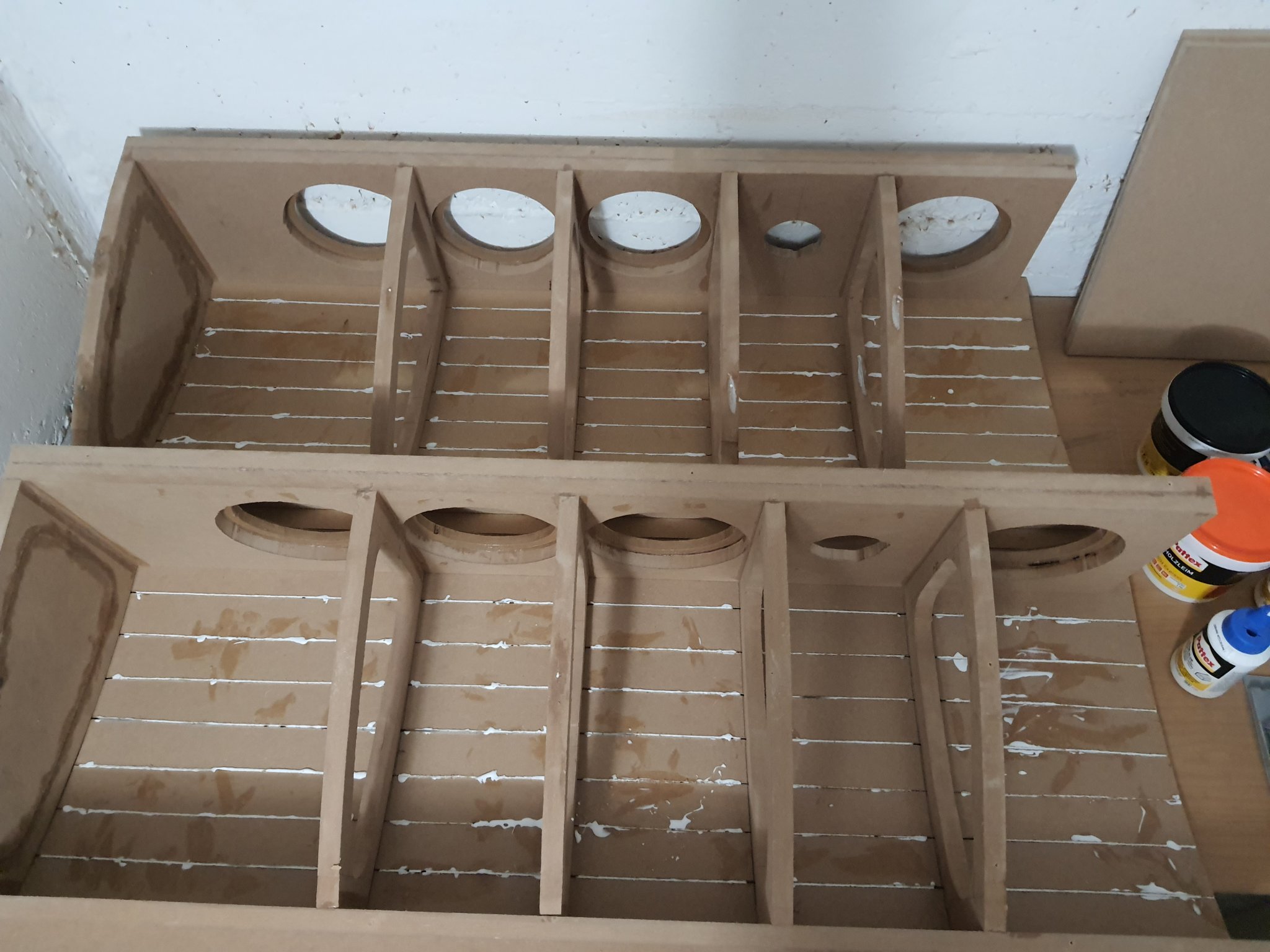

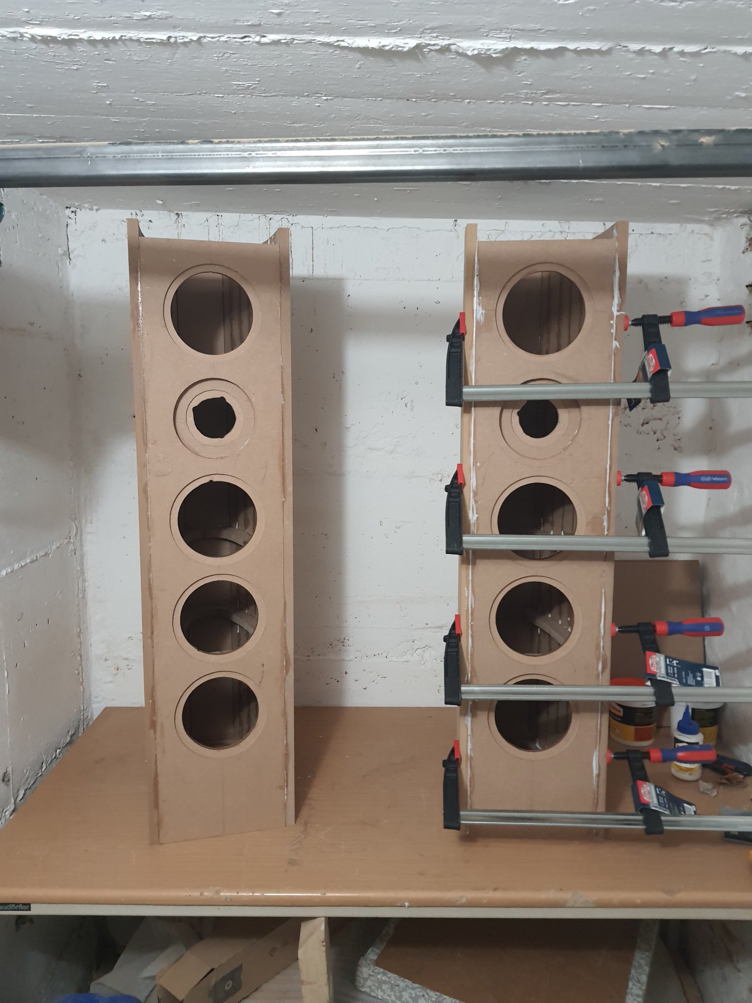

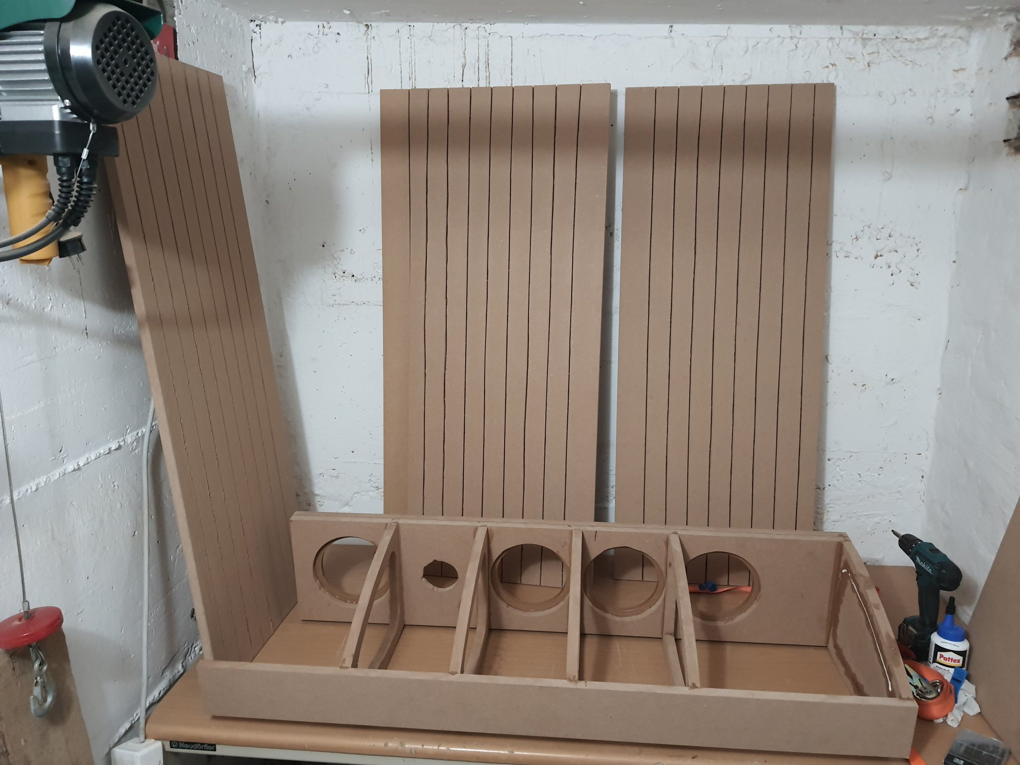

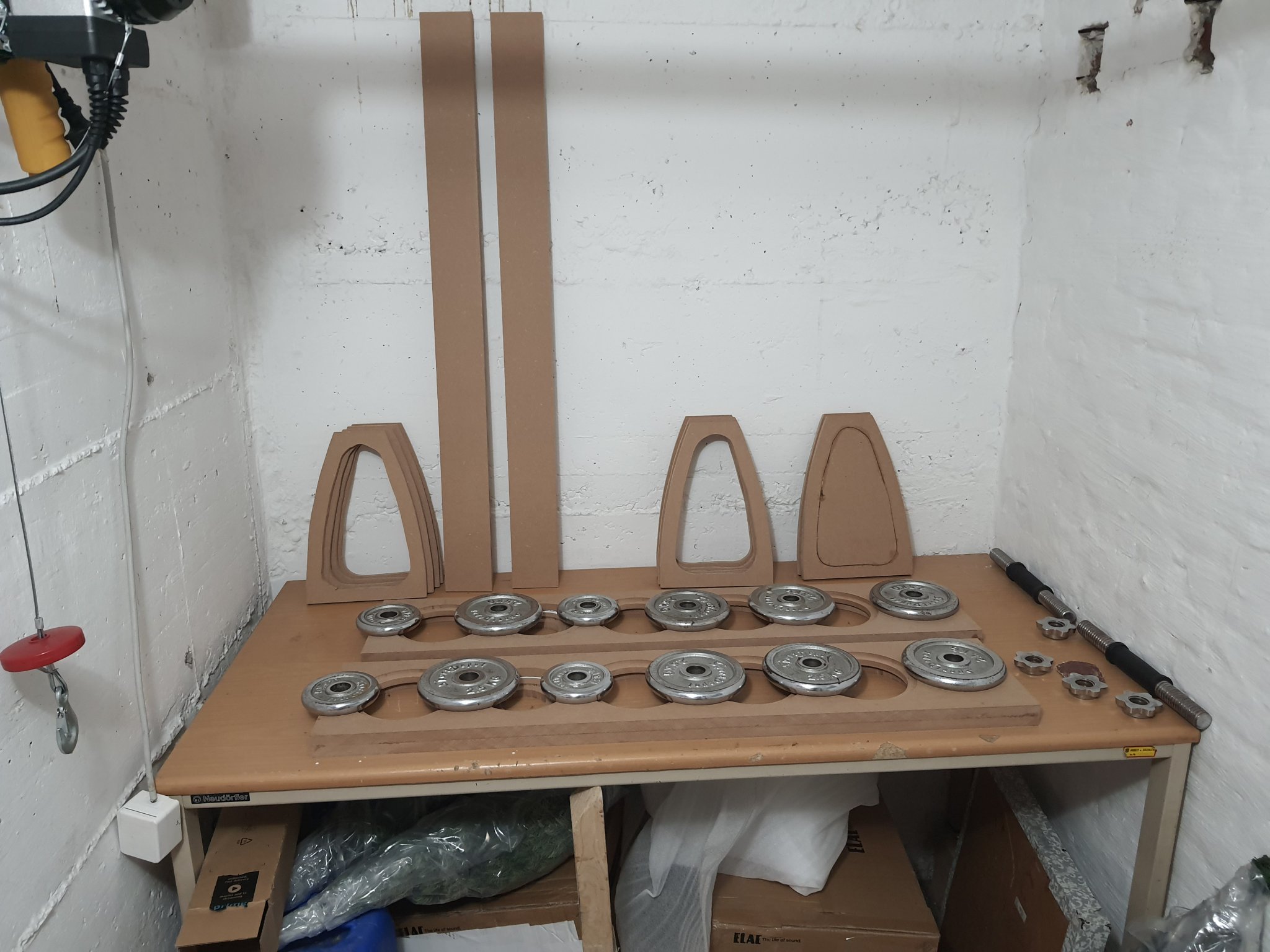

Hopefully, my end game speaker project started 3 weeks ago in my basement in Austria, Europe
NRX Version
Custom enclosure design- as complicated as possible 🙂
front panel and volume are same as in original project
NRX Version

mito147,
Looks like your project is coming along nicely. You have the crossover components?
I also see a lot of weights being used for putting pressure during the gluing process. 🙂

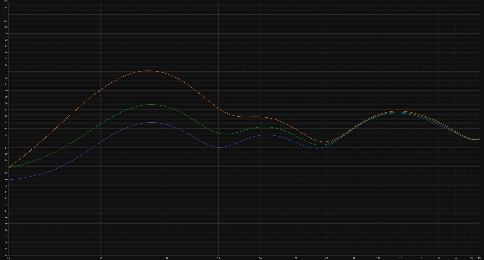

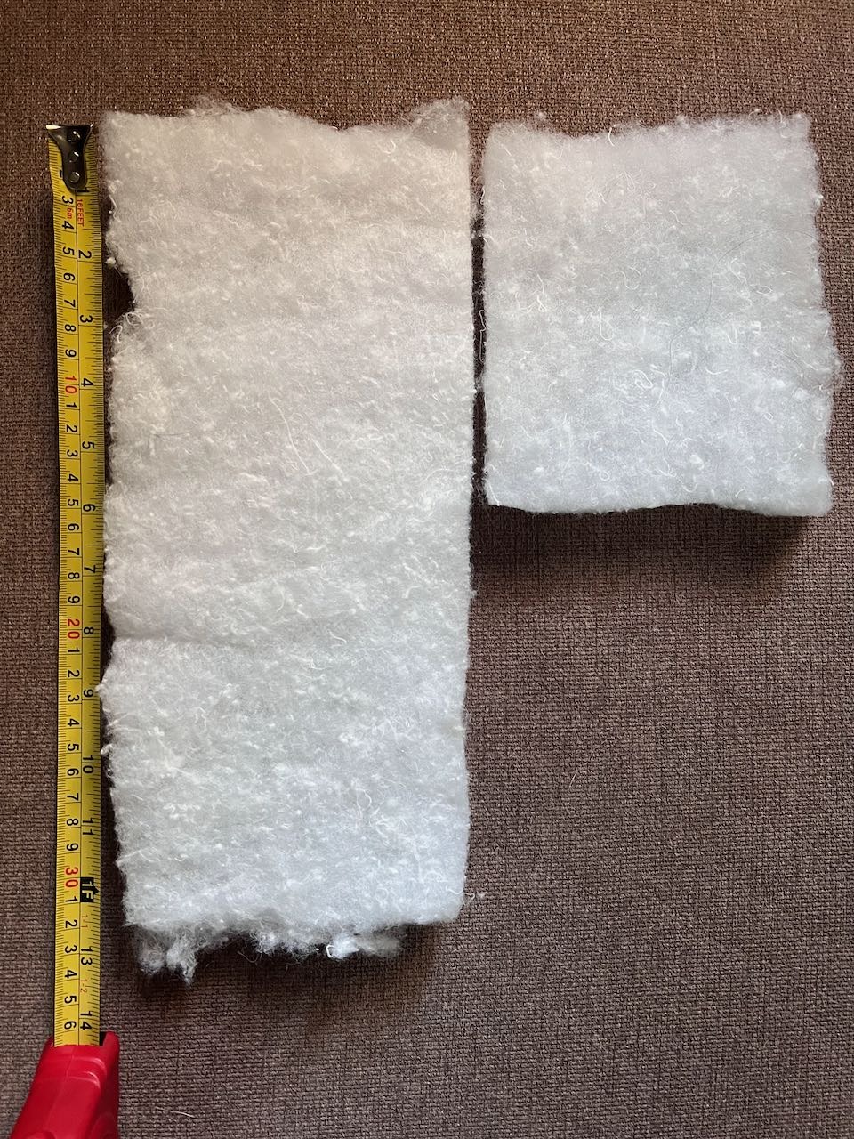

Maybe it will interest someone.
Applies to Elsinore ULD version. It is worth checking whether the low attenuation of the basreflex port will improve the legibility of the bass. And thus the rest of the frequency response.
Below is an example. Three passes. The highest one is the open port. And then clogged with a small piece of cotton wool and a larger one.

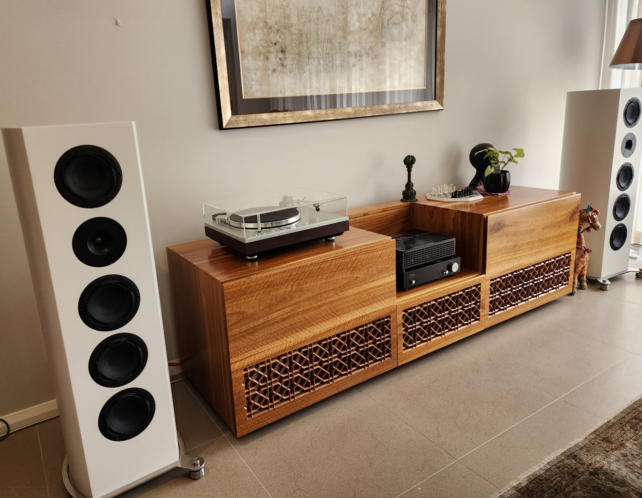

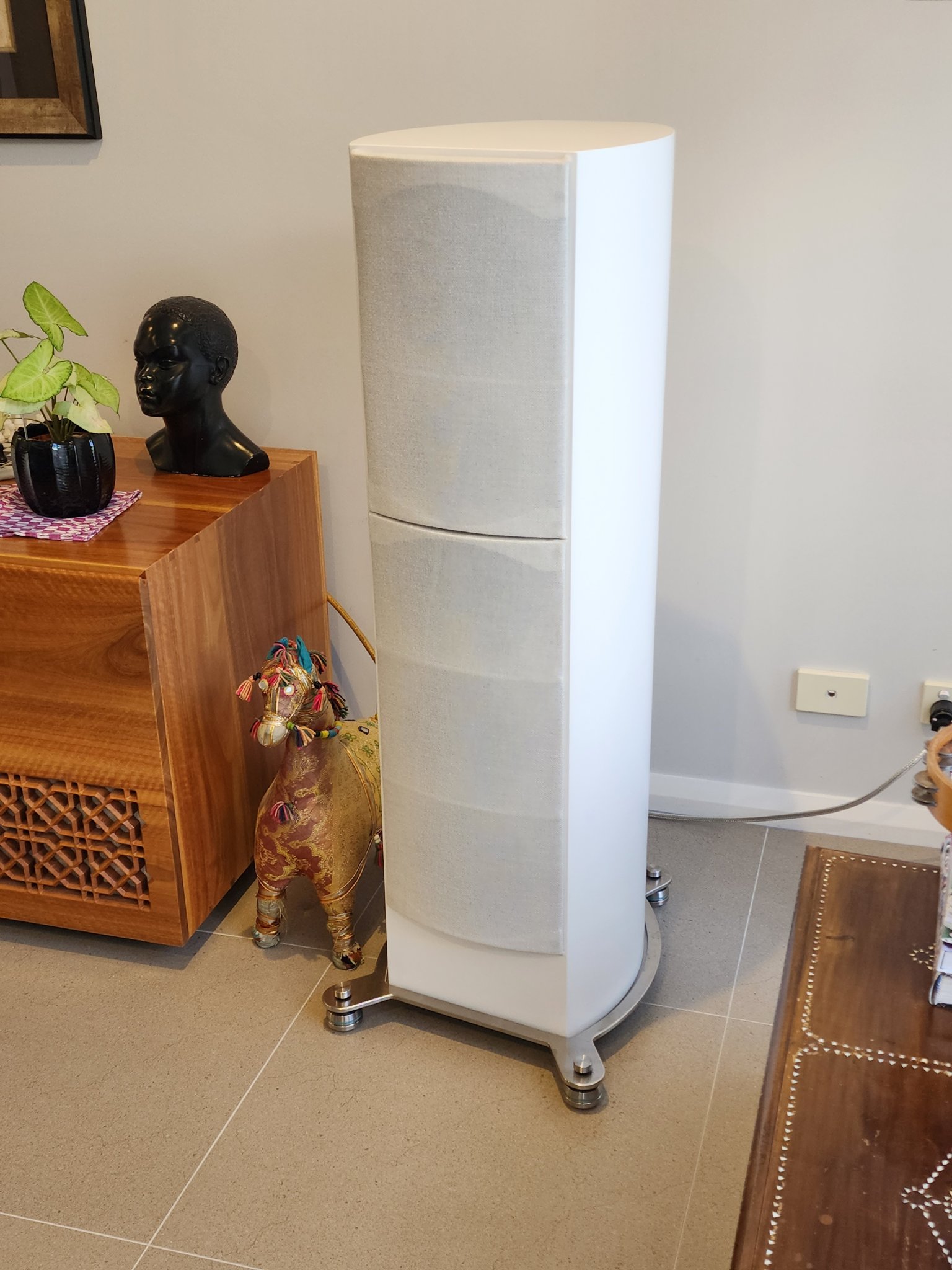

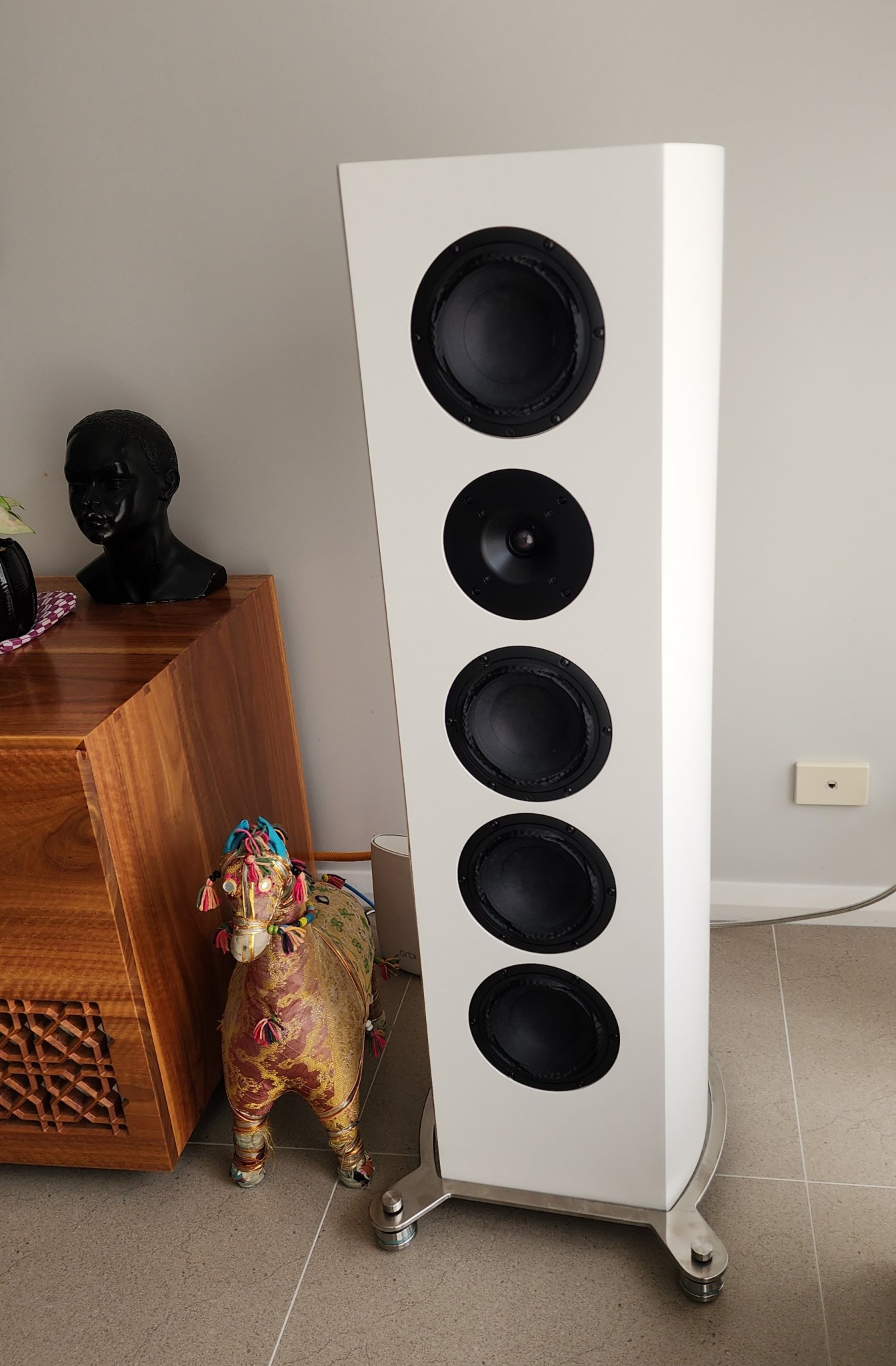

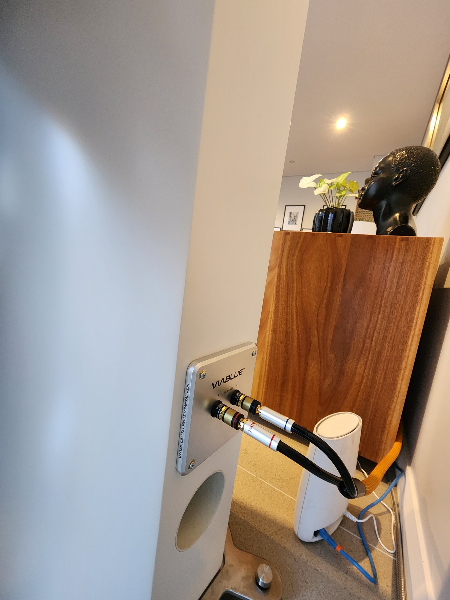

Finally my Elsinore ULD‘s are playing in my system. I’ve only occasionally been using the speakers due to my daughters end of school exams restricting listening time. Just 2 weeks so far.
the sound is so refined and strangely has managed to utilise the airiness of my valve amp, but made the sound tighter and added realism. I’ll write more about the sound soon, based on extended listening.
speaker grills just added.
the metal base made a big difference to the overall refined presentation of music.
my amp is an upgraded Line Magnetic 34i, which had Joe’s ’beyong triode’ mods. I’m using a cocktail audio x40 for streaming and cd. So far no vinyl played, as I still have to clean my mostly donated record collection.
Alfebear,
Your Elsinore ULD speakers look great - congrats on the successful build! The choice of white for the speaker cabinets is a good one - it goes well with your room.
What genres have you tried out? Do you still have the Elsinore MK6?
P.S. Noticed that you have a beautiful console - also DIY? What wood is that?
Hi @zman01
i never owned the MK6, but have heard them on numerous occasions in a good acoustic room.
So far quite a few different music genres including reggae vocals and dub, jazz piano, bass heavy track (massive attack - angel, dead prez - hip-hop, ginuwine - pony, etc), pop (Taylor Swift, Sam smith, adele, Sade), Stevie wonder - songs in the key of life, classical, others; khruangbin, blick bassy, etc
i know the speakers are are not in the optimal listening position, so will see how far I can adjust without causing a fuss in my household.
the cabinet is in spotted gum. It was made locally based on a design my wife and I put together. The furniture maker is talented, but now solely sells excellent wood slabs and makes tables. It’s very sturdy and cable management is good.
