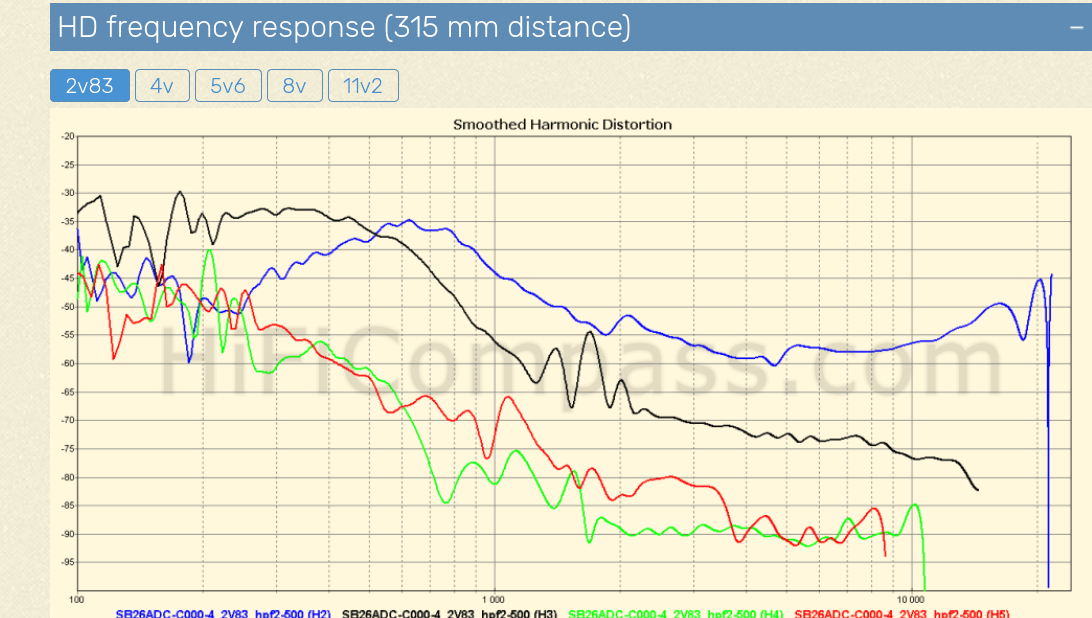

That does seem to be the case, I too looked at another SB tweeter that uses it, the aluminium SB26ADC.
https://hificompass.com/en/speakers/measurements/sbacoustics/sb-acoustics-sb26adc-c000-4 nice low thd
I have a pair of SB26CDC tweeters here. I have secured a panel that I am going to mount the waveguide and tweeter on/into and do some measurements. But getting closer to the holyday period and have work priorities, it will likely happen in about a month. How will it take to using the waveguide? What will the waveguide 'gain' at around 3KHz look like? We shall see. The waveguide used in the Elsinores are more 'aggressive' in order to get that gain near 3KHz. That is why it is not as gradual looking at the more recent ones we see around today. That's OK, we must pick our priorites, mine is that more 'gain' mean less distortion and not go for a lower crossover frequency. I think that approach has paid of quite well.
BTW, I realise that the earlier idea that the crossover of the Elsinores was thought to be around 6KHz were likely concluded on the basis of the cap being 1.8uF and yet the waveguide means a much smaller value is needed. This is a nominal 4 Ohm tweeter and not 6-8 Ohm that we have been using, so it will be beneficial that the main driver sensitivity is lower because we can additional series resistor value, but all of this will be come out in the wash.
