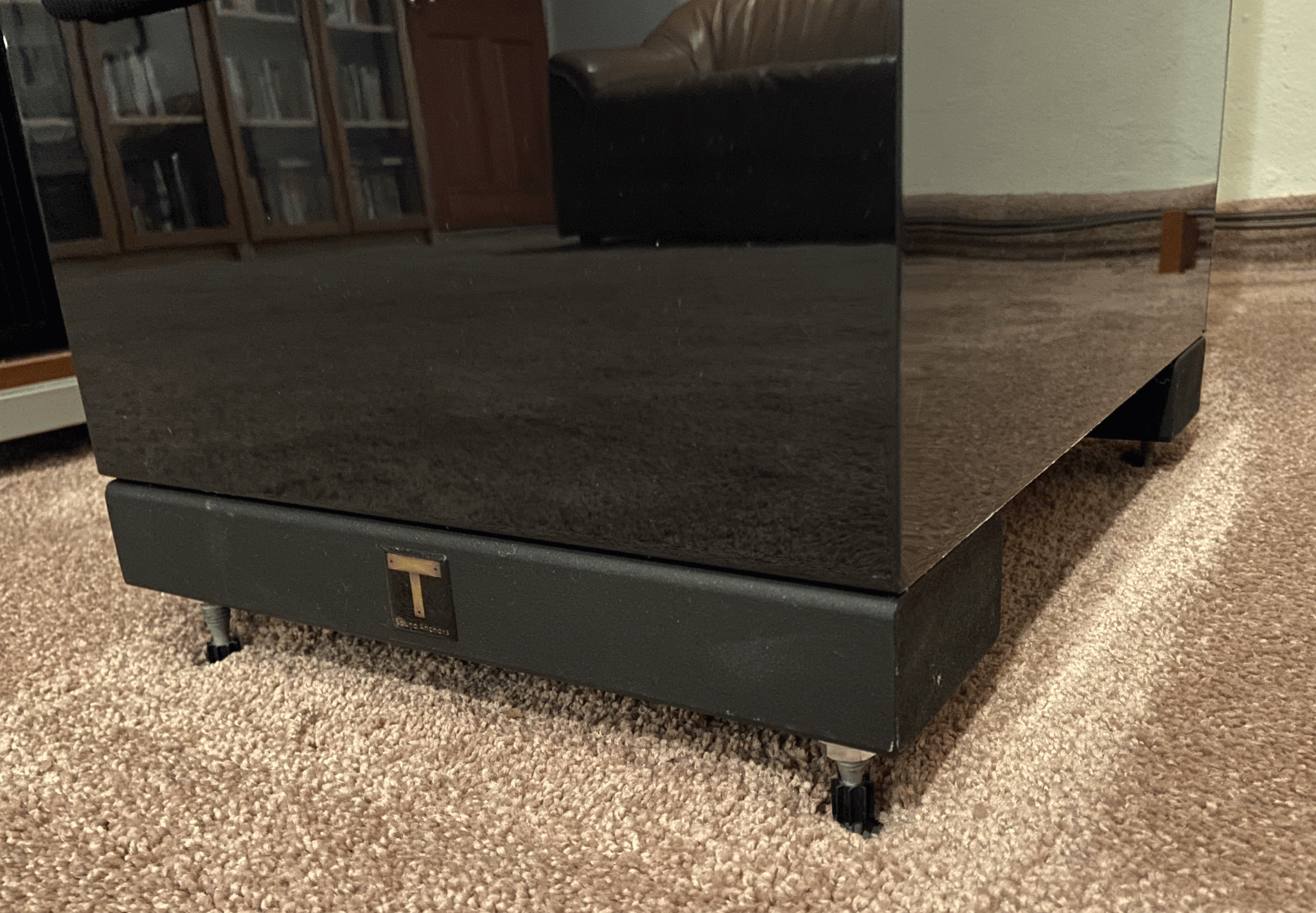

Both Andrew's and your speaker stands are very handsome! There was a brief discussion a couple of years ago about the benefits of raising Elsinores above the floor; my recollection is that the identified benefits focused on better isolation of the speaker itself, resulting in a more coherent sound, and elevating the speakers' sweet spot slightly so it better aligned with listening height. In any event, schubert (a friend, fellow Elsinore owner and member here) built speaker stands out of lumber and reported good results. I in turn had a set of custom speaker stands built by Sound Anchor and was very pleased with the result. Your findings agree with ours: raising Elsinores by 3 to 4 inches (8 to 10 cm) has a notably beneficial effect.
I cannot speak to the benefit of one type of spike over another and, with all due respect, wonder about undamped aluminum plates as a mounting surface. What I can report is that Sound Anchor fills their stands, leaving them very heavy and inert, and provide spikes. It may well be that high quality spikes perform better than a heavy and inert stand; I just don't know. I have no relationship with Sound Anchor other than as a satisfied customer, but their custom stands are very well made and not very expensive (indeed, they were a lot less than the price of two sets of IsoAcoustics GAIA II). But if I were to do it all over again, I might experiment with a variation on schubert's idea: build a box, fill it with sand or something similar and perch the speakers on top. Cheap and, maybe, just as effective?

I am planning on building a set of Elsinores/Hamlets as LCRs for my future home theater. I had seen that it is ideal to raise these speakers 10-15CM off of the floor, as well as tilt the tower back. I'd like to make the riser appear as part of the speaker and house the crossovers in it. The interior of the box, volume etc would remain the same. I'd just extend the front and side panels a few inches and angle the sides so that the speaker is also slightly tilted. Is there any issues with this method? If that's fine, what angle is ideal/tried and true? Does as little as 4-5 degrees work?

Just an idea - maybe build the box without any tilt (simpler construction), and then achieve the desired tilt with speaker feet/pads/spikes? By varying the height of the "feet" you will be able to adjust the angle.
In addition to ease of construction, another benefits is that if you don't like the tilt after listening, you can have the speaker level to the floor easily by just taking out the feet/pads/spikes.

I agree with the post above regarding using adjustable feet. Maybe if you wanted to do something fancy do some kind of outrigger type setup where the feet extend beyond the width of the cabinet. Make it less tippy as well as being able to adjust for unlevel floors etc.
Were you able to see Joe's post regarding his new speaker feet setup?

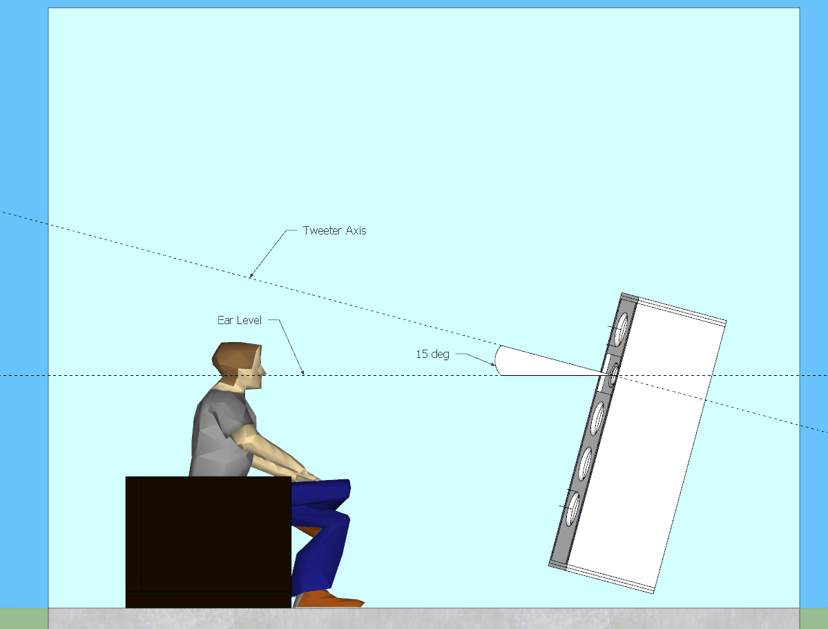

Correct about the 15 degrees. I think the guiding thing here is that the tweeter should be aimed at the level of the ears and then around 10-15 degrees off axis. So if the stands are high enough so the you are level with the tweeter, then that is OK. If the tweeter height is not high enough, you have the option of tilting it up so that you achieve the same thing. Am I being clear enough? Let me know.
I think I understood that. My brain works way better with pictures than with words. I made a quick diagram to make absolutely sure though. I believe that's what you are referring to, right? If ear level is say 36" above the floor, we want to elevate the middle of the tweeter to 36", and then keeping that elevation rotate the tweeter 15 degrees off axis?
No, the 15 degrees is laterally off axis (to the side). If your listening height is 36" and the speakers are upright and the tweeters are also 36 inch, then that should be fine. But if the tweeter is lower that 36 inch, then it may be desirable to tilt the speaker up, so that the tweeter is aimed at 36 inch at the listening position.
Now toe in the speakers so that you are listening to the speakers 10-15 degrees off axis. Toe in more if you need it a bit brighter, but never directly at the listener. Alternatively, toe it out (more off axis) to make it less bright.
Got it, that makes so much more sense! Thank you!
