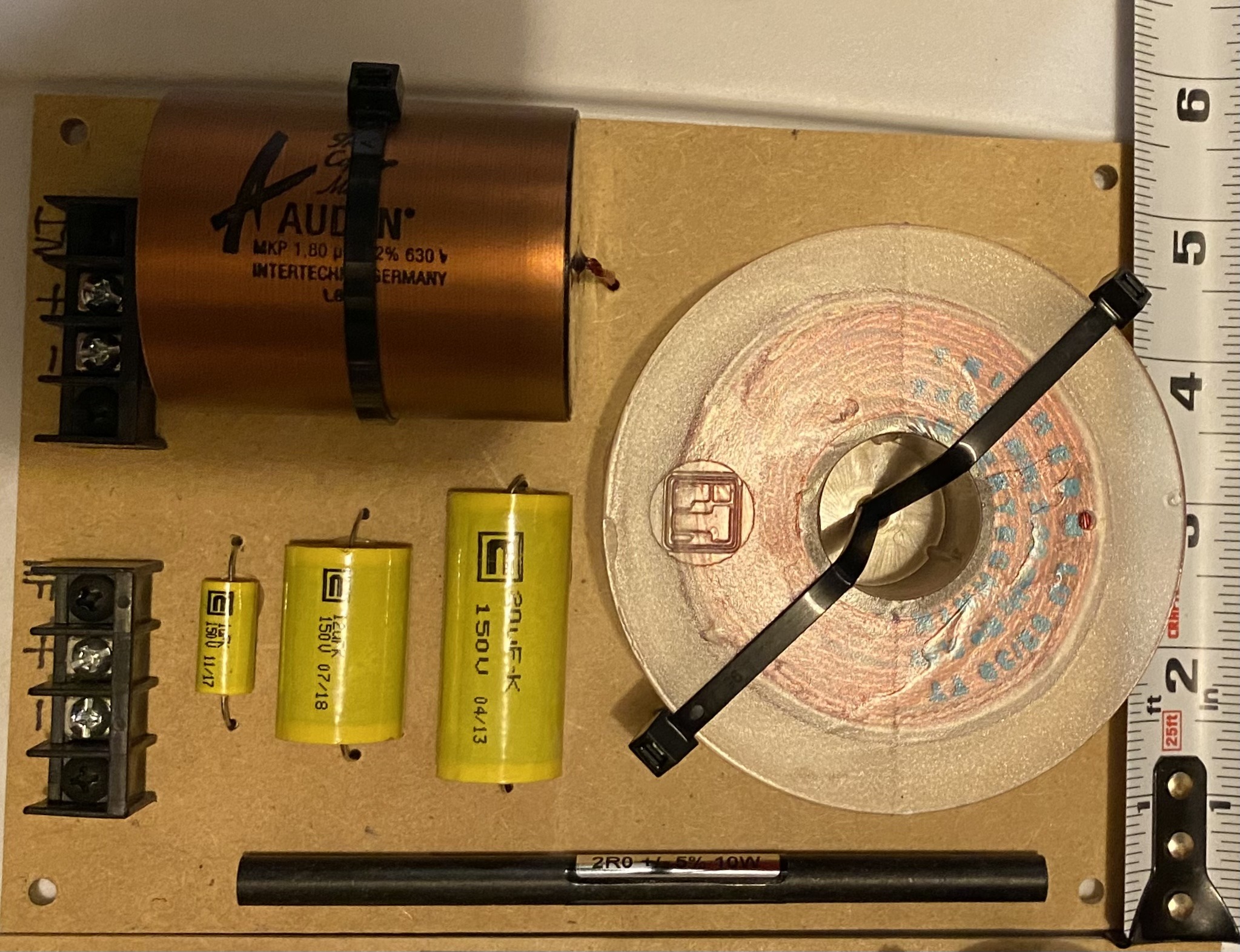

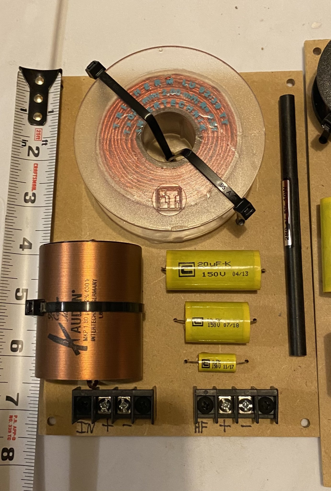

So for the xover illiterate can anyone point out the specific changes. I had complete xovers built for the MFC. and I might consider the ULD and am curious how many parts I'd have to swap out of the xovers. I'll try to decifer on my own but like I said, pretty clueless on this stuff.Have a closer look to post 4793, thats the final ULD crossover
Edit...after looking at that post its pretty clear what's happening. Where are the US builders getting their Purifi drivers?
So if I'm reading your post correctly going from MFC to ULD is a pretty much a complete overhaul if all the magenta values change and R5 R5 C5 need to be added. I'm going to pull my xovers out of the cardboard box they've been in for two years and see if I can decipher things. Thanks Allen.

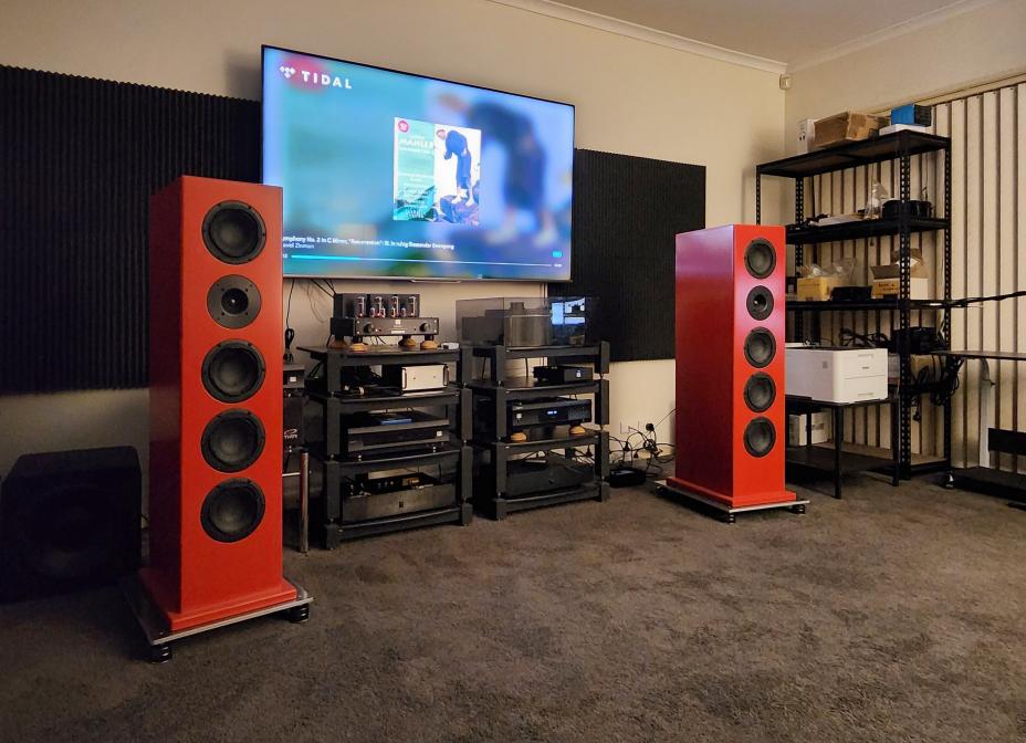

Back on September 18 I reported my experimentation with changing the drivers in my MK6 Elsinores.
I changed all the mid/woofers to SB Acoustics SB17NBAC35-8 drivers. Then I replaced the ScanSpeak D2608 tweeter with the SB Acoustics SB26CDC-C000-4/Ceramic dome tweeters. While refining my crossovers to suit the new drivers I lowered the tweeter crossover point from the original 6kHz down to 2.5kHz.
For the last week I have had my good friend Sean's original MK6 Elsinores next to my modified Elsinores for a direct side by side listening comparison.
With the external crossovers it was relatively easy to compare the different tweeter drivers with the different mid and bass mid/woofers.
Yes the original SB17NRXC35-8 mid/woofer are slightly more efficient than my "new" SB17NBAC35-8 drivers, but the difference is small.
From what I heard it was clear that the SB Acoustics SB26CDC-C000-4 tweeter has quite noticeably less distortion that the original ScanSpeak D2608 tweeter.
Added to this the SB17NBAC35-8 mid/woofer drivers have less distortion in my listening tests than the original SB17NRXC35-8 mid/woofer drivers.
All in all I am very pleased my upgraded Elsinores, making my great speakers even better.

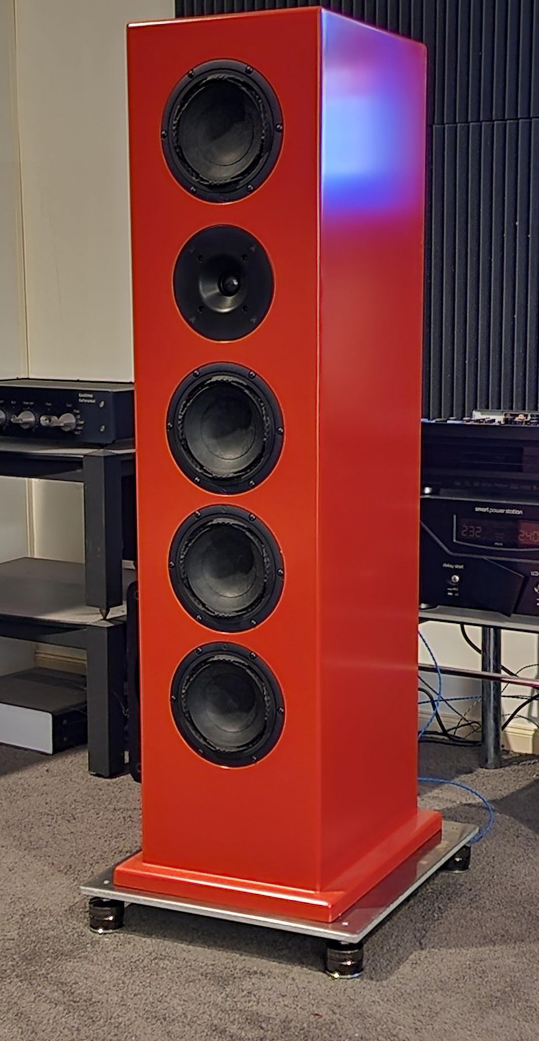

this side by side comparison was very interesting to be present for as the comparison was not subtle. in general the ScanSpeak D2608 had a noticeably harsher sound than the SB Acoustics SB26CDC-C000-4, it was very obvious to me every time we changed them around in different combinations. i'll be getting a pair of SB Acoustics SB26CDC-C000-4 for my setup asap. i built my Elsinores while working in the uk and brought them back with me and just got them out of the box before this test they're working well, they were built to spec mk6. the change of tweeters is a must after this comparisonBack on September 18 I reported my experimentation with changing the drivers in my MK6 Elsinores.

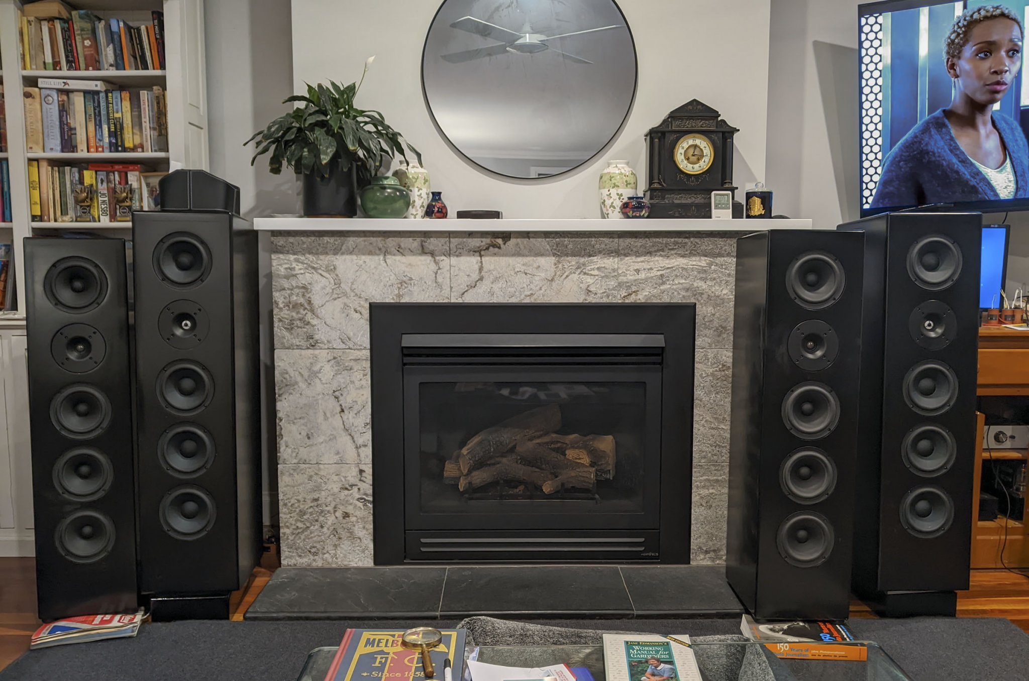

This has been going on for years now. So...
Anybody feel free to visit and listen to this:
NOTE THE BASE:

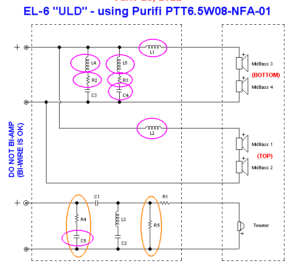

If you are going to use the ULD drivers, you need to now look very carefully at what you are putting them on. Brian in Auckland has also looked at this very carefully and applied it to the standard MK-6 with SB drivers.
I will have a bit more to say on that very shortly.

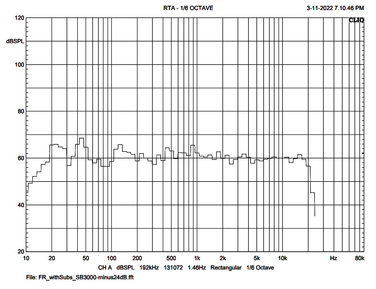

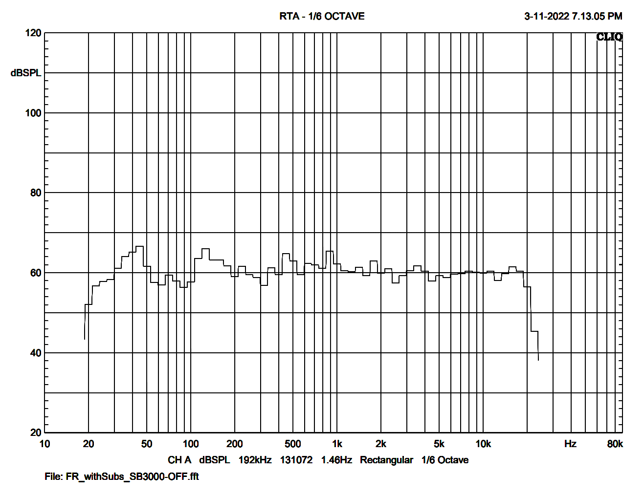

So when the above pictures were taken, I decided to measure the ULD Elsinores using 1/6th Octave pink noise using the Clio system. The Clio system may be considered old-tooth but it is still very current (you can still buy new) and I have spoken to speaker designers around the world that are using it for design work. It is certainly preferable to its rival, the MLSSA system from DRA Labs.
But I also spent some time seeing what kind of result I could get with my two SVS SB3000 Subs. This model occupies a sweet spot in the SVS range and is quite a performer. It is preferable to have twin SB3000 Subs than a single and more expensive SB4000 - even SVS say that themselves.
Again the Clio system was invaluable to setting up and integrating the two Subs, both of which are behind the Elsinore ULDs and you can make out the left one in the darker area.
The first with the integrated Subs:
Here is without Subs:
We can see that with the twin SVS SB3000 Subs, the response in the room is flat down to 20 Hertz. The slight elevation between 20Hz to 30Hz is following the advice of Earl Geddes and needed because at these frequencies rooms tend to leak bass. I recall he suggests 5-6dB boost.
Finally, let us look at both together:
We can see that the Subs are creating minimal interference above 40Hz.
Please note that the microphone was an Earthworks M30 measurement mic and one that is highly recommended by Clio (Audiomatica) themselves as it works very well with the +24V phantom supplied by the Clio box. The mic can handle up to +48V.
Two separate independent Pink Noise signals (dual-mono) were sent to the speakers, the microphone was at the listening position, almost a near perfect triangle, and right on the height of the tweeter, which at the listening position was near 15 degrees off-axis.
So how does it sound? First of all, the measurements above are in the room where I listen to them. What they show is what reaches my ears. The room has a wide range of absorption, reflection, and most importantly, diffusion. The best ears I know (and maybe the best on the planet) is Phil Punch of Electric Avenu Studios and he says that he hears a slight bass bloom on the left side, but overall this room is well above average. The one anomaly could be fixed by hanging a curtain of the right stuff there, but that is not an option because then we would have no door. But when I went over to "the Base" that seems less obvious... more later.
Actually pretty much like it looks. The peaks and troughs largely average out, everything seems to be in balance (I am BIG on balance). Particularly pleasing is above 1KHz, but here a good room should not have too much of an effect. The biggest problems are always going to be under 1KHz and that is what we see. Still, The peaks at 45Hz and 130Hz and the trough at 300Hz, this is the room imposing itself (so-to-speak) on the speaker.

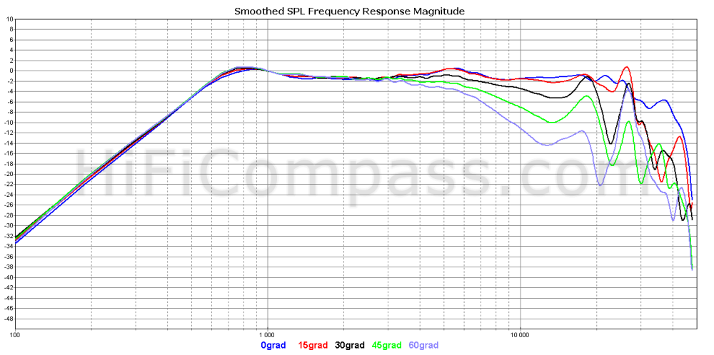

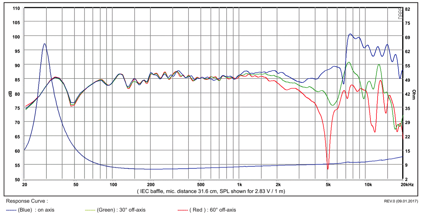

PS: I must make a quick comment of the SB Acoustics SB17NBAC35-8 - this driver is of the 'hard' cone variety, the ULD and SB17MFC drivers are of the 'soft' kind, the ULD being fibres and the MFC being a polycone. If you are using the NRX version, that is fibres and also 'soft' cone variety.
Can the SB Acoustics SB17NBAC35-8 be used as an alternative? Generally, I would say no, but if there is one 'hard' cone that you might get away with it, then the NBAC might be the one. Most drivers of this kind I would not look at, but let us look at the NBAC and the affect at around 4-10KHz range, the area that are a problem with harder cones, some can be rather violent cone behaviour:
OK... I do see something...?
Ignore the on axis (Blue) response. Look at the Green 30 degrees off axis response. The Elsinores were always designed to be listened off-axis. If this was to become an Elsinore Mk7, then I would need to do the work. That would require a lot of work, but what I see with this driver is that some kind of network centered around 7-8KHz would be needed, and then see how things hang together. Will this be a 2023 project? We shall see. I have a suitable pair of naked MDF boxes, but need $1500 Australian to get started. We shall see, but if it has to be done, it has to be done properly. Keep in mind, they are less sensitive speakers! But their load on the amp will still be sweet as honey pie.
I will have a discussion with Steve and see where this might be going.

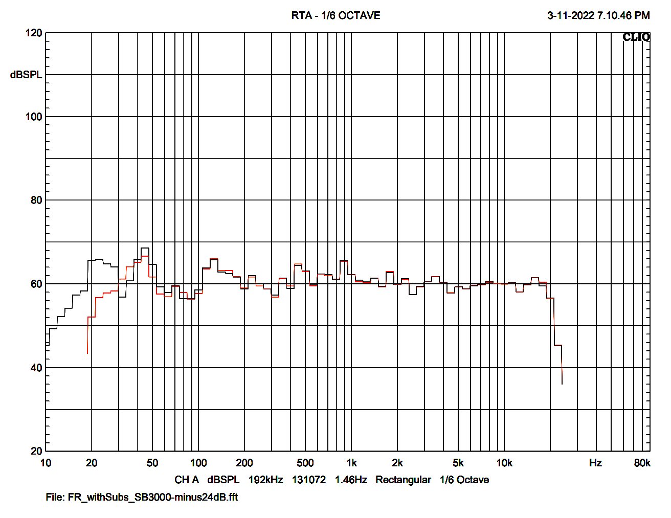

One of the graphs that shows both with and without Subs went missing, so here it is:
Black is with twin Subs and Red is without.

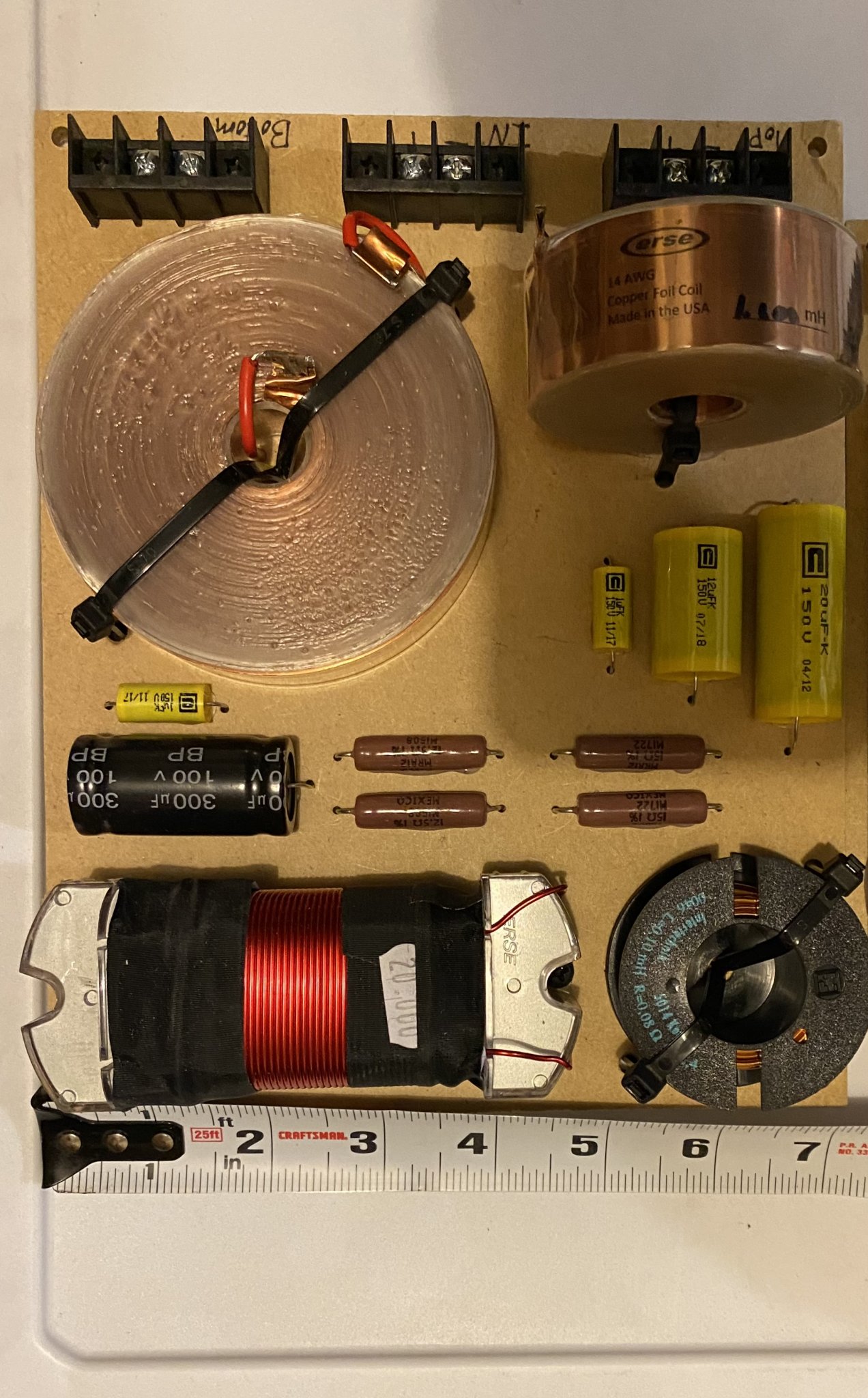

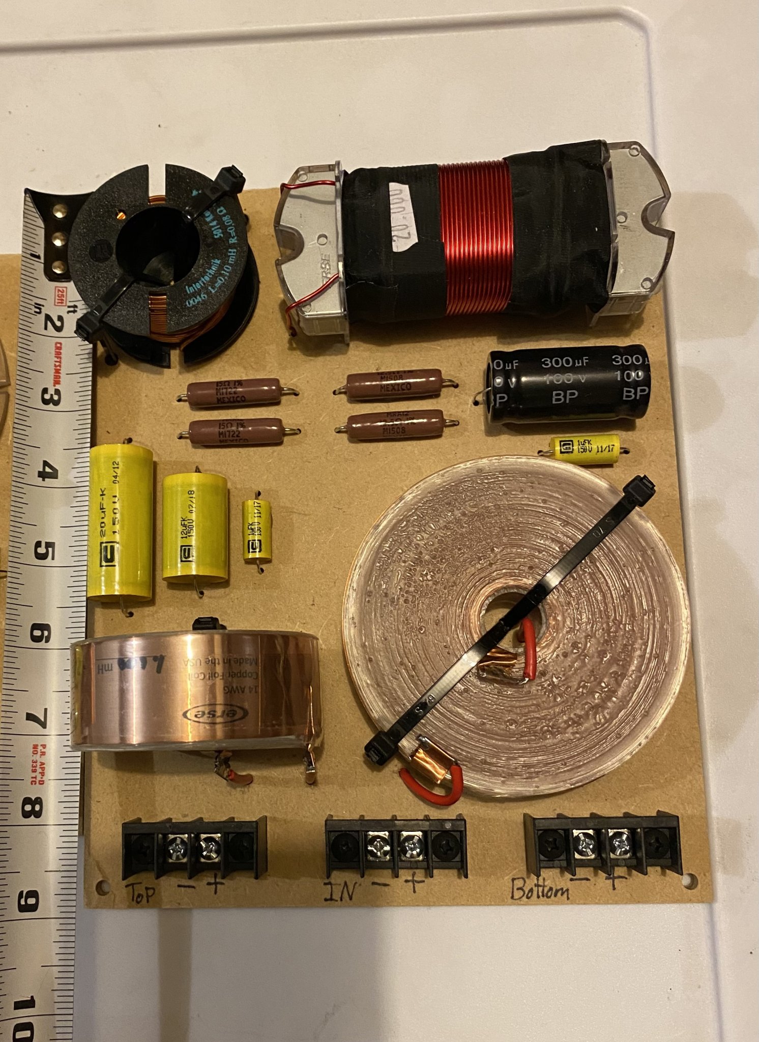

I have been sitting on a complete kit for about 2 years now. Its a complete kit with assembled and upgraded xovers, tweeters, MFC drivers, wave guides, ports. I had it sold and backed out on @Mikerodrig27 who was very gracious and has moved onto his own kit). But we're moving in the spring and don't see the build happening. I won't clutter this thread beyond this but if anyone is looking for a turn key kit sans boxes you'll find it here in the swap meet.
Elsinore MFC Kit
Any questions just PM me. I take care of Paypal, you take care of shipping. Will meet within a reasonable distance from southwest Missouri. Will consider splitting the kit but would rather just let it go all at once. Apologies if inappropriate for this thread and if requested I will delete the post.
Elsinore MFC Kit

As an update most of this kit is sold. The crossovers are still available. These have upgraded components recommended by one of the members. I'll post a few pics so folks who might be interested in the easy button on this build.I have been sitting on a complete kit for about 2 years now. Its a complete kit with assembled and upgraded xovers, tweeters, MFC drivers, wave guides, ports.
Elsinore MFC Kit
Any questions just PM me. Will meet within a reasonable distance from southwest Missouri.
