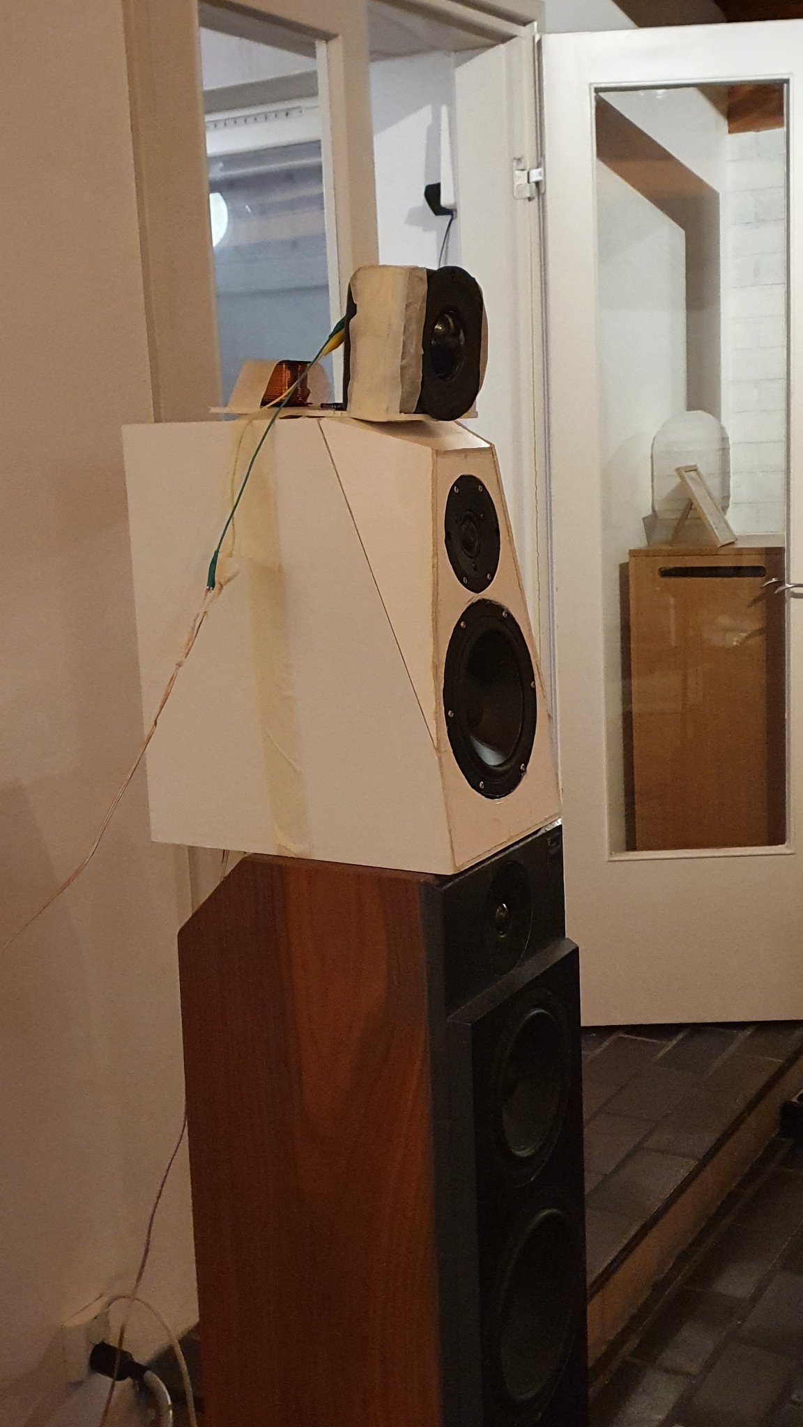

Actually i am building speakers right now with morel em1308 dome and it has more detail than atalante, and more exact placement of instruments.
It reminds me Yamaha JA-08B5 dome that i have heard in same room, but since i have not yet completed this project (it is in early prototype stage) i cannot compare them too directly yet (yamaha and morel)

i am building a 3way speaker, and right now after some testing it seems that domes might be way to go. The dome im testing right now is morel em1308.
I have few questions:
- What contributes to the soundstage size with domes? How big/wide it is?
When i have heard yamaha ns1000 (with br dome) in same room, they had wider image than what i had right now in testing "free space" (look at the image in last post, middome top of the speaker)
Is it because of the baffle was wider with yamaha and so sound reflected differently into the room? Also revival 5 had same kind of big sound, so im thinking it might be the baffle..
(im trying to decide should i do narrow baffle or wider baffle)

I have the EM1308 and really like them, however, my three way speakers did not come alive in terms of soundstage until I nailed the on axis phase co-incidence between the drivers for at least one octave either side of the crossover points. As I have active crossovers I can play with different low/high pass slopes and also delays, I had four crossovers programmes that were all pretty much the same on axis frequency wise but the one that provides a wider and deeper apparent sounds stage and also more separation between instruments (when it is actually engineered that way on the track) was the one with the lowest order slopes and that had the best phase coherence.
No idea if this is everyone's experience and not sure if there is any maths/physics behind it but this is my experience.

i know the phase was little of with my quick/dirty phase setup as it was meant to make clear tonality of drivers and no so much other aspects..
I know from my own tests that i am phase sensitive.
Phase most likely plays a role in here, also i feel baffle width, but i have to test it.
Next week when i have time, I will make a comparative test with rounded wide edges on my test box vs narrower box as it is now..

@mayhem13 There's nothing wrong with using an HF dome with a mid dome as long as you get the relative phase in the overlap region right along with making sure there isn't a sudden jump in radiating width at the xover point. If you nail this and design a minimal defracting cabinet, the speaker will disappear into the room and throw a deep / wide stereo image.
Planar tweeters are easier to integrate with a mid dome due to their narrow vertical pattern, closer to the midrange pattern at xover compared to a typical wider pattern of an HF dome at the same xover. The dome tweeter isnt as forgiving because of the wider overlap region, but a WG tweeter can address this by narrowing its directivity down low. Again, if both drivers share similar directivity at xover and relative phase, they will blend seamlessly.
