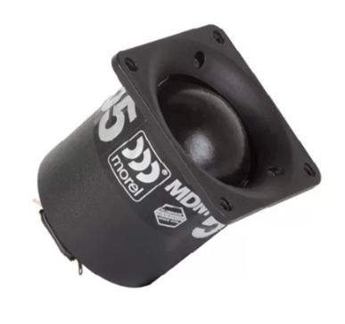

Yes, the MOREL MDM55 is indeed a nice and compact speaker, with a large dome, and good FR too 😎... But unfrotunately, the 89.5dB/W/m sensivity won't suit my needs, I guess... 🙁
https://www.morelhifi.com/product/mdm-55/
If I had a MDM55 for my 3-way orange-white bookshelf (pictured a few post before), instead of the small full-range I used, it would have certainly worked to match the 90dB/w/m level of the speakers. 😉

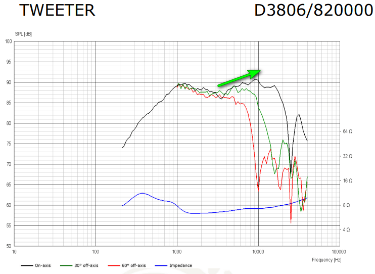

@tubelectron Yes it sounds like you have found your preferred compensated FR curve.
A thing to note with the SS 3806 38mm mid-tweeter is it has a rising response. This actually a good thing when you factor in the midbass response being able to carry some of the output shyness down low with a shallow midbass LP slope. Adding the steeper HP on the 3806 with an offset slope can still retain the desired summed FR despite the lower sensitivity (to a point).
You can also try a bucking magnet on the 3806 to see if it will pick up another dB sensitivity. Thats obviously an uncertain thing which may not end up working out, so its not worth the risk of being stuck with an unsuitable driver.

I see @profiguy. I suppose you mean this about the rising response of the D3806 (green arrow below) :
The crossover strategy would be to let the Low-Midrange 8M60N "complement" the lack of level of the D3806, if I understand your purpose. Deduced from what we discussed about the slightly subdued response around 3.5kHz, well... Why not, after all ?
I did not though about the additional magnet tip, nor experimented anything serious in that field about speakers... A friend of mine did it years ago, and did not noticed great improvement in effciciency. But it was before the advent of the compact and powerful Neodymium magnets, and he used a dismantled ferrite, for which we all know that a significative part of the magnetic energy is lost when the front and back magnetic field plates are removed...
Then would the combination of both the FR/Xover trick and additional magnet tip be able to enhance the performances of the SS D3806 and/or D7608 ? 🤔

Adding magnets is hit and miss due to the design of the motor dictating how much effect it will have. An internal magnet motor like the D7608 has usually won't pick up much if anything, but an open magnet motor will usually benefit from a bucking magnet. The gain is however usually very subtle and every little bit can make a difference.
The response overlap working in your favor hinges upon the relative phase response between both drivers adding output. It doesn't do any good if they have opposing phase relationship to one another. It requires careful planning designing the crossover. This is where a good sim tool will be of great advantage.
Another thing to consider is just how much the minor amount of overlap between the LF and HF on a 3 way add to the net midrange output sensitivity. Obviously the more shallow the slope, the more overlap but there's alot more which comes into play fighting your efforts here. Using very shallow filters with a wide range of overlap is a recipe for combing and destructive interference when the driver spacing is less than ideal for the WL of chosen crossover frequency.

I see. It can be a plus, but no "magnetic miracles"...
Unfortunately, my PC-based measuring gear has became obsolete (thank you Windows), and I am still lagging to setup a new one... But in the S-// crossover formula that I use, all speakers are connected in polarity (= same cone displacement sense on attack) and with a 1st order configuration (= same phase of signal on decay, sustain, release), so it is already a good starting point - not to say prerequisites - against phase problems...
Of course, this doesn't prevent phase issues in the speakers themselves, but if these are used in a linear area and still be there at FC with a reasonable margin, there shouldn't be too much overlap irregularities problems. That's not always doable !
Yes, sure. That's why I also try to minimize the spacing between tweeter and midrange as best - in that sense, the MOREL MDM55 you mentioned is an interesting item, due to its small frontface - too bad for the moderate efficiency ! 😕

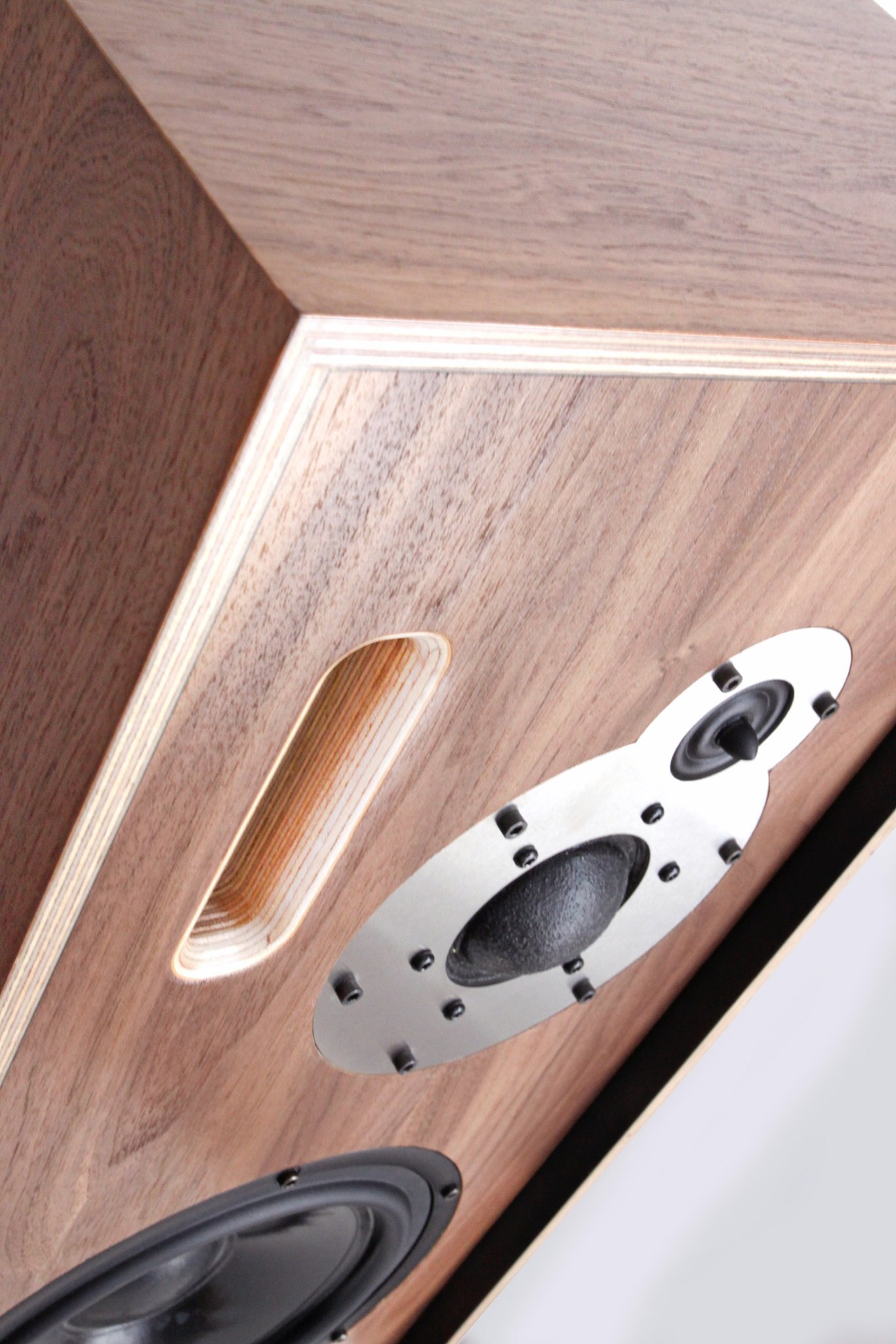

Thought I'd post some photos of what I built with the Hi-Vi DMB-A. Seas CA22RNX woofer and Vifa XT25SC50. I called it BM50 for 50 Liters.
Kind of a modern homage to the older BBC monitors I think sensitivity is around 90dB and 8 ohms so an easy drive for low power amps.
