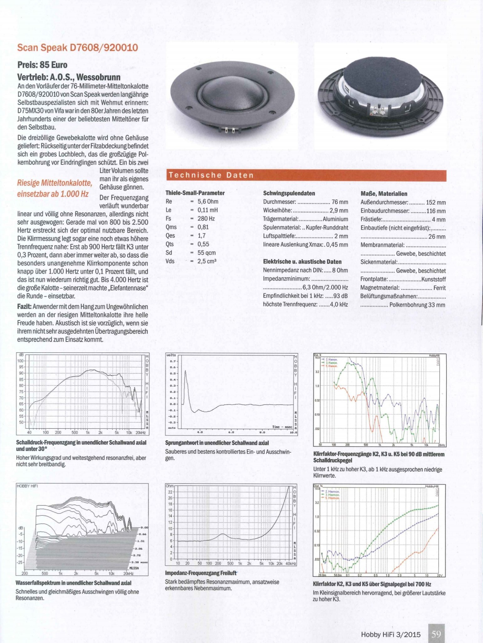

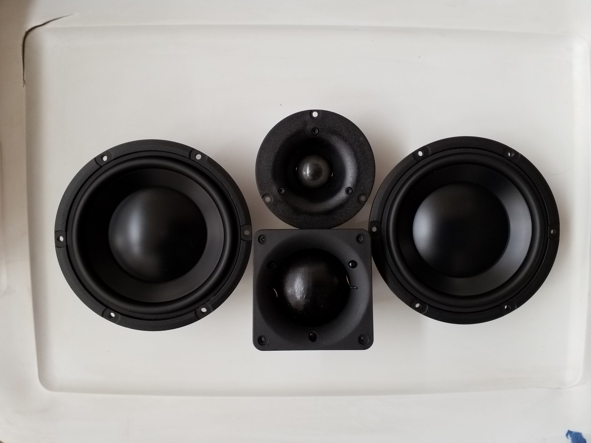

Here's a German review I found. Not sure I agree with some of the data. Interesting nonetheless.

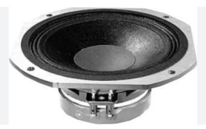

This one? http://www.audax.com/archives/HM210C0 - Catalogue 1994.pdf
How did you load the woofers (sealed, ported)?

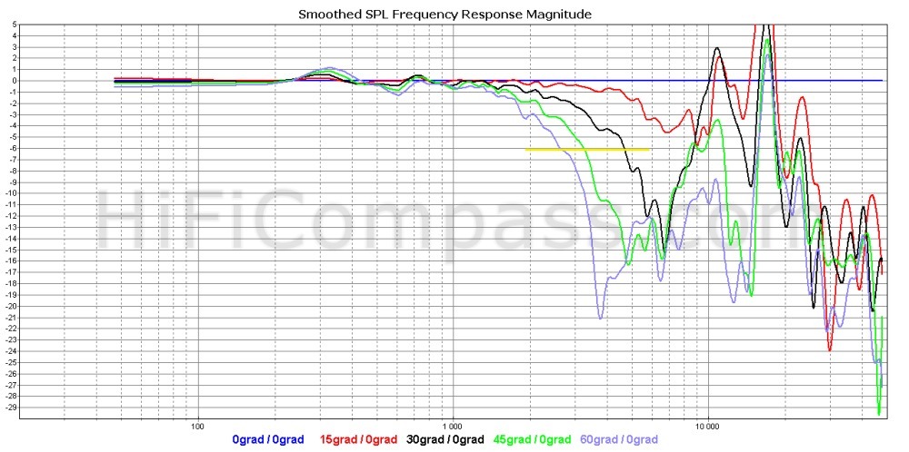

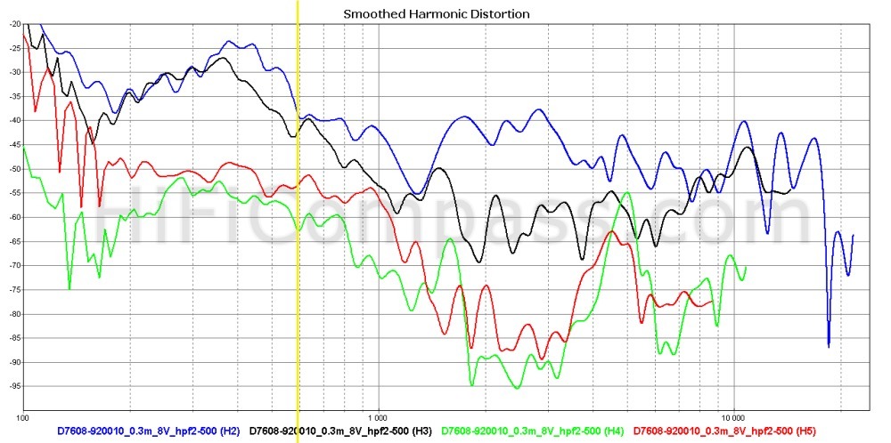

Here’s a sample of the one with the faceplate

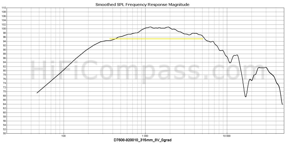

as tested by @ HifiCompass.
“Test baffle size – 1650x850 mm”
View attachment 1259969View attachment 1259970
Yellow lines by me for emphasis of natural response on a quasi IB.
Yevgeniy measured it with 2nd order Butterworth high pass @ 500 Hz
As you know; a Butterworth filter has a -3dB at the cutoff point.
Reference:
https://hificompass.com/en/speakers/measurements/scan-speak/scanspeak-d7608/920010
If we need to play lower or louder we can use sleeper slopes…
@HiFiCompass
Dear Yevgeniy,
Do you recall testing this unit out of the box, or did you attach a small enclosure on the rear side?
Hi Thanh,
I tested that midrange "as is", with no any chambers
  • Thank You

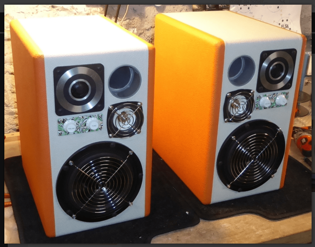

......3 way with the Audax TW025A28 and dual HM210C0 running in staggered LP (technically a 3.5 way). I used a bunch of left over crossover parts to throw a set of speakers together over a weekend, including the cabinets. I didn't even sim anything and just used a ton of clip leads, some white noise and my old Audio Control RTA to whip up a crossover in a few hours. I ended up living with these speakers for a few years in my main system....

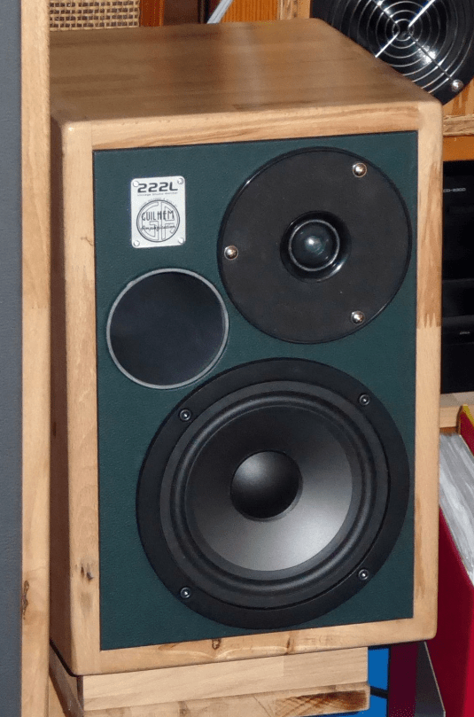

Yes - the works of Mr. Bakegaard. That's this idea which inspired me for my 3-way S-// Xover : midrange filling speaker.
I'll add another RLC couple for the High-Mid dome speaker - for the moment, the favori is the SB SATORI MD60N - here's the look of that 4-Ways project :

You have to utilize part of the natural rolloff slope to add with electrical response ie LR2 with -6dB points between 3 - 4k. I honestly wouldn't go steeper than LR2 or derivative thereof to preserve smooth phase response. The baffle will dictate much of the response in that area, so you need to factor in diffraction and baffle step losses.

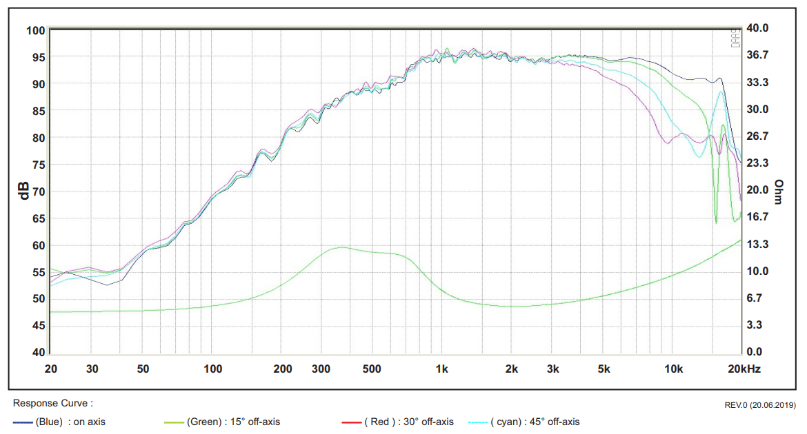

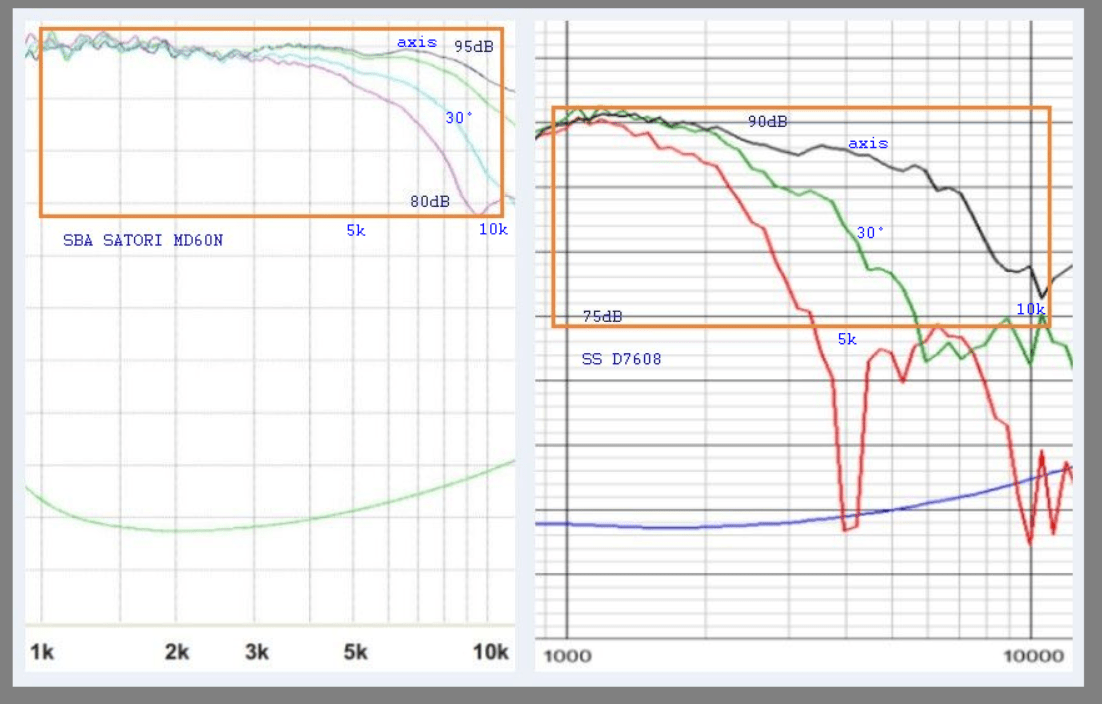

Here is the FR response of the SBAcoustics SATORI MD60N, as provided by the manufacturer's data sheet - if it is taken on a plane CEI baffle, then chances that it is realistic... The interest is the 94-95dB/w/m efficiency and the good linearity up to 6-7kHz 😎 :
That said yes, nonetheless a baffle step correction may be required : it has to be evaluated by tests, on a prototype of my project.

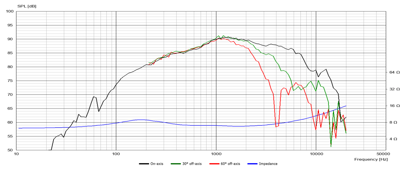

Here's the FR of the D7608, according to the official SS specs, showing a lower efficiency and a faster response drop 😕 :
At least on the specs comparison 1-10kHz below - assuming all things equal - the FR response of the MD60N seems more favourable for my project than the FR of the D7608, if I plan to reach 6-7kHz, notably for a near field listening, at incidence 15-20° horizontal :
So I am tempted to go for the MD60N, but having no real experience about dome midranges : am I missing something, @profiguy, that would finally turn to the advantage of the D7608 vs. the MD60N ? 🤔

Be aware the specs on the MD60N have changed at least once. There is a small issue with the original design around 1k due to the air space behind the VC gap causing a secondary peak.
If you look at the impedance plot from SB, it shows only a slight asymmetry at the upper end of the peak. The Hificompass test shows some significant asymmetry on both ends of the impedance peak. That corresponds with raised 3rd HD around 900 to 1k. I observed this myself with the first set of MD60N I tried and didn't keep. They sounded like a rubbing VC when in fact it was simply elevated HD around resonance.
They changed the chamber dampening on the 2nd version which I haven't tried. The FR also changed slightly up top and it has the typical mass rolloff kink on the upper end that other large mid domes suffer from.
The sensitivity is pretty high on this dome. The xmax looks low and I'd tend to agree based on the elevated sensitivity. My reasoning for favoring the D7608 over the MD60N is simply that its a large diameter dome and it has excellent breakup behavior in thr upper rolloff despite a lower cutoff. The price is also very good and I prefer to use a larger chamber with extra flow restriction to lower Qts. The MD60N is also closer to $200 whereas the D7608 is around $115.
So maybe the bugs are worked out on the 2nd version of MD60N. Id like to see 3rs party measurements to see if things are better. I'm perfectly happy with the D7608. It has better top end than the measurements show but off axis it shows its a larger dome. I'd cross it to a smaller HF dome around 3.5k. If you need the extra extension, I'd look at the Morel domes, as they have 2mm p-p xmax and about 6mm smaller diameter. That should be close to the MD60N for low end capability, but the sensitivity isn't as high. Pick your poison.

Touching on the Morel MDM55s, I plan on using some in this design for small format high output 3 way NF monitors for my son's home studio. He needs something small which can play pretty loud (with good power handling) assisted by subs and not struggle in the lower mids. This is why i chose the MDM55 with 2 x CAW538 midbass and CAT378 tweeter, all in a 20 ltr sealed box. While these Morel woofers aren't the lowest THD out there, they can take ALOT of power from 100hz upwards. Crossover points are planned to be around 1k and 4k 2nd order.

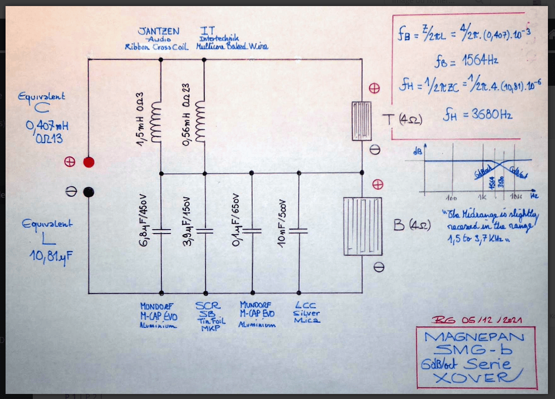

Incidentally, when I rebuilt my Magnepan SMGb crossovers in 2021, I came to that similar "dip around 3.5kHz" trick you mention in your post's 2nd paragraph. I finally found that - by ear - the SMGb required a gentle "dip" between 1.5kHz and 3.5kHz grosso-modo, that is to say centered at circa 2.6kHz, (below, hand graph at the right) :
And yes : a flat FR doesn't imply necessarily a good FR...

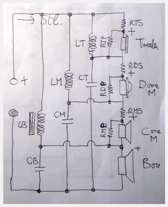

Then it drives me to the assumption that, if my Hi-Mid dome speaker offers an excess of sensivity (dB/W/m), I can simply balance it with a L-Pad, or add a frequency-focused attenuation, if finally required, to match the desired tone balance.
Conversely, if the sensivity of that speaker is too low (i.e. like 89dB/W/m on the SS D3806 proposed by @motokok), the correction latitude in level is significantly reduced, even insoluble to balance, I'm afraid... 😕
Again, Do I miss something about the behavior of dome midrange setup strategy ? 🤔
