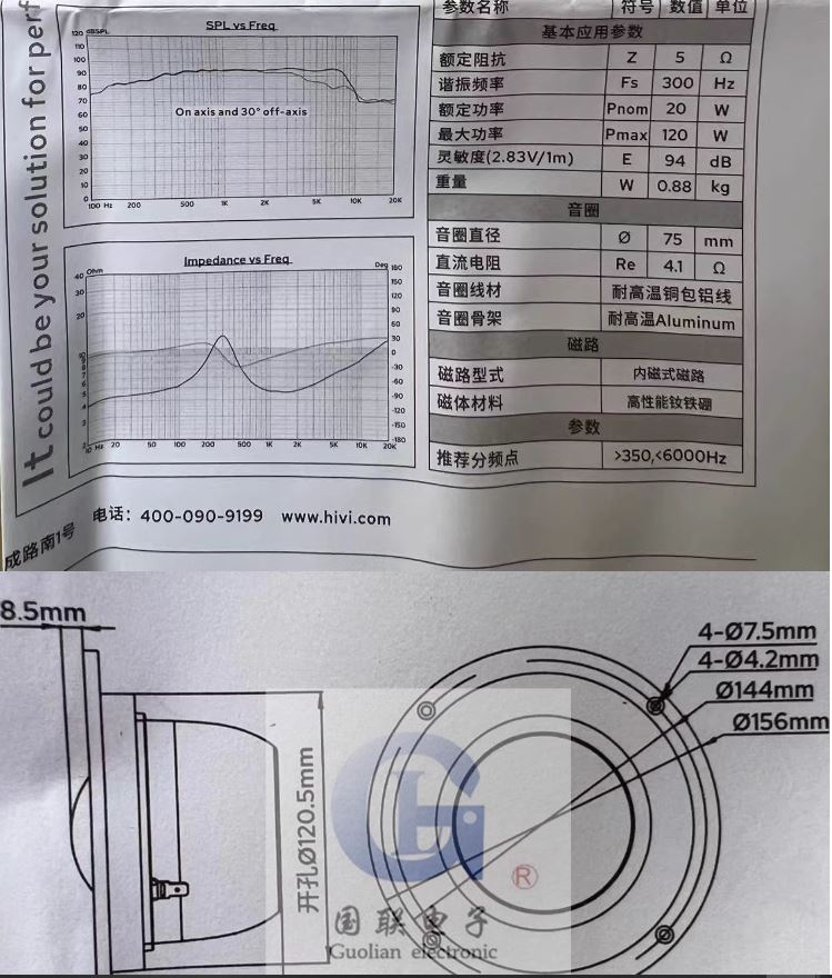

If you understand Chinese or someone can help you with it, you can actually order it from Taobao. There are official stores there that sell HiVi stuff. Also, there is no mention of the Xmax of this driver even on the official stores.I'd love to see some tests by a comparable source such as @HiFiCompass 😀 The DM7600 looks like a beast.

You should never believe any data hivi publishes because of how they measure and test. The graphs are overly smoothed with large scaling, making them look more attractive at first glance.
The xmax spec isn't a reliable measurement to determine linear operation of an overhung VC driver with a proportionatly large motor. The magnetic field flux symmetry (not readily visible to the naked eye) can and will throw it off.Does anybody know the Xmax of this driver?
If you don't have Klippel measurements for BL symmetry, its hard to determine by how much distortion will increase with further VC excursion. Only the THD measurement along with its individual component proportions can reveal overall motor linearity.
Even if Hivi would claim a specific number, I'd be suspicious of its accuracy based on how blurred their other claimed specs are. Based on my findings when looking at the DMB-A internal build, I didn't see more than a total of 1mm VC winding overhang when comparing winding height to upper pole plate thickness.
There was also some discrepancy in the winding height centering, specifically a negative VC offset (inwards towards the motor). A slight negative coil offset is common on dome drivers, but its not good if it varies alot. This will cause large TSP and THD variances at different SPLs.
Do we know it is an overhung design? Kind of uncommon for a midrange dome I'd think? But surely suggests a significant xmax.

I believe the differences between the DM7500 and DM7600 is the latter has a waveguide faceplate. Are there further changes?
I also would hope on a driver of this price HiVi does better quality control... but we won't know that until many units are sold!

Well the best way to know if something is consistent is to order at least 2 and test yourself. Thats honestly the only trustworthy way to know having someone in a trusted circle of people test it. I wouldn't trust anything Hivi puts in a soec sheet based on several previous experiences.
Most mid domes aren't underhung... at least not the ones I've taken apart and I can tell you I do take most drivers apart which facilitate it. Sometimes that happens without my involvement ie shipping damage.

I have not checked which domes are underhung or overhung, I just assumed (a**-u-me) since the excursion requirement and power handling is limited while linearity is prized. I'm not surpised the Hi-Vi DMB-A is overhung since it appears to borrow the motor from their mid-bass drivers.
