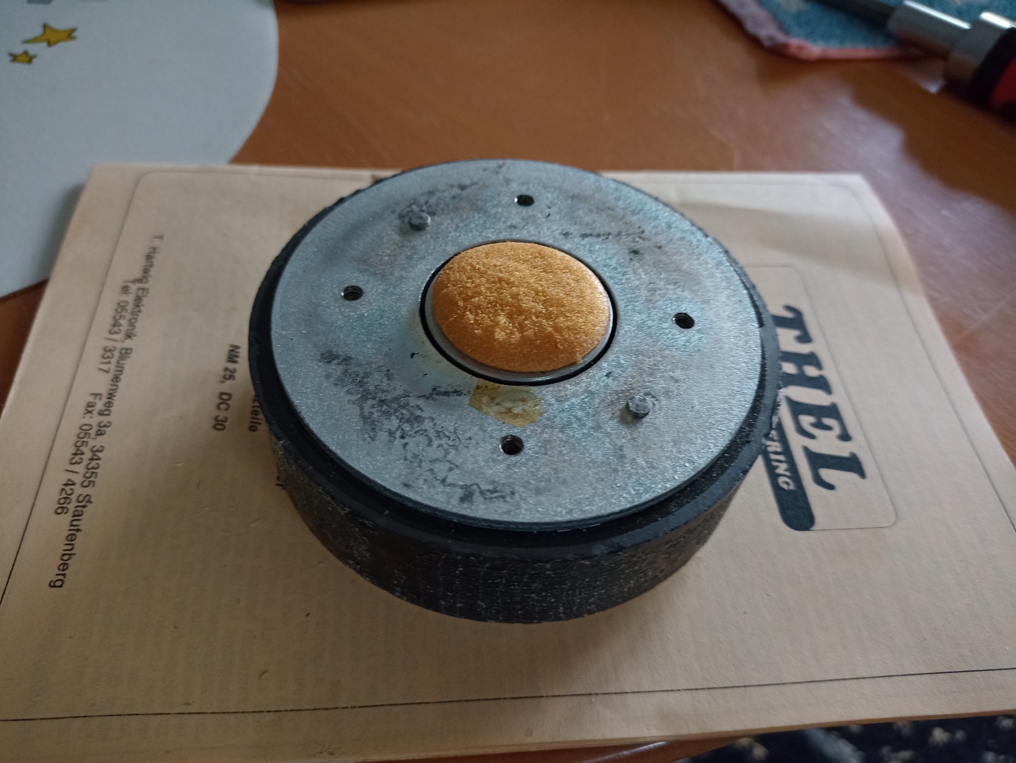

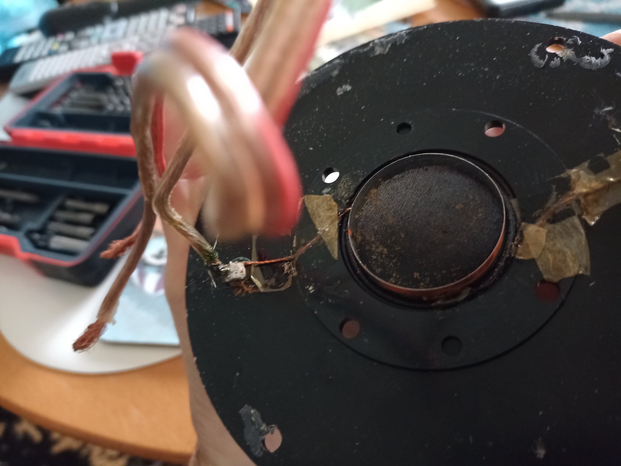

There is a difference between the way the Yamaha beryllium domes were made and the way nowadays beryllium domes are made.
Yamaha domes were a "vacuum deposition on a former process" whereas nowadays domes are formed out of a foil, so a totally different process with likely different properties.
One of the reasons the Audax domes become bad is the foam behind the done becoming brittle and spreading parts into the coil , see pic of a 35 mm dome I took apart...
