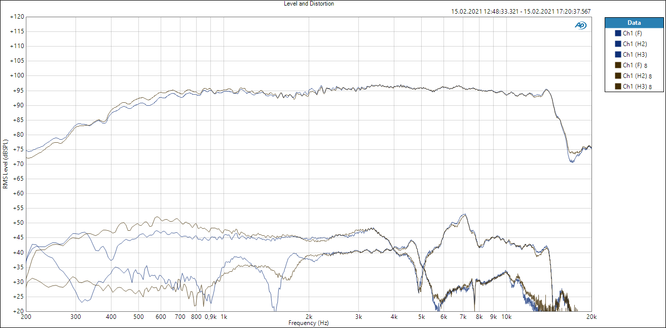

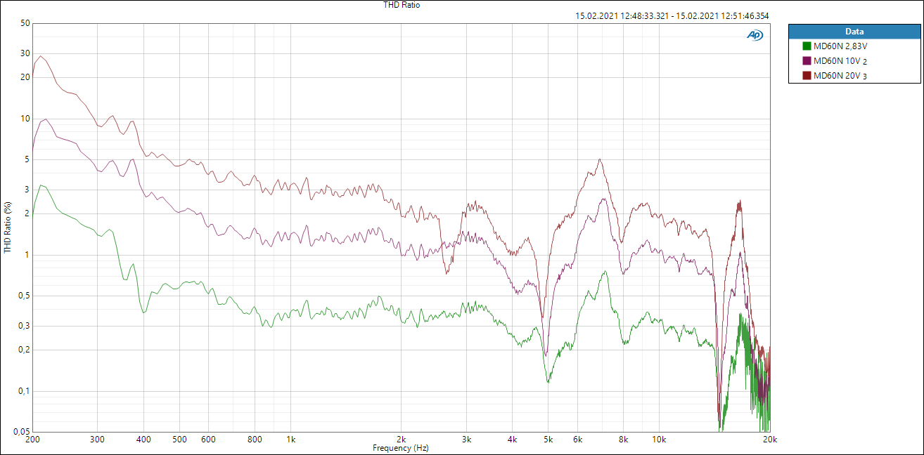

For a build with such a high cross over frequency I would chose a smaller dome! 3" is narrowing off axis already a lot at 3,5kHz. Maybe MD60N, here FR and THD from one of my units (HiFi Compass got a very early unit I belive, I also had some tolerances with an earlier unit. They are sensitive to the backchamber damping which I plaid around a bit).
20V are about 110dBSpl here. THD is not super low with these units but it's mainly H2.
And that's the difference with the "real" domes - you can build speakers which are capable of >110dBSPL with a membrane weight of 2g. Bliesma and ATC can be used wth 2 12" underneath and for full power would need a tweeter bigger as 25mm. You have high sensitivity, no compression and the ability to reproduce crazy peak levels -> very natural sound even at higher levels. You hear details better at some higher level cause S/N is bigger.

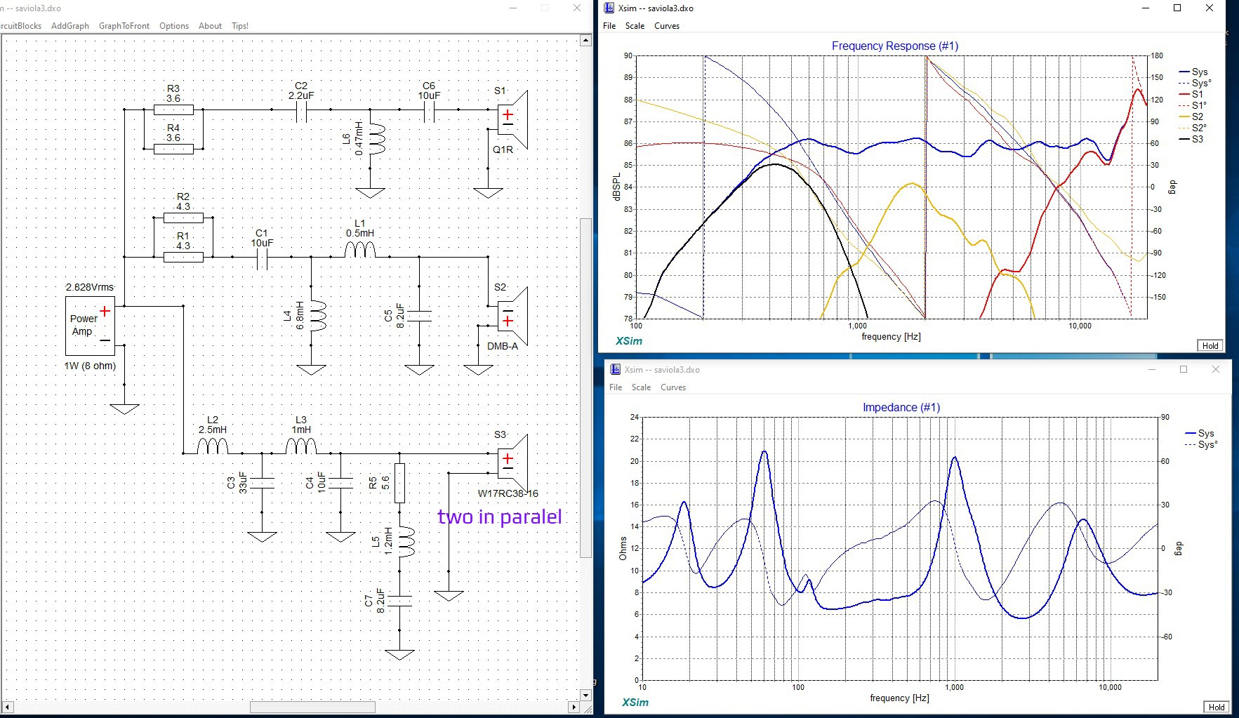

I have good result with Q1R paired with DMB-A in last 3way project, prety linear and nice sounding but not easy for designing crossower. Anybody experience with HiVi DMN-A ?

The MD60-N is an odd bird. On paper it looks nice, but in real life it has audible issues around 1k. The back chamber design is a compromise and I dont like what it does with piano music. I prefer the smaller Morel domes to it.

Same dome asy but slightly different motor and dampening. The DMN-A isn't worth the extra money IMO vs what you get.I have good result with Q1R paired with DMB-A in last 3way project, prety linear and nice sounding but not easy for designing crossower. Anybody experience with HiVi DMN-A ?
They're both a decent dome mid if you get lucky and end up with a closely matching pair. That's the main issue with these, but at least with the DMB-As, the high Qts around the Fs, makes them tricky to blend cleanly with the LF. They really need a notch filter around Fs.
The Morel domes are much better and easier to use, plus they can cross lower without a notch. If the consistency was better with the Hivi domes, they would be an absolute steal. Sadly, as with any product made with cheap labor, consistency will always suffer. If you order extras and pick out a pair that are close, you can end up with a nice pair of matching mids.
I ordered 2 pairs of DMB-As and still didn't get a decent matching set, so I sent them back. These aren't light weight drivers, so shipping a pair back would cost most people 20 - 25 bucks without a business shipping account using UPS or fedex. Don't expect parts express to pay return shipping either since they don't care how close the drivers are in specs to others. They state that 20 percent deviation in TSPs is acceptable with a pair of drivers. Thats absolutely ridiculous and another reason to support places like Madisound instead. They give you much better service and the price is similar. They used to sell the Hivi domes, but dropped them due to same inconsistency issues I mentioned.

Yes I know, prety hard to design but when designed right very nice sounding! Another one, Hivi DM-7500 might be interestng too, even better than DMB-A, I can see many nice reviews about them, looks interesting! DMB-A have prety high fs, in my case it was not as like on paper, freq response had shape like word M with an deep hole in center freq, around 86db I was need to tune them to get flat response, indeed it was flat like a buter but crosover frequncy was around 1k anf 4 or 5k if I am not wrong, not one of the best mids, hard to get right crossover, even phase was hard to match with tweeter, for example mid was 4th order but tweeter was 3rd order to get booth in phase, in my case ended good sounding but prety hard for desing and crossower parts cost twice the domes. : ) Q1R paired with DMB-A an nice flat combination.Same dome asy but slightly different motor and dampening. The DMN-A isn't worth the extra money IMO vs what you get.

@IamJF The MD60-N rear chamber isn't really designed with the best dampening strategy. I'm sure there is some cost cutting done here and they tried to save labor plus materials. By relying on a minimally dampened TL without absorbing media, variances in dampening are reduced if uneven amounts / densities of absorbing media are used. This was at least the case with the first run of these mids I've seen. I'm sure there are better materials and techniques to getting this driver to behave better around 1k. If someone wants to send me one of their MD60-Ns, I can come up with a better chamber dampening scheme.
I would have needed to remove the rear tube for my use case to fit it in an existing design so I messed around with it a little. Plan was to do a 3D print of a new backchamber. But then M74 appeared ... and I could build a complete new design for it, so no further development from my side.
