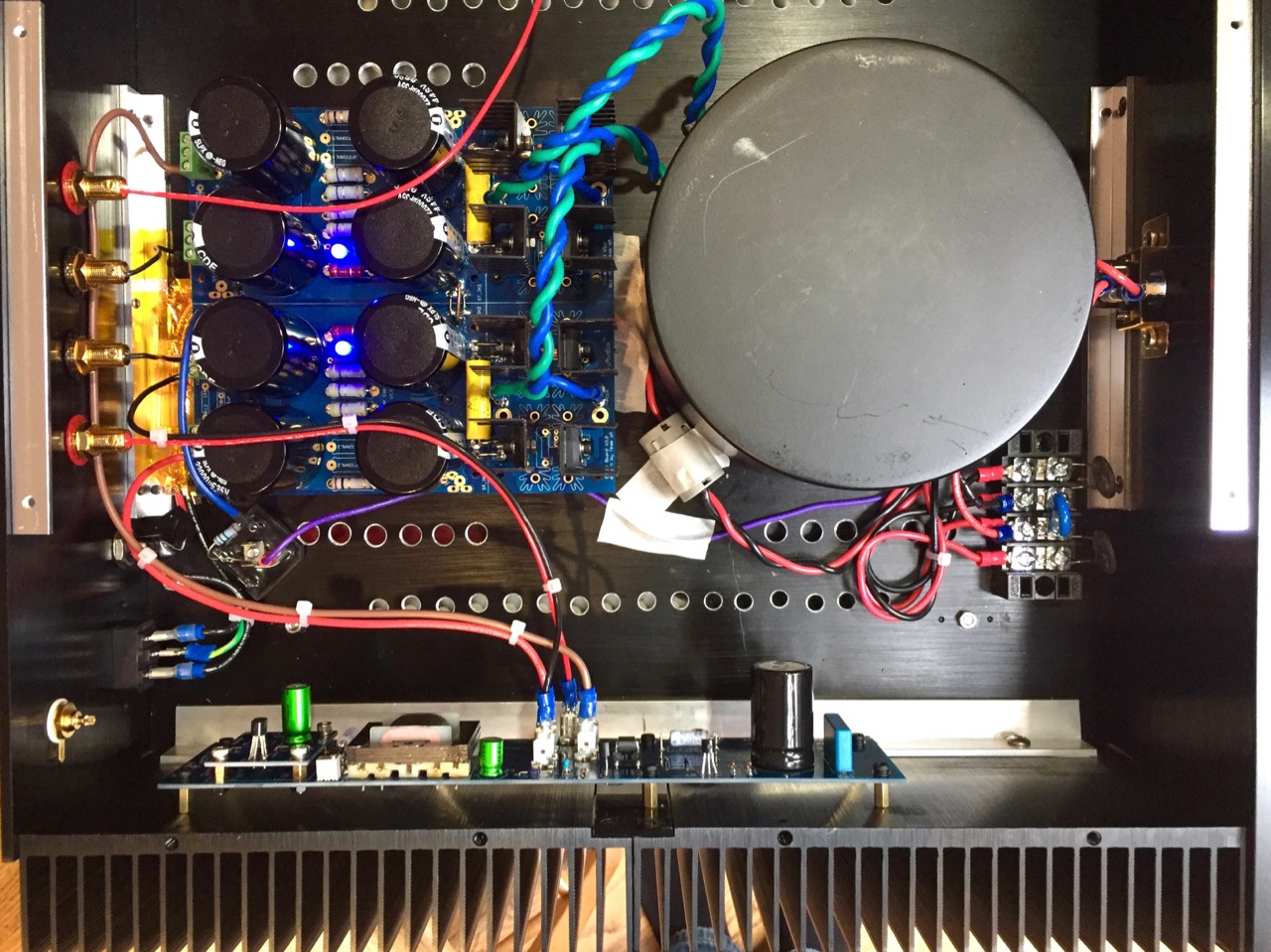

New M2x coming online
I just did a simple power on test for one channel of my new M2x. Looking good so far. Transformer is an Antek AS-4218, shielded by one of their 400VA steel cases. I decided to try a discrete rectifier implementation this time, using Vishay FEP30DP-E3/45 fast recovery diodes. Power rails loaded by a single channel are right at +/- 23.0V for now. Unloaded voltage was 24.6V.
The chassis is a 2.5U, 400mm deep ebay special. I figured its heat capacity would be sufficient, but added an aluminum L bracket along the base of each heatsink to better spread the heat between the two pieces on each side. Voltage across the source resistors indicates 1.31 Amps through the output transistors, and the heatsink was just warm to the touch after a half hour of warming up.
Good idea on the L-bracket and on the (DIY?) perforations in the bottom chassis plate. It must have been painful to find length1 brass male-female M3 spacers to fit the flat part of the heatsinks, and also length2 which fit the recessed area where the heatsink halves abut. Kinda weird not to center the power amplifier boards with left margin == right margin, so the left output transistor has the same amount of heatsink as the right output transistor. But the arrangement in the pic does move the Edcor another inch farther away from the power toroid.
I bet the socket you used for the 4N35 cost more than the optoisolator itself.

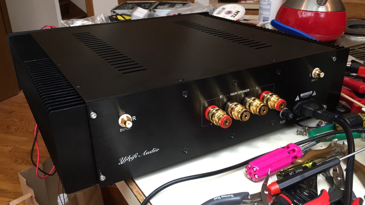

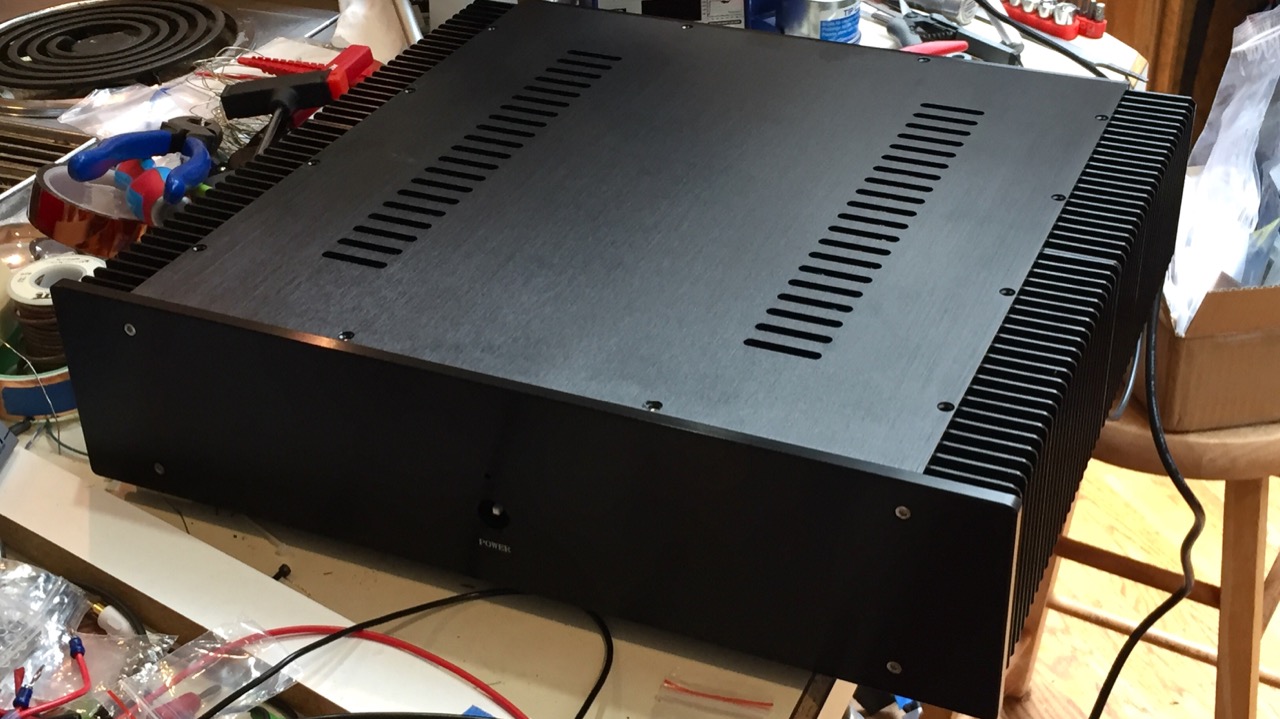

Took a couple quick and dirty pics of the amp while both channels are cooking. Rail voltage has dropped slightly to +/- 22.6V, and bias current is holding steady at 1.31 Amps. Output offset continues to drift slightly, but remains in an acceptable range, thanks to an unmentionable procedure using component values that shall not be named. 😀
The extra holes that needed to be drilled in the bottom plate are doing their job, as the power rectifiers are giving off a noticeable amount of heat. The main heatsinks do have a detectable thermal gradient from front to back, and the front plate is also warm to the touch. My plan was to have the entire case act as a heat sink, and this seems to be working well. So far the whole case is just warm to the touch, with warmer spots where the MOSFETs are bolted on. The hottest areas are still comfortable to touch indefinitely. I'm using 1.78 mm thick ceramic thermal interface spacers and 10 mm brass standoffs to elevate the main PCBs above the heatsinks.
I chose to insert the C1 output capacitors in the Ishikawa IPS to allow for some deliberate tinkering of the JFet offsets. I have a distortion analyzer and a 'scope, and plan to play with H2 content by adjusting RV1 when feeling sufficiently motivated at some later date. In the meantime, I didn't have any 200Ω pots to install, so the output caps are there for peace of mind.
Nice neat build! 👏🏻
Well done! Different rear layout than most. Which chassis did you use?
