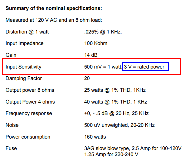

Have a question though - AFAIK the M2 is not a high gain amplifier (14dB?), so wouldn't a preamp with decent gain be a welcome addition in the system?
The M2 has 15 dB of gain. What gain preamp you need depends on your whole system. In my case, I have 103 dB+ horn speakers. I built a transformer coupled linestage with a 5.6:1 stepdown that provided only 6.7 dB of gain. This driving the M2 is perfect combo for my setup with the normal voltage inputs. I built another linestage (that used the same tube) but provided full mu of the tube or 19 dB of gain. It was too much gain for my system.

My question was addressed to Sesquipedalio, who in his post lists three speakers. The sensitivity according to Stereophile for his speakers are as follows:
Thiel CS2.3: 87dB/2.83V/1m
Snell KII: 90dB 1W/1m (anechoic)
Triangle Esprit Comete Ex: 90dB/W/m
Decent sensitivity, but not in very high; hence my assumption was that some preamp gain would help.

According to the manual, the M2 yields 1W@500mV in, and needs 3V in for rated power. So a few dB of preamp gain would be helpful for many of us.
Thanks Mark! I had not downloaded the manual. Makes more sense now.
BTW, the 15 dB came from Nelson's table at the FW site.
