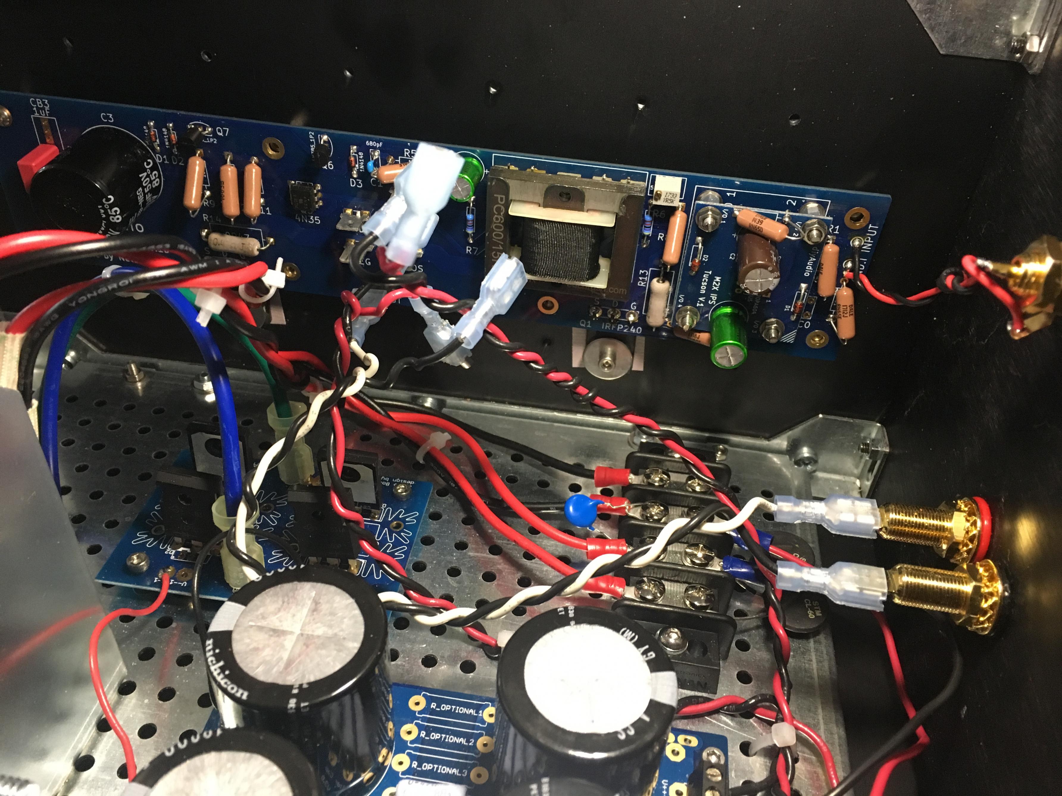

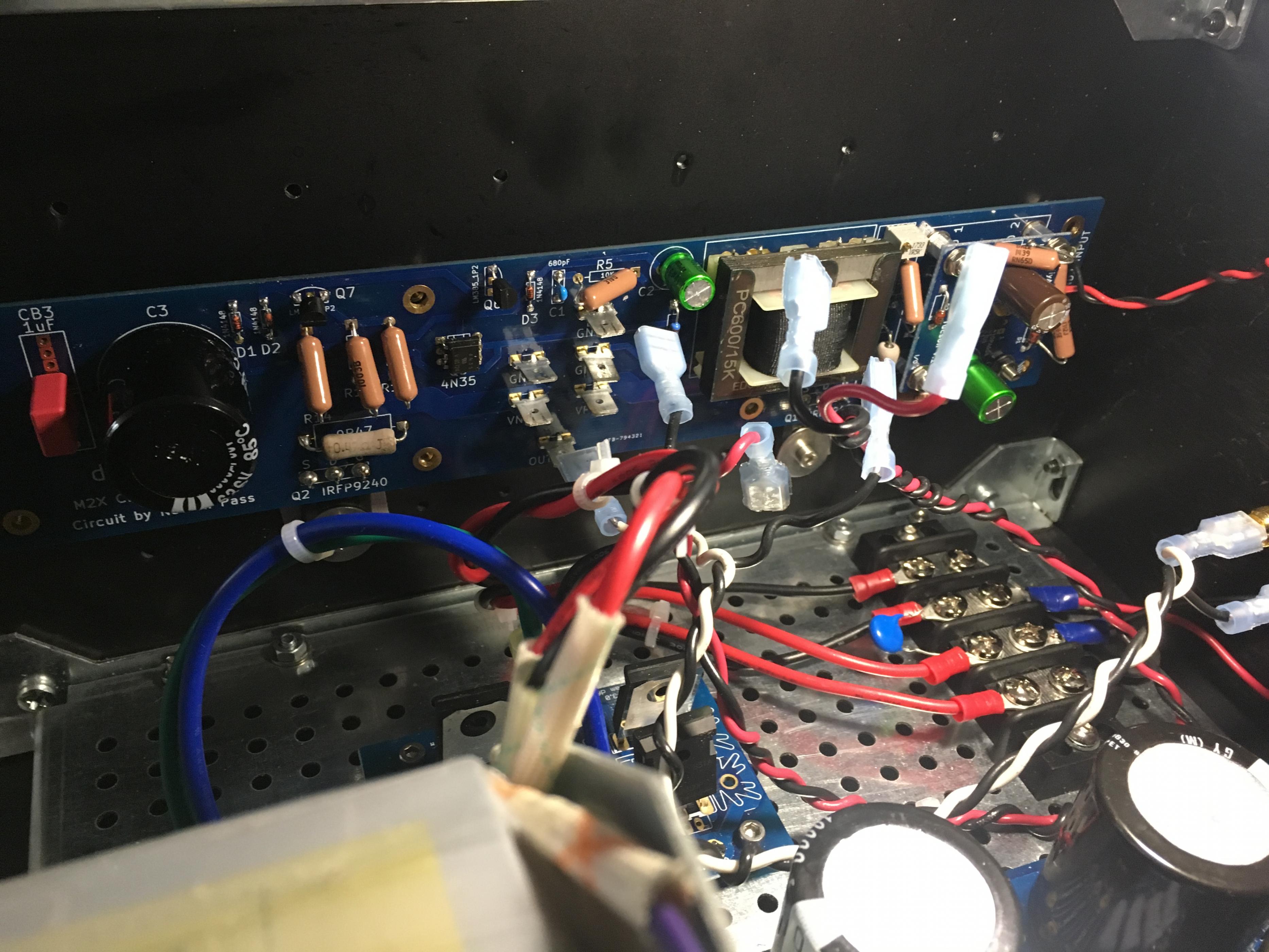

I'm building the M2X and have a problem. After stuffing and soldering both amplifier boards I tested for proper voltage at the secondaries, diode boards, and the PSU output blocks. No problems found. I then wired and connected the left channel board. I tested with the dim bulb tester first. The bulb lit and dimmed quickly. I took that to mean no shorts. I then removed the tester and started to set offset. I used a shorting plug but no dummy load tester as I don't have that. After a few minutes I saw smoke coming from the board in the Q2 area. I shut down immediately. The resistor at R14 looked a little smudged. I put my finger on it and it was too hot to keep there.
I've confirmed that the output devices at Q1 and Q2 are installed correctly. I confirmed that I installed the resistors in the right locations. They all measure OK except for R12, which is a 100 ohm resistor measuring 83 ohms. I've confirmed that the Keratherm is OK - no tears, holes or anything that might impede full contact with the heatsink. I powered up again, same result except I think I saw smoke coming from Q7 but I'm not sure because I shut it down really quickly. I removed the board from the heatsink and looked for anything that might help to locate the problem. I didn't see anything obvious. I did confirm that the optoisolator at Q5 was installed with Pin 1 in the right place. Same for the Edcor signal transformer.
I decided to test the right channel. I disconnected the left channel. No smoke or bad smell so I guess whatever I did wrong on the other board wasn't repeated on this one, although there's problems there too. Offset fluctuates from 0.00 to about 3.0. Very low audio output and badly distorted. I'm going to concentrate on the first board for now. Any thoughts on what could be causing the behavior I described? I won't be surprised if some parts will have to be replaced. R14 looks pretty bad.

garyalex, the last guy who reported burned up 0.47 ohm resistors, discovered the cause via a simple continuity check.
He unplugged his M2X from the mains, waited 10 minutes, disconnected the amplifier boards from the PSU. Then he used a digital multimeter to measure resistance between the MOSFET mounting bolt, and each of the MOSFET Drain, Gate, Source. If there's low resistance from the mounting bolt (a/k/a the heatsink) to any of D, G, S .... that's wrong. In his case, he had a small metallic burr on his heatsink which pierced the Keratherm insulating pad and shorted the MOSFET package to the heatsink. Ouch!! It kept doing this every time he replaced the MOSFETs, which he did more than once. Ouch!!

Perhaps a few fotos from your pcb? Optocoupler 4N35 in correct direction.
Rail voltages o.k.?
What kind of insulation between FETs and heatsink? LM385 in correct direction?
LM385 1.25v version?
Foto of your wiring?
Diodes D1-D3 in correct direction?

Does the optocoupler 4N35 have good contact? If your offset at the speakeroutputs fluctuates from 0V to 3V something is really wrong.
What Mark Johnson wrote that the MOSFET got a short or was destroyed?

Jim has graciously agreed to have a look at my amp boards. They're packed and will be shipped tomorrow. Rail voltages were good. Keratherm between MOSFETs and heatsink. As far as I could tell 4N35 has good contact and LM385 in the correct direction. Hopefully Jim will be able to sort this.
