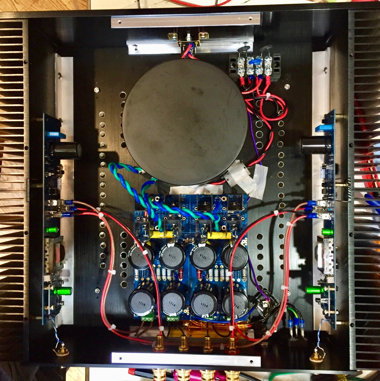

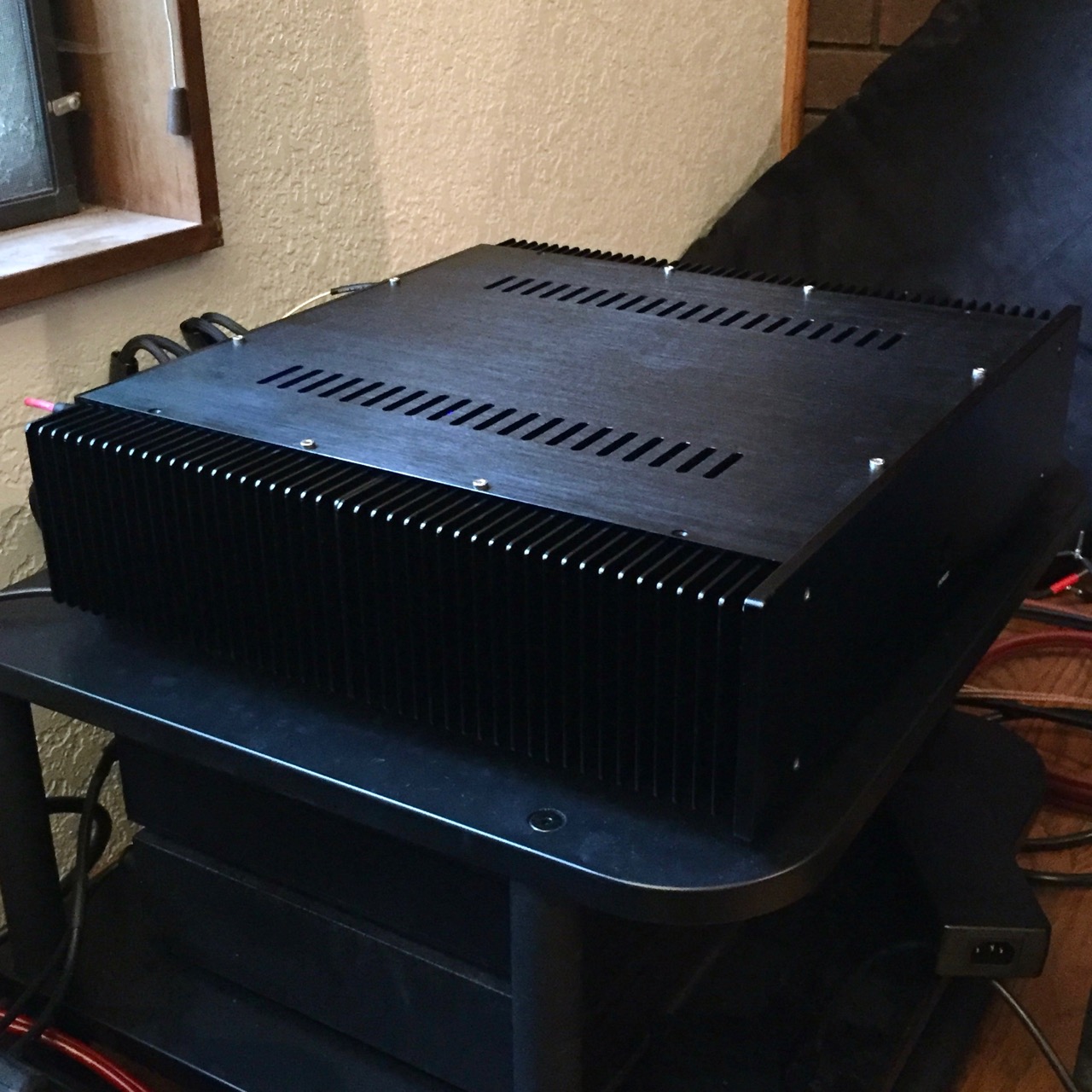

It has been a pleasure to listen to the new M2x for the last couple days. As my last post indicated, it has that wonderfully engaging quality that tends to thoroughly distract one from other thoughts or tasks while the music is playing. It seems to have enjoyed a relatively brief 'break-in' period compared to the ACA builds I have done. It did mellow out a bit, but has remained stable in timbre, dynamics and presentation after about four hours vs. about 20 for the ACA. This is the fist big Papa amp that I have built and had a chance to listen to for a while in my system. It's been a pleasure to have the extra headroom for when I want just a little 'more.'
I am also happy to report that it is nearly silent. I can only hear a very faint 60/120 Hz hum when my ear is next to the speaker grill cloth. No noise is detectable from the listening position. I may try rotating the transformer case a few degrees just to see if that changes anything. Or not. The minute amount of hum is really a non-issue.
Since I have become accustomed to the sound of my various ACA builds, all of which are either dual-mono or separate monoblocks, the character of the M2x sound stage with its single power supply is noticeably more concentrated toward the center. It still does a good job of making the speakers 'disappear', but doesn't expand beyond the speaker centerlines. Top to bottom and front to back imaging seems slightly restricted as well. At the beginning of the build, I had considered using a pair of 200VA transformers in steel cases. Two capacitor boards would have just fit, if I had used monolithic bridge rectifiers instead of discrete diodes. I chose instead to go with the a single supply with the standard amount of overkill, a 400VA transformer and 22000 uF capacitors. The discrete diodes did buy me about 1.5 Volts on the power rails, which I like to have as a power reserve. As things stand, switching to a dual-mono supply would be a major amount of rework, and probably more trouble than it is worth. I have a couple other ideas in mind to improve channel separation.
As with the other amps I've been listening to recently, my system remains as follows:
CD player - Naim CDX2 w/ diy XPS DR power supply (using Sigma 22 regulators)
Preamp - Naim NAC 82 w/ diy dual HiCap DR power supply (using Sigma 11 regulators)
Speakers - Vandersteen 2C

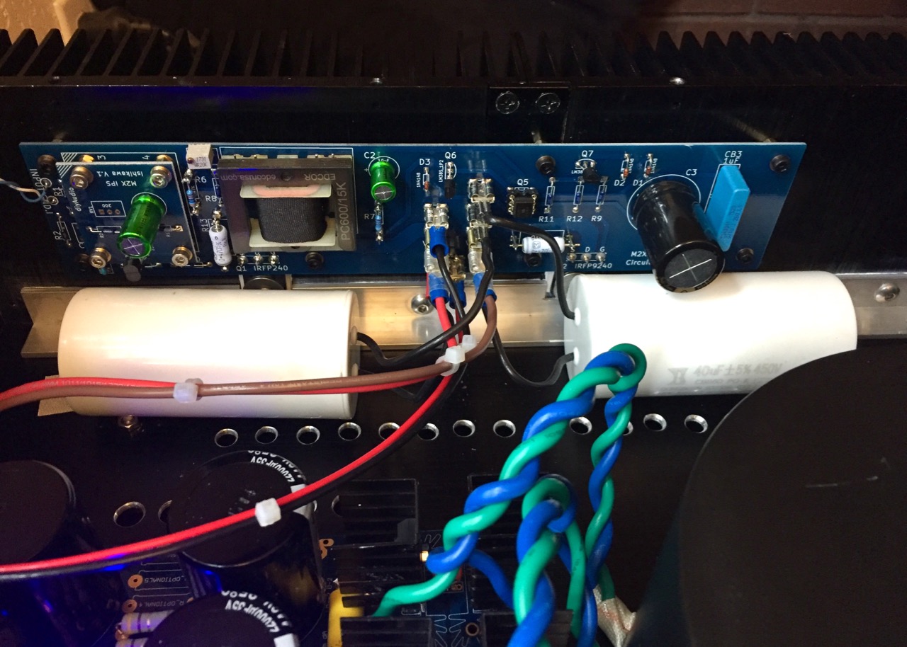

There were two stages of options that I had in mind. The first involved adding local capacitance to each channel board. The second, more drastic stage, was to add capacitance multipliers local to each power rail. See the K multiplier for an example.
Fortunately the solution proved to be quite straightforward, as I had already acquired some special parts in anticipation. Following another recommendation by the Wiley Zen Mod, I had a set of motor run capacitors on hand. These did the trick. The soundstage has opened up quite nicely, as has the top end. Transient attacks of percussion instruments have also been improved. Quite frankly, this is what I had hoped a big Papa amp would sound like. Musically involving, detailed and non-fatiguing.
These particular caps were 40 uF, 450V oil-filled polypropelene. They are sourced in the US and carry the CBB60 and MKP markings. Search for "CBB60 motor run capacitor." Make sure they are run and not start caps.
The amp is now ready to use as a platform for evaluating the various IPS boards. I will order parts for the Tuscon and Mtn View next.

You might want to experiment with where you connect the two leads of your new supply bypass capacitors.
Maybe you've got a tightly twisted pair of wires that connect between the amp board and the positive output of the PSU, where the two twisted wires carry VPOS and GND. If so, connecting the new bypass cap right at the VPOS and GND FastOn spade connectors on the amp board, might be worth trying. You also might have another tightly twisted pair of wires that connect between the amp board and the negative output of the PSU. Those two twisted wires carry VNEG and GND. Their FastOn spade connectors on the amp board, might be a good place to try connecting the other bypass cap.
OR, perhaps right at the drain leg of the output MOSFETs (where MOSFET connects to supply) would be a better place to connect the VPOS end and the VNEG end of the bypass caps.
You will probably be able to dream up another few possibilities to try.
Yeah, I did that last one 😉
I made a direct ground connection from my PSU board to the speaker negative binding posts. With that in place, the M2x channel boards only use ground as a reference for the VAS, which is the Edcor autoformer. I routed VPOS and VNEG from the PSU to the channel board without twisting in a ground wire. The channel output is routed alongside the ground instead. The last two pictures I posted show how this was done.
With two open GND spade lugs available, I used those for the local motor run caps. The VPOS and VNEG capacitor connections were made through piggyback spade connectors. Very simple and easily reversible if it didn't work the way I hoped.

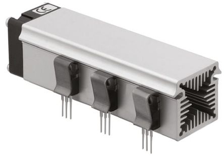

If anyone is considering adding a fan to their M2x for additional cooling, the thread linked below might offer an idea or two. Of course you could mount the fan inside the chassis or outside the chassis; totally your call. You could have one fan or several fans, again your decision. You could even go wild and build a heatsink "tunnel" like the attached picture. The Pass A-20 amplifier project had a similar contrivance.
You can place the thermal sensor wherever you wish; it's at the end of a cable and you can relocate it easily. Monitoring heatsink temperature, bottom-of-chassis temperature, air temperature near the front, air temperature near the rear, anything you choose.
Remember that M2x is a class A amp and its power dissipation is relatively constant, whether it's sitting idle with no input, or playing loud. So the amount of heat to be removed is relatively constant, and the fan airflow required to remove this heat is relatively constant. So the fan will run at a relatively constant speed on a class A amp like M2x. It won't slow down when the music gets quiet. On the other hand, it will take the fan a loooong time after power-on to gradually creep up to its final fan speed. Because it takes a looooong time for M2x itself to gradually creep up to its final equilibrium temperature. There is a lot of thermal mass to warm, and this takes time. The fan will be slower and quieter at turn-on, than it will be 2 hours after turn-on.
Fan inside audio chassis: variable speed, temperature controlled, analog. No PWM.
