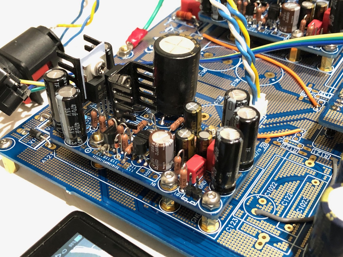

I think I have found why my L channel let out some of the magic smoke from R12.
I have the output devices in the wrong place, I have them swapped. I need new glasses.
Swapped new Mosfets in the correct position this time and replaced the 100 ohm resistor - no smoke.
Now to do the setup.
I now have about 300mV offset on the right channel and the left is in runaway mode, gets above 1V, any pointers would be appreciated.
Sounds like the optocoupler died too. Did you also measure the voltages at the source resistors? Are they ok?
Thanks, what is the dc offset range?
No output on the L channel and R is just noise coming through the speaker that started getting louder so I switched off.

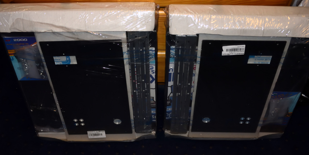

For my M2X build I received 2x 5u deluxe chassis from HiFi2000 shop. I built as mono blocks to have space for a large PSU with good distance from transformer to M2X boards (part of avoiding Edcor hum pickup issues other has faced). Apart from that I like mono blocks. I ordered two sets of connector kits from DiyAudio Store and as you can see from the picture I have back panel "mono block cut outs" for the connectors. I like two sets of speaker terminals as this makes it easier to use two sets of speaker cables for bi-wire. These chassis are heavy!
If other want same mono block panels I assume 30 Euros can be saved as this is the price to make the "cut file".

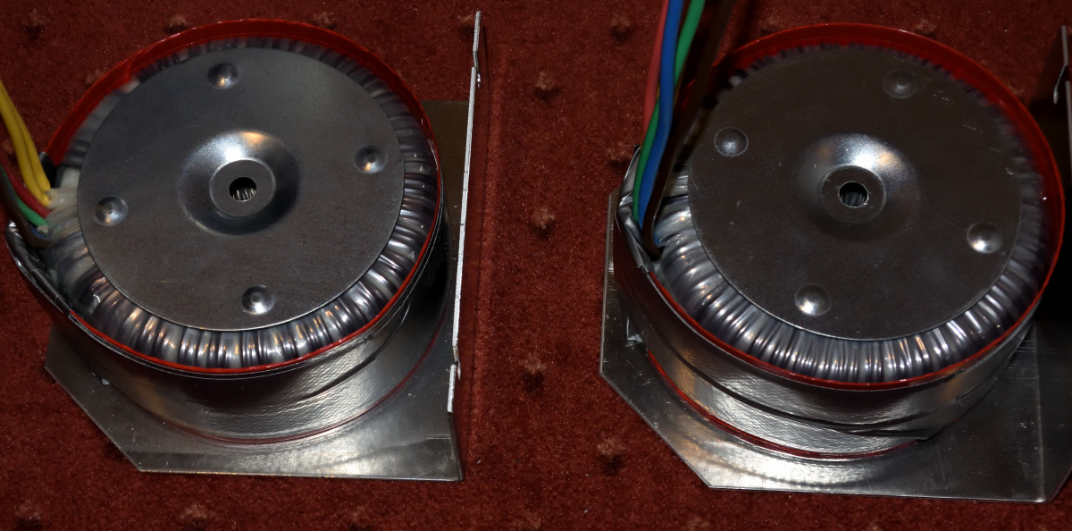

I decided for 500 VA transformers. One for each chassis. Then I hope the flux will stay inside the core. It is standard Talema Czech made. I found a good offer. Think they are ok. A lot of good stuff are Czech made! ….then I applied magnetic shielding. Also the steel rondel is speciel grained steel for magnetic shielding (poor mans mu-metal). I got the shielding from Don-Audio.
