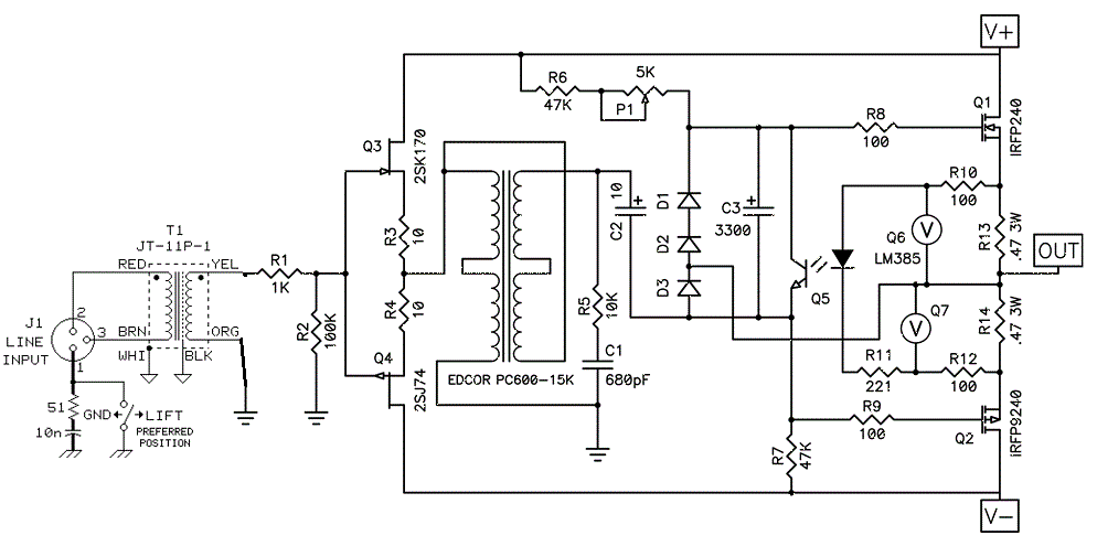

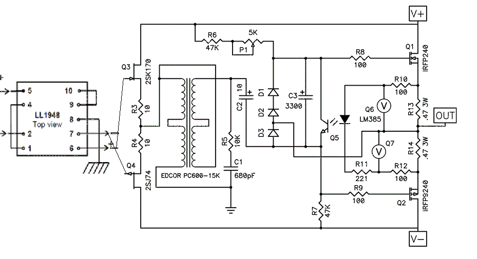

I have a very very long run from preamp to amp and would like a matching balanced T before the M2x.
I am using a 4p1L to a LL1671 with balanced output but want the M2x to have a Input T as well.
Does the attached image make sense?
I know I could just keep R1 and R2 and slap that inputT right infront but could I do what I put in the image and remove R1/R2 and place each pole of the T output to the Q3/Q4 directly.
center of secondary would be grounded of course(maybe place the 100K R there too?

I recommend you check with the much larger number of people who have built the First Watt M2 amplifier using the original Nelson Pass input circuit (no daughter card) with Toshiba JFETs:
I think you will need to swap 7 & 10 (same phase - see F6, note opposite phase) then connect 7 & 9 to 0V.
On second thoughts, parralell the output windings to keep the JFET gates tied together.
Let me rephrase the question because I did that in a rush this morning between meetings.
Attached is a new image.
Can I remove R1 and R2? I know they set a load but wouldn't the Transformer do that instead. I know there is losses and some people will say why would you do this and add distortion device. But I have over 40 ft from pre to amp so I need that CMRR.
R1 and R2 are there for establishing proper conditions for input JFet buffer
if you are keeping input buffer , do not remove R1 and R2 ......... with these values they are not loading your additional xformer in any harmful way
ZM is correct (as usual), you also need something to terminate the transformer, I should put my brain in gear before answering.
terminating xformer to establish linearity (20-20K) is completely other issue
these resistors are there for reason and will not impede loading impedance for xformer

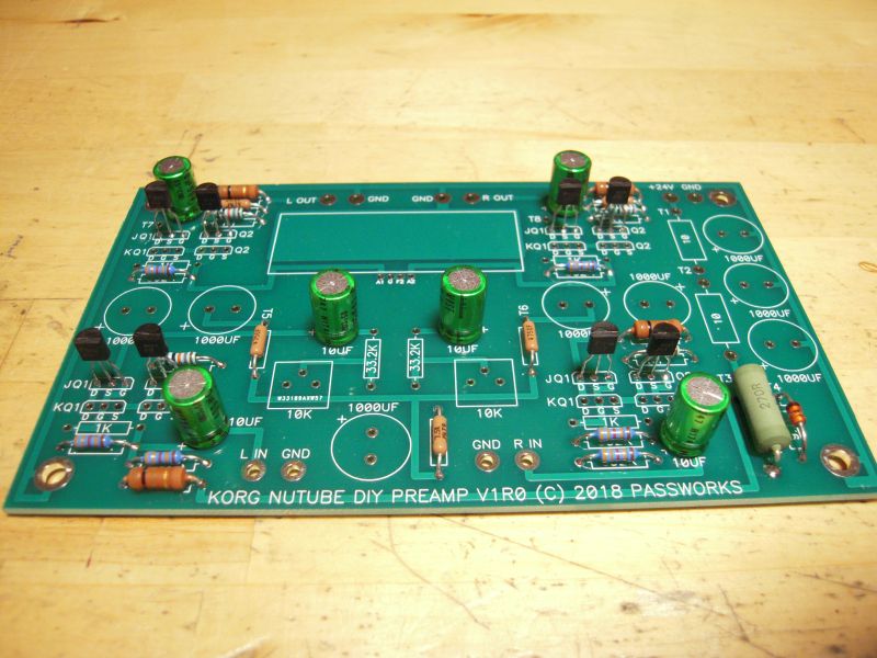

I have used the NICHICON UES (green sleeve) bipolar caps in position C2
in my M2X with very good results.
At the moment I have a MUNDORF cap in there. Sounds also very good.
For me a very marginal difference in sound. Can't tell you which is better.
I used the green NICHICONs also in my KORG NUTUBE Preamp (not finished yet). Why? Because they sounded very good in the M2X. 😀

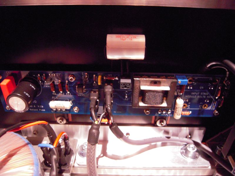

One specific Nichicon capacitor is called for in the M2x Bill Of Materials (and also on the official M2x schematics). It goes into position "C2".
Another specific Nichicon capacitor is called for, in all five of the M2x daughter cards' Bill Of Materials and on their schematics. Download the .zip archive file from post #1 of this thread, and have a look for yourself.
edit- you can also see these Nichicon capacitors in the color photos attached to post #2 of this thread. Let's try to link to that specific image:
C2 is on the M2x main board, and the other Nichicon is on the Tucson daughter board at far left. You can see that, besides the Nichicon, Tucson includes a second electrolytic capacitor, made by Illinois Capacitor. It is Mouser part number 598-477CKE050M .

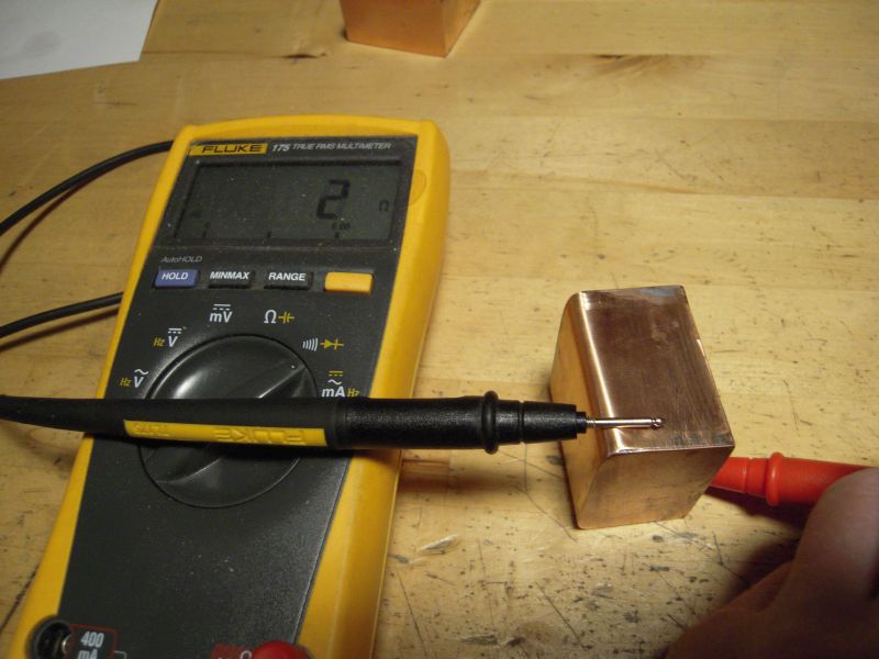

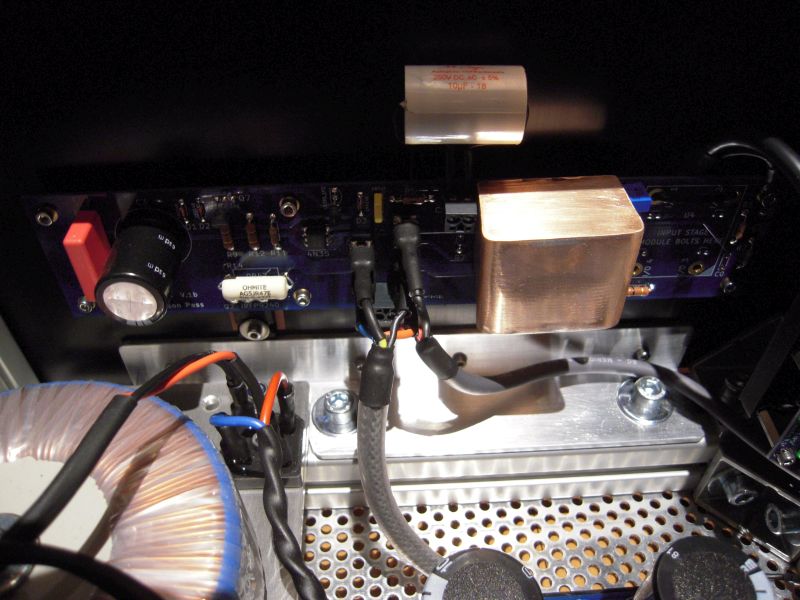

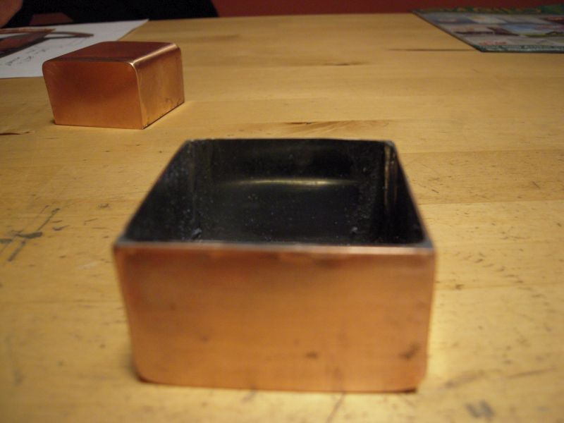

I am still working on the EDCOR shielding covers. I made them of copper (1mm).
Inside is now MU-metal foil (0.1 mm). I have electrical contact between inside
MU foil and outside copper.
I need to make a bracket for the covers over the EDCORs.
I will be surprised if it was worth the effort? I will report back.
