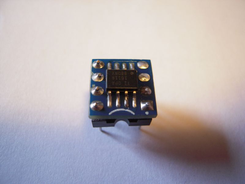

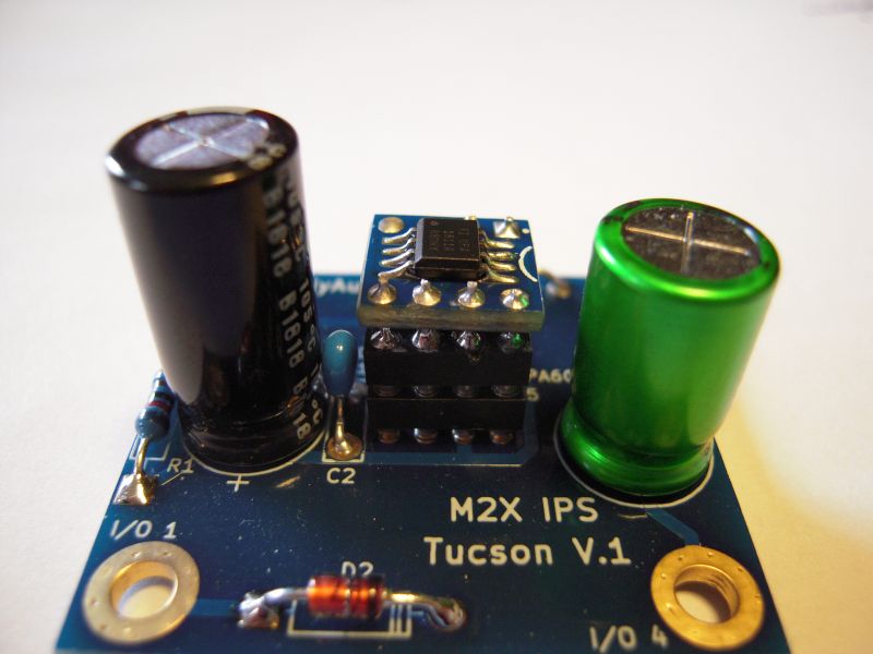

I reported about my problems with the TUCSON - board (offset at loudspeaker-output drifting away).
On this lazy sunday morning I inspected everything around my switcher-board.
Putting out the boards, measuring,.....
Then I inspected the TUCSON board. All solder joints, measuring,....

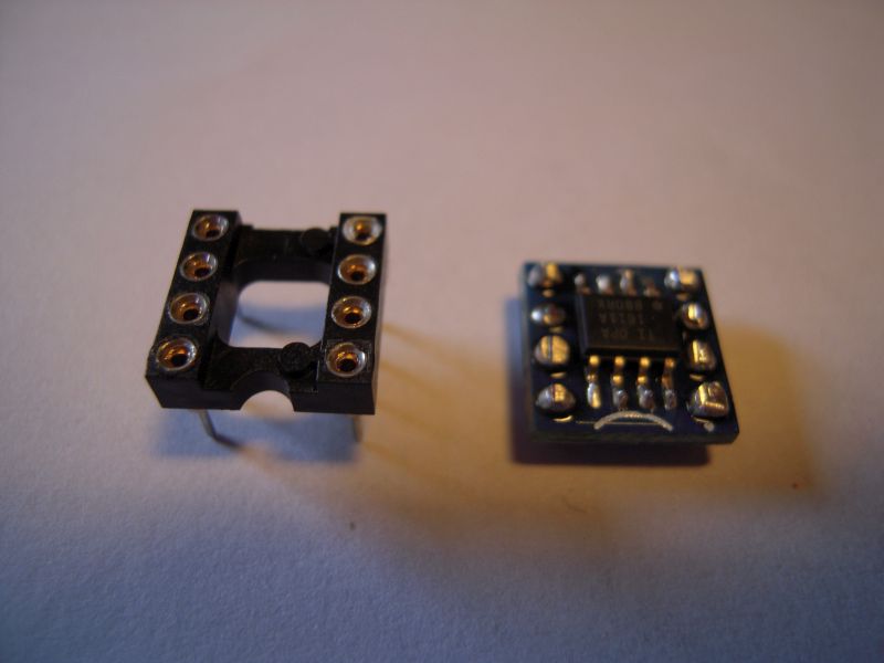

Then I put out the OPAmp - OPA1611 (SOIC8) on a DIP8 socket with adapter-
pcb. Nothing to see under the magnifier glasses. Measuring - 1 pin suspicious.
And then I had suddenly 2 parts in my hands.

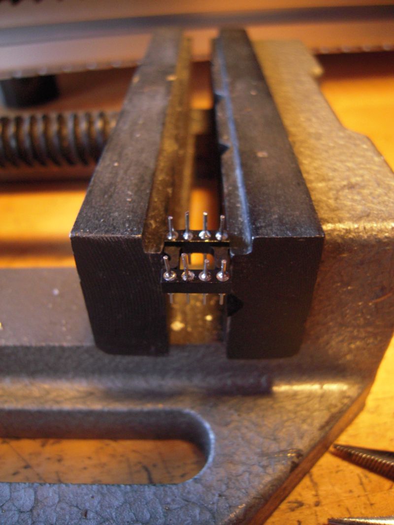

I disassembled all and soldered it again. And I cleaned so much. Especially
the flux between the legs of the OPAmp.
It works!!!!
I put the TUCSON boards in. Switching on (I was alittle bit nervous) and all
worked flawless.
I am happy!
Dirk

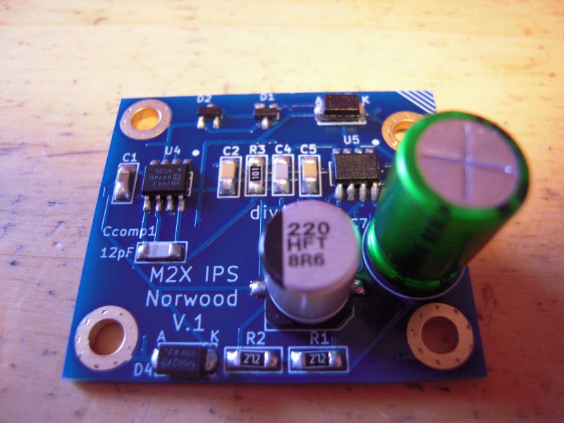

M2X experience
Hello M2X-builders,

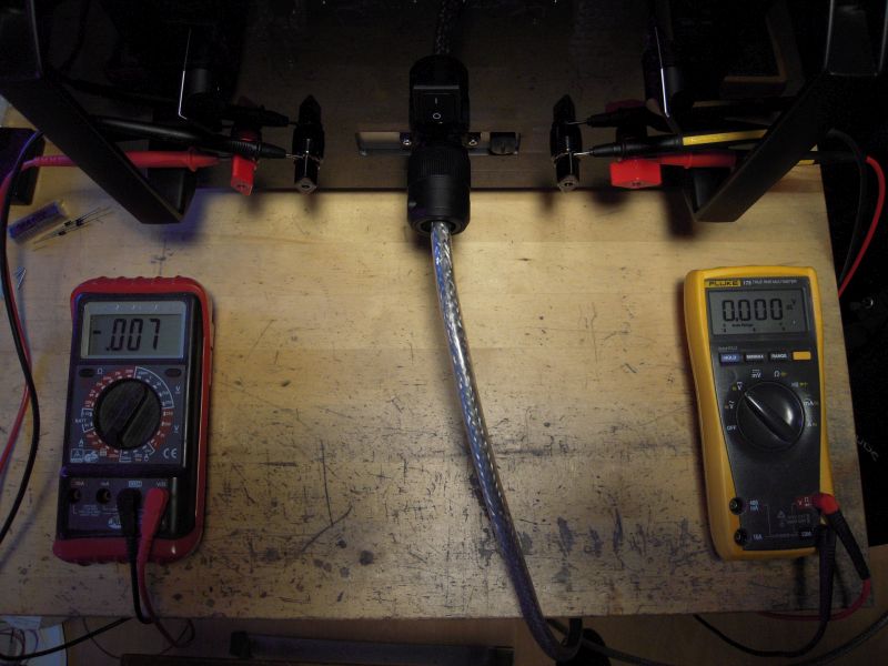

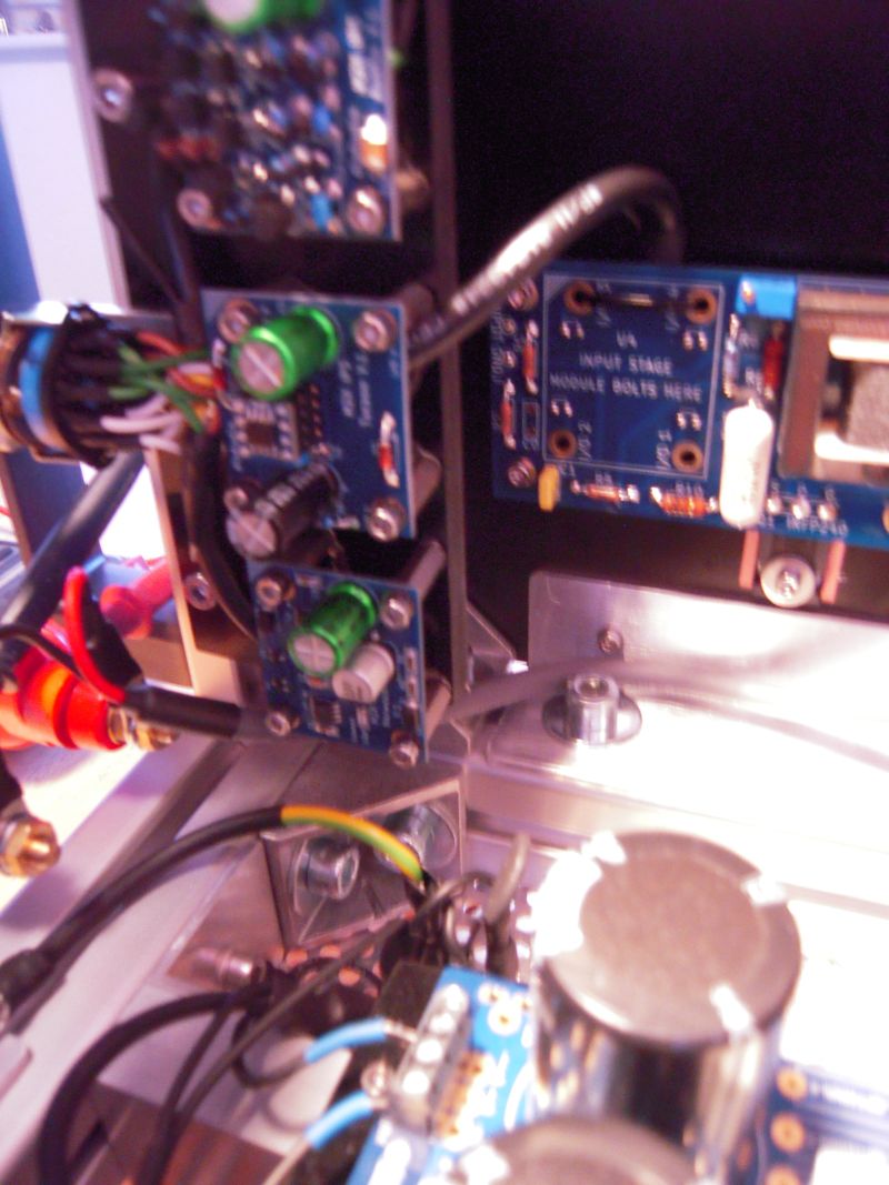

today I mounted my overhauled NORWOOD - boards into the amp.
All is working! Fantastic!
I think responsible were my solderjoints at the OPAmps. I am not sure.
I resoldered the complete boards. I think I will never use Pb-free-solder
anymore for SMD-devices?!
I cleaned the NORWOODS from the flux (with Isopropyl-alcohol and an
unused toothbrush 😀).
Offset at loudspeakeroutput was measured 20 seconds after turn on.
(without any adjustments). 7 mV and 0mV seems pretty good?
I am running them in. Music is playing. Success!
Sorry to everybody I was confusing! I apologize!
Special thanks to Mark Johnson, 6L6 and MEPER!
Cheers
Dirk

Congrats with the success!
I have red Norwoods!! ...the sound should be a bit "warmer" than the blue Norwoods.
