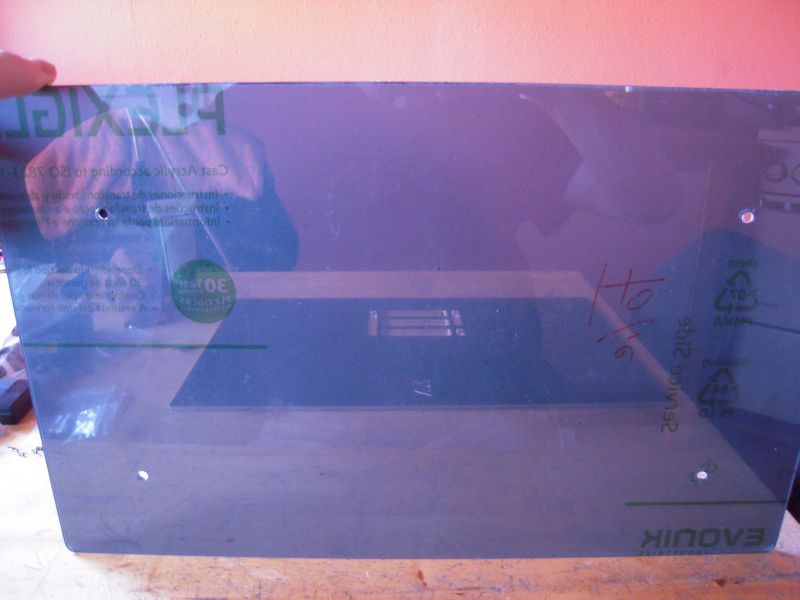

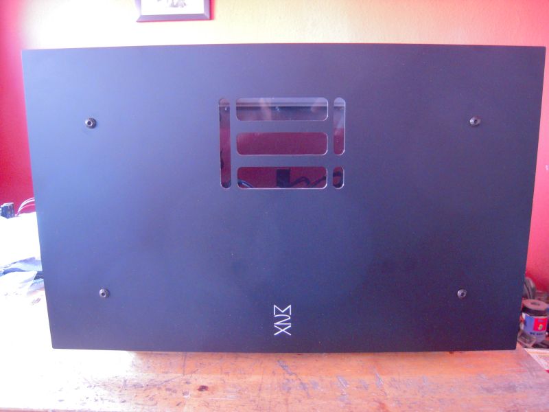

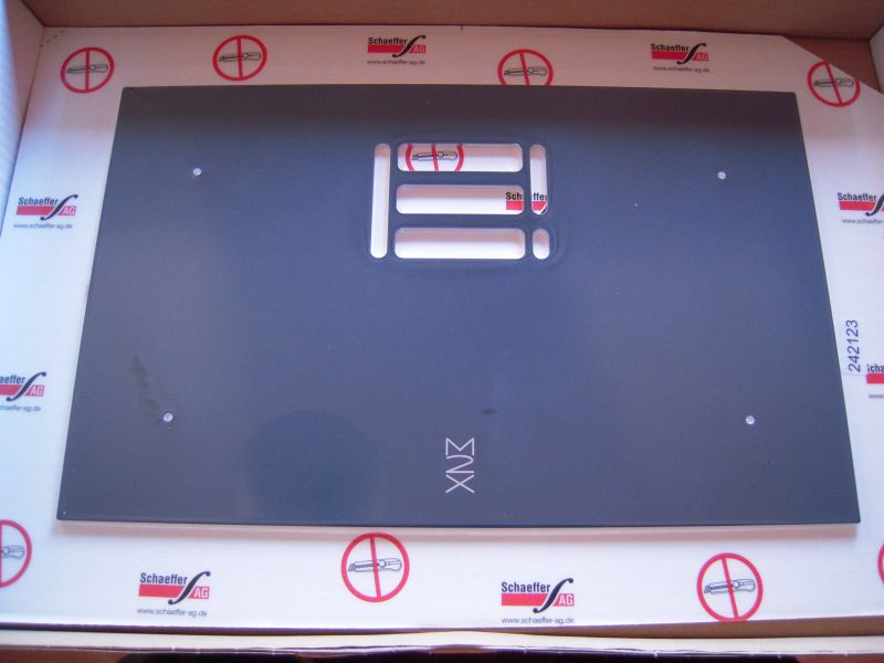

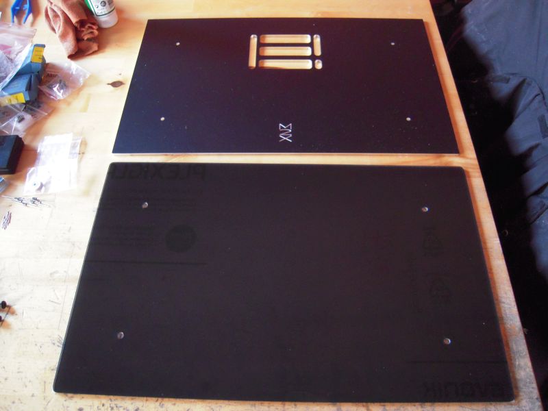

The german Schaeffer AG (front panel express) made something from my CAD - experiment.
The aluminum frontpanel is 4mm thick, black anodized. I tried to design a simplified MOSFET - logo. This was cut out of the aluminumplate.
I added the M2X-lettering.
I cut a second acryl plate (translucent dark grey) in the same size as the aluminumplate. Second layer.
Now the M2X - baby looks like this.

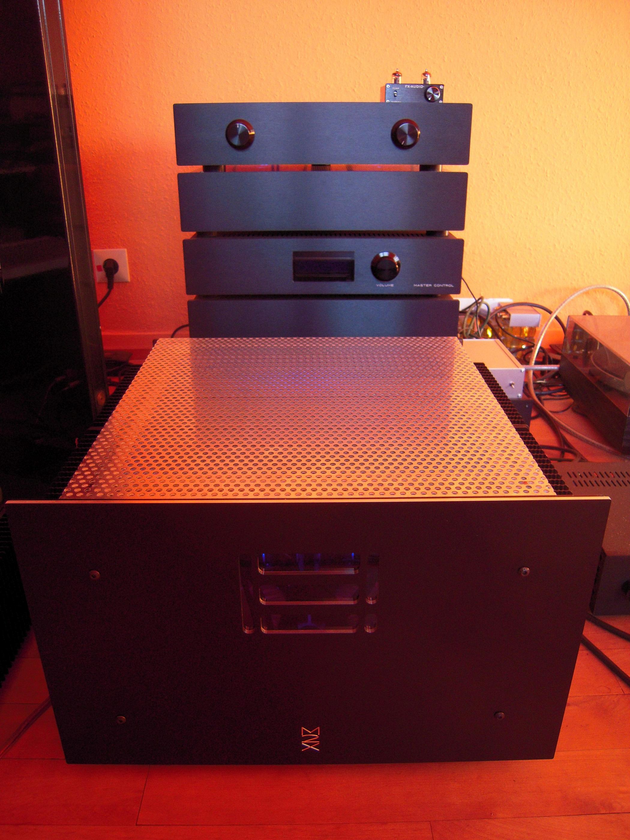

The NORWOOD-boards also sound great!
Greets Dirk

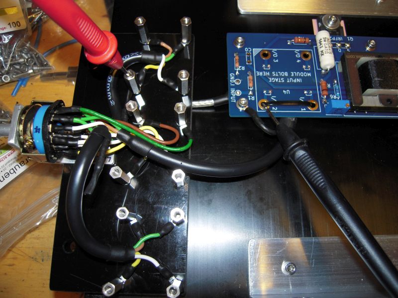

When you switch between the input boards…..it is only the inputs/outputs which are switched so all boards have power and are up in their working temperatures when you switch?
I received boards and am starting the BOM.

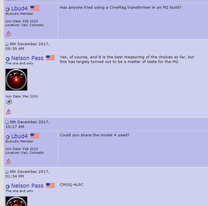

Has anyone used something other than the Edcor transfomer's and, if yes, what are your thoughts.

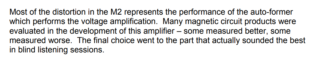

Here's a paragraph from the manual of the First Watt M2, the one that was sold as a finished, complete, assembled amplifier. The whole entire manual is on First Watt's website as a pdf download.

answer to MEPER #1414
Hello MEPER,
all 4 contacts of the inputboards are switched. But I only do this if amp is off.
Never tried during operation.
On the foto you see the 4 colours of the cables. The standoffs on the switcherboard have the exact same pattern like on the main-pcb.
The alps-switch is a 4-pole.
Greets
Dirk

Ok....so it is not possible to do a A,B,C comparation "on the fly" where all input boards are at working temperature. That would have been a fun experience.
