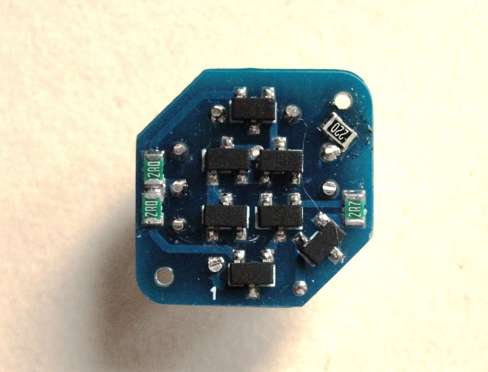

I started a brief discussion here about using the LH0033 for the M2X input stage, for which it is ideal on paper at least.
https://www.diyaudio.com/community/threads/diy-front-end-2022.394339/post-7235889
In order not to upset our moderator, I moved further discussion here.
Mark made a few remarks about it being expensive and difficult to get.
https://www.diyaudio.com/community/threads/diy-front-end-2022.394339/post-7236421
But you can still get them at ebay for reasonable price.
I bought 20 years ago, and can part with some if people in Europe might have interest to try.
And of course, the circuit is published, so I also have a discrete version, size and pin compatible.

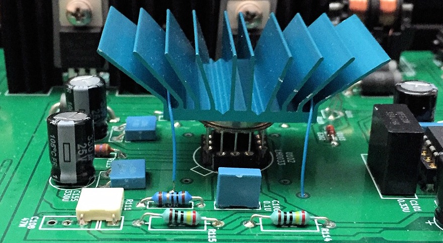

I'm not aware of anyone who built an M2x input stage daughter card using the LH0033. Certainly I never did.
However I once did build a different, non M2x, amp project containing a pair of LH0033s, and displayed + demonstrated it at a Burning Amp Festival. In the attached photo you can see a socketed LH0033, with its heatsink on top, and "strap the mattress to the roof of the car" guy wires. Also visible are a couple nearby capacitors that were laid down flat, for vertical clearance to an LH0033 "emulator board" that I used during debugging and checkout. If there was a design error or assembly error in the initial boards, I preferred to destroy an emulator rather than an LH0033.
I really liked the looks of those anodized blue heatsinks with non-parallel dissipation fins. The guy wires, and pads of slightly-sticky phase change material from Laird, kept them in solid contact with the LH0033s. As member @pfarrell remarked at the time, yes I really did buy a spool of AWG-30 wirewrap wire with blue insulation, just for this purpose.

I remember LH0033 has a much faster "bigger brother" in TO-3 housing?
6V/ns vs. "very slow" 1.5V/ns slew rate? .....something like that from memory.....
Could be a nice oscillator.......
I purchased some LH0033's from ebay when it was "advertised" in this forum. Could be fun to use them some day.......

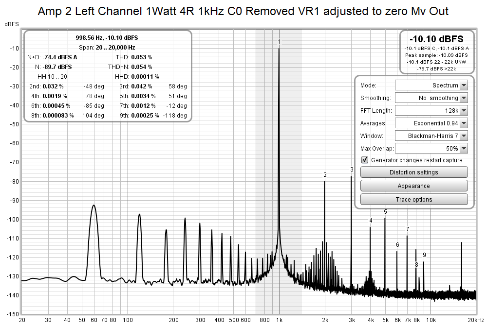

Ishikawa Input Board. Need Clarification.. I have searched and see both of the following being used.
In my search in the setting of the RV1 on the daughter board I seem to see two schools of thought.
1) Set RV1 so that the output is 0mV thus allowing to remove C1 or 2) set it so that the voltage drop across R1 and R2 is equal and let the output offset from the daughter be wherever it lies.
I have enough range on the RV1 to do either but not both.
If 2 is the answer then how much offset is acceptable before saturation of the Edcor becomes a concern and c1 becomes necessary.
I do have a REW/2i2 setup as well. What should I expect on the phase of the 2nd harmonic?
This is the THD of the amp with c1 shorted and offset to zero. 1 Watt = 2Vrms 4 ohm load. I will be trying some Mu-metal shield but not overly concerned as I really don't hear any hum. Amp is quiet.

Ishikawa has the advantage of being very flexible, as you note.
If you want to null the DC with RV1, that’s a great use of it. If you want to adjust your harmonic profile with RV1, by all means do.
I’m not a fan of DC on transformers and I am also not afraid of coupling caps, so having C1 in circuit is not a bad idea, imo.
You could also rig Ishikawa without RV1 nor C1, and you’d have the original front end as designed by Nelson.
Lots of choices.
