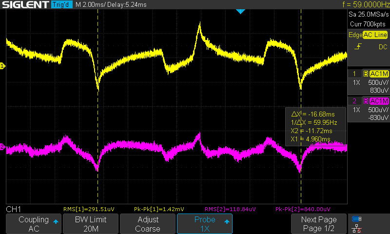

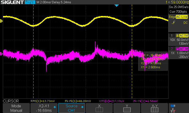

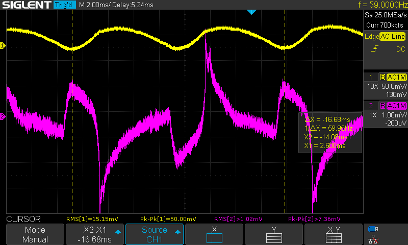

First scope picture is with the exposed edcor. The yellow trace being V+ showing 15mV ripple @ 120Hz. The pink trace is the output. Seeing a kinda funky 1mVRms (7.36mVpp) output with 60Hz cycle. I am Really curious as to why the waveform appears this way.
The second frame capture is with the Edcor covered as explained above. Scope is untouched, channels and scale are the same. As you can see the output noise is still 60Hz, but the magnitude is now only 300uVrms (2.56Vpp)
Finally the third capture is comparing both channels. The Yellow Trace is Channel (1)
is the one seen above. The pink trace is now Channel (2). The Channel 2 is in identical condition as Channel 1 however, it is significantly quite with only 118.84uVrms (840uVpp) output. Similar wave form an60Hz.
I want to get Channel 1 as good as Channel 2 now.
I can make Channel 1 worse by getting in and touching components. I swapped IP Cards and it did not follow so it is in the main PC board. Channel 2 is not as affected by touch leading me to believe I have a poor solder joint or similar. It might even be caused by the slightly different layout I am very Interested in opinions and ideas on what to look for.

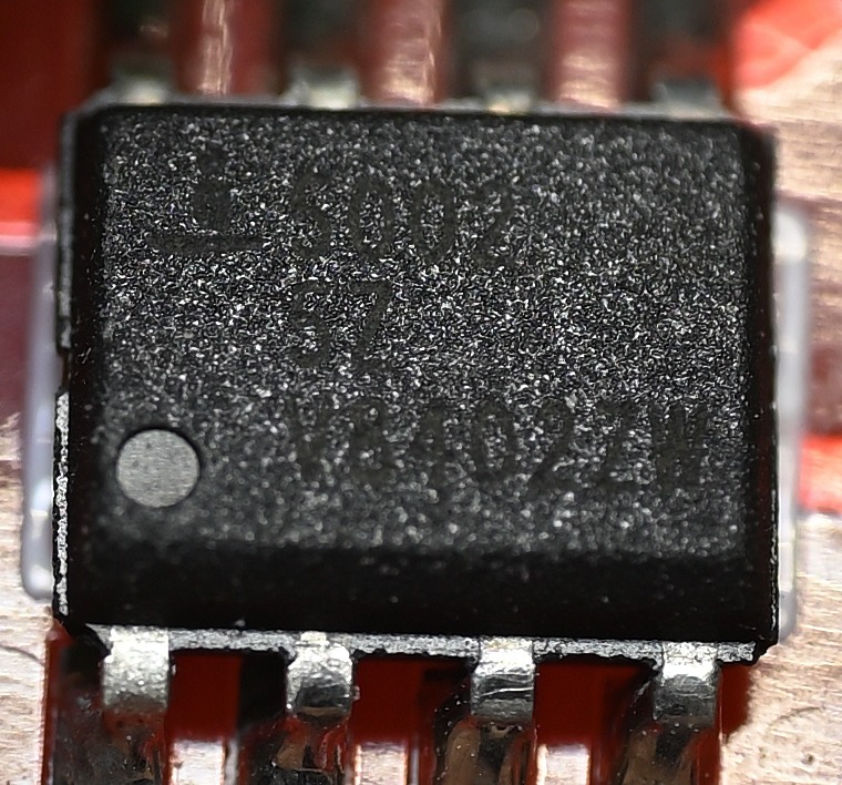

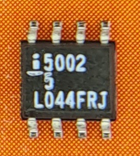

Hello
I couldn't find a close-up picture of a finished Norwood card showing the HA5002 operational amplifier.
Because of the very long delivery time of the op. amp. at the distributors I bought two from ebay (I know it was huge irresponsibility 😉). One is already soldered and the other (I think it is fake) is still "waiting".
What do you think they are all fake or am I lucky and the soldered one is original?
If someone could take a close up photo of a working Norwood panel I would appreciate it, it might be useful for others.
Thank you
Gyuri

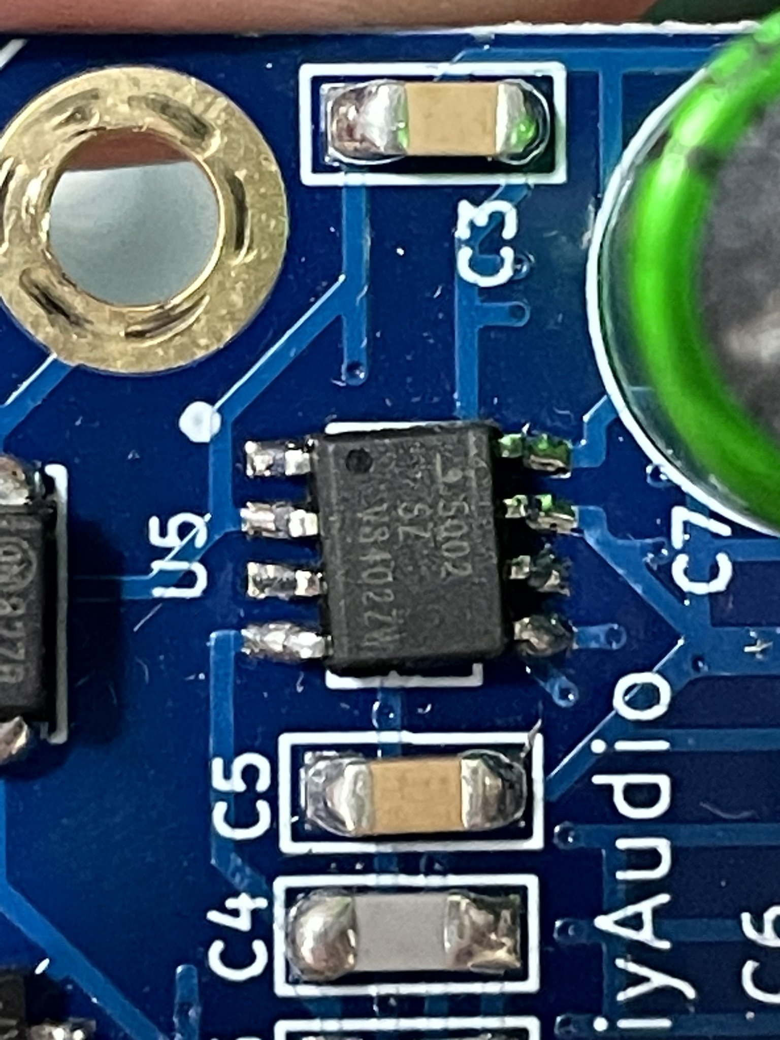

Your top one soldered looks more like mine... ordered from known source. Can't speak to the bottom one...

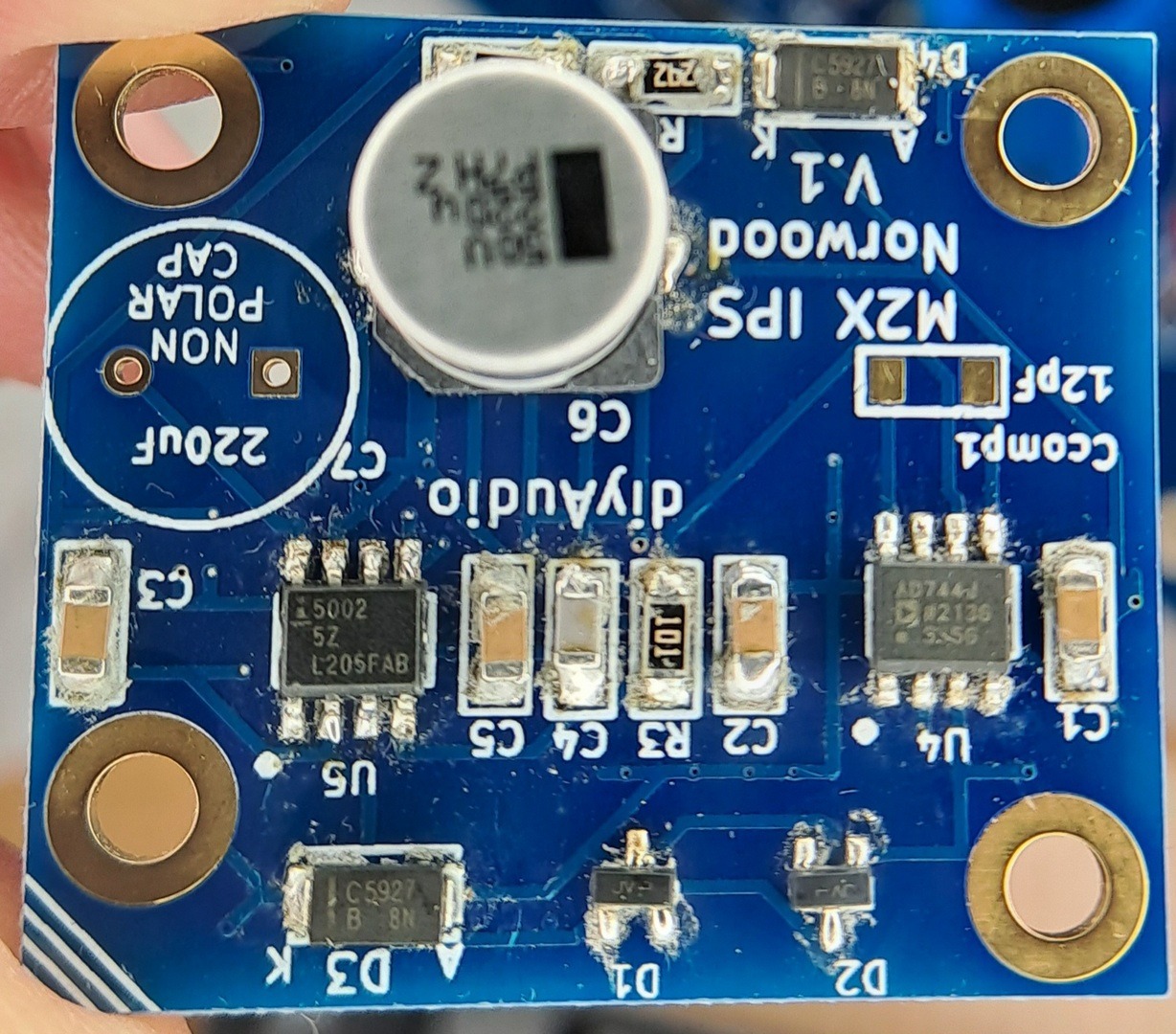

Ignore the poor soldering, please. First SMD soldering I ever did on an actual project. Just goes to show that it doesn't have to be pretty to work. One of my favorite (if not my favorite) IPS.

Thanks for the quick replies and the pictures.
My SMD soldering is much uglier, also a first attempt, plus I don't have a heat gun...
I haven't completely finished soldering the panel yet.
Anyone know of a reliable HA5002 source or have one of your own for sale? Farnell could deliver by October.

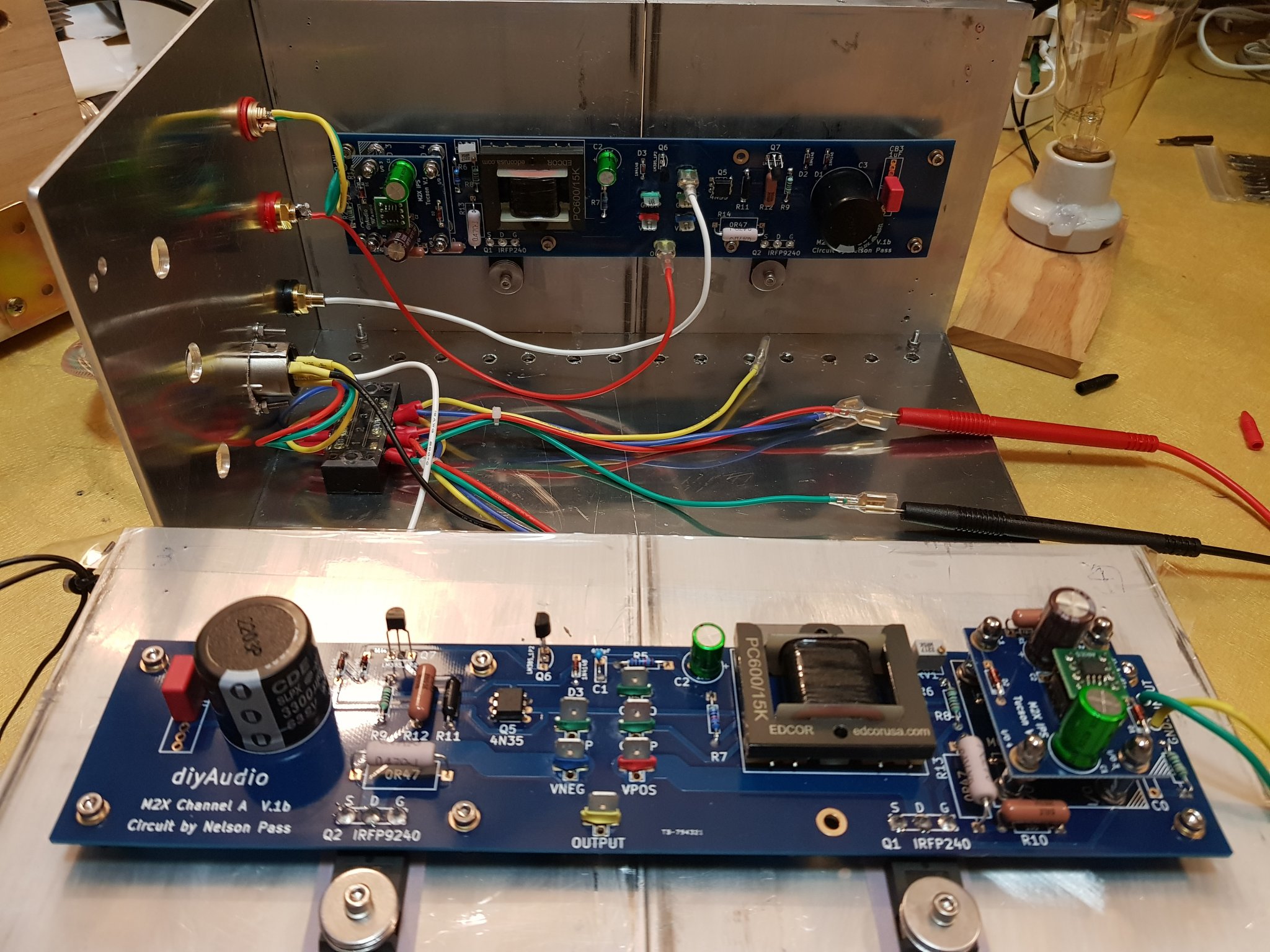

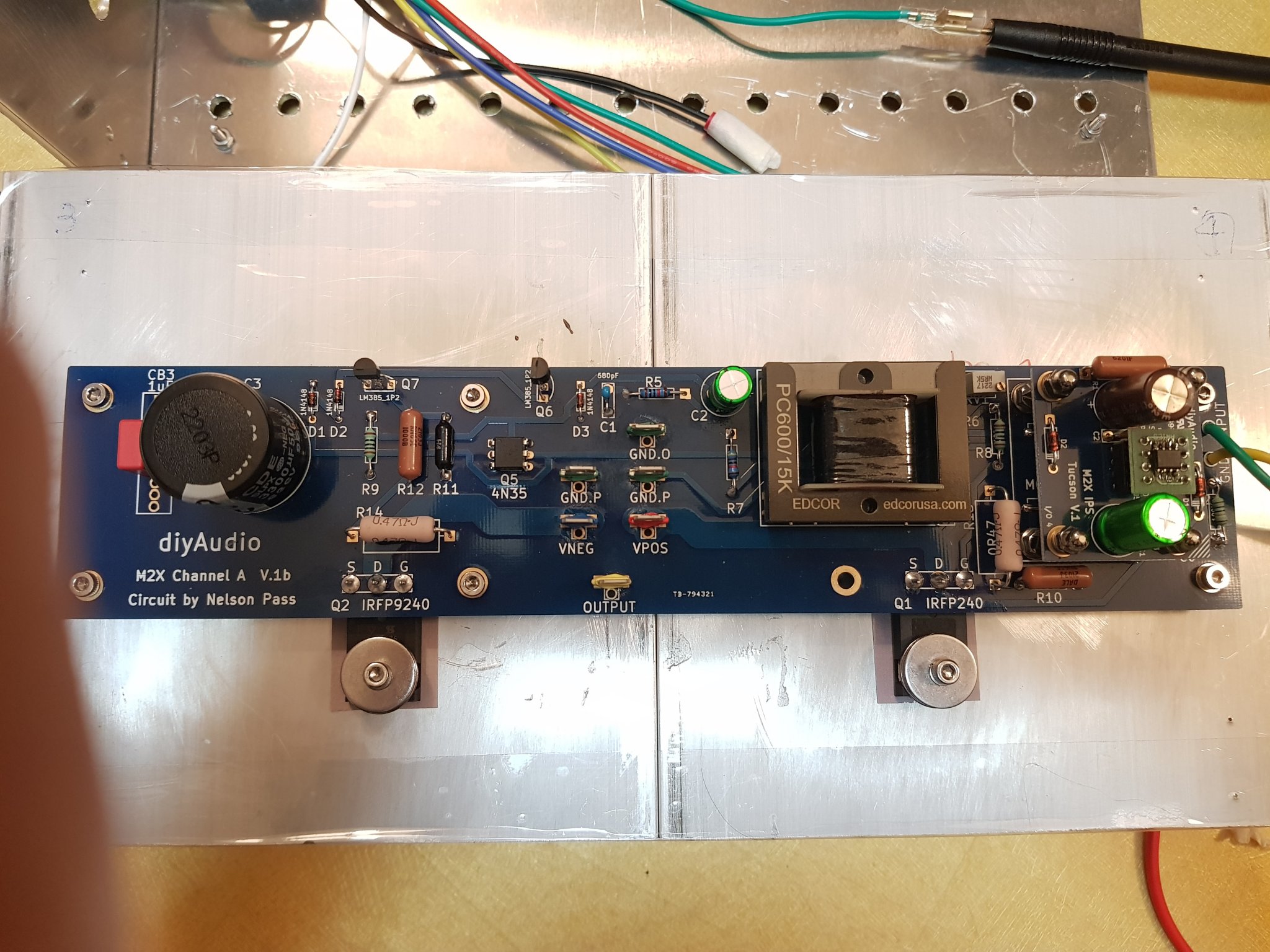

I've powered it up with a bulb (60W) tester, no load and no shorting input.
There is no smoke or burning stuff on both channel amp boards.
I've seen this comment and bulb brightness time series graph. #3355 #6062
The bulb became brighter in about 30 sec.
Is this normal in bulb testing on this M2X?
Can I go ahead to the next step - disconnecting the bulb tester and inserting a shorting RCA input jack and powering it up and adjusting dc offset with RV1?

In bulb testing, the voltage drop to about 5VDC (I've connected a multimeter to power lines for another channel) when the bulb became brighter again.
And It seems the bulb became brighter fully.

I'm glad you found my post useful. What you're observing I would consider 'normal' for running both amplifier boards with a 60W dim bulb tester. If you have a >100W bulb and/or a <25W bulb you can try various combinations and see how the behavior and brightness / timing may differ. It might be fun to watch your DMM from the initial 'flip of the switch' through the bulb dimming and brightening. I'm making an assumption as to how your DMM is connected.
There are a number of wonderful posts around dim bulb testers, but I've always found the article in this link to be very helpful.
https://antiqueradio.org/dimbulb.htm
In Mark's post, you'll notice that he states the power consumption of a 'normally' operating M2x (with both channels operational similar to yours). If you cross reference that with the article linked... and notice how they describe the behavior of various bulbs... particularly for a bulb of roughly 1/2 the rated wattage of the 'radio'... I'd think you're good to go.
What I think your concern might be is the overall timing and the fact that the bulb went back to 'full brightness' vs. some level of dimness. Both the timing and final brightness would be affected by the overall power draw vs. the bulb's initial 'cold' and steady-state 'hot' impedance / resistance.
Mark's illustration could also show on the Y axis 'Power consumption'.
tl;dr - if your bulb had not dimmed at all, I would be concerned and recommend troubleshooting. I say remove the dim bulb tester and carry on with final DC offset settings and/or if you have a higher wattage bulb you can put it in as one last final hurrah to rest easier. However, I'd consider that more of a "fun" check vs. necessary. No need to go buy more bulbs.

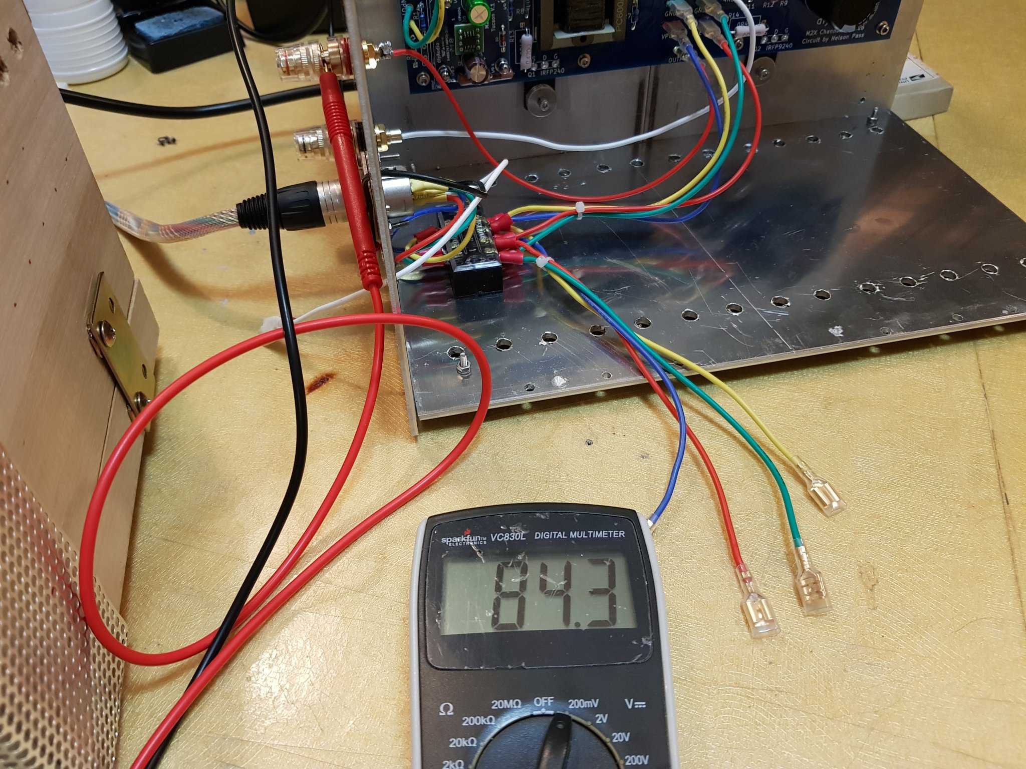

I disconnected the bulb tester and powered it up a channel.
I am on adjusting DC offset.
-8.5mv now

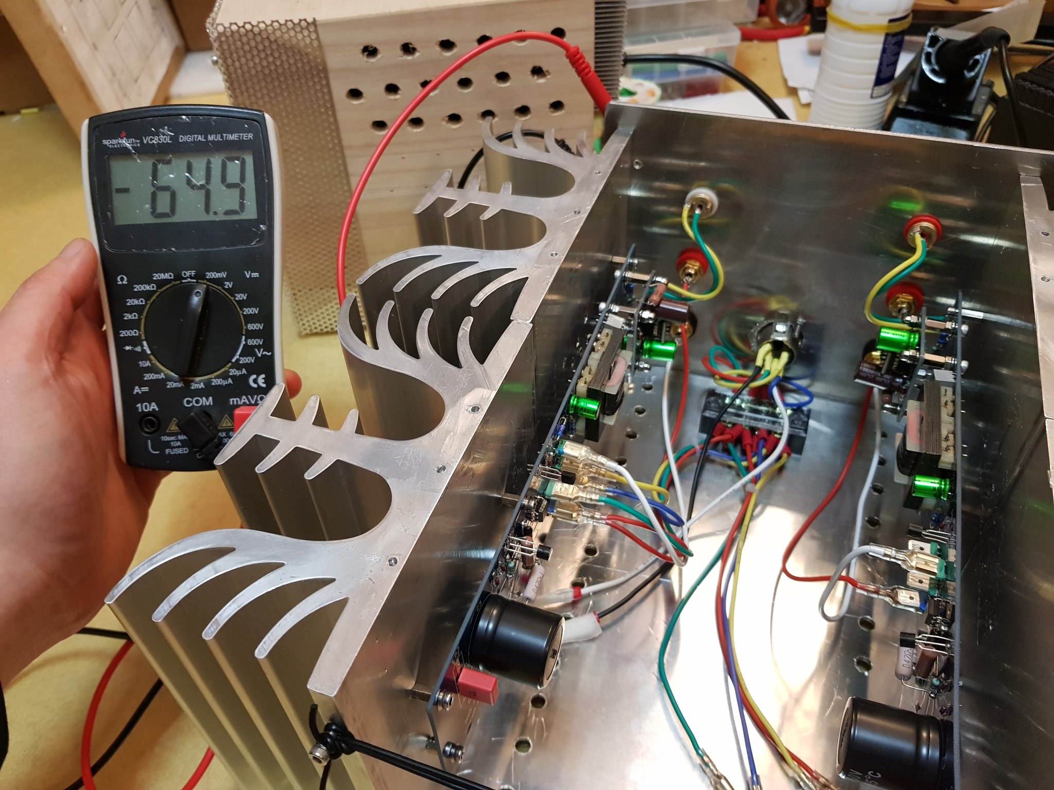

Adjusting dc offset of A channel seems OK.
It became 0.0mV automatically after one hour.
But B channel ended near (-)65mV after one hour.
DC offset of both channels started from minus values.
I felt that hooking up a speaker to A channel output gonna be OK.
It sounds indeed.
BTW, the dc offset has going down below -100mv and up over 100mV after powering the PSU down.
Is it safe on a connected speaker?
and... -65mV of B channel is safe?

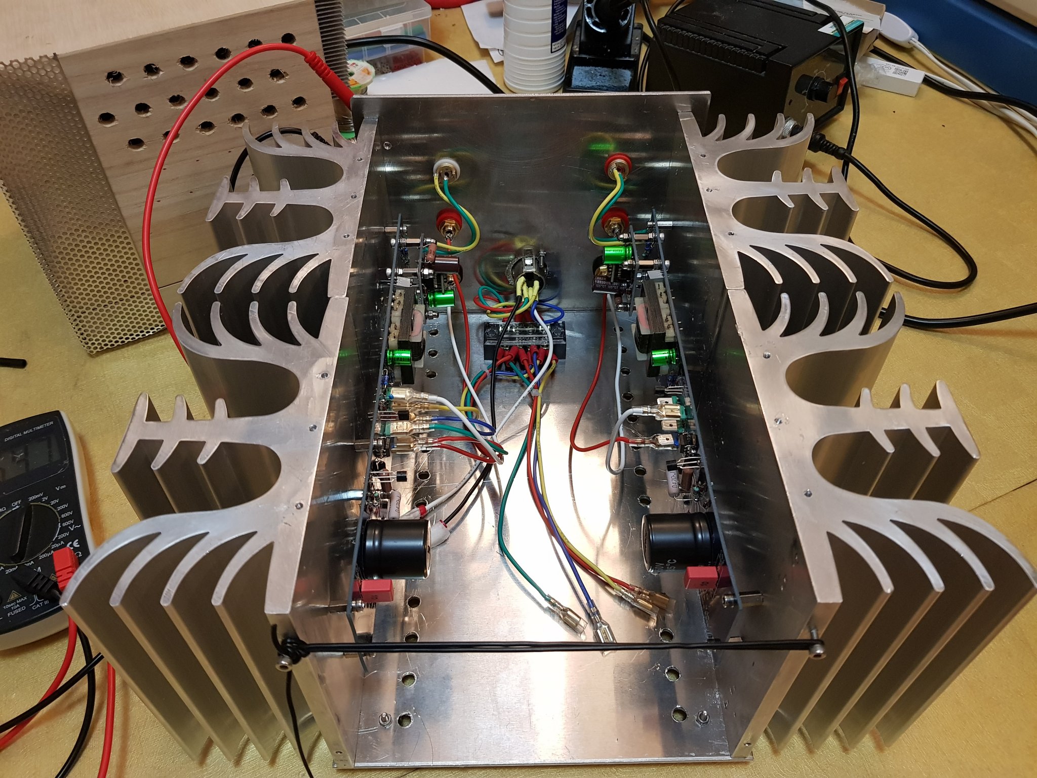

I would be very concerned with the stability of your chassis design. It looks as if the only support holding the two heatsinks together is the M2X board?
Wow, those heatsinks are gorgeous!
Re DC offset, this is a common issue and can be solved by blasphemous heresy, described by @Mark Johnson but please don't tell anyone that I got it from him https://www.diyaudio.com/community/threads/the-diyaudio-first-watt-m2x.321925/post-7201332

I've bought this heatsink with custom length cutting.

Yes. I thought it is not stable and am searching a proper method to connect the two heatsinks.I would be very concerned with the stability of your chassis design. It looks as if the only support holding the two heatsinks together is the M2X board?
I would suggest using a 6-10mm thick alum plate as a heat spreader that spans both heatsinks. Drill through holes(not tapped) and use M4 bolts/nuts to secure the plate to the heatsinks. Now you have one solid heatsink assembly. Drill and tap holes in the spreader plate to mount your M2X boards.
It's more work, but you'll have no worries afterwards 👍
