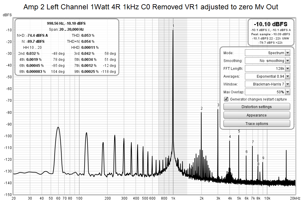

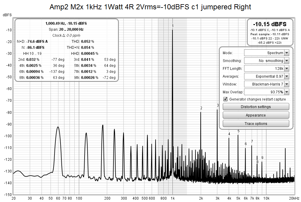

So as I got further into testing I find that I was able to achieve 0mV offset and equal Vdrop across the resistors in the second channel. For the first one (the one I was concerned about), I ultimately set it so that the Vdrop was equal and found that the offset voltage was only 1mV. I don't expect that to be a huge issue.
I would much rather optimize the gain stage for best linearity and have a cap if needed. C1 is the lesser of the distortion evils. But lucky in that I was able to equalize and not have C1.
Final results:
Should never say Final......
