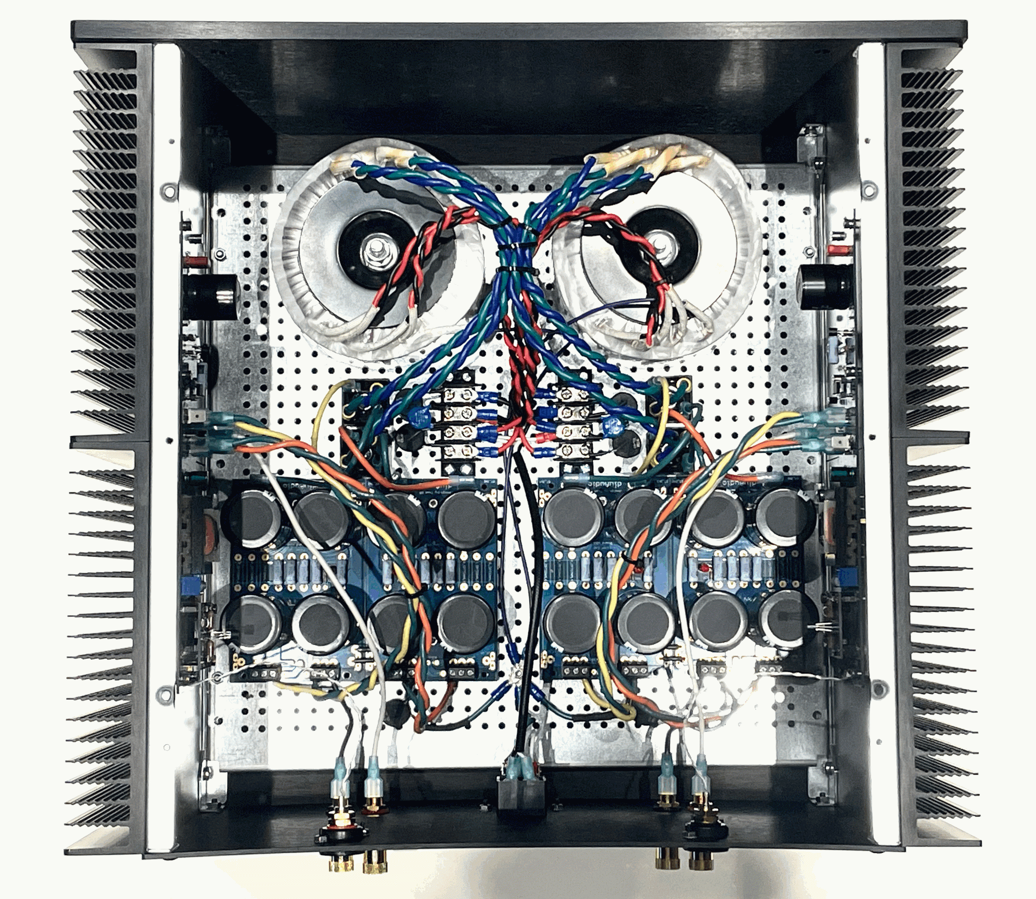

I'll let the amp burn in before commenting on sound, but have to say I feel so privileged to have access to this quality of amplifier through this forum and the store. This is my second build, following an F5. Thank you Nelson, and Mark for making this one happen.
Dual mono build in a deluxe 5U chassis.

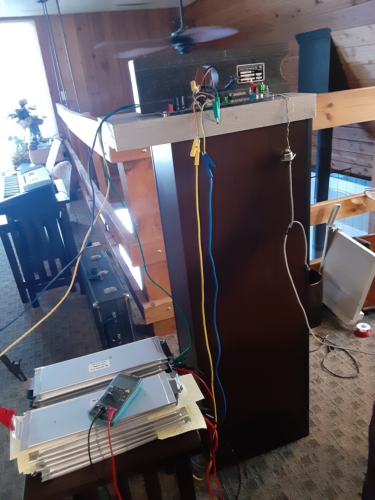

This seems about right. I'm running mine on batteries, center tapped and unregulated, so the voltage steadily declines from peak. When I ran the battery down too low the amp started crashing hard, very abruptly. I checked the voltage at about 12.5. My guess is around 14v for a bare minimum. What's interesting is I did not notice any change in performance from peak voltage up until the point things fell apart. It was sounding fantastic and then there was a sudden drop in volume with heavy distortion. It was less than thirty seconds later that I grabbed the voltage measurement; however, it's entirely possible the voltage could have dropped drastically in that short time frame considering it killed three cells in the process. So 14v is just my guesstimate.Yes, I think 10 + 10V is too low.
The lowest I will be sort of comfortable with is maybe 15 + 15.
See how many ifs I inserted in this?
I personally would not go any lower than 20 + 20V.
And what is it to gain with the lower B+?

A quick follow up on powering with center tapped battery-- I figured out a good way to do it and am using large LIFEPO4 pouch cells at 14s, center tapped, to the tune of 1.4kWh. This is the first time I have actually gotten decent power to the M2 and am totally impressed! This setup sounds much better than any of my previous amps and I haven't even started on any of the tweaks. The amp is freshly built and it really started coming to life after about a 30min warmup. I'm certain it will only keep getting better from here. BTW the battery should run two channels for about 8hrs and is good for about 2k charges cycles.This seems about right. I'm running mine on batteries, center tapped and unregulated, so the voltage steadily declines from peak. When I ran the battery down too low the amp started crashing hard, very abruptly. I checked the voltage at about 12.5. My guess is around 14v for a bare minimum. What's interesting is I did not notice any change in performance from peak voltage up until the point things fell apart. It was sounding fantastic and then there was a sudden drop in volume with heavy distortion. It was less than thirty seconds later that I grabbed the voltage measurement; however, it's entirely possible the voltage could have dropped drastically in that short time frame considering it killed three cells in the process. So 14v is just my guesstimate.
