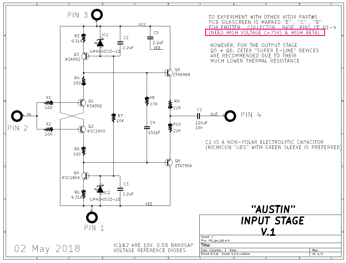

Referring back to MJ’s post #101, where he describes the Austin daughterboard:
And given that the originally specified (per the Austin schematic) ZTX Super E-line transistors are currently out of stock at Mouser, may I use these NPN and PNP substitutes?:

All six of the bipolar junction transistors on Austin need to be high voltage (>75V) and high beta, as noted on the circuit schematic.
IN ADDITION, I strongly recommend selecting output transistors (Q5 and Q6) which are high voltage, high beta, and the lowest possible Theta-JA (thermal resistance from junction to ambient). In TO-92 style packages, that means either Zetex super E-Line devices, OR Motorola/Fairchild/OnSemi/Toshiba devices in the TO-92L "long boy" package.
If you don't mind finagling the pins a little bit to make everything fit into the PCB drilled holes, medium power transistors in the TO-225 package with metal slug, are even better. TO-126 without the metal slug are nice too. Maybe you'll find a few that fit all of the criteria, (including the most important criterion: It Must Please YOU), in (this list). I slapped it together in 20 seconds so there may be omissions or errors, therefore be cautious, be skeptical, and double-check.
Beware: there are plenty of E-Line transistors that don't go all the way up to 75 volts. The 688 is only good to twelve volts (!).

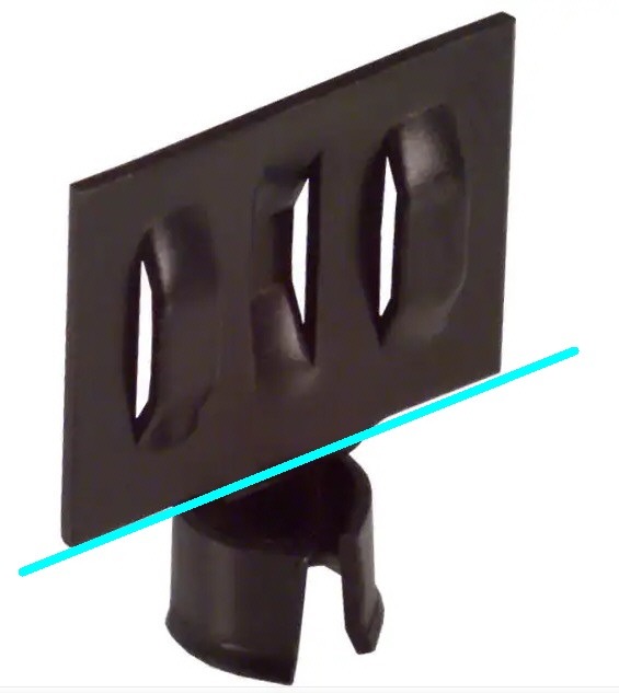

Finally, you could do some mechanical what-if sketches to estimate whether the TO-92 heatsink (!!) used in the diyAudio Noir headphone amplifier, might possibly fit Q5 and Q6 of Austin without clanking into nearby components. Check the clearance in all three dimensions, as I recall it was surprisingly tall. Download attachment #3 of Noir post #1.

Thanks again for the guidance. I revised my search criteria, knowing that the Austin board is quite compact, as such I ruled out TO-225 and TO-126's (at least for now). I ruled in TO-92L "long boy" and of course Zetex super E-Line devices but with the additional criteria of high voltage (>75V) and high beta. Getting the lowest possible Theta-JA has proven to be somewhat of a challenge. So with regards to the TO-92L variety, here is what I came up with that is in stock at Digikey.
The 2 that interest me the most are KSA1013YTA (PNP) and KSA2383YTA (NPN). They are at 160V, and the "Y" variety has the highest beta. I also found the heatsink you alluded to, the Aavid 575200B00000G which is rather tall!
For the TO-126 types, I rather like the TTA004B and TTC004B; they also seem to be good substitutes in the emitter output stages of Waynes BA2018 pre.
Let me know if I am getting close...

Anand, see whether you agree with this statement: "An artful dodger can read the Toshiba TTA004B datasheet cleverly, with great cunning, and from it deduce that Theta-JA is 75 degrees C per watt. Which is a hellll of a lot better than the KSA1013Y in the TO-92 long body package".

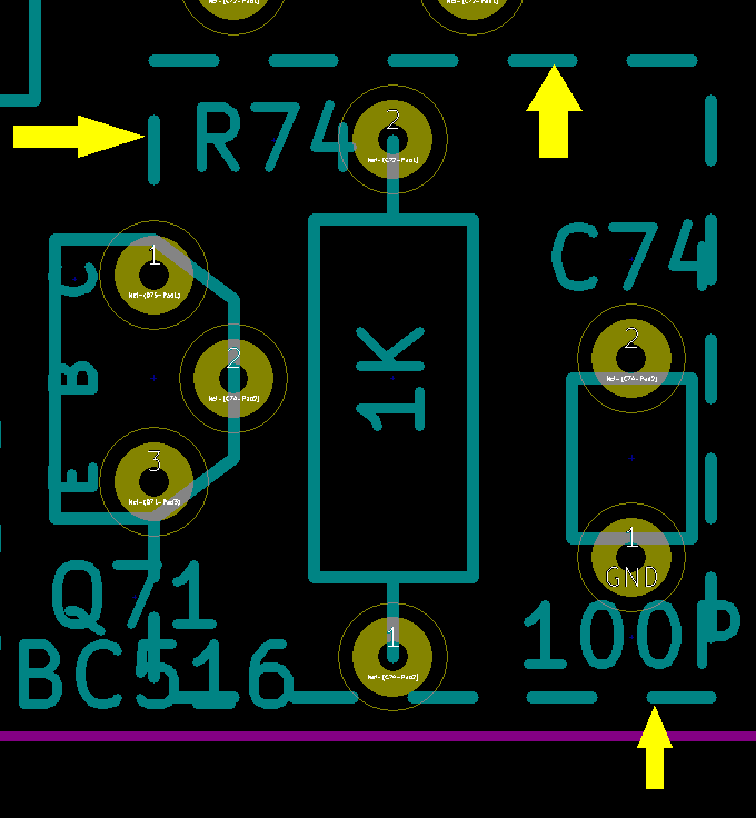

Also scan your long term memory to recall when you yourself assembled a Noir headphone amp. It had a TO-92 packaged device "Q71" with a heatsink. Ask yourself "Why is there a dotted rectangle on the PCB silkscreen adjacent to Q71?". When you get the answer, say Eureka.

Yup! 139 degC/watt (KSA1013Y) vs 75 degC/watt (TTA004B), essentially a no brainer.
