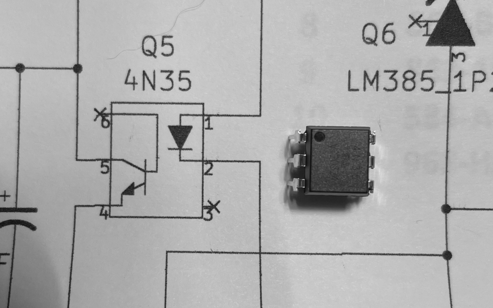

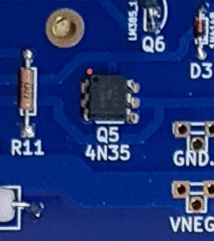

I have sourced all the parts to build a M2X. This will be my first real attempt at building from a schematic. Something I've noticed (and caused confusion in the past with my f5 build) is that occasionally parts are shown in mirror image. For example, Q5 on the main board of the M2X. Is there a reason for this? Or are schematics typically drawn from the bottom of the board?
Q5 is not mirrored. When you place it into the board from the "script" side, pin 1 must be where the square soldering field is (red dot):I have sourced all the parts to build a M2X. This will be my first real attempt at building from a schematic. Something I've noticed (and caused confusion in the past with my f5 build) is that occasionally parts are shown in mirror image. For example, Q5 on the main board of the M2X. Is there a reason for this? Or are schematics typically drawn from the bottom of the board?
I understand that the dot on the 4N35 is pin 1, and going counterclockwise from pin 1, each pin is labeled: 2,3,4,5,6. Component placement on the board is clear. On the schematic, pin 1 is shown to be at the top right rather than the top left - a mirror image of the 4N35.
98% of schematic diagrams that include ICs, use "symbols" for the ICs which have scrambled pin order. In fact that's why these schematics include pin numbers at all -- because the pin number is extremely significant electrically, while the (scrambled) pin order on the schematic symbol is electrically insignificant. Schematic symbol pin order is either utterly random, or else chosen to make the draftsman's life easy. The schematic READER's life is made easy by including the actual pin numbers.

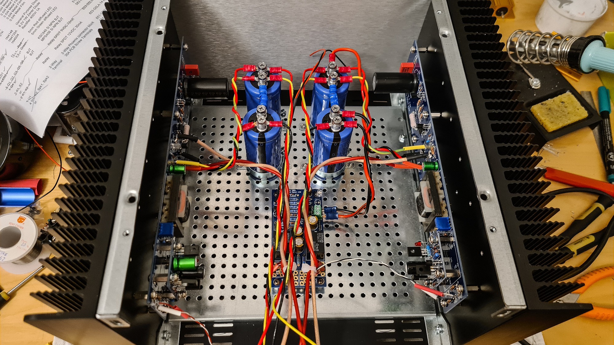

About a year ago the left channel on my DIY First Watt M2X stopped working, I was not in a good place at the time and couldn't be bothered fault finding so just swapped it out.
Yesterday I decided it was time to investigate, Opened the lid and the -24v rail to left channel had a burnt wire and connector at the PSU end.
Disconnected the wire and powered up to measure the rails, all good. Visual inspection of the left channel showed the 0.47ohm resisters were slightly browned, not a problem.
I removed the MOSFETS and tested them, all good, so I refitted them.
I swapped the opto coupler as I had a spare. Glad I fitted sockets now.
So I repaired the wire and on checking the screw in connector blocks I noticed that they were not very tight, tightened them all, checked for any visual probs on the PSU before powering up.
Long story short, it is now back in my system and working as it should.
Lesson learned: Loose connections cause heat problems at the joint.
