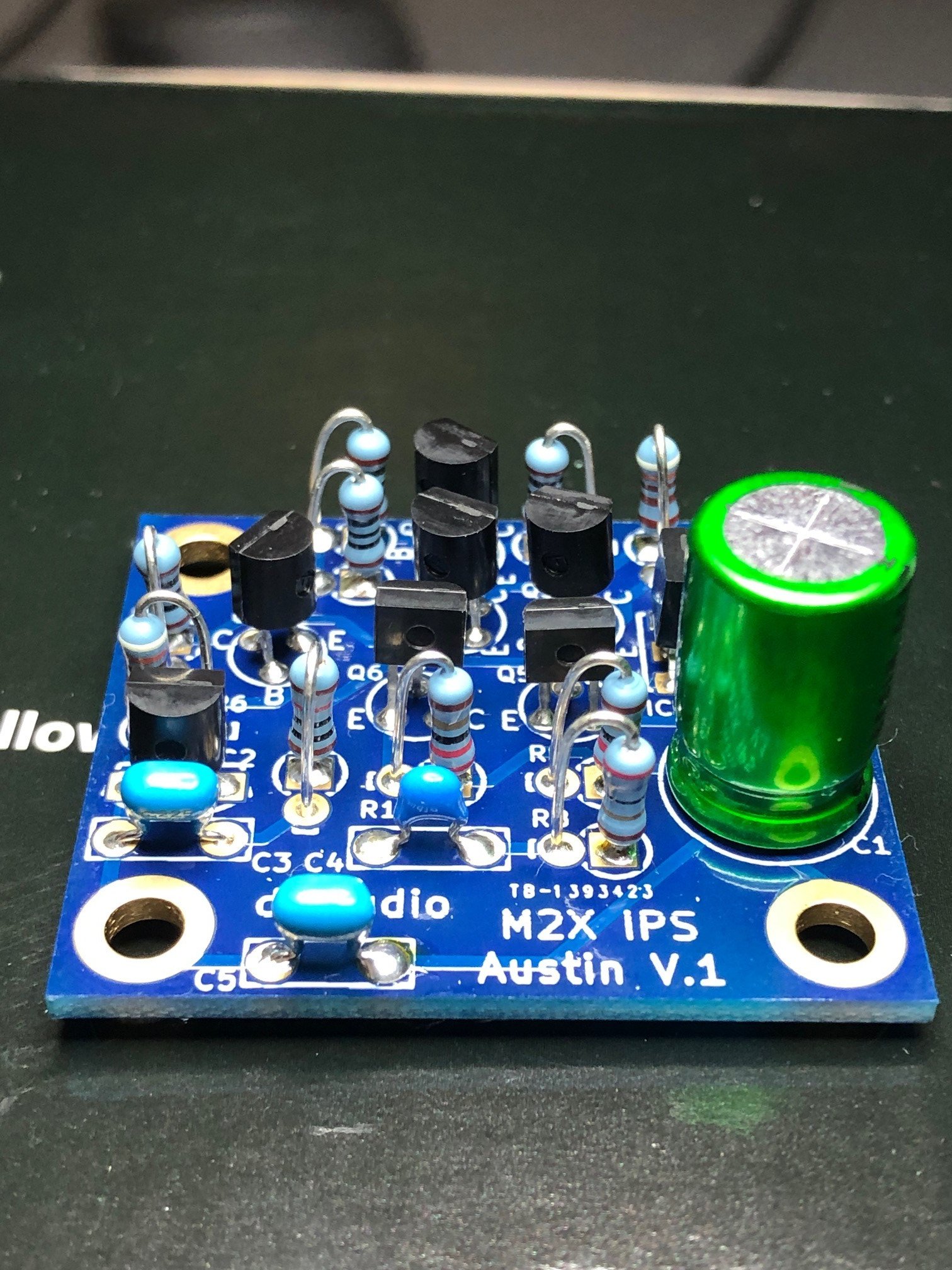

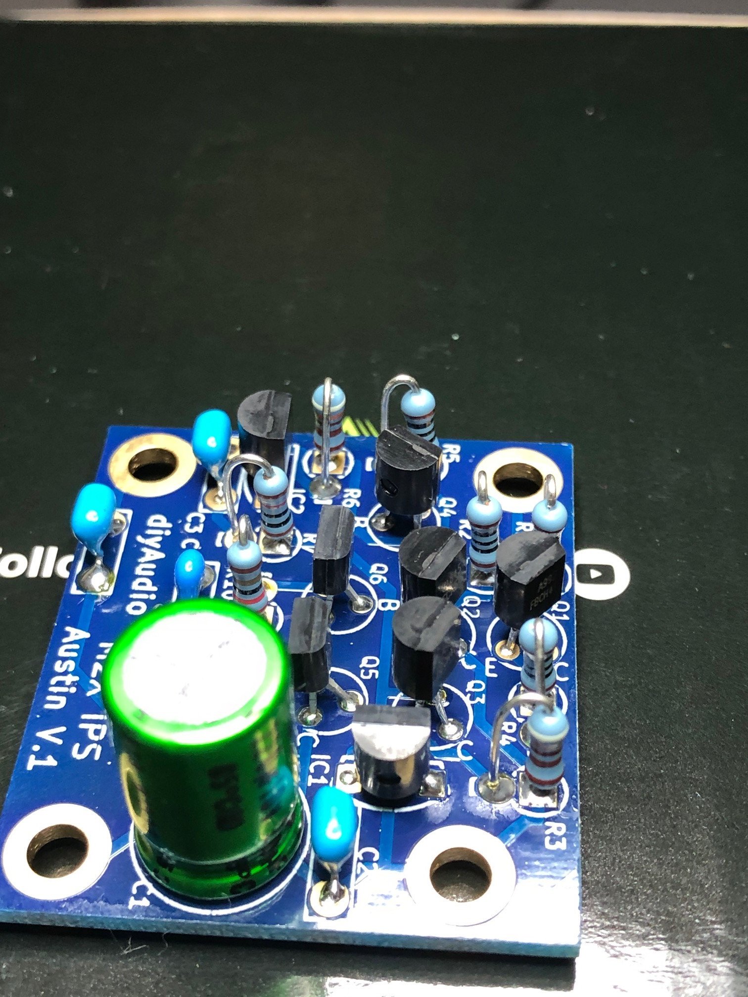

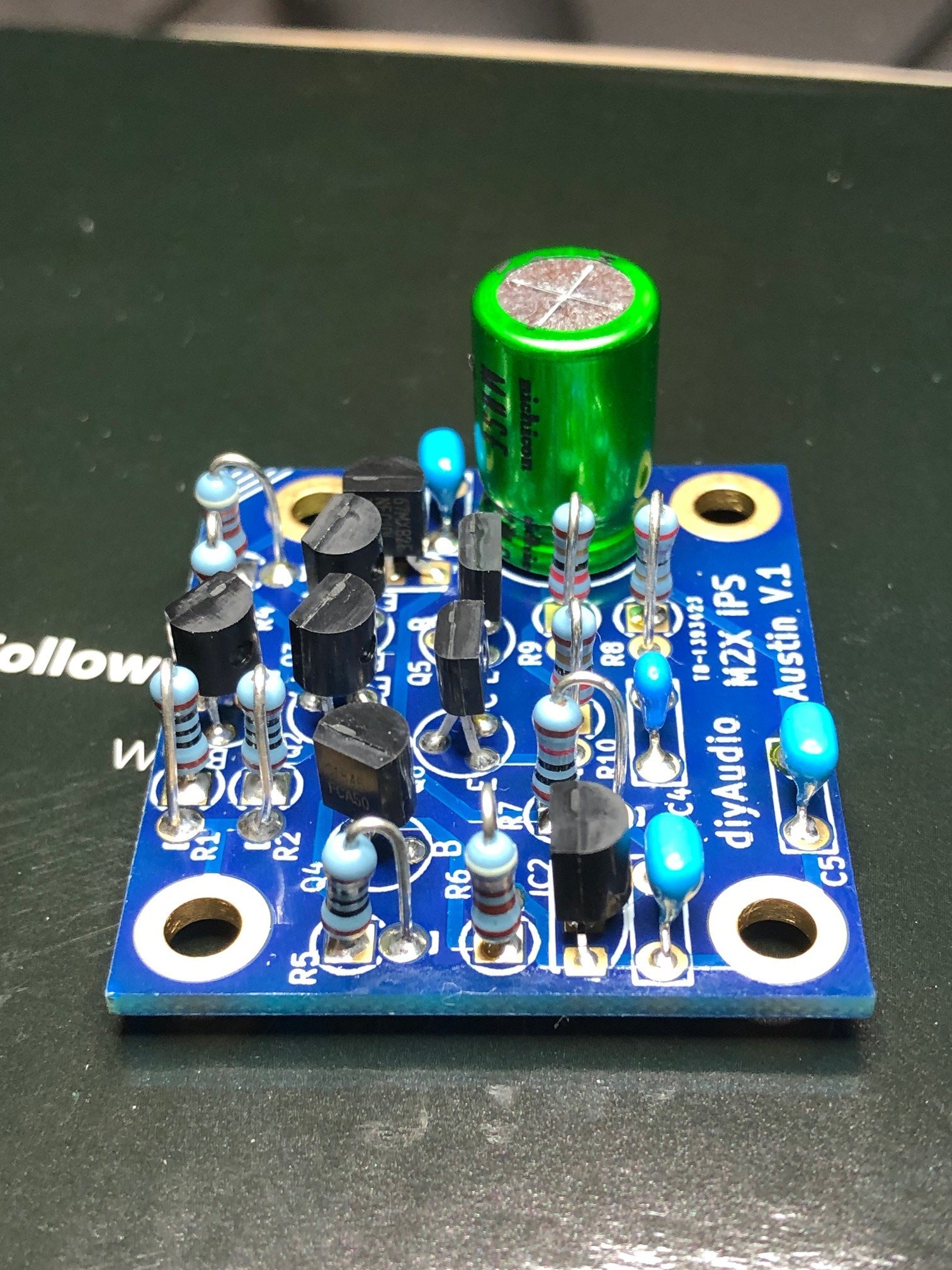

Yea. The first time I built the M2x all daughter boards worked great. The Austin is my biggest worry because of the Orientation of the transistors. The 1845s and 992s don’t have the same pinouts as the ZTX and I wanted to confirm I had them the right way. Does anyone have a closeup picture of their austin boards so I can confirm?

Here three pics of my Austin board. Here's three angles, let me know if you need anything else.

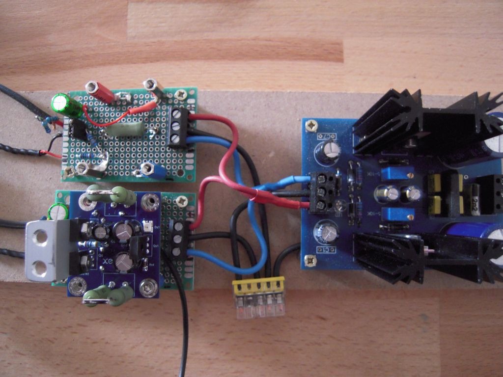

I built a input board test bench just using an extra amp-board. For PSU I used a lab-supply which is nice because of the current limiter. Then smoke can be avoided. I use RCA for in and output so I can measure using scope etc. and look at the signal....e.g. like sinus in, sinus out and square in, square out.

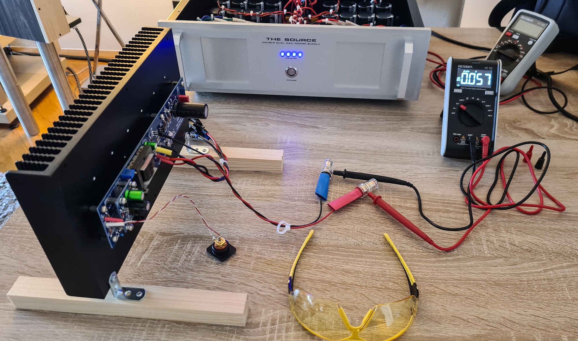

So, after 1 hour the DC offset has settled to -41mV... yes, minus... is it a problem?
If yes, should I change R6 to 37k and RV1 to 20k as described by Mark, when using the Tea Bag IC? I however the Mountain View input card.
Many thanks for any help in advance.
