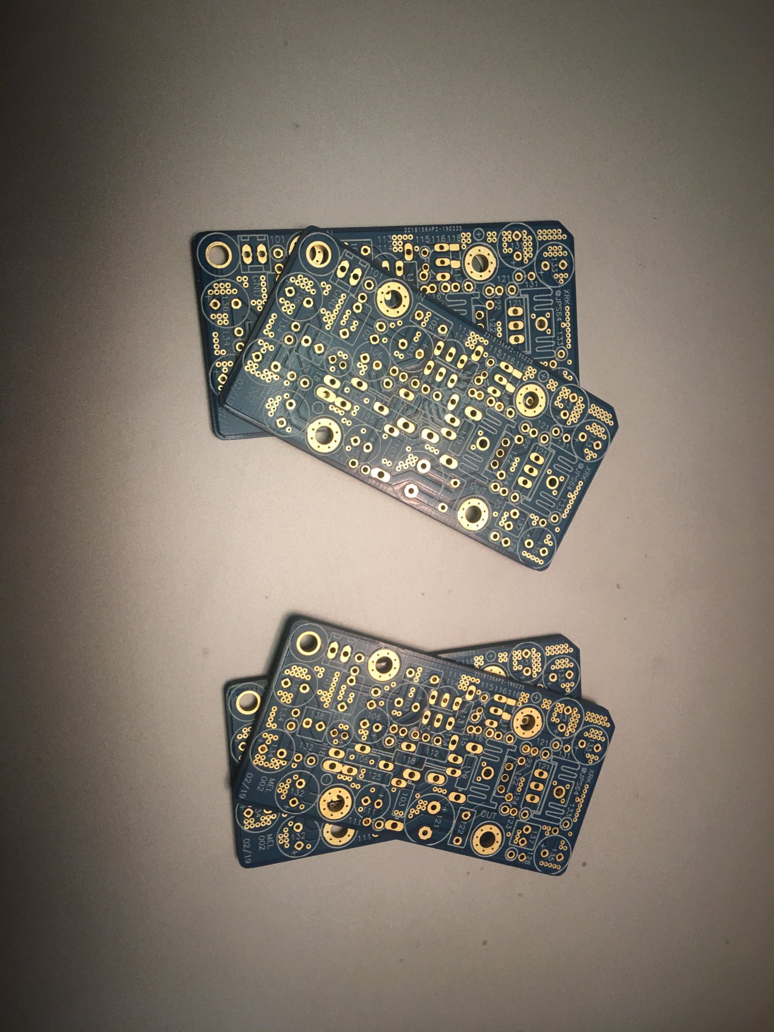

Is it possible/feasible to alter the IPS6 or IPS7 to provide a 3 - 6dB gain - would it need an extra wire to the 0v point of the signal ground? I was thinking of ICs like the OPA-627, Burson V6 classic, etc
That’s an easy one… in M2x the input cards are all, by design, buffers, in order to supply the current necessary to allow the autoformer to provide the needed gain for the output stage. The buffers all float between the power supply rails as thier reference to ground isn‘t necessary for proper operation and can be utilized beneficially in certain cases.
As jameshillj correctly infers, any of the IC input cards would require a connection to ground in order to be wired for gain, and that may work just fine, but I don’t think anybody has tried it, (perhaps one person?) so an intrepid amplifier builder might as well break out a Tucson and fiddle with it and see it can be made to work properly. The worst that happens is an unsuccessful experiment and you return the configuration to (the excellent sounding) stock. And if it works, fantastic! Please post your results here.
What about the AKSA Lender / Melbourne input board project?
This board could be configured to have some gain?
It also had a GND connection. Maybe search this forum for "Melbourne".

Post #110 in the Melbourne group buy thread, suggests that about a hundred daughtercards were fabbed. Some were probably purchased but never built, others were probably built and plugged into the "Yarra" (non M2x motherboard), and still others were probably built and plugged into M2x.
