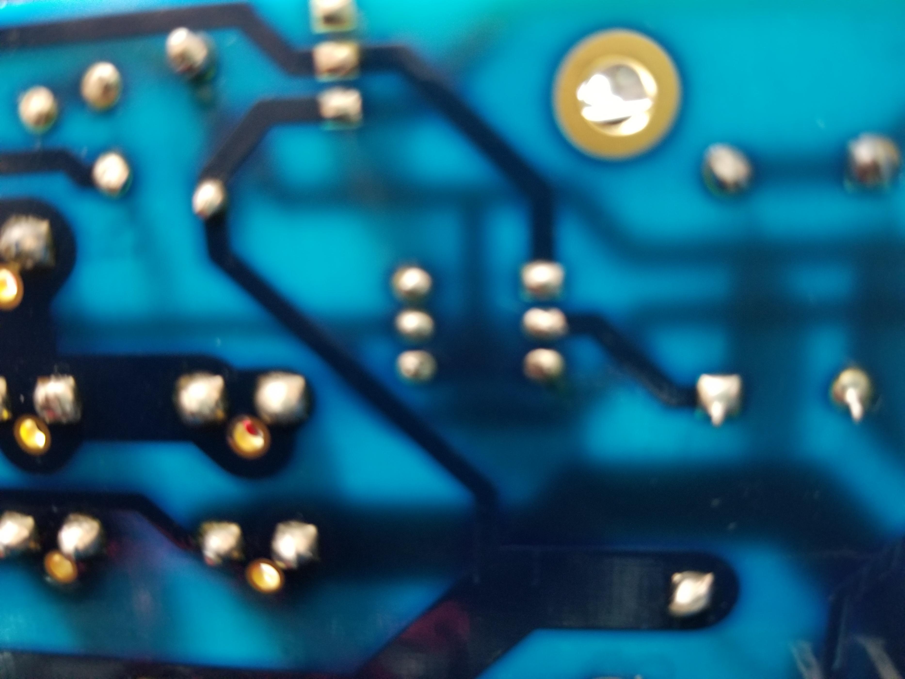

2. Attached are photos showing the orientation and backside soldering. Have done a good bit of this recently and know that both are correct. Keep my Hakko iron at 348 degrees Celsius which is the lowest setting to melt solder. Only touch transistors and optos long enough to make a good, solid connection.

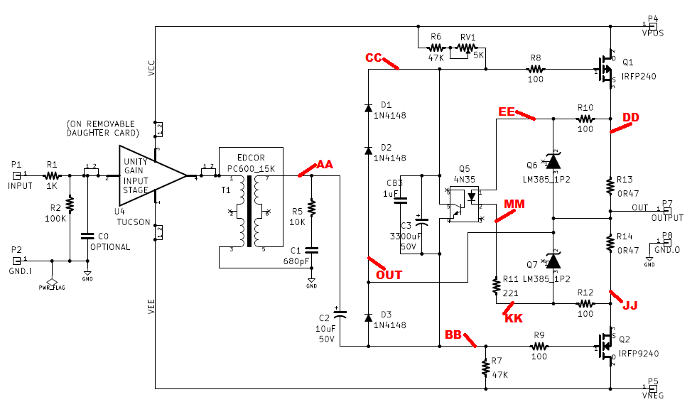

The LM385 1.2 at Q6 and Q7 are actually not transistors, but voltage references, See attached data sheets. I think they are used here as a voltage limiter to protect the Opto LED, kind of a low-voltage Zener Diode.
The symbol on the schematic shows them in this way, too.
Don't know what happens to them if a lot of current is drawn around them, and don't know what defective LM385s would do in this circuit.
It could be instructive to monitor the voltage between Pin1 and Pin2 of the Optocoupler after you switch on the amp. It should start at zero, and rise like 2x the voltage over R13 or R14. Probably a bit less than 2x, because once the Opto LED starts drawing current, some voltage gets lost over R10, R11, R12. And the voltage between Pin1 and Pin2 should always be less than 2.4V (two times the LM385 reference voltage). It should stay there even if the voltage over R13 or R14 continues to rise.
That way, we could make sure that the Opto LED gets the right signal.
How many meters do you have ?
I would only try this measurement with one meter (very small-tipped clip-on probes) at Opto Pin1 and Pin2, and the other meter measuring voltage across R13, so you could switch off before it starts to smoke.
1.2V across 0R47 are actually already 3W (P=U^2/R), so anything higher will have it smoke eventually.
The Opto LED reaches too high current already at about 1.5V (see data sheet maximum ratings and Figure 1). So it might be damaged by now.
Also, 1.2V over 0R47 are 2.55A (Ohm's Law) - that means Q1 and Q2 are dissipating about 60W (P=U*I) each - they will get too hot quickly as well.

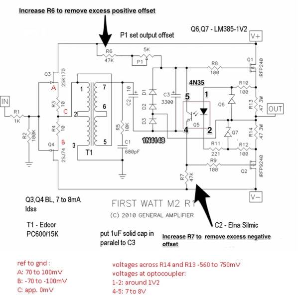

That you measure a resistance of 220R between R14 and Opto Pin2 does not indicate that the 4N35 is damaged or the wrong part.
If you look at the schematic, there may be additional current pathways that the resistance-measuring current from you meter might be taking as well, giving a result different from the expected. I don't know what voltage your meter uses to measure resistance, and don't have a clear understanding if the LM385s will have a finite resistance under those circumstances, and if the Opto LED might be conducting.
Anyway, this is not the route to follow at the moment - as I wrote before, a too-low resistance would in a working bias circuit regulate the bias to a lower current than the correct resistance in the string.
We need to find out if the Optocoupler is working as intended - that the Opto LED gets voltage and illuminates the opto transistor when current flows through R13 / R14, and that the opto transistor is discharging the cap C3, so that there would be an equilibrium at 1.3A current through R13 / R14 (600mV).
Which, apparently, isn't happening. The capacitor C3 gets slowly charged as designed, but it doesn't get discharged at the same time by the opto transistor as a counter-action, and no equilibrium is reached.

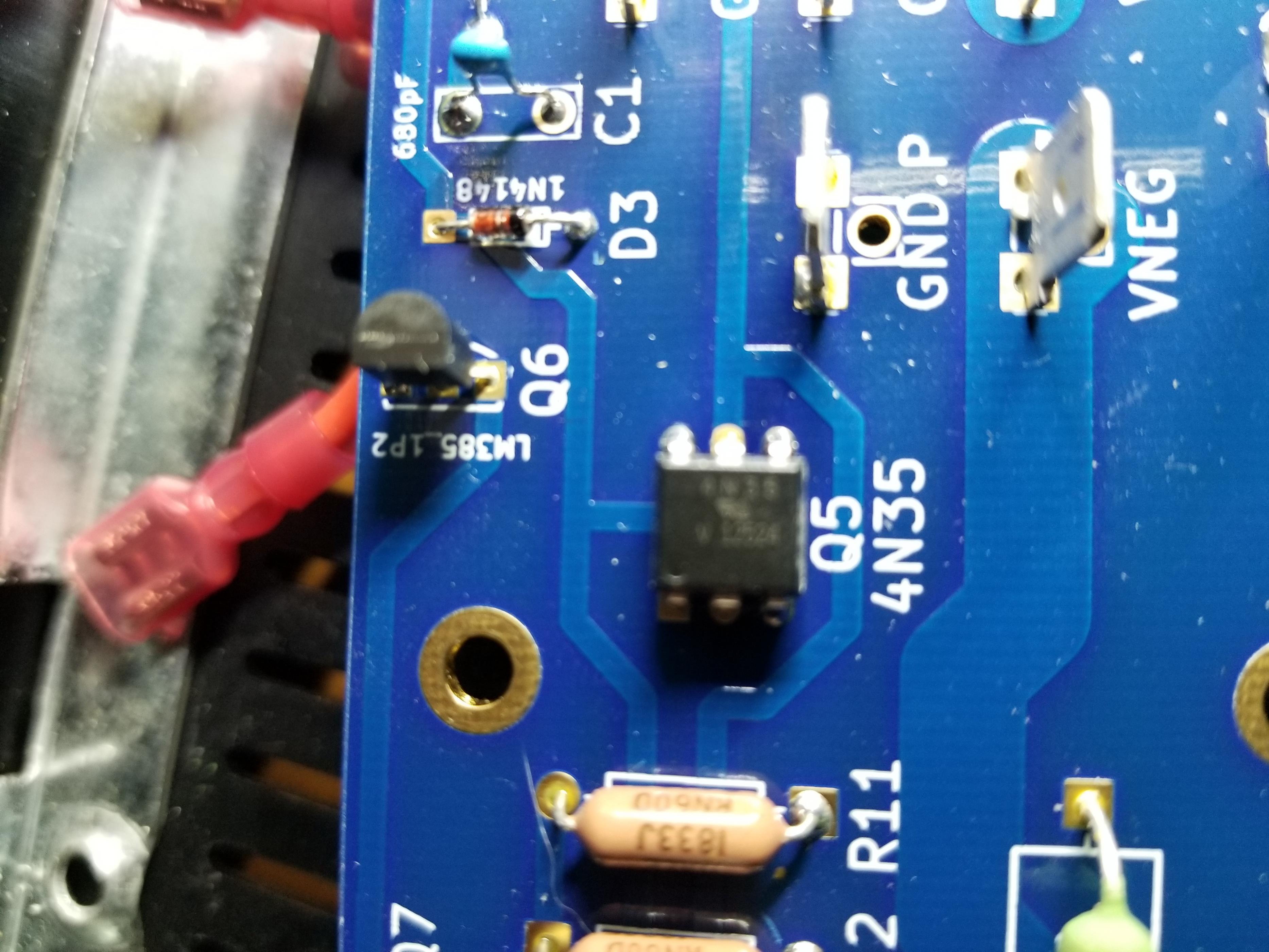

Can a diode check be done on the 4N35 and the voltage references? I think pin 1 to 2 should test as a diode also pins 4 to 6 on the 4N35. I am not sure about the voltage references.
From the data sheet it looks like pins 2 to 3 of the 595-LM385LPR-1-2 should test as a diode. Test the working boards verses the non working boards.
The voltage drop across the opto diode will be around 1.5V, so if your DVM will light up an LED,
it will be able to test the opto diode.
Just checked the two optocouplers I have from, possibly, a defective batch. They show 1.077V from 1 to 2, no conductivity on reverse polarity and 0.708V from 6 to 4, no conductivity on reverse.
Does this indicate poor performance being less than 1.5?
The working board measures 0.440 from 1 to 2 and the same 0.708 from 6 to 4. But this is connected and often a diode must be measured free. So, measured a new, unconnected RN35 and it was like the non-working boards -- 1.077 1 to 2 and 0.708 from 6 to 4.
Does this suggest that something is not connecting to the non-working boards and causing a different voltage than the working board?
